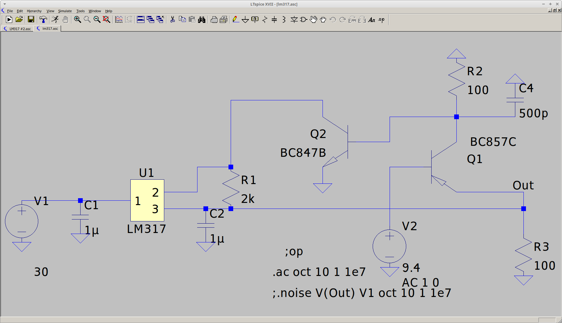

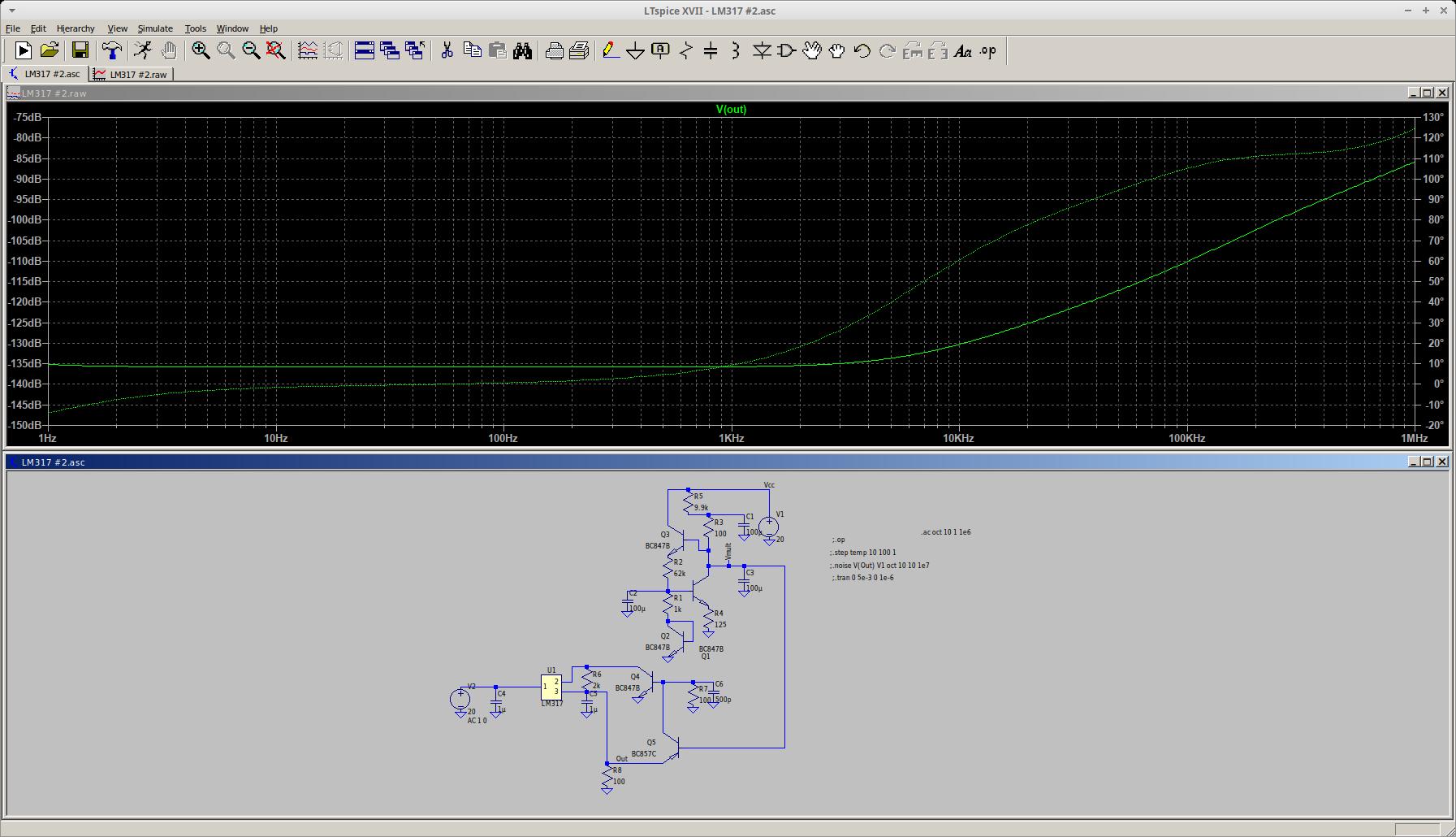

Tube/valve amplifier Stability Simulation in LTSPICE
Hi all,
As I am doing my experiments with valves, many times I found my amplifiers oscillating.
To get a better insight of what is contributing to this, I have decided to simulate the circuit in LTSPICE, however the results I get make no sense at all.
Just to show an example, I designed a basic 2 stage 12AY7 pre-amp with the usual values for the resistors, capacitors, etc.
To do the analysis, I used the normal approach:
1 - Connected the amp in unitary feedback
2 - Broke the feedback puting a large resistor and capacitor, followed by a DC voltage source with DC=0 and AC=1
3 - AC analysis with 50 points per decade from 100Hz to 10MHz
Simulating the circuit gives me non-sense results. The poles should contribute with a 20dB/dec roll-off and 90deg/dec, which doesn't happen. It can be seen that the magnitude curve never crosses 0dB.
