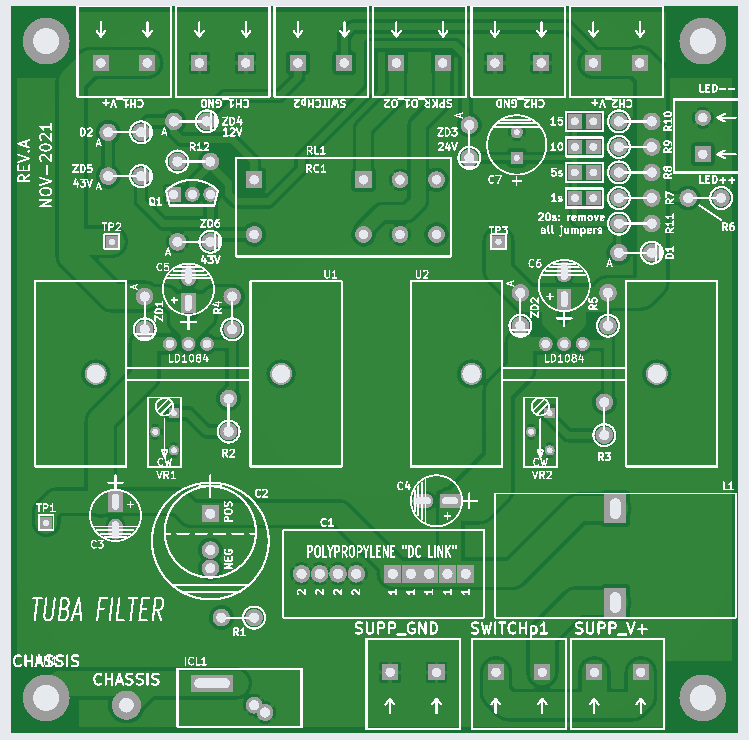

This Tuba PCB contains both an LC filter, to get rid of >50 kHz SMPS hash noise; AND also a of pair linear voltage regulators, to get rid of 100 Hz / 120 Hz hum. It's 2X filters. And just as 2X4 lumber is called two-by-four, this board is two-by-filters. Common mis-pronunciation is "two buh four" aka "tuba four". This board is thus "two buh filter" aka "tuba filter". Yes I know: too much information.
Each amplifier channel gets its own linear regulator, so Tuba provides an almost-dual-mono power supply arrangement. The left channel has no idea what the right channel is doing, or how loudly, so you get better stereo separation. Among other dual mono benefits.
The key component which makes Tuba possible, is the LD1084 voltage regulator IC from ST Microelectronics. It's a 5 ampere, low dropout regulator, which gives excellent hum reduction (>60 dB @ 100 Hz) without dropping much supply voltage. That's the second, downstream filter.
The first, upstream, filter is a critically damped LC network, using an inductor whose DC resistance is only 0.067 ohms. Even at the SMPS max rated current (4.4 amps), it drops less than 0.3 volts. This is paired with a "DC Link" polypropylene film capacitor, for lowest possible ESR. I suggest you actively consider the Epcos B32653A4105 , or if that's not available, the Kemet R75GI41005 . Both have truly mind boggling specs for dV/dt. The LC resonant circuit is critically damped by C2 and R1, reducing its Q well below 0.5, thereby eliminating any possibility of ringing.

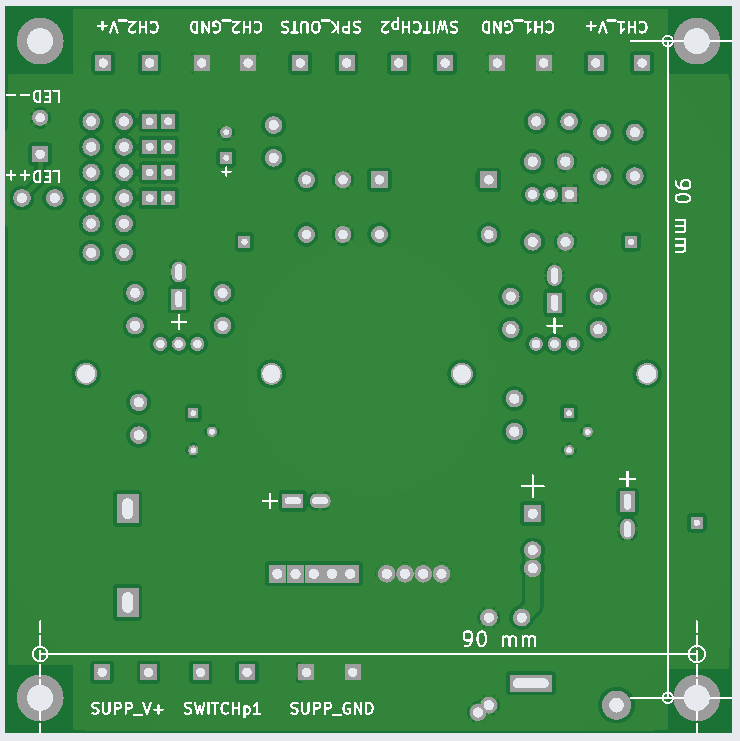

Gerbers are attached below; I very strongly recommend that you order PCBs with double thickness copper ("2 ounce copper"). There's nearly 5 amperes flowing in these traces! Make them thick and let the board run cool, run safe.

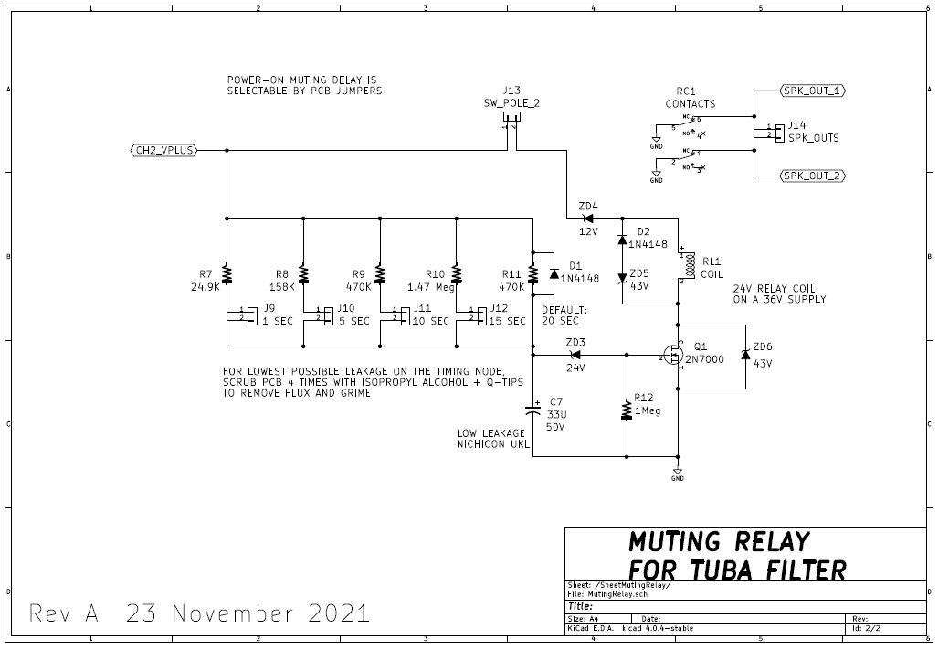

There is also a thump prevention relay circuit, on page 2 of the schematics. It is just a slightly fancier implementation of the thump preventer on the N-channel VFET supply filter board, designed by Nelson Pass. The same two-pole switch ("DPST") from the Nch VFET filter board is used. One pole turns power on and off, the other pole gives the thump preventer circuit a warning that the supply is about to collapse Right This Moment.
The speakers are muted "instantly" (with no delay) at power off. And the speakers are only un-muted after a long and leisurely delay from power on. PCB jumper options J9 thru J12 let you, the builder, choose the un-mute delay after power on: either 1, 5, 10, 15, or 20 seconds. Both of the beta testers set their PCBs for 10 seconds. And both were so happy with the results, they didn't bother to try the other delay options.
Tuba's choice of relay is mostly dictated by what parts are on the shelf today and not backordered for 24 months. That means: avoid the high demand relays (with 12 volt coils) and use the low demand relays (with 24 volt coils). Also avoid the small and cute, low profile relays; instead, use the big clunky ones that take up too much PCB realestate and are too tall. So I chose 653-G2R-24-DC24. Other relays that fit the board and work well are 655-RTE24024F and 651-2961192 .
The board fits inside the Modushop VFET chassis and its mounting holes align with the ventilation slots on the bottom cover, so you don't need to do any drilling. Its mounting holes are also aligned on the same 10 x 10 mm grid as the standard steel baseplate of the Modushop non-VFET chassis such as the Deluxe.

ADJUSTING THE TRIMMERS: IT'S ALL ABOUT THE IN-TO-OUT VOLTAGE DROP
Find the three test points "TP1" , "TP2" , and "TP3" on both the schematic and the PCB. Adjusting the trimmers depends critically upon the voltages between these points. Solder a piece of 22AWG solid-core wire, sticking up about 1cm above the PCB, in each of those three places. Or use explicit "test pin" parts made by Keystone or Harwin. And get out your most accurate digital voltmeter.
Before you ever apply power to the Tuba board, turn both trimmer knobs ("VR1" and "VR2") all the way clockwise, to the right. This commands the LD1084 regulators to set their output voltage to the maximum possible value. Aha! Maximum Vout gives minimum (in-to-out) voltage drop.
With no load attached, and certainly with no front end boards or amp channel boards attached, connect Tuba to the on-off switch and to the Mean Well SMPS. Turn it on and wait 60 seconds. While you're waiting you'll hear the muting relay click; that's the un-mute delay. If you don't see any flames or smell any smoking parts, proceed.
Connect your DVM positive lead to TP1 using crocodile clips. Connect DVM negative lead to TP2 using crocodile clips. Now slowly turn trimmer VR1 counterclockwise while watching the voltmeter. Keep turning until the meter reads 2.0 volts from TP1 to TP2. That's the in-to-out voltage drop of the CH1 regulator. Congratulations.
Now move the DVM negative lead to TP3 instead of TP2. Slowly turn trimmer VR2 counterclockwise while watching the voltmeter. Keep turning until the meter reads 2.0 volts from TP1 to TP3. That's the in-to-out voltage drop of the CH2 regulator. Congratulations. You've completed phase 1 of the adjustment. Now you can finish wiring up Tuba's DC outputs
