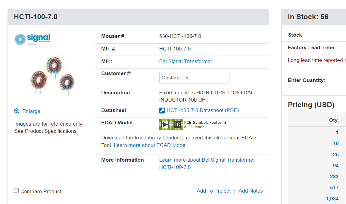

If you're going to pull (2 x 2.5 amps) through one inductor, I recommend you choose a part whose max rated current is at least 20% higher, namely 6A or more. Such as the 7A inductor shown below. Changing to two inductors (one L+C+DampingSnubber filter per regulator) would provide an even greater margin of safety.

Many, many thanks Mark. Much appreciated.
I acknowledge and accept that off-label use of your TUBA filter and reg comes with some risks/unknowns. But it's just such a nice, compact board that it cries out to be used in other setups. I will experiment and see. I am using Keratherm Red pads. And I'll test the voltage drop with a freshly calibrated diy millivolt meter. I'll go with 1.8V to be on the safer side.

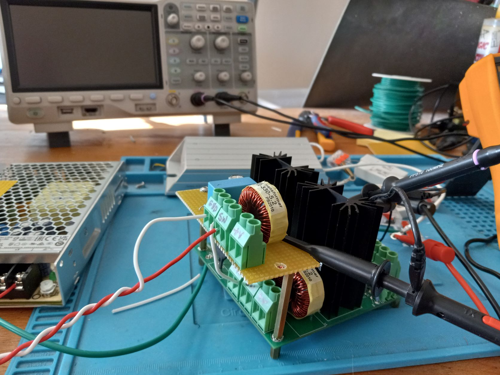

Here's a pic of my "Franken-Tuba", built for 24V @ 2.5A per channel with a separate hash filter for each channel. To get 24V output, I used 1K5 ohms resistors for R2 and R3. The filter and reg is paired with two Mean Well RS-150-24 smps each rated for 6.5A with adjustable output voltage of up to 26.4V.
If I can get cleaner scope traces, I will post some scope shots this wknd. I don't have fancy differential probes, so my first attempts at measuring ripple and hash noise were plagued by coupled interference. But I was able see a sawtooth ripple pattern out of the smps and after the hash filter (which wouldn't be expected to smooth the ripple, just eliminate HF hash noise), and then, most importantly, a somewhat fuzzy but flat trace for the dc output after the reg. Much if not all of the fuzz is likely coupled noise from the environment. This wknd, I will try to gerry-rig a poor man's version of differential probes using the "subtract" function on the scope - something I saw on EEVblog.
But long story short: it works! Very pleased. Many thanks again to Mark for sharing his design.
Edit: I now need to figure out how to modify the Thump killer circuit for 24V. I'll work on that next week.
@grataku: the 1084 datasheet provides the formula and method for changing the output voltage: Vout = 1.25*(1+R2/R1). In the Tuba filter, R2 is comprised of the series combination of R2 (or R3 in the case of the other channel) and the 1K trimmer pot; and R1 is 120 ohms. Since I wanted a regulated output of 24V, I solved for R2 and got approx. 2K2 ohms. Since the 1K trimmer can be adjusted from 0 to 1K ohms, I arbitrarily picked it's midpoint of 500 ohms, which meant I needed R2 and R3 values of about 1K7 ohms. I didn't have any resistors in that value on hand, but had a bunch of 1/2W 1K5 resistors, and so I used them. But to deal with the voltage drop across the 1084 reg, you'll need a supply of approx. 26V to get regulated 24V out. I'm not sure if the 24V Mean Well wall warts permit adjustment. As per above, my smps allows for up to 26.4V output.
cheers, Derek

I should add that for the purpose of the Vout formula above, R1 of the formula is R4 (or R5) on the Tuba board: 120 ohms.

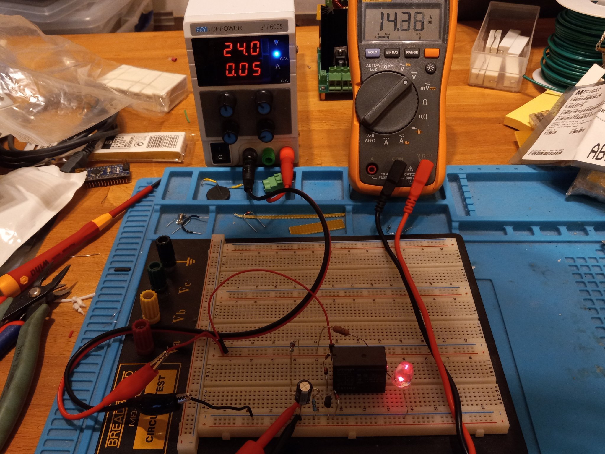

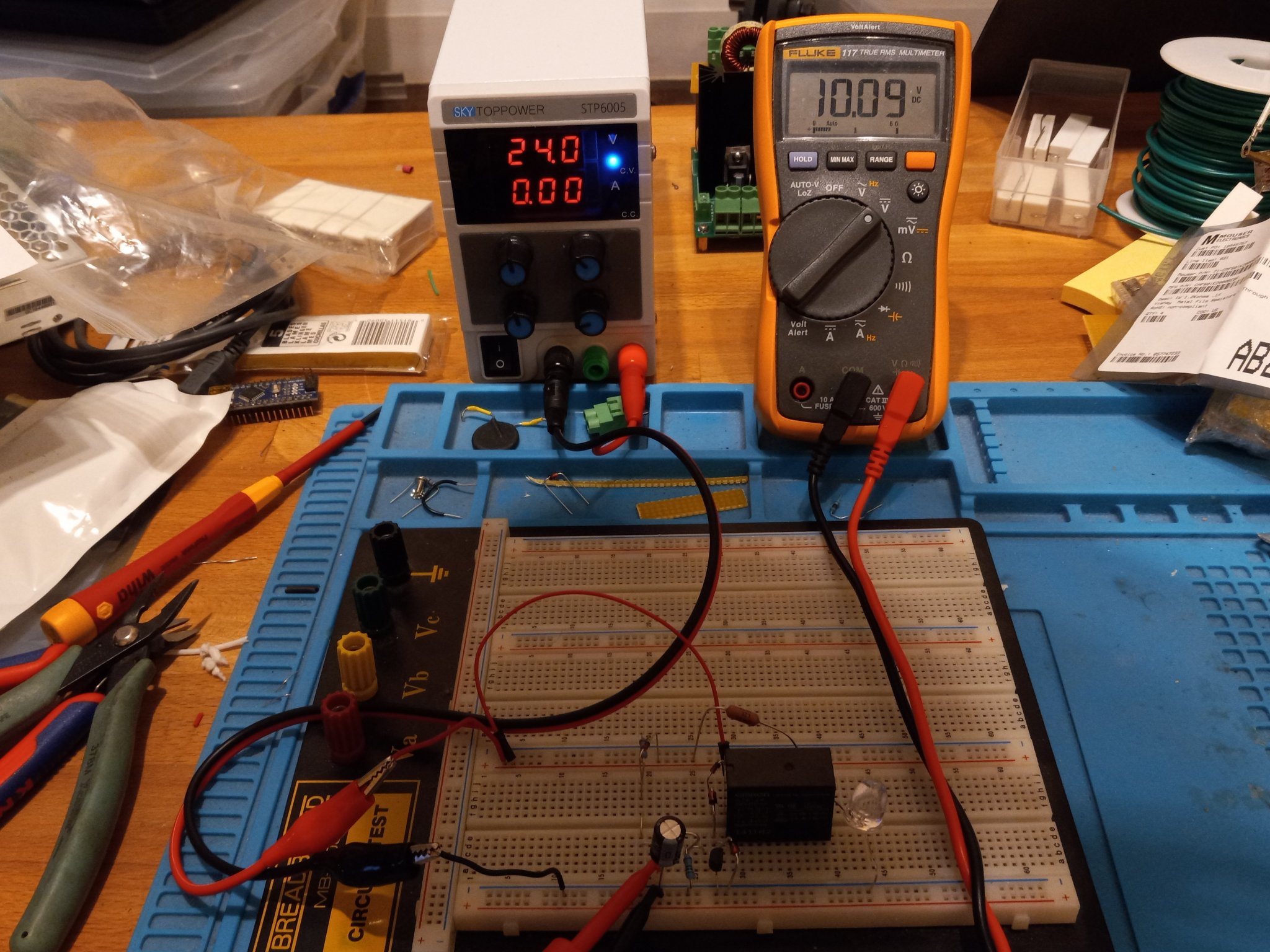

I had a fun and educational afternoon studying and breadboarding Mark's thump kill circuit and then modifying it to work with 24V V+. I think I managed to figure out its basic workings -- the only thing that confuses me is the purpose of the reverse diode across the 470K resistor that forms part of the first leg of the timer section of the circuit. My guess is that it allows the 33uF cap to quickly discharge (thus turning off the mosfet) on power down/interruption. If that's the case, am I correct in thinking that the cap drains through the grounded resistive divider that sets Vout on the 1084 reg???
I used an LED to indicate when the relay switched "on" (you can also just listen for the click sound, but that's difficult to capture in a photo ... 😗). After testing the circuit with stock values @ 36V to make sure I breadboarded it correctly, I modified and tested the circuit at 24V by replacing the stock 12V zener in front of the relay coil with a piece of wire, and replaced the stock 24V zener that feeds the gate of the mosfet with a 12V zener. With the 470K forming the first leg of the timer circuit, I get a turn on delay of about 13 seconds or so - which is fine by me.
Here are a couple of pics. The meter shows the voltage across the 33uF cap. It was interesting to watch the cap charge -- quickly at first and then slowing, as one would expect.
Am I missing any other needed changes?
cheers and thanks, Derek

D1 discharges C7 if some dunderhead decides to turn the amp off by cutting the AC mains, instead of flipping the power switch to its OFF position. They beg Nelson for a thump killer, he designs one, they build his thump killer PCB, they upgrade to the not-inexpensive Tuba board with its extra fancy thump killer, and then they completely circumvent its functionality. Ugh.
When the mains is cut, both amplifier channels continue to draw 1.6 amperes of class-A bias current, for as long as they can. This discharges the supply rails right quick like.
Many thanks Mark for the explanation. Not sure if the "circumventing its functionality" concern was directed at me. Have I done that? I was aiming for the opposite: to preserve all functionality, but at 24V supply. Although I did wonder whether I should reduce the 43V zener protecting the mosfet to a lower value (e.g, 30 to 32V) in light of the lowered V+....they upgrade to the not-inexpensive Tuba board with its extra fancy thump killer, and then they completely circumvent its functionality. Ugh.
No, the member who uses his "Home Automation" system to cut the juice to his audio rack. D1 is a last ditch attempt to make THAT thump smaller.
