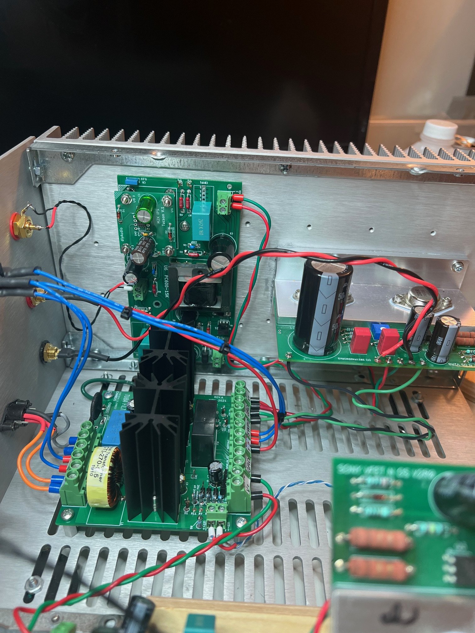

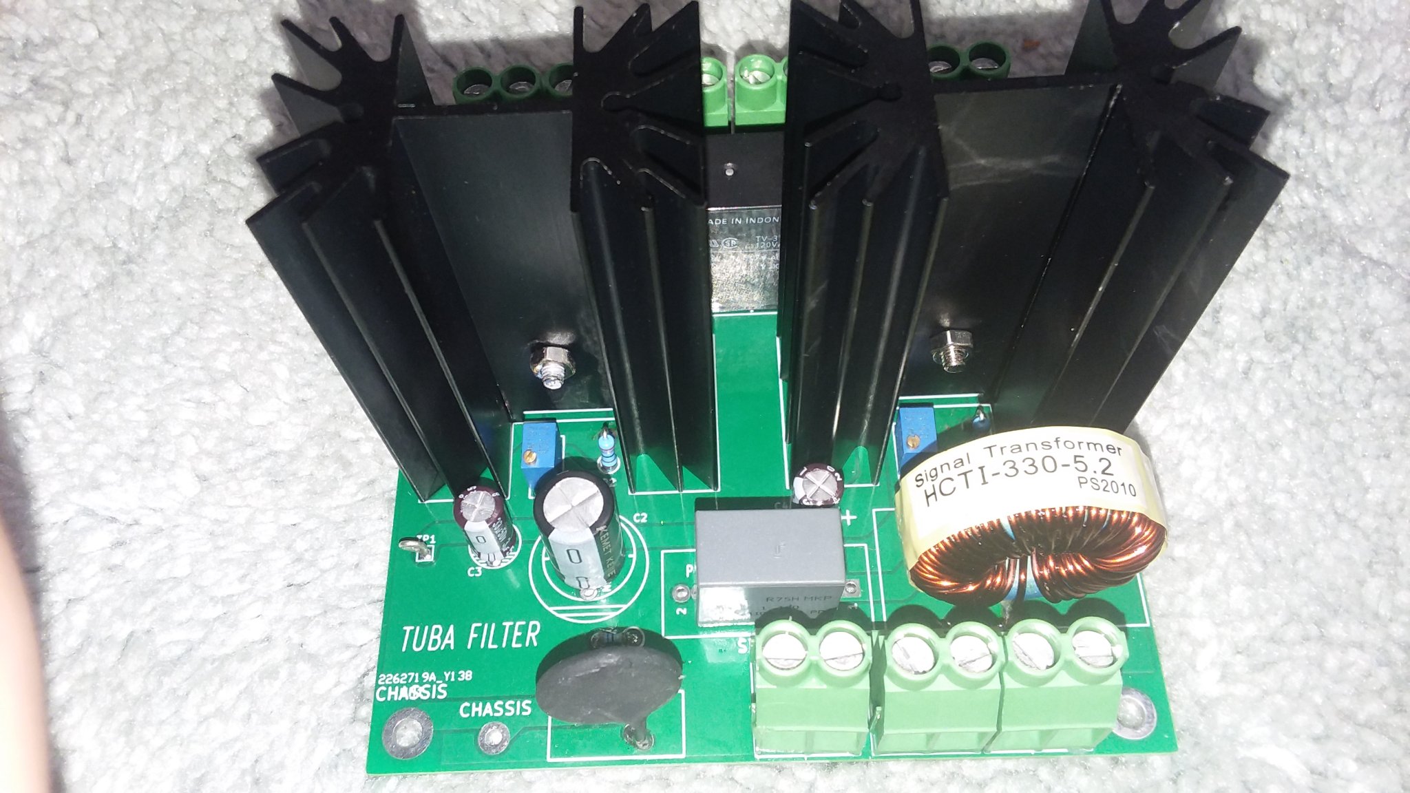

Here's a few... I will be setting and testing tomorrow.

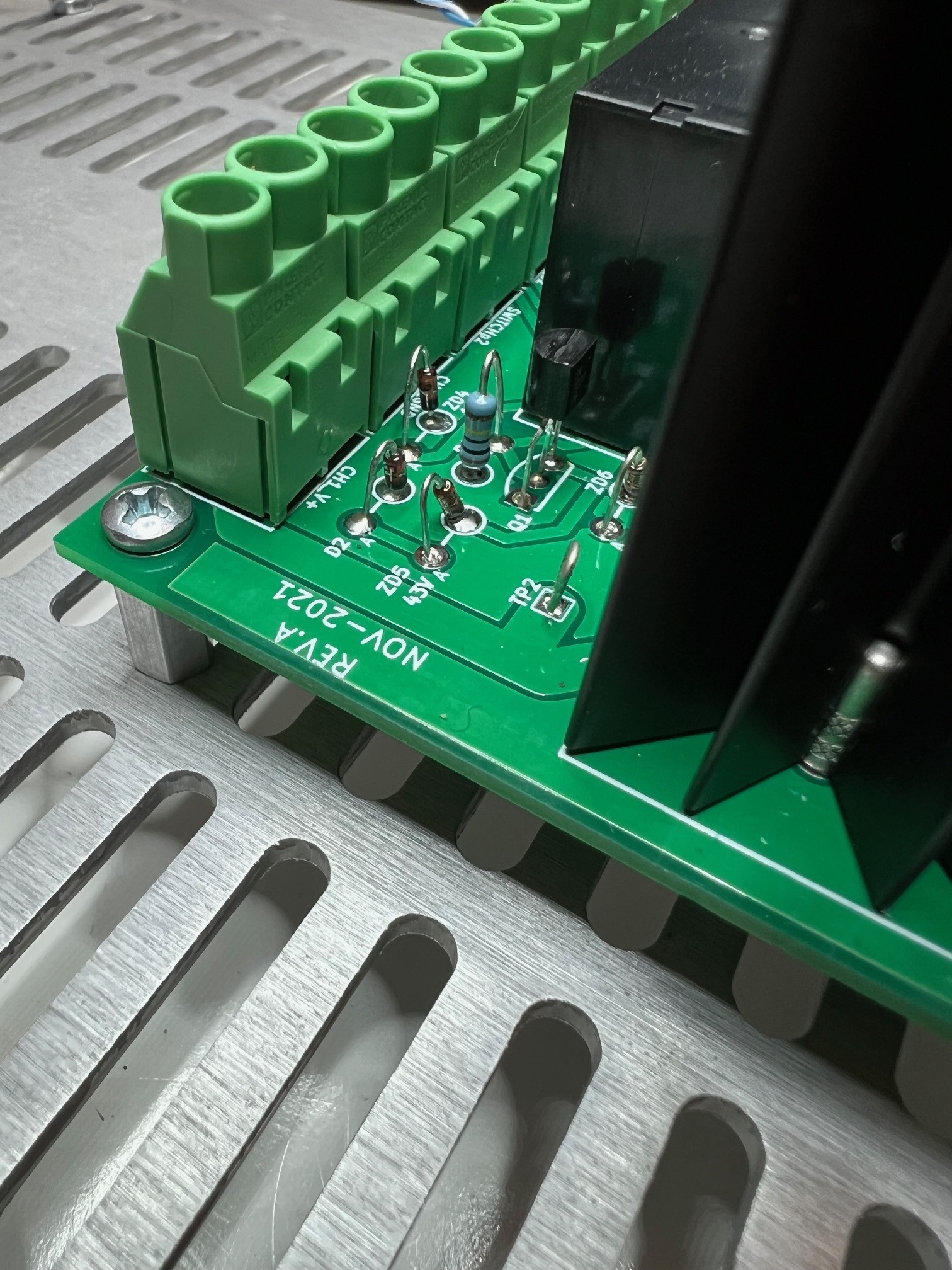

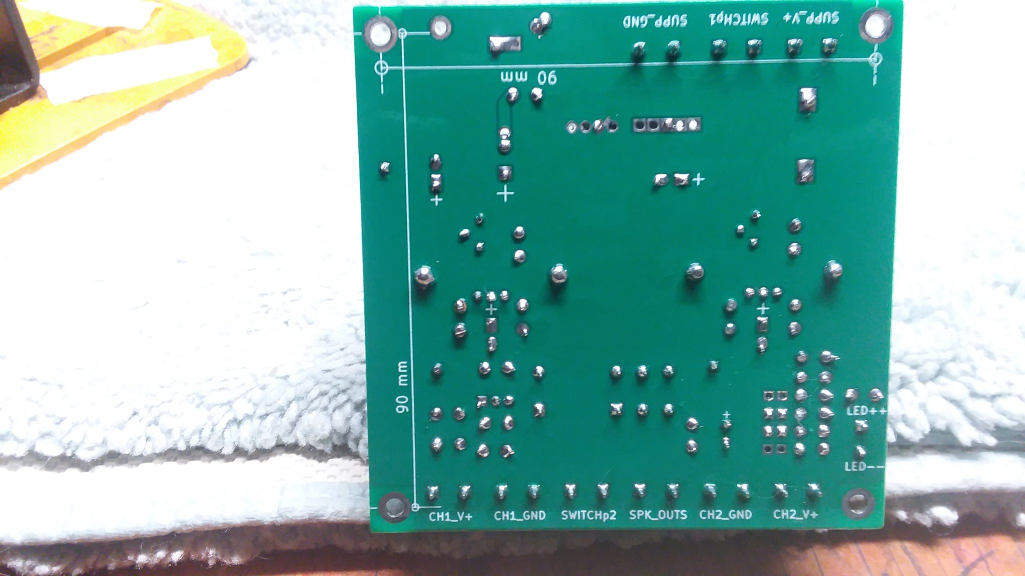

A couple thoughts; the pads for the variable could be larger as could the ones for the stakes on the heat-sink. You can see I just made a nasty big solder ball on the stake for stability. Also, you can see where it's not a good idea to bend the 5W diode when mounted flush. A slightly larger hole for the stake hole too. It's just able to fit the diode, and makes removal precarious with regards to pads. This is an older design from Mark, but if you are planing on having a board made, you might consider these few changes.

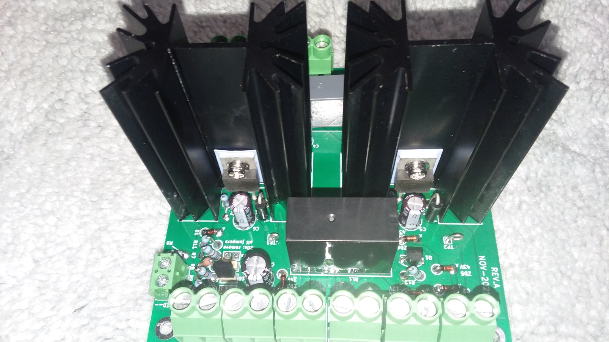

I got around to testing the Tuba today, something isn't right, I have 35V on the outputs and a drop of 1v across the test points, and VR does nothing. I checked all the diodes and resistors, all appears to be right there. All the caps are correct. The relay works as it should. I have LM1084 in place of the LD1084, as far as I can tell that should be okay?
It's a pretty simple circuit, but I'm missing something.
I followed Marks power up and test procedure too.
Update & Warning!: The LM1084 is not a direct swap, for those that can't find the LD1084. I'm sure it would work with some tweaks, but not as designed. I found some LD1084s I didn't know I had and swapped them in... adjustment perfect, no issues at all.
The holes are pretty close to the component size on these and I pulled a trace and had to pull a cap and solder that pin from the top. Hint: if you have very close ID/OD I found it best to heat, or even add solder then heat all and pull the part. After the part is removed, you can go back and clear the holes. 😉

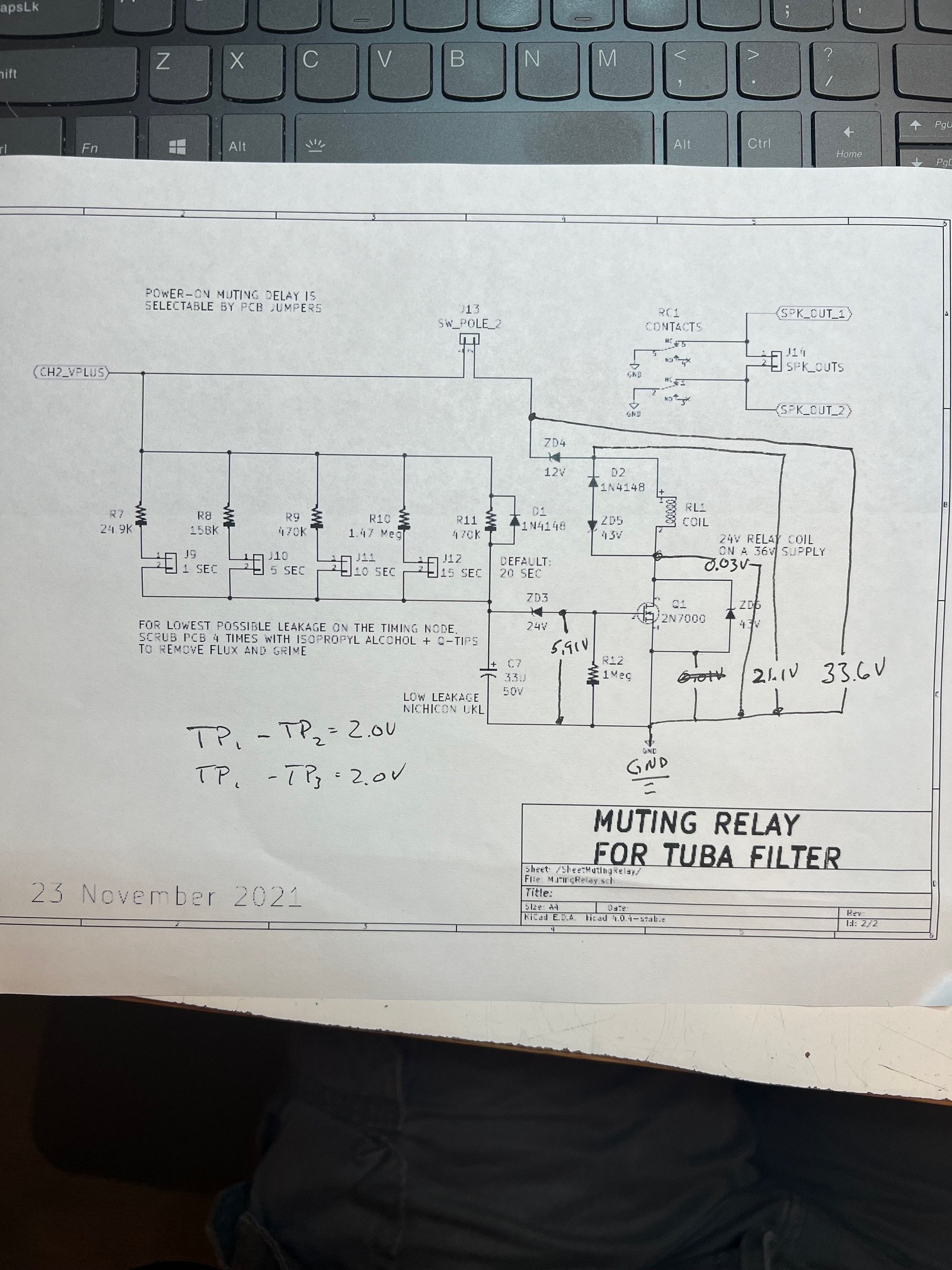

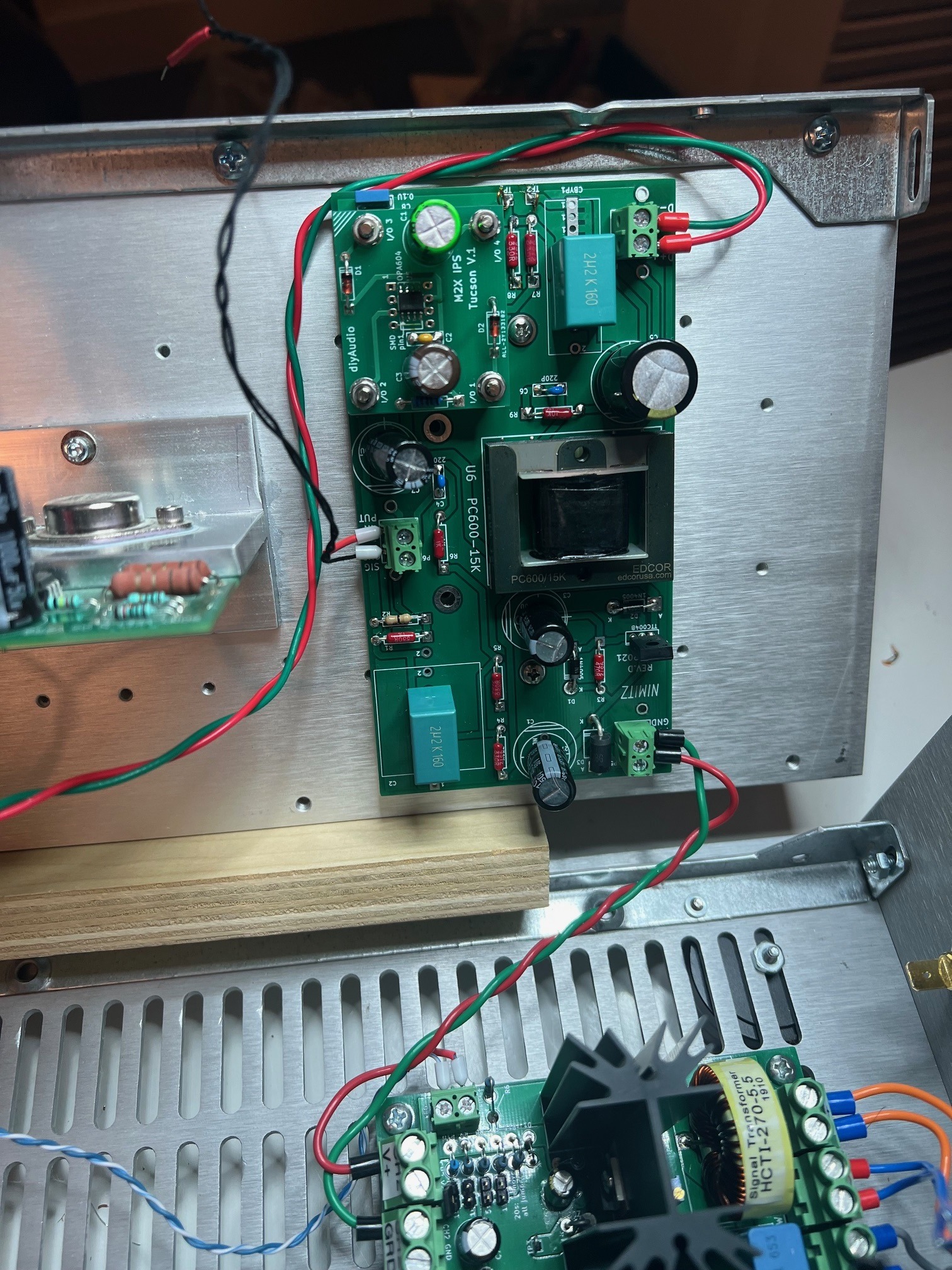

I hope that some of the successful builders might help me out with an issue with my TUBA. Was able to build and successfully dial in the 2.0V at the respective test points and have output voltage at 34V. As I was changing the power supply also modification to my N channel Lottery VFET also added a Nimitz with Tucson card to just verify that everything was functioning. On test speakers everything works and the tucson sounds like it did on the M2X.
The start up thump was not audible with a 10 sec delay although I had the DC offset started about 15mV at relay click and climbed to 852mV as per my Fluke 87 min max function. Offset slowly declined over several min to 3-4 mV. There was NO turn ON thump. Music was great.
THE problem is I have big Turn OFF Thump. It is 85dB as per my SPL meter on audiotools on iphone. Measures as per my Fluke at 667 mV Right channel and 527 mV on left channel using min max function at speaker terminals.
I Measured voltages in the relay circ rel to GND and see attached.

5. Pics of Nimitz show a bonehead error with 330 ohm Resistors instead of the 330k ohm resistors. Those have been replaced and the amps behavior is noted above. Didn't change the Turn off thump.

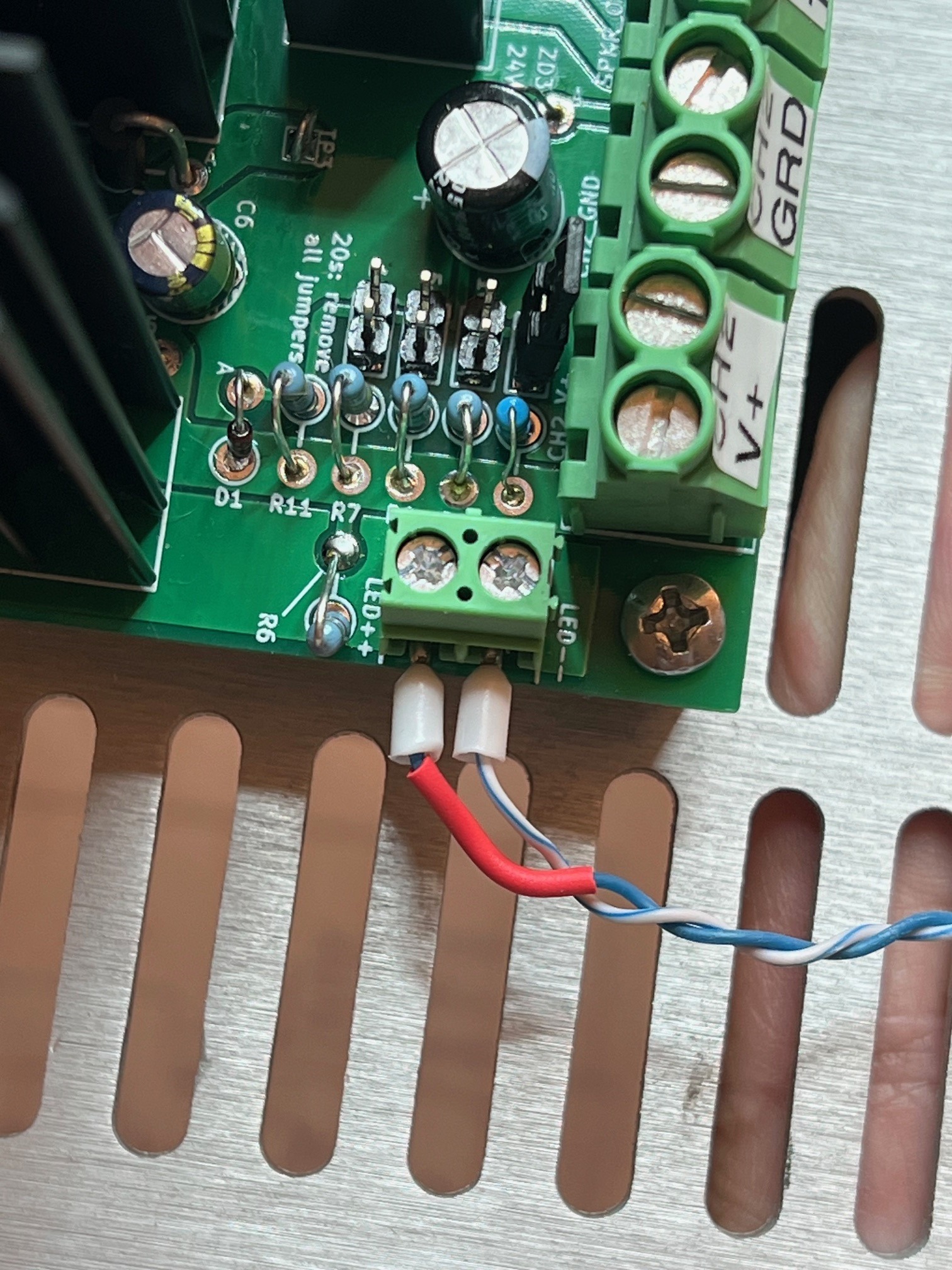

"Post photographs of your power on/off switch and its connection to your SMPS filter PCB. Are you using a 2-pole switch having four or more terminals?

It is surprising to learn that your Tuba-powered amp has a thump at turn-off. If you look at the circuit schematic (attached to #166 above) you'll see that the on-off switch directly and immediately removes the 653-G2R-24-DC24 relay's coil current (through connector J13). When the relay coil current immediately disappears, this causes the relay's armature to release within 5 milliseconds according to the relay's (datasheet). When the armature releases, the relay contacts short out the loudspeakers. So if the board is working correctly and wired up to the switch and to the speakers correctly, you are getting a turn-off thump in the first 5 milliseconds after the switch event. That's unexpected and surprising.
I'd recommend that you disconnect the SMPS from the amp (unplug the DIN connector), wait 60 seconds, and then carefully verify that the on-off switch is wired to the Tuba board correctly. Verify both poles of the switch. Check both ends of all wires visually, and double-check with your DVM on continuity test "buzz" mode. Also verify that when the switch is in its "off" position, the two pins of connector J13 do not have continuity. They are an open circuit.
Then carefully verify that the speaker terminals are wired to the Tuba board correctly. Check both ends of all wires visually and double-check with buzz testing. Also verify that each pair of speaker binding posts is solidly shorted together by doing an ohmmeter test instead of a buzz test. It should read 0.0 ohms.
My cousin Jimmy Jim-Bob Boudreaux, who lives in Fordyce Arkansas, would probably suggest that you consider temporarily trying a voodoo experiment. He'd say maybe it might help and certainly it can't hurt. Temporarily add at least 330 microfarads more capacitance between CH1_V+ and GND, and another same size cap between CH2_V+ and GND. 50 volts rating or higher. Maybe just using alligator clips and masking tape to insulate everything. Why would he pick that number of microfarads? Because it's ten times greater than what's on the board right now. If 33 is too small, 330 is likely to tell you so.

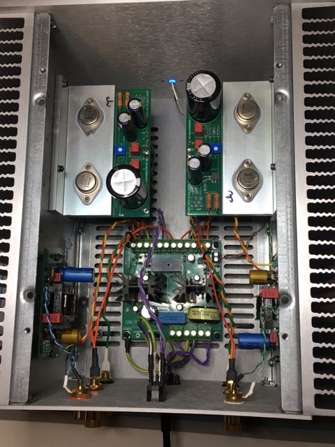

Another Tuba up and running in a Sony N-VFet. Works like a charm.
I had boards produced using the gerbers in Post #1 with 70m um (2 oz) copper, per Mark's suggestion.
I didn't have any troubles getting 2.0 V across the regulator, although as predicted after connecting it to the amplifier the voltage dropped (in my case to about 1.5 V). I let the whole thing soak and adjusted the voltage up a few times - after an hour or so the VFet was 'warm' and I didn't note any more fall off. I also reset the drain voltage on the P-mosfet because it too had fallen off a bit (13.8 V rather 14.0 V). After that everything seemed pretty stable. Here is a picture of the internals:
There is no thump at all (now) and the timing circuit is just about bang-on on the 5 second delay.
