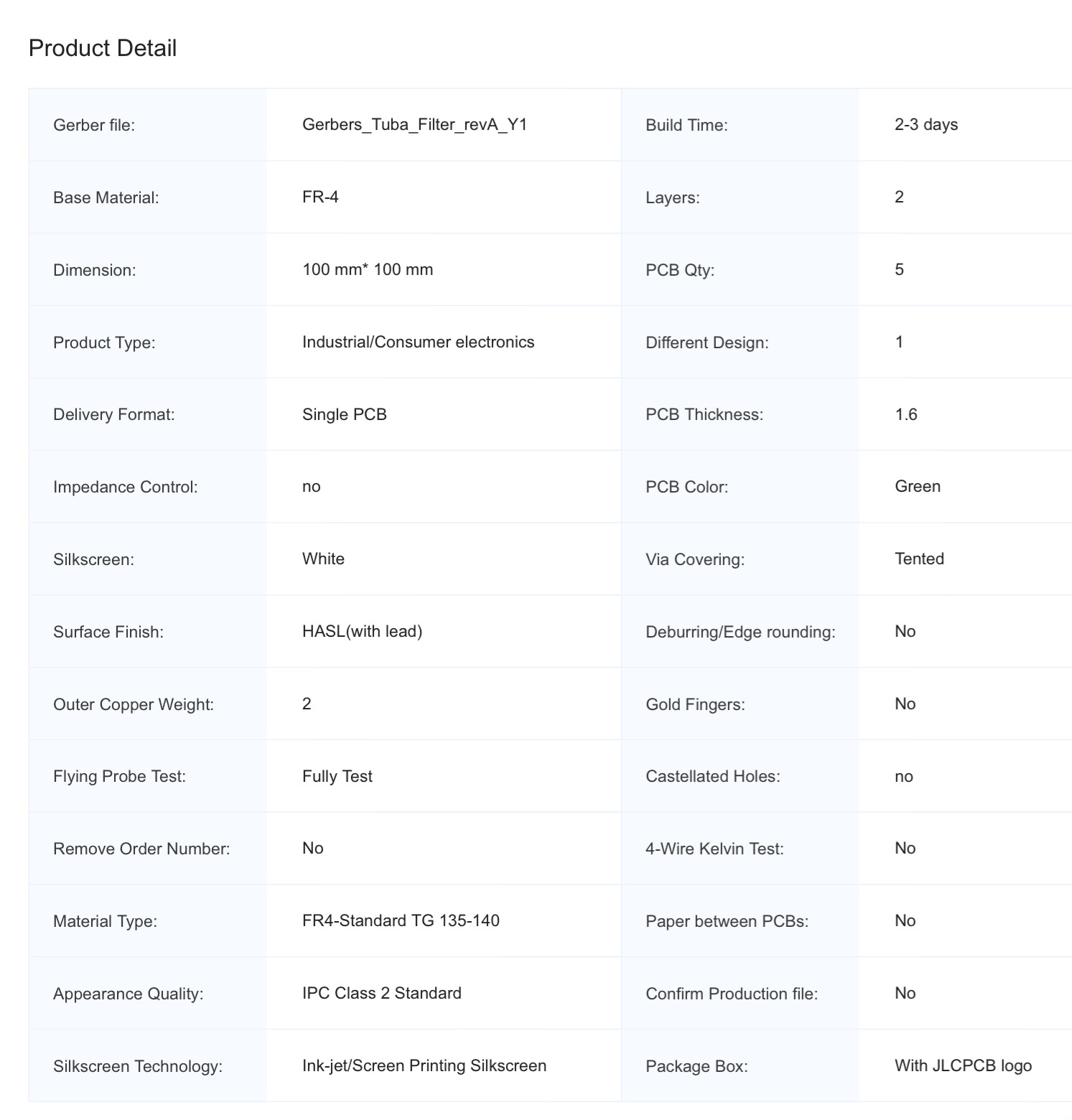

The pcb order is already in my cart at jlcpcb. It’s my first time ordering a pcb, I’m pretty sure that everything is ok but if you could confirm that all the options on my order are ok it would be great.
Thank you Mark

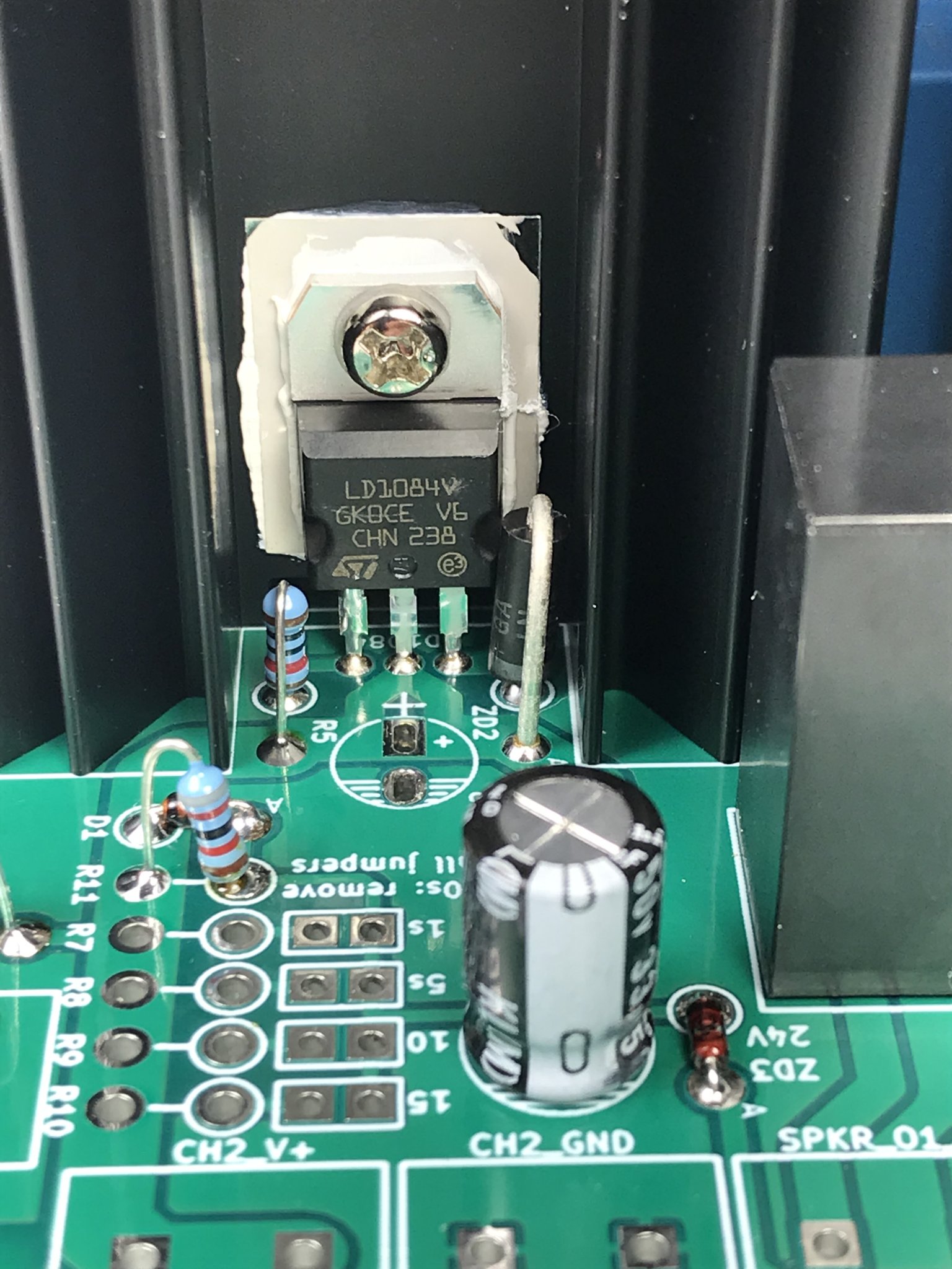

Hi Mark, I have mounted zd1 and zd2 on the pcb oriented so that they are not too close to c5 c6, but now their body are touching the ld1084. Do you think it could be problematic?

I did the same thing and the body of the diode was going to be on contact with the heatsink. I didn't like that option, so I removed it and placed it the other way round. It was lucky I bought extra diodes as you can not switch it once you cut the leads. Do I think it's a deal breaker? No I do not, but it's not optimal in my book. I would issue a caution here as most of the holes have extra room, these do not. It would be easy to hose the copper inside the whole by removing it without serious consideration and proper tools.
