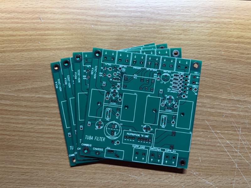

I have completed one of my Tuba filter boards, no magic smoke and the relay clicks on and off. I plan to connect the FE and OS boards later today.

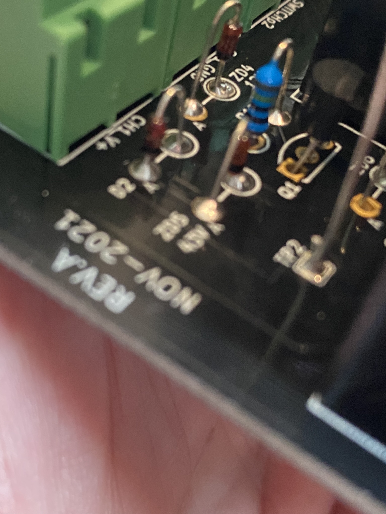

I flipped the diode today, and I was glad I managed it. Replacements wont be here until Tuesday.

I figured that if I had to order boards from gerbers, and source the parts, I would start with the Tuba board.

Guess I’m back to checking the MOSFET. The relay audibly clicks with power on, but does not release. I guess I could have damaged the diode when flipping it, but I don’t think I got it hot.
