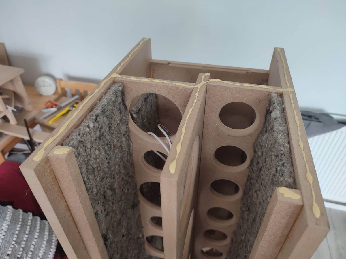

Kinda sounds like you overstuffed the cabs. What did you stuff them with, and how much?They sounds very bright, pain sparky high range, with poor mids and average low end.

I forgot to mention: enclosure material is a 18mm MDF, fully braced as on KJF plans, damped with rich wool felt 16mm thick.Kinda sounds like you overstuffed the cabs. What did you stuff them with, and how much?

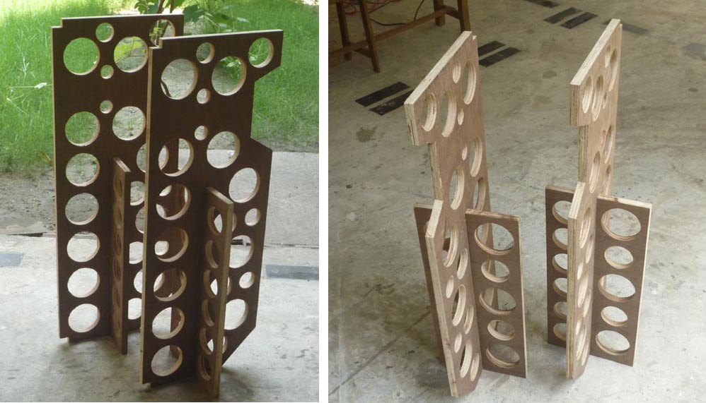

Here is an example of simple braces for a SuperPensil. Likely insuffucent for MDF.
But i doubt thany issues would not casue your issue.
I would check out what Jeff said. Typically people seem to settle on about ⅔ the specified damping. And, all too often, we see the damping insufficiently teased. Bernie just built a set of smaller A11ms Pensils and complained that tesing the acoustastuff took 3 hours.

The pensils are not designed to be lagged but stuffed, with the density adjustable by the user (that was a specific feature of the design & why they have a removable rear baffle, to facilitate tuning in that way). 'Poor mids and average low end' doesn't really tell us a lot though since we don't know what you mean by either. Lack? Excess? Ringing? Something else?

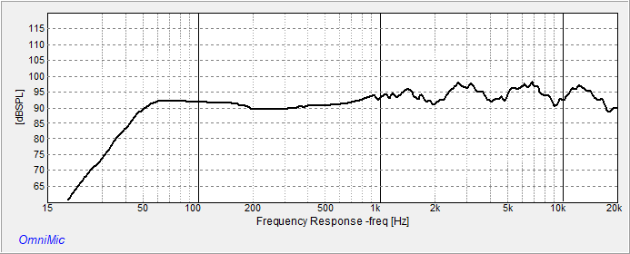

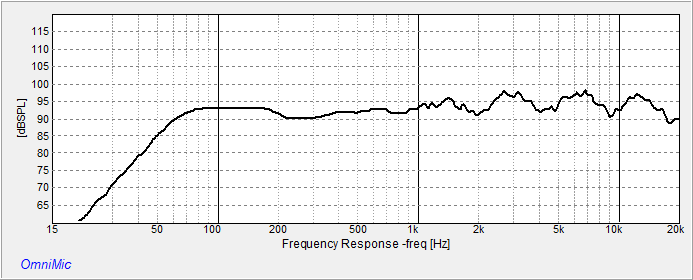

Curious, Vb = ~2.377x A12's Vas, which of course nothing wrong for the alignment type, but combined with a < 0.3 Qts, seems like the OP's "poor mids and average low end" (high roll off corner to a tuning plateau my assumption) is to be expected if not driven with some form of high output impedance, so was it designed for other than the A12?The pensils are not designed to be lagged but stuffed, with the density adjustable by the user (that was a specific feature of the design & why they have a removable rear baffle, to facilitate tuning in that way).
No, both were designed for the 12P, assuming an amplifier output impedance + wire R falling roughly into the 0.5ohm - 2.5ohm range as the 12P was done leaning in the over-damped direction & MA wanted something to suit SET etc. users without going OTT in that direction. FWIW, as designed, quasi-anechoic responses attached. Slightly different conditions; IIRC (it's a few years ago now so don't quote me 😉 ) Pensil12P nearfield was spliced in at 450Hz; from fallible memory the larger SuperPensil12P nearfield was blended in over a wider window as it was done at a different time / location. My own preference was always the smaller for its higher gain -it's basically the intended alignment with the latter being an optional extra for those who wanted an extra 10Hz or so extension. Loses out a bit in the upper bass / lowest end of the midrange (but will likely to an extent depend on room behaviour).
Thanks for the 'reminder'! Finally remembered overnight we had some conversations re the pioneer's 'one size fits all' cabs with these being the results. Oh well, at least I finally remembered........
It would appear that KJF missed the memo on that, as their kit is supplied with both the lagging AND ployester stuffing, even though there is no mention of lagging in your design desription.The pensils are not designed to be lagged but stuffed.
jeff
Hell, I can't remember last night, let alone a few years back. 😉Thanks for the 'reminder'! Finally remembered overnight we had some conversations re the pioneer's 'one size fits all' cabs with these being the results. Oh well, at least I finally remembered........
Stefan likes to provide a few extras; no harm in it, providing the 'user adjustable' mantra is kept in mind, which in fairness isn't always easy to do with kits, since many kit buyers tend to want something relatively plug & play.It would appear that KJF missed the memo on that, as their kit is supplied with both the lagging AND ployester stuffing, even though there is no mention of lagging in your design desription.
I second the suggestion to check stuffing. My regular (not super) 12p Pensils sound great and learned something years earlier when I had the same problem with the A7m Pensils....to much un-teased stuffing. I removed almost half of it and when I really teased up the remaining stuffing, it came up close to the bottom of the driver and sounded so much better than before...
