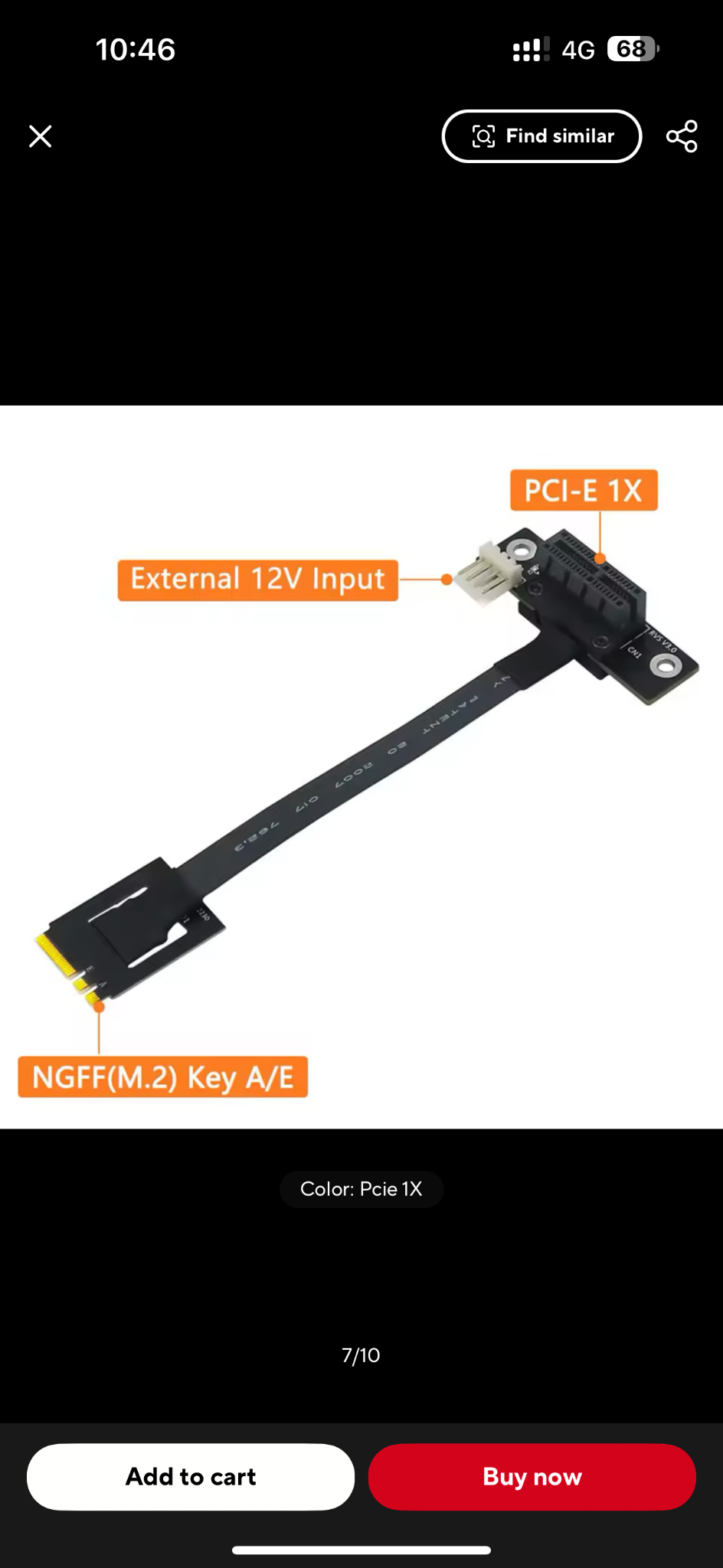

I am trying to install a firewire PCIe card onto the Intel NUC5CPYH mini PC via an adapter connected to the M.2 slot (photo attached). I intend to use a firewire dac with this set up. This slot was previously used for a wifi card which was working ok. I understand that it is compatible with PCIe 1X standard.
The firewire card is Syba-pex30016 with TI XIO2213B chipset.
I have connected the card and provided external power into the power socket of the card.
The problem is that the NUC does not recognize the firewire card at all. In the bios setup of the NUC, it says nothing is populated in the M2 socket. Nothing show up in device manager of Windows 7.
The firewire card and the adapter are brand new.
I am wondering if anyone could give me some advice where to check for problem.
