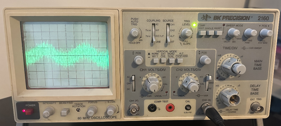

So you have no signal on pin-3 of IC2, therefore you will have no reverb. Keep moving backwards until you see the signal, so you know at what point it disappears. Is there signal on the 'top' side of C16? How about at the junction of R20/R23?With the amplifier on and a 1khz sine wave playing through it and heard through the speaker cab, I placed a scope ground on the chassis and the other lead to the end where C16, C17, R24, and pin3 of the TL071 join.

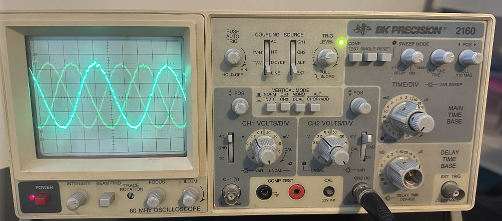

...the end result on the scope for this start of the "Reverb Drive" was what I will refer to as low mv noise and not a sine wave.
Broken solder joint, bad component... something is stopping the signal from reaching IC2.
Thanks Merlinb! I think we are getting somewhere.So you have no signal on pin-3 of IC2, therefore you will have no reverb. Keep moving backwards until you see the signal, so you know at what point it disappears. Is there signal on the 'top' side of C16? How about at the junction of R20/R23?

The above is the scope result when connected to R20/R24/C14 which is after the decoupled v2a and the intersection of R15/R17/C12 (aka output of IC TL072 which is just after the fx loop and before the next gain stage at V2a. Looking good! Note the old scope in real life looks like this sine wave is surfing from right to left. So things are looking good basically before the reverb circuit and even after it (see below).
The above is the the scope at connection R19/20/21/22 which is after the reverb drive and recovery. To me this is good. It is a mucher lower amplitude wave but that signal path to skip around the reverb through the 2.2 mega ohm R20 is intended to squash the signal.

As described in the original post, I don't get any waveform R24/R25/C16/C17 (aka input of IC2 TL071). I also get no waveform above C16. So the signal disappears between R23 and C16.

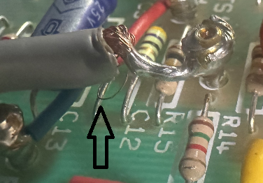

1) While reviewing things more I found this "fun" item. The isolation wire that connects the send/return fx loop which is located on the second PCB (power amp) back to the preamp PCB had one stray wire touching the intersection of R15/C12/R17. In the photo the stray wire looks tinned, but its plain copper.
By pushing that out of the way did not help the situation, but that likely has been there for 30 years, yikes.
2) In the above the waveforms that were received were not affected by the standby switch. I believe that is because the standby affects the power tubes and not the preamp ones. If however I should not have received a waveform while in standby please make that known.
