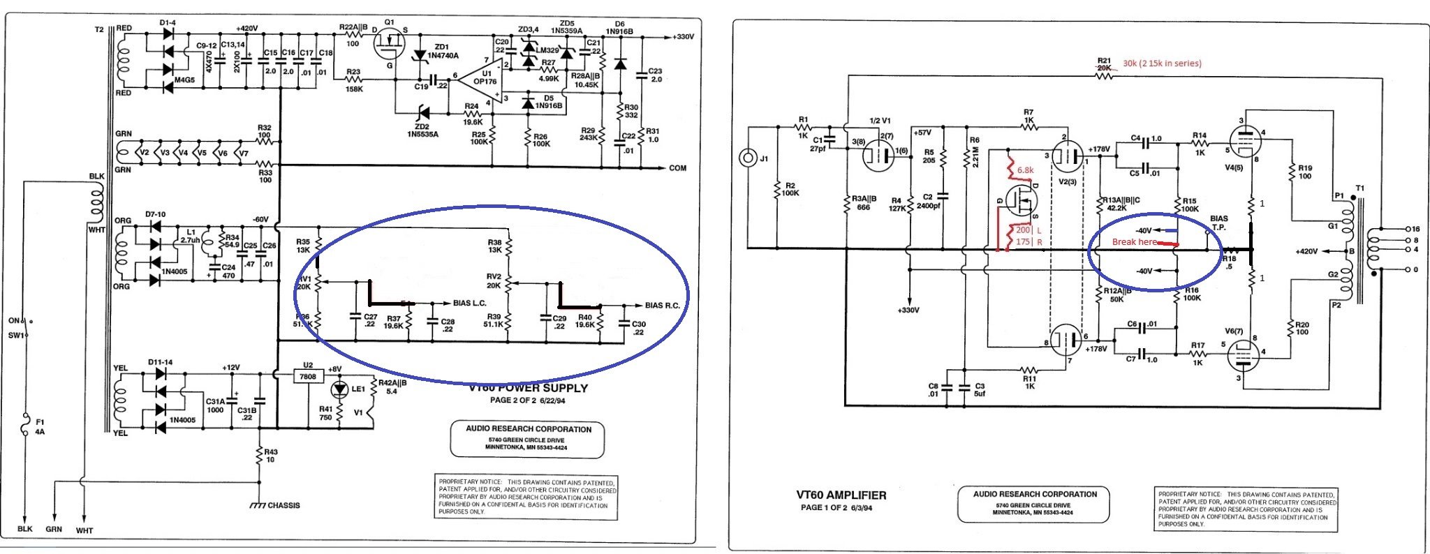

So I've found myself elbow deep in rebuilding this old arc vt60 amp for fun, and as an opportunity to learn more about tubes and how all this stuff works, so I appreciate commentary.
So this amp uses a single bias trimmer for each pair of output tubes. I would like to add individual adjustment, among other things. I've managed to find a few different ideas, and I'm hoping someone can set me on the right track.
1.) Duplicate the bias adjustment circuit, and break the connection between R15 and R16, eliminate R18, add two new 1r resistors between each cathode and ground. (Blue circles on schematic)

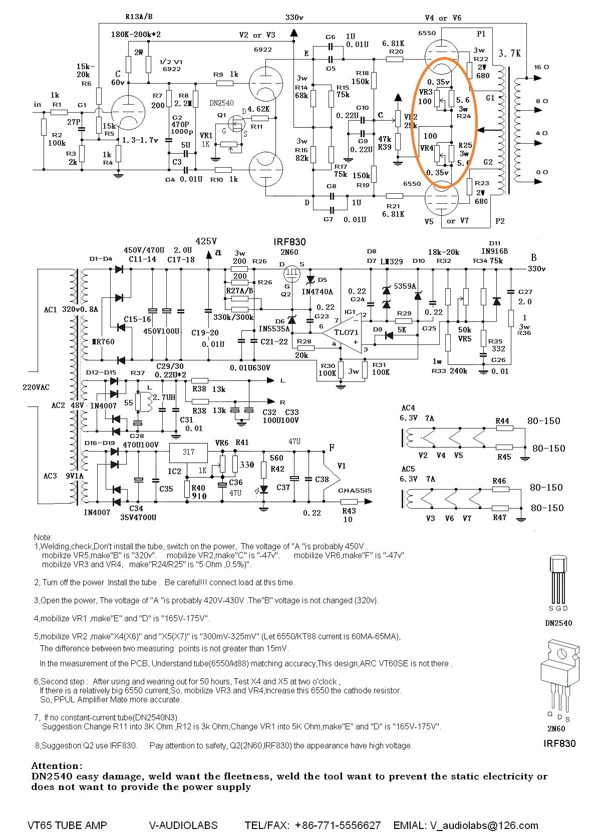

2.) Add some cathode adjustment, like they did in the vt65/clone amp, 5r6 with a 100r trimmer. (Orange circle on vt65 schematic)

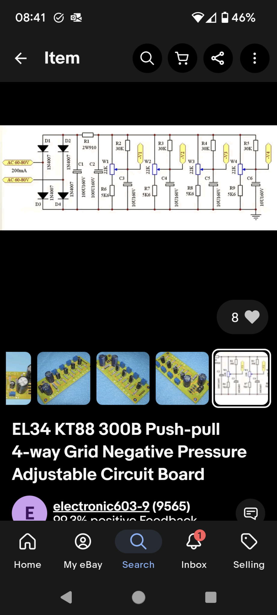

3.) Order and play with something more esoteric, like an AB-Qi module.

I might suggest something similar to option 1 but implemented as a bias/balance circuit arranged such that if the wiper of the pot fails open than the tubes gets full negative bias voltage for a fail safe feature. An individual bias circuit is shown on the Valve Wizard page and shows how to make it failsafe.
http://www.valvewizard.co.uk/bias.html
I have used the auto bias boards like the ABQ and they work fine but you'd have to mount it somewhere and that might be difficult.
I'll give that a read, thank you! The wiper coming off the pot and turning the tubes into lava was something that made me a bit nervous, too.
The bottom cover is perforated, so mounting a few standoffs would be fairly easy, and there's a decent amount of space under the board where some tricks could hide.
Edit: The valve wizard page, it would seem that all I would really need to do is add a resistor across the adjustment pot.
If you go the AB-Q route you may need a higher bias supply voltage since you get some loss in the board and the slow start function wants a higher negative supply to keep the tubes closer to cutoff for the warmup period. Changing the bias supply to a voltage doubler might be an option.

It adds a bit of computational complexity. Since the VR can be any value in parallel with the fixed resistor, you don't know what the actual cathode resistance is for the calculation with the voltage until you turn off the amp and read the resistance. So just setting the voltage to a fixed value will not give you the cathode current. It's trial and error with multiple calculations.
Reactions: DrDyna
I was wondering about the added math and not knowing the resistance in use until it's already set. I considered adding yet another resistor in series to serve as the test point, but now the bodges are getting crowded. 😛
