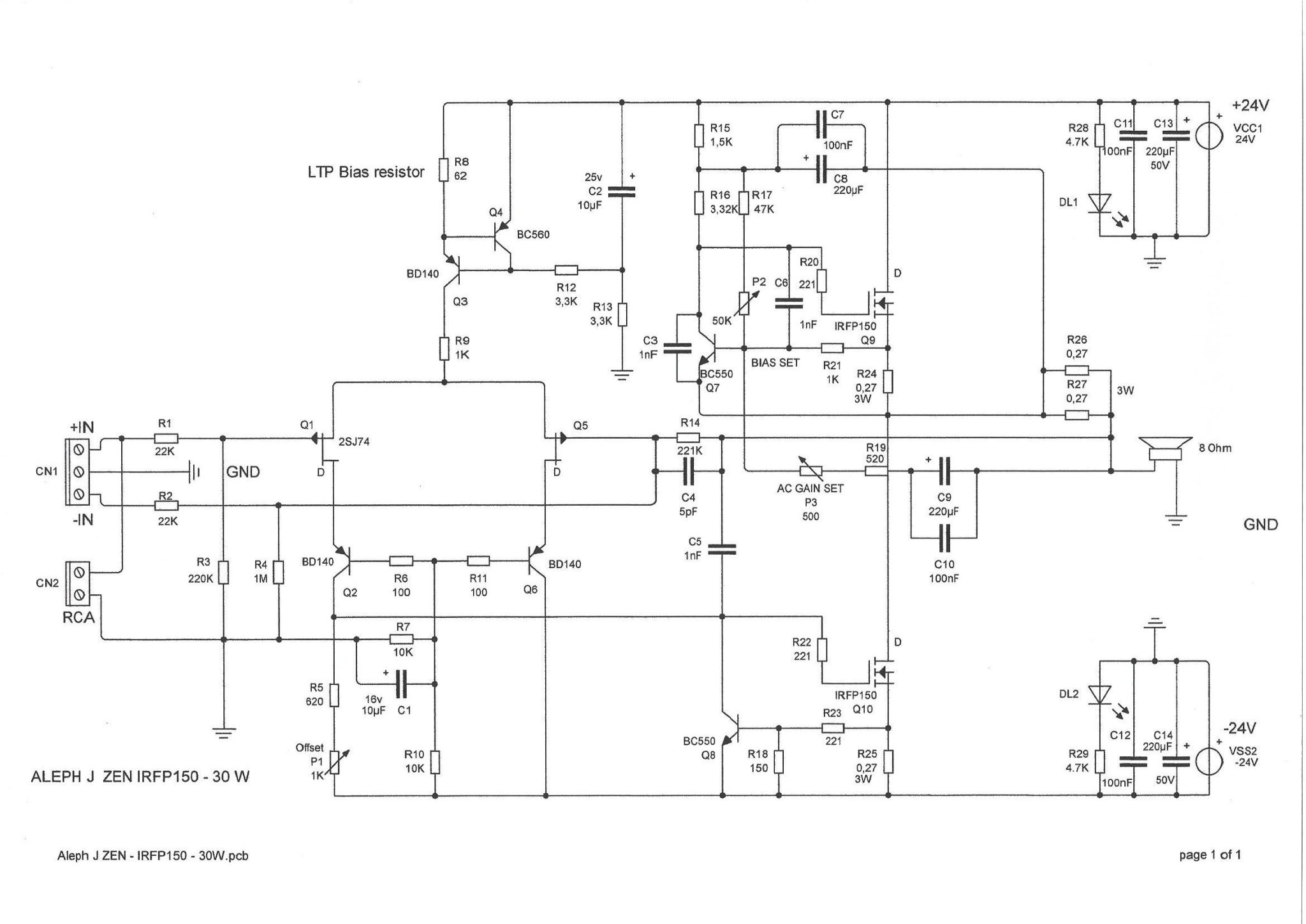

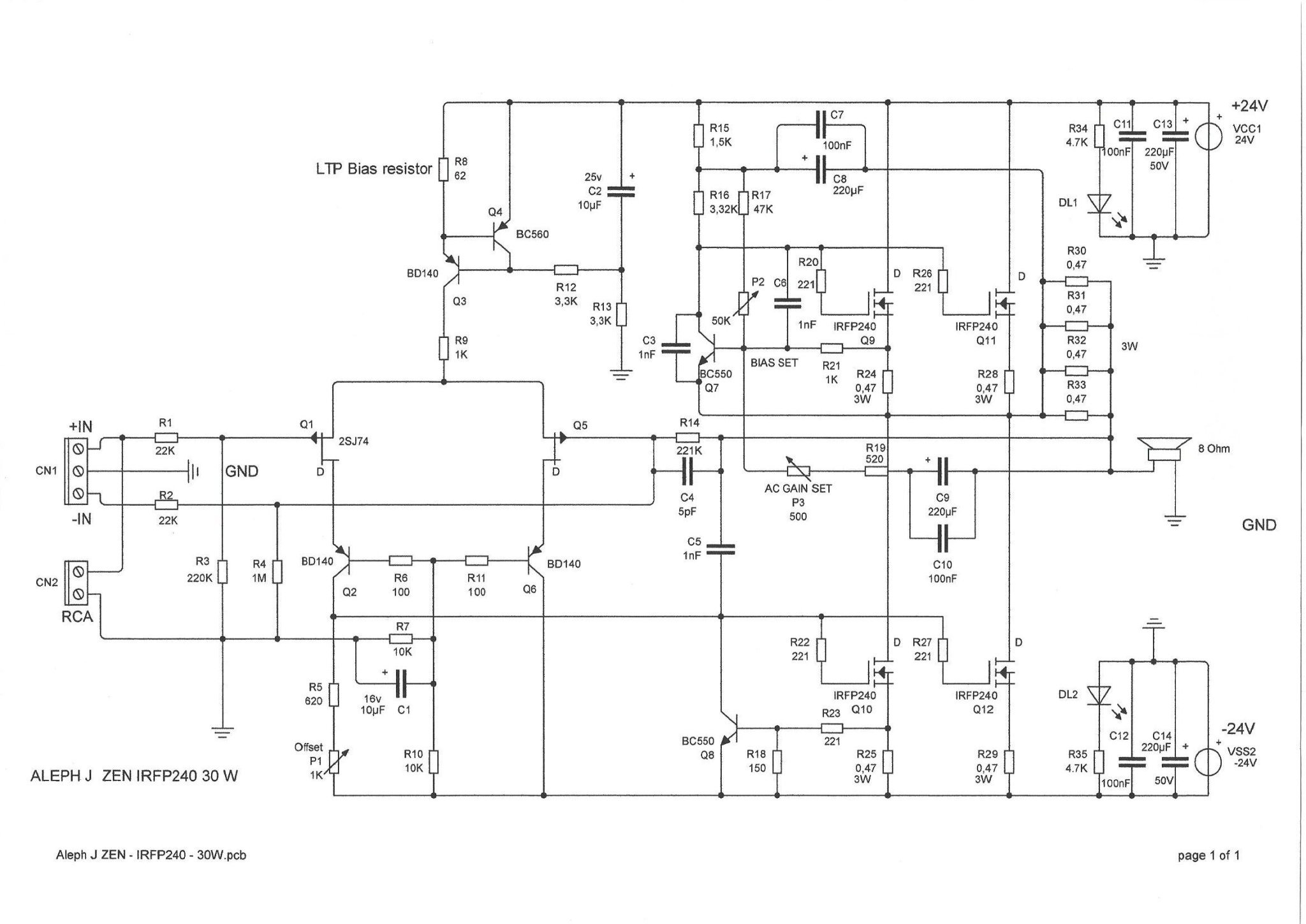

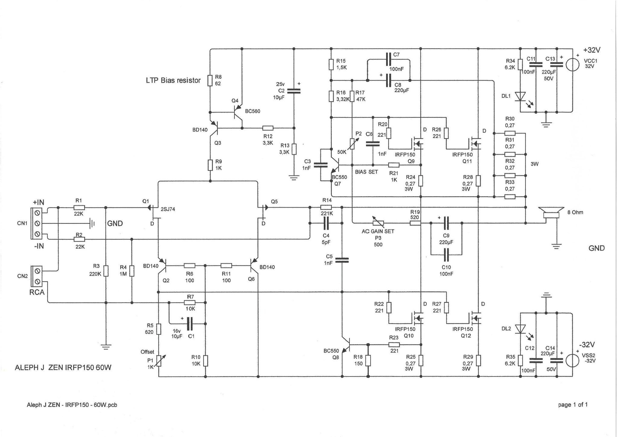

Hi!
I made three types of wiring diagrams possible only to the precious advice of Zen Mod
1) Aleph J ZEN - IRFP150 - 30W
2) Aleph J ZEN - IRFP240 - 30W
3) Aleph J ZEN - IRFP150 - 60W
They have the front end as their common denominator.
1) type 1 is a 30W and has the advantage of being able to avoid MATCHING with IRFP150 that is equal of 2 x IRFP240 inside .
2) type 2 and 3 use the same PCB layout for both 30W and 60W (only the power devices, PSU and heat sink obviously change for 60W), both 24V to 32V RAIL able to operate.
Many thanks to Zen Mod
Antonio

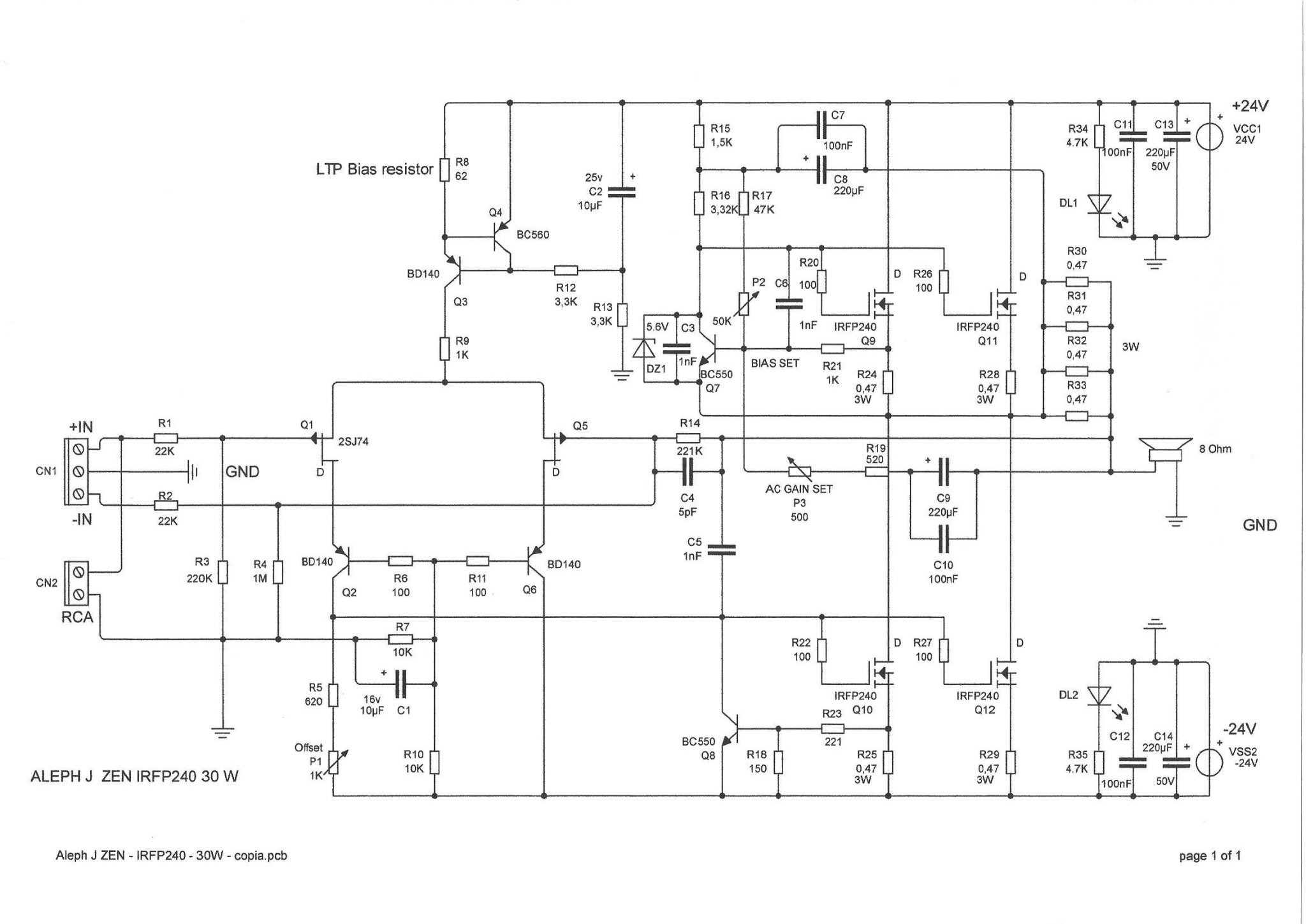

Hi Alex ! thanks for your advise
Diagram updated!
1) Added DZ1 5v6
2)100R JFet gate resistors change
3) P3 is still there but I only need it to fiddle around and see on the oscilloscope what happens in real time.
Immediately afterwards it will be bridged and the definitive value of R19 will be adjusted.
As soon as ready I will share both the Json file and gerber.
Antonio

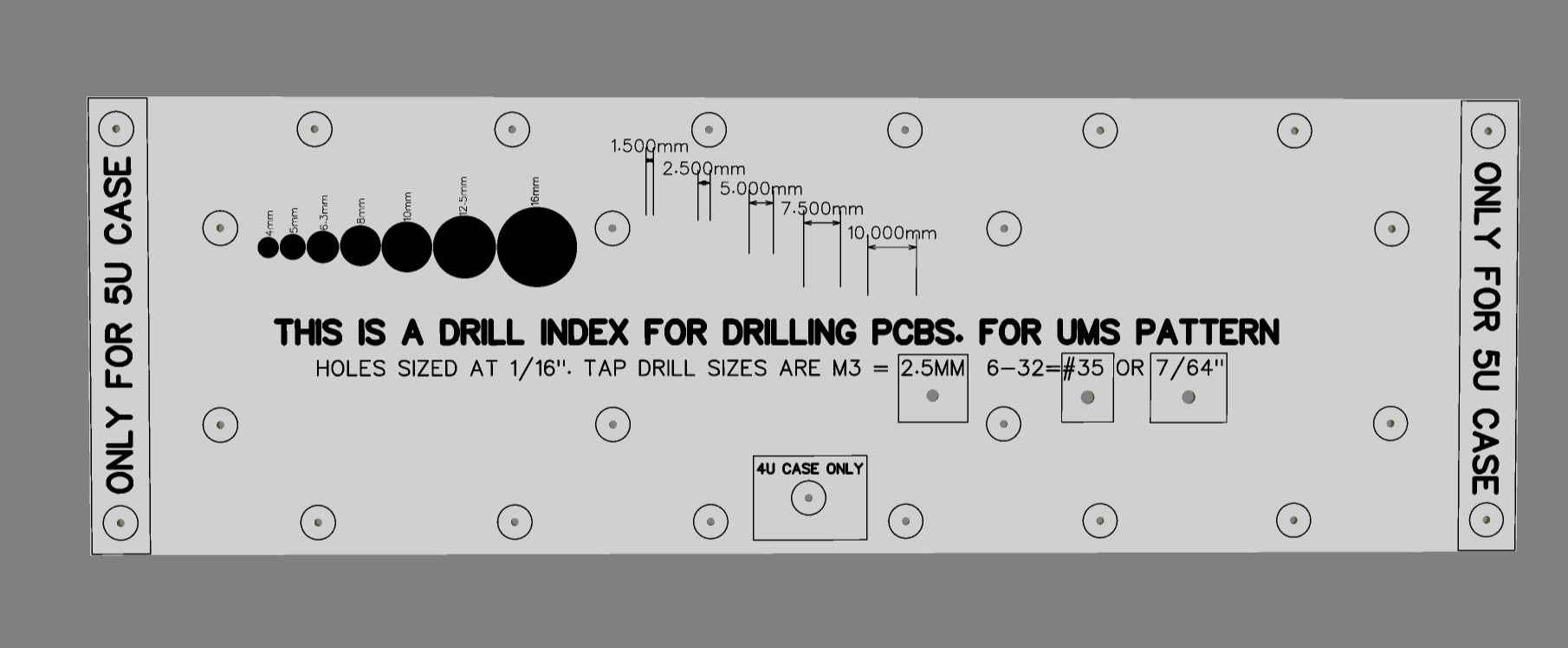

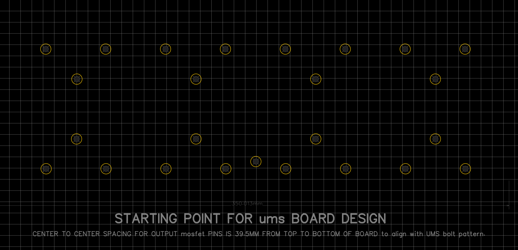

You can read about it here:
https://diyaudiostore.com/pages/universal-mounting-specification
I have made a little hole pattern template in my PCB program so that I can copy and paist it into whatever PCB I am working on. The measurements are in the link above in a PDF file.
I also had a few drill templates made in aluminum PCB material which makes driling accurate holes very convinient for non-DIYaudio heatsinks.

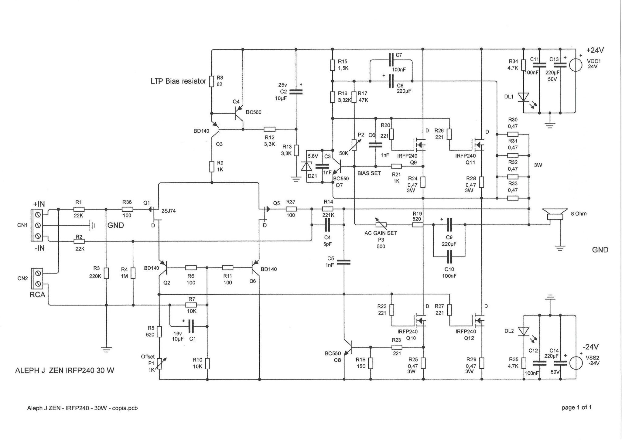

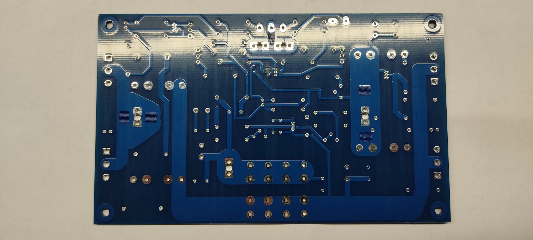

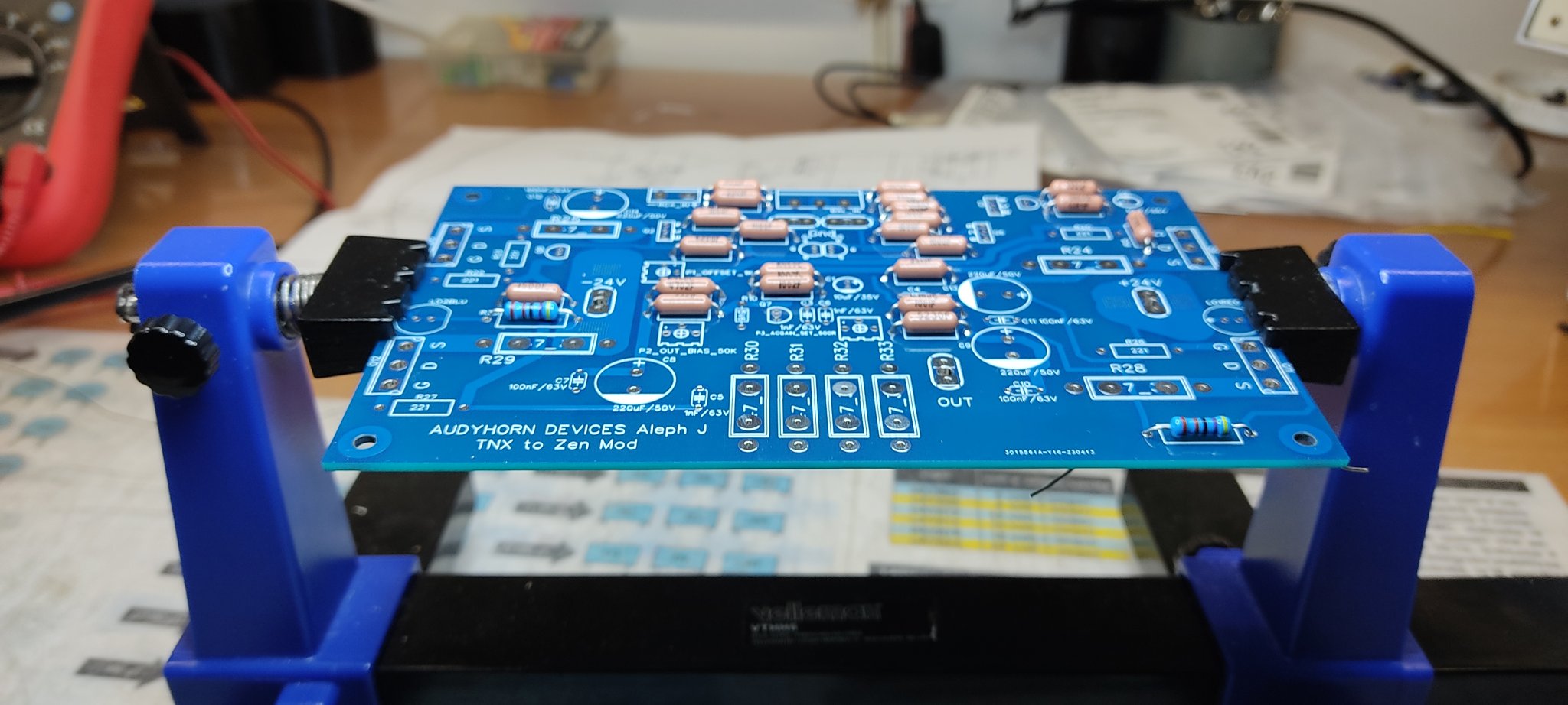

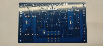

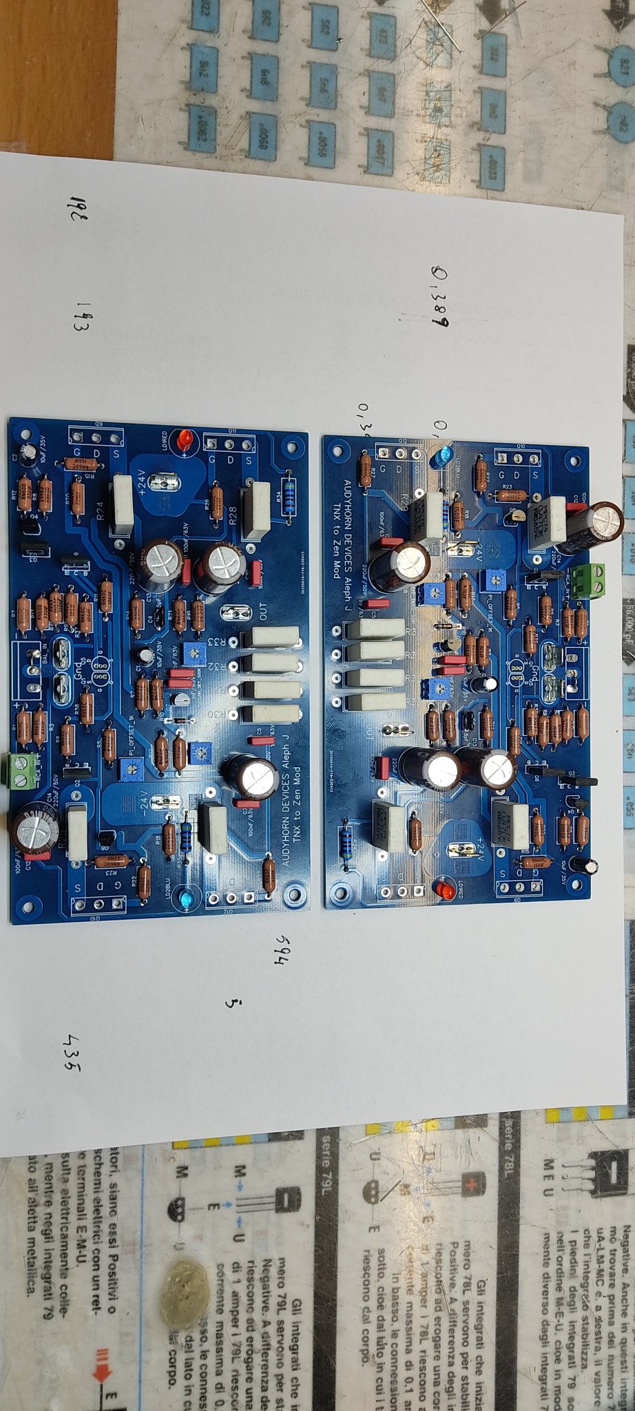

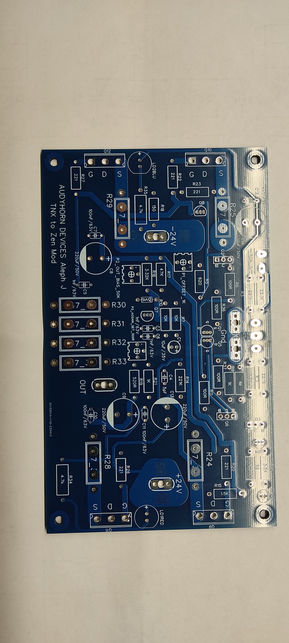

Latest version with some small adjustments to the screen printing and application notes for 60W type use.
Furthermore, the BOM list generated by EasyEDA now is correct and consistent.
Thanks again for Zen Mod and Nelson Pass of course, sorry I didn't mention him earlier.
Antonio
