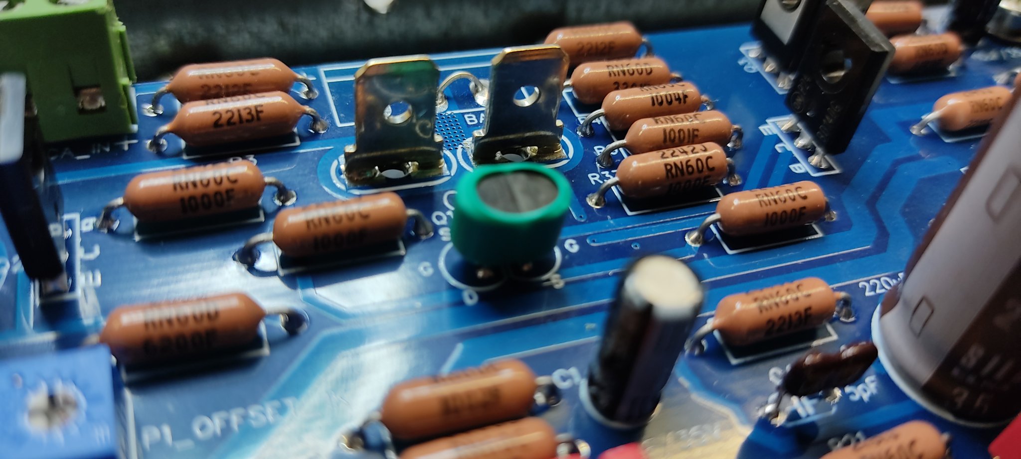

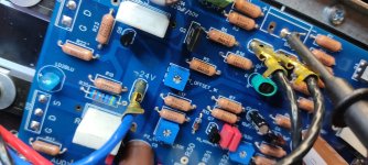

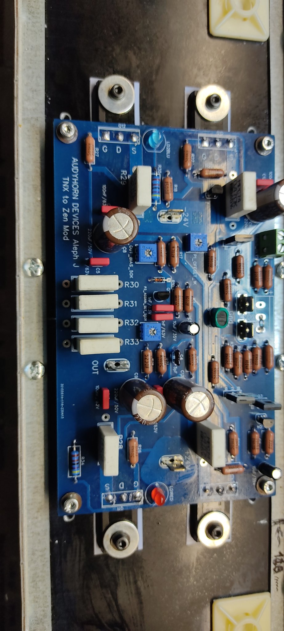

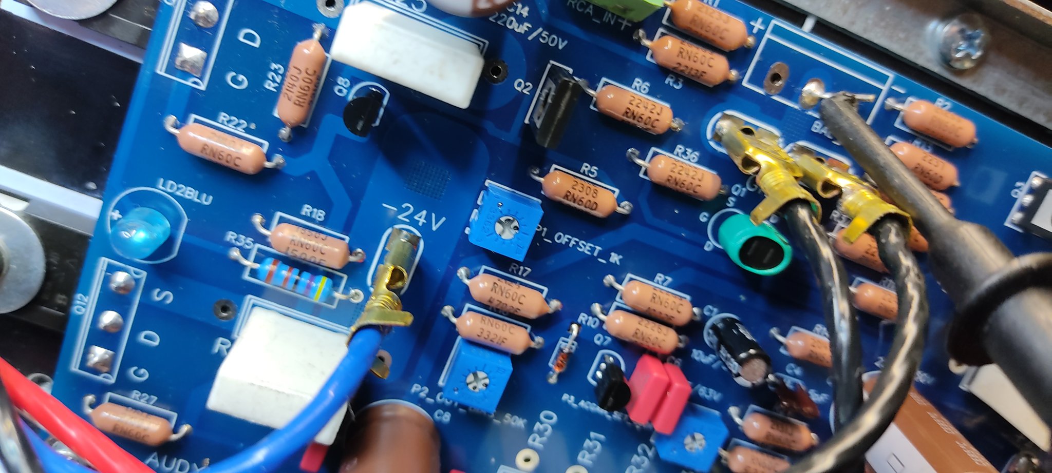

First ignition results and general adjustments/considerations.
1) to get 0.460mV on R25 I had to rotate P2 to the maximum (50K) so I got about 0.98A on Q10
instead on R29=0.53mV
also on
R24=0.53mV
R28=0.57mV
2) to get +/- 10mV offset (shorted input and no output load) I had to adjust P1 to about 170 Ohm
in this condition I obtain with 20°C TA max a heatsink temperature 55°C
3) I measured the voltage of 10V on R9 (therefore 10mA)
4) I measured 4.49V on Vce of Q7 (BC550)
In the afternoon I'll try to understand something about P3 regulation (AC gain) and I'll post measurements that will be done with an oscilloscope and Arta Software (I hope don't explode everything)
Errata corrige voltage measurement SORRY!
R25=0.460mV was right !R29=0.453mV
R24=0.453mV
R28=0.457mV
Updates...

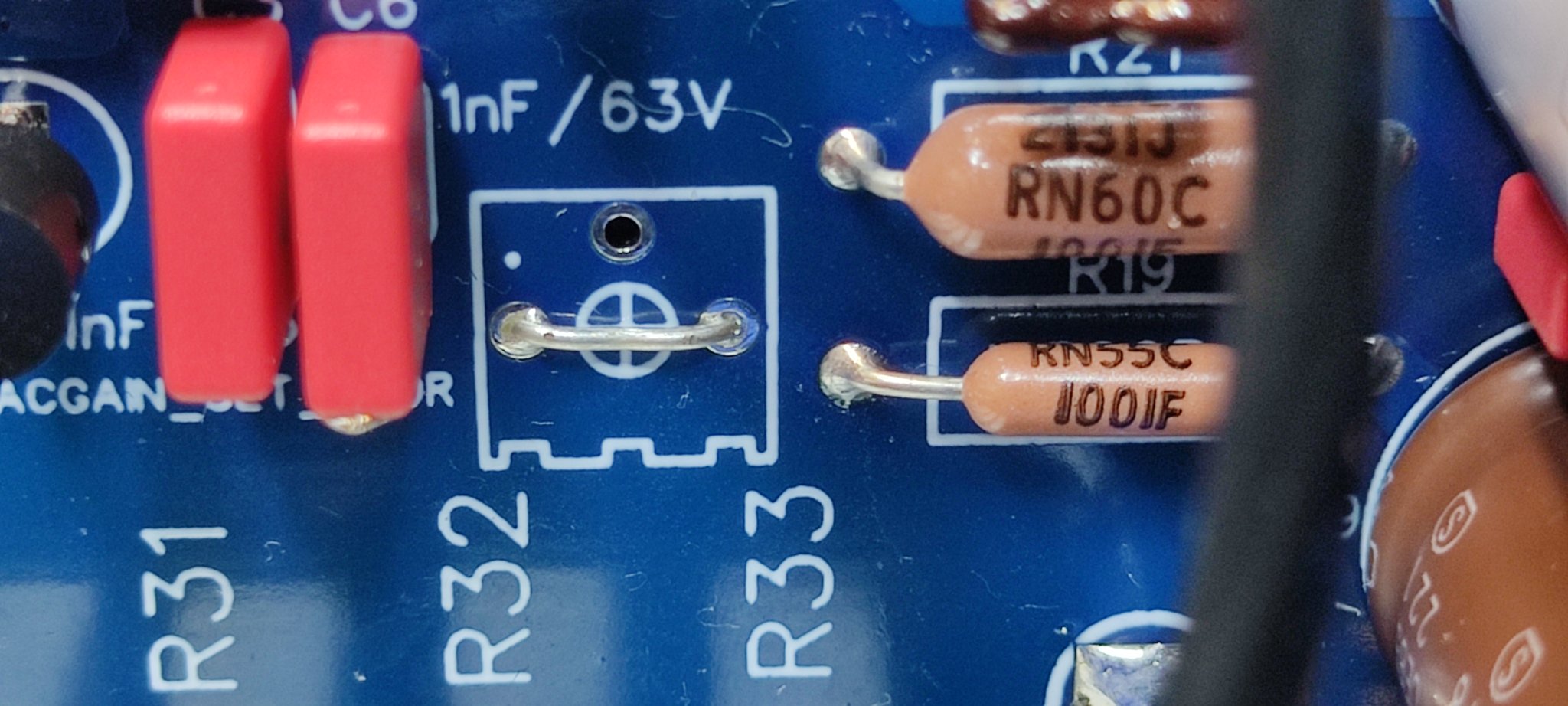

After several measurements I realized that in order to obtain the best compromise between THD and maximum available output power (with perfect shearing of the upper and lower part of the half-wave), the right compromise is R19 (AC gain resistor 1k ) with P3 removed and jumpered.
Scaled harmonic performance and good frequency response.

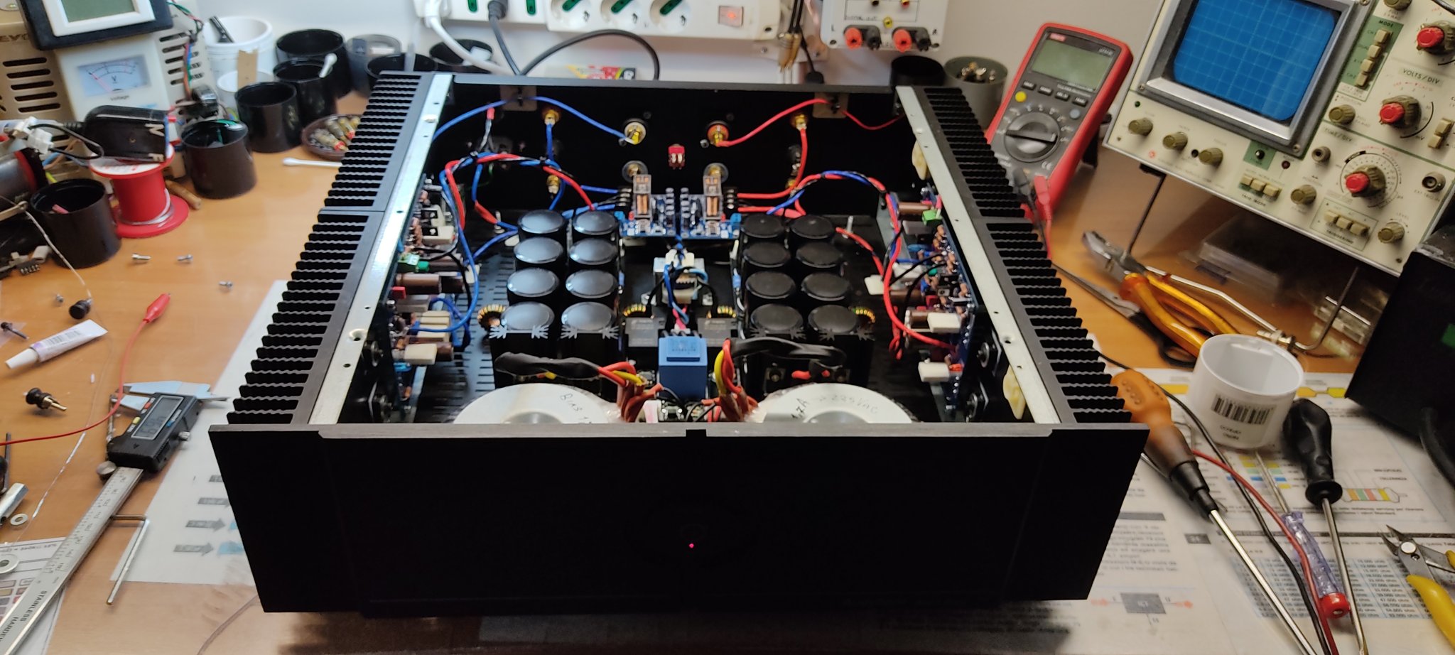

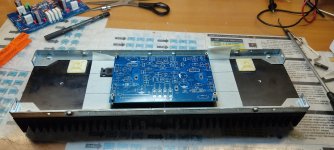

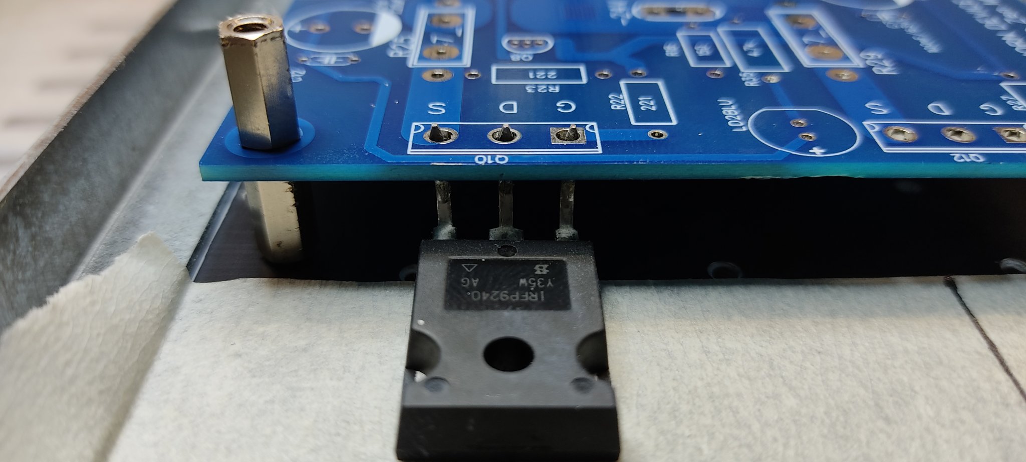

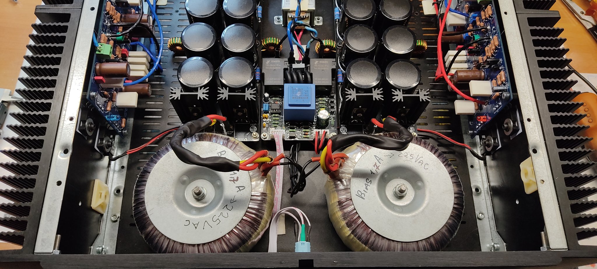

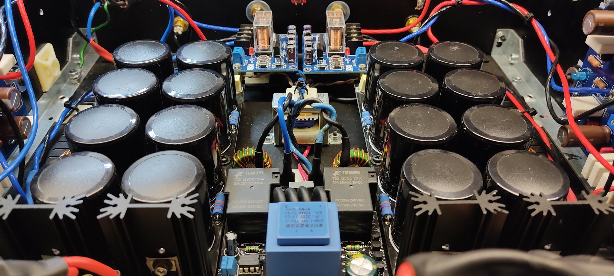

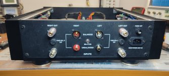

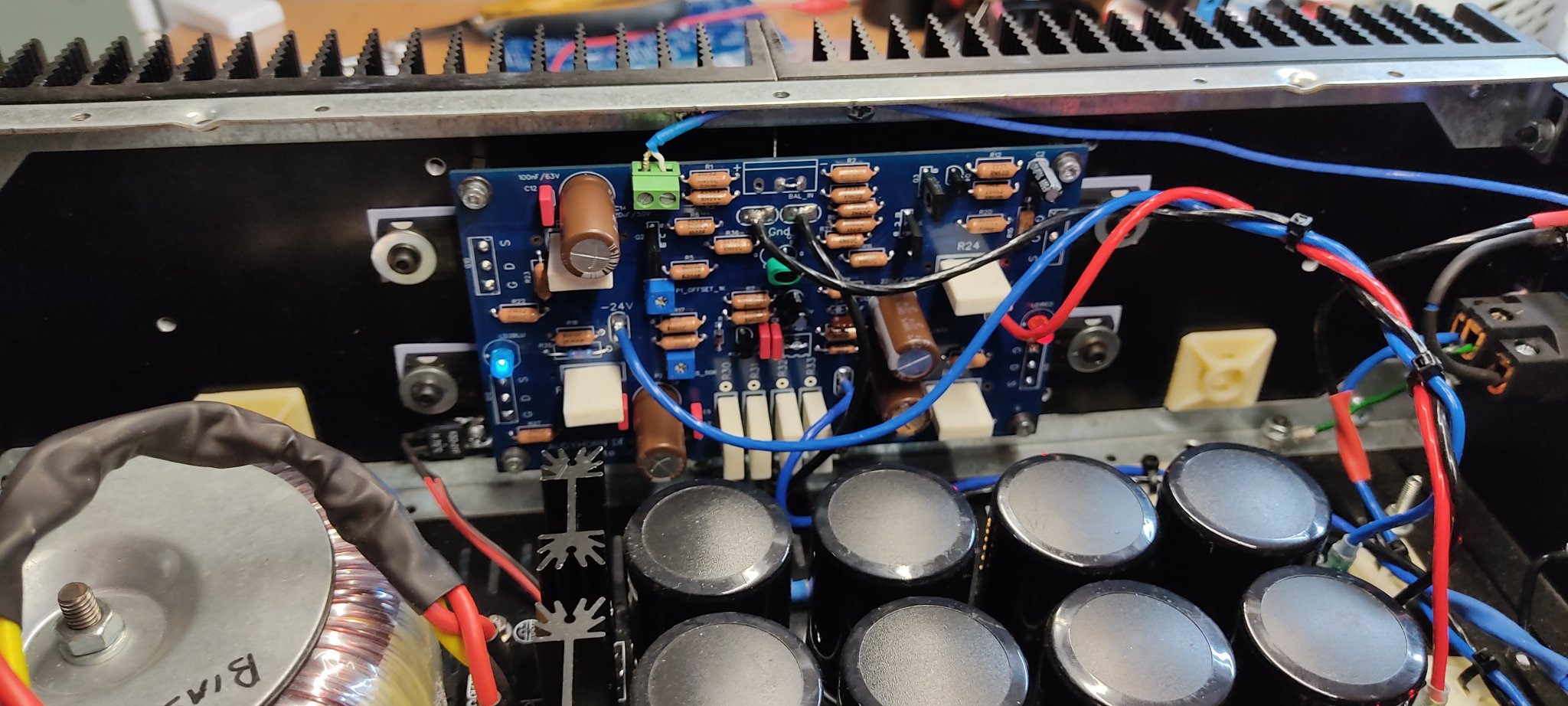

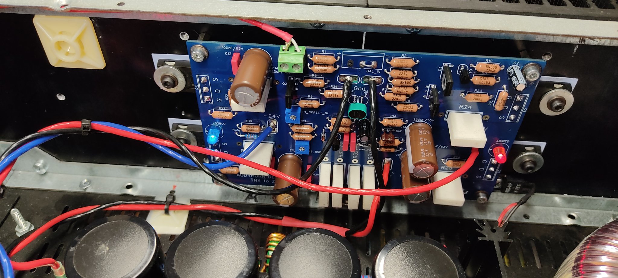

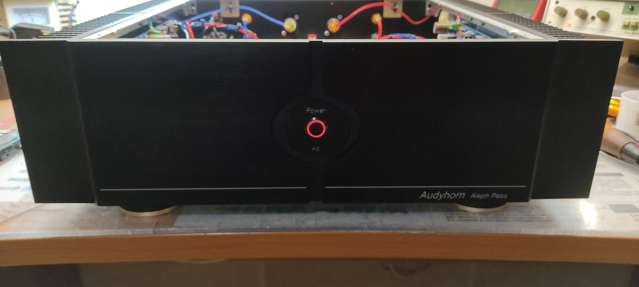

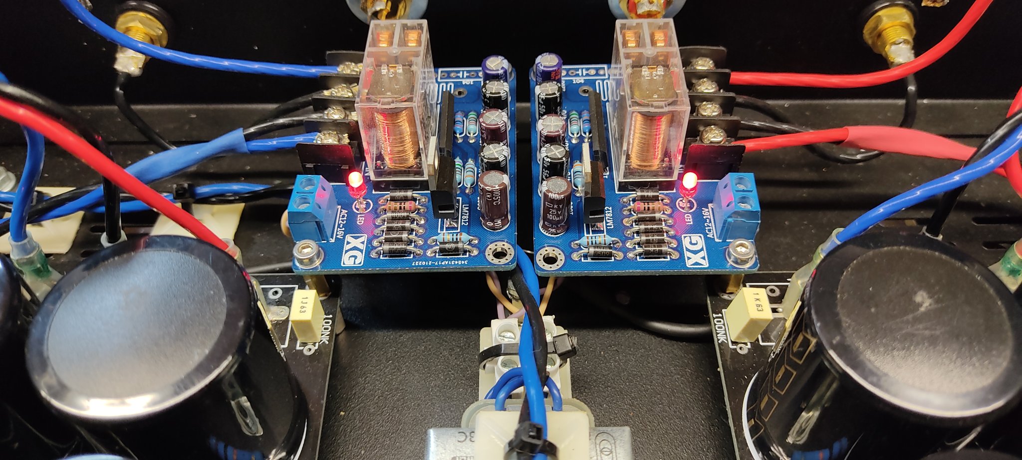

Finish....

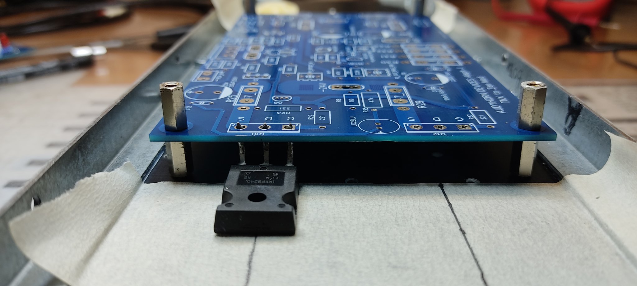

Now in Italy Is 15:30 pm
The reason Is for more power supply capacity and for possibility to be ready for 60w type with some little modding ( as irfp150 and 0,27 resistors).
Thank to Zen Mod.

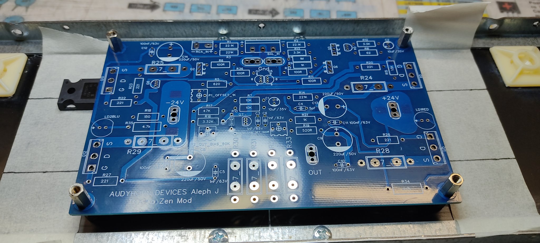

Now i have to update Electric diagram (some Little adjustment) and PCB file that i will share.
Thank to Zen Mod.

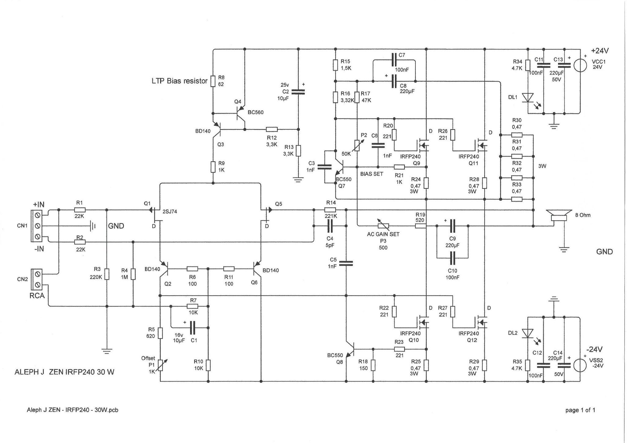

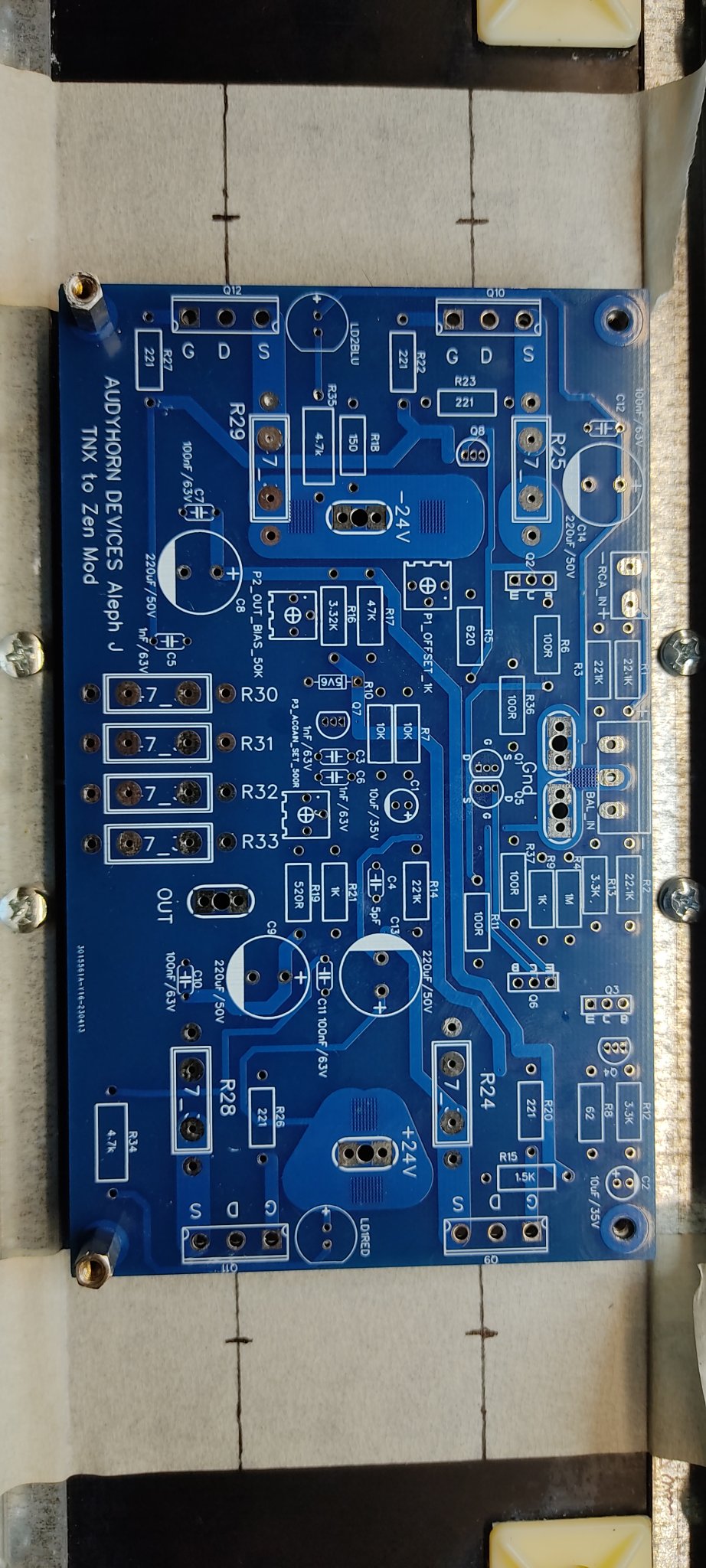

Here we are!
Here are some small variations that I think could be functional:
1) Replaced P1 from 1K to 500R (offset adjustment should be more accurate)
2) Replaced R17 from 47K to 68K (greater extension of the bias adjustment range)
3) Replaced R19 from 520R to 680R (greater extension of the ac gain adjustment range)
4) Introduced JP1 (Tp1 on schematic) to achieve convenience of AC GAIN adjustment. (thanks also to Rhthatcher guide 😉)
Aleph J (Zen Modded😉) vs F5 listening tests will follow.
Stay tuned!😉

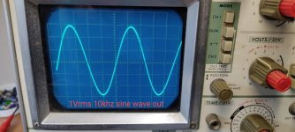

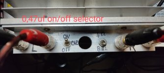

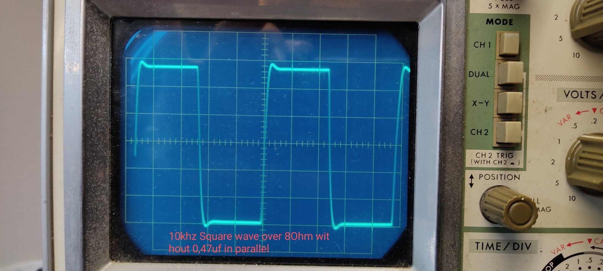

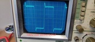

Below are some measurements made with an oscilloscope.
1) 1khz/1Vrms sine wave tone out
2) waveform with 1khz/1,4Vrms square wave out
3) FR -3db 5hz-90khz detected
any advice for C feedback?
