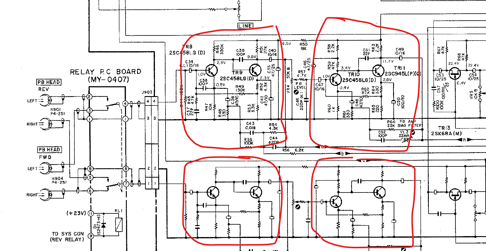

I am restoring an Akai GX 255 reel to reel. It's my first attempt at restoration so I am a nubi. The left channel did not work when I started and the first thing I replace where all the C 458 transistors with the suggested replacements. When I tested it out I had the left channel sounding good but in a few seconds I could hear pops and other noises and then the it went dead. Can anyone suggest where I might start looking for the problem?

The solder joints may not be the best. I did this without taking the boards out of the unit so they were rather hard to get at. I am thinking about changing out all the electrolytic caps so I may remove the boards anyway. I have used Deoxit on all the switches and pots but again they were hard to get at. Will clean them again when I take the boards out. I don't have a scope yet and don't know how to use one if I had one. Can you trace the signal with a multi meter? The replacement trans were KSC1845FTA. I will be back here to ask more questions. Thanks for the help so far.
Simple answer to that is no I'm afraid but you should check the DC voltages on those transistors when the fault occurs.Can you trace the signal with a multi meter?
I checked the voltage on all the transformers I replaced last night. The right channel ones seemed to be stable but the left channel ones were all over the place. One leg on one had 0 volts. They seem to get worse as the unit warms up. They start out sounding ok and then they start to "crackle" and fade away. Any suggestions on where I might look to narrow down the problem?
You are going to have to break the circuit down into blocks to start with. For example these sections are AC coupled and so DC values in each should be stable.
For example the collector volts of TR9 should be stable and so should the collector of TR11.
The same applies to the unmarked parts for the right channel.
I am assuming these are the transistors you have replaced.
