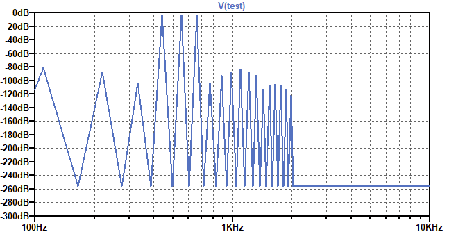

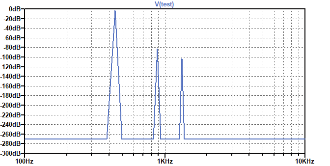

Let me conduct a little experiment. Let's say we have an amplifier that adds 0.01% of the 2nd harmonic (H2) and 0.001% of the 3rd (H3):
The distortion is not particularly high and is all low order, harmonious and benign, perhaps even euphonic.
Now let me play a simple chord, A-C#-E:
Oops. In addition to H2 and H3, our benign test amplifier sputters a bunch of intermodulation products, musically unrelated to the chord, with levels comparable or in some cases above those of H2 and H3. These are not euphonic and would not be masked by music. Such an amplifier might be ok for simple music such as a solo vocal, but would get confused with anything moderately complex, and would mush a full orchestra.
So, while various components of the audio chain undoubtedly distort, 0.01% THD does not give your amplifier transparency, and you do get audible benefits from making one of them more linear.
