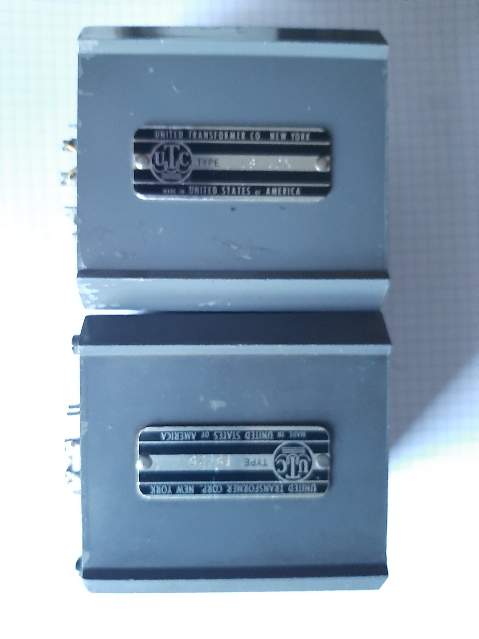

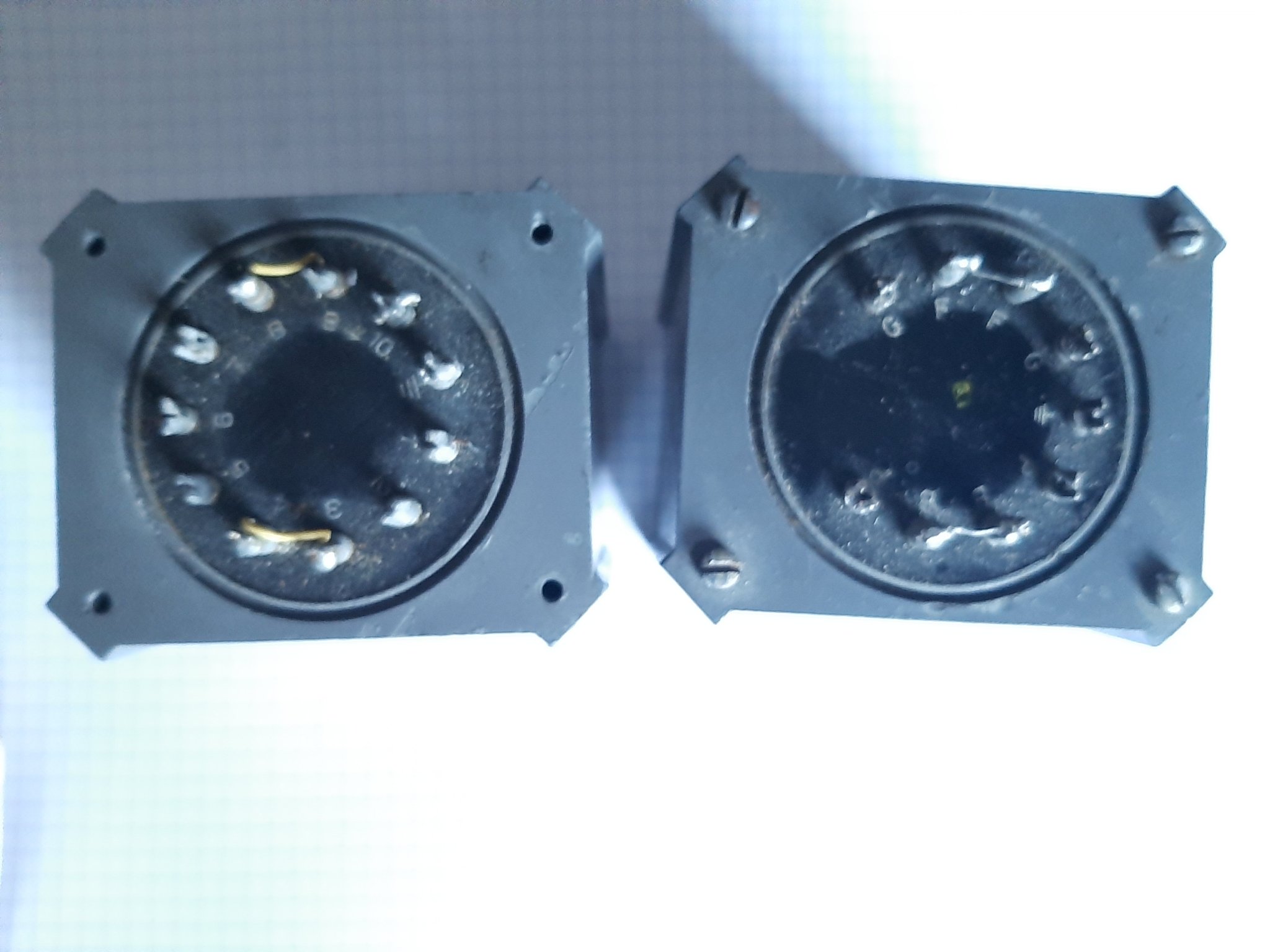

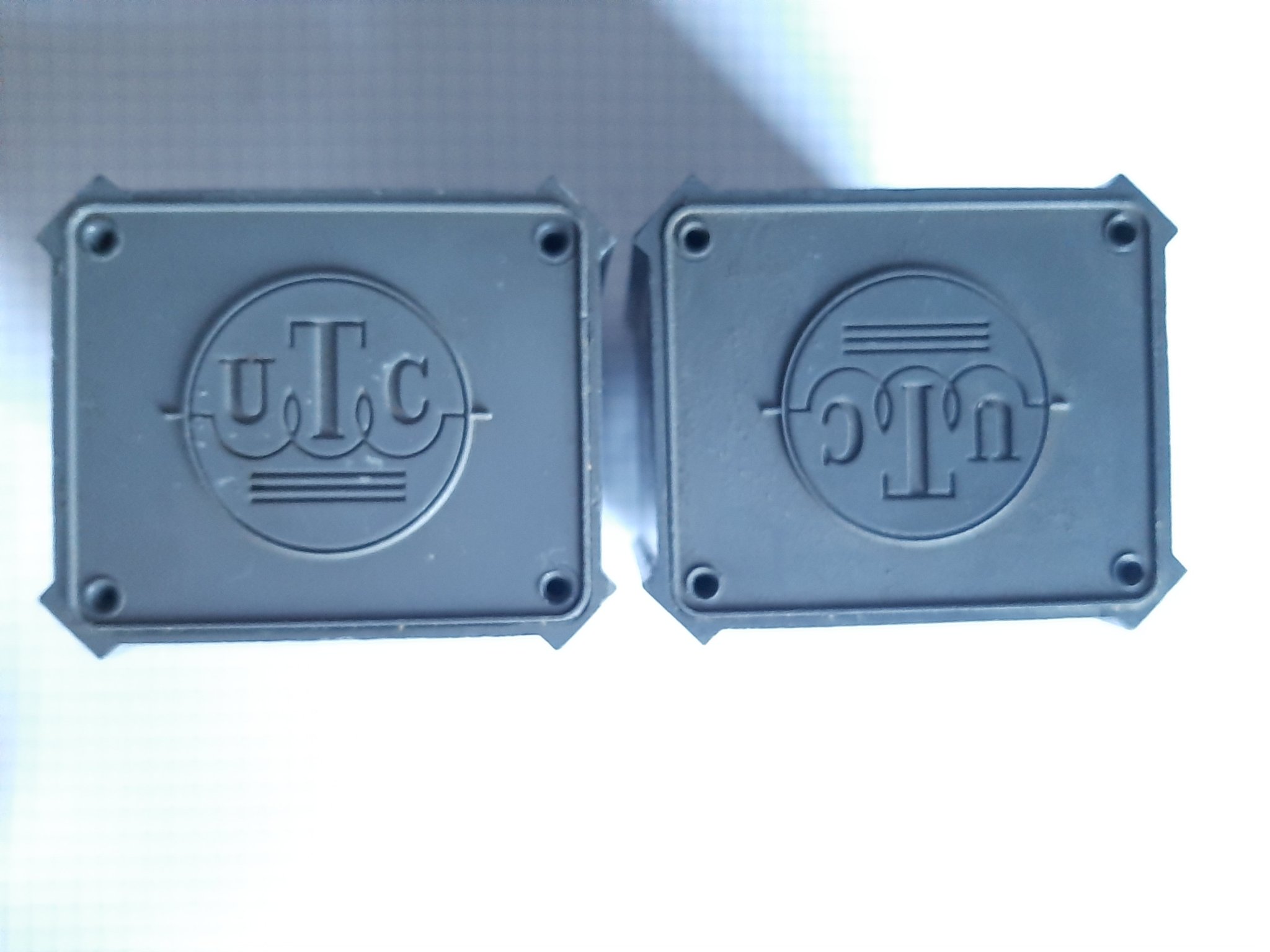

For Sale 12MU/4731T00
SOLD!!!
Anyone has a need for a pair of 12MU/4731T00?
I am asking since my friend that is retired gentleman is selling these, so i decide to help him out since he does not know english and does not frequent these forums.
They are unused and new. Selling for 310e for 2x (pair)
Manufacture week 22 of 2022
(PW:2222)
If interested send pm, i will post them and make the sale.
Updated with photos:

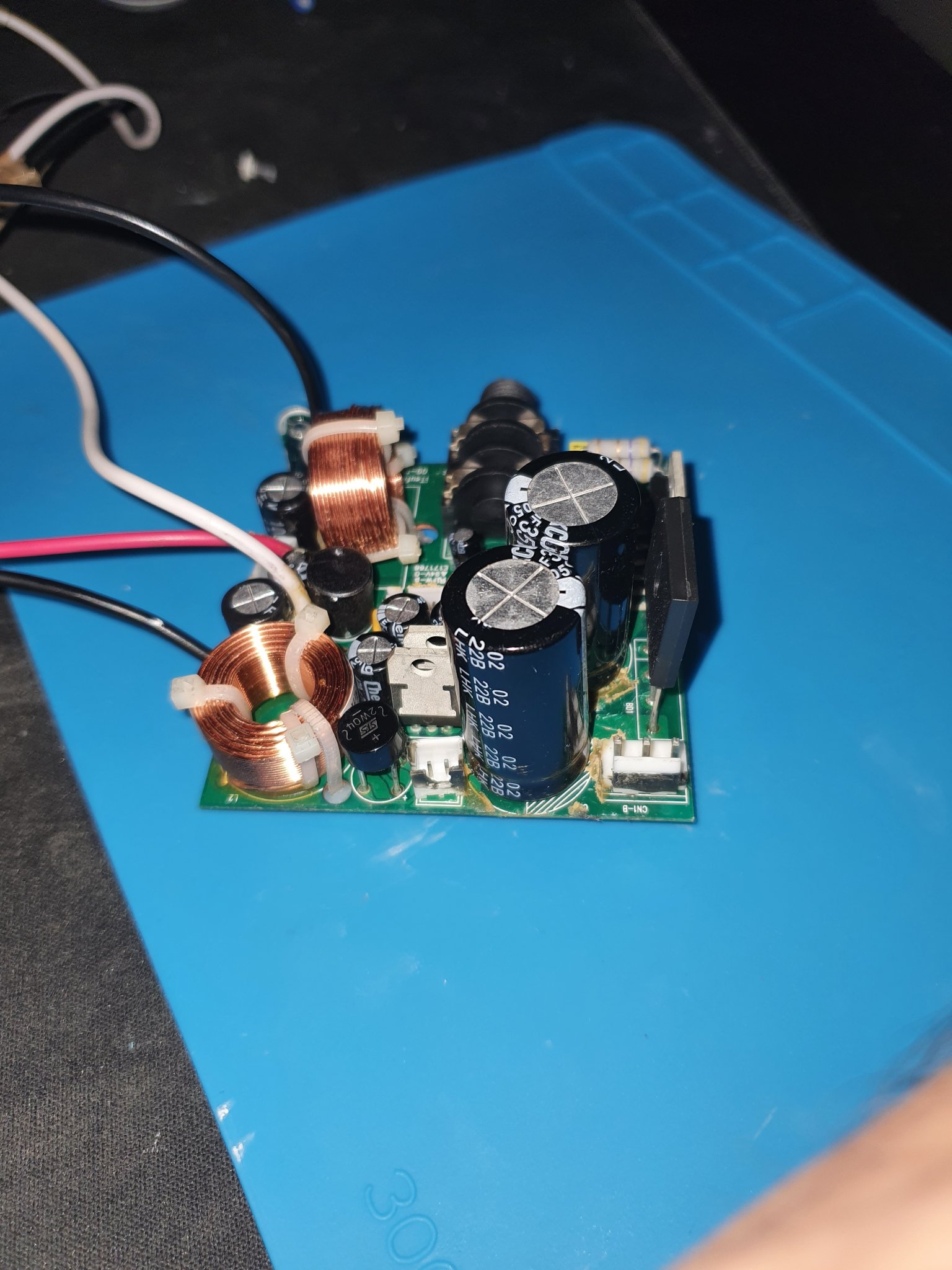

Low power TPA3255 and DSP
I built an active speaker with a 24V battery some time ago, a DSP ADAU1701 and two TPA3118 and it sounded quite good and loud. I wanted to increase its power and I bought two TPA3255 but the problem is that it has not increased as much power as it should and investigating I have discovered which is because the input sensitivity of the amplifier is 2Vrms and the output of the DSP is 0.9V is there any way to decrease the input sensitivity or increase the output of the DSP? Would it help to change the OP Amps? The specific amplifier is this

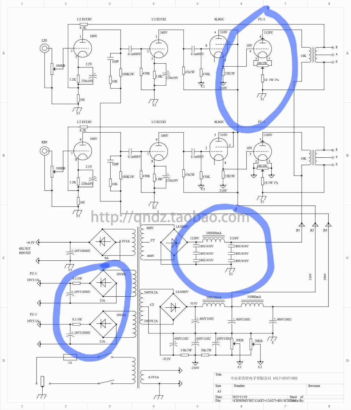

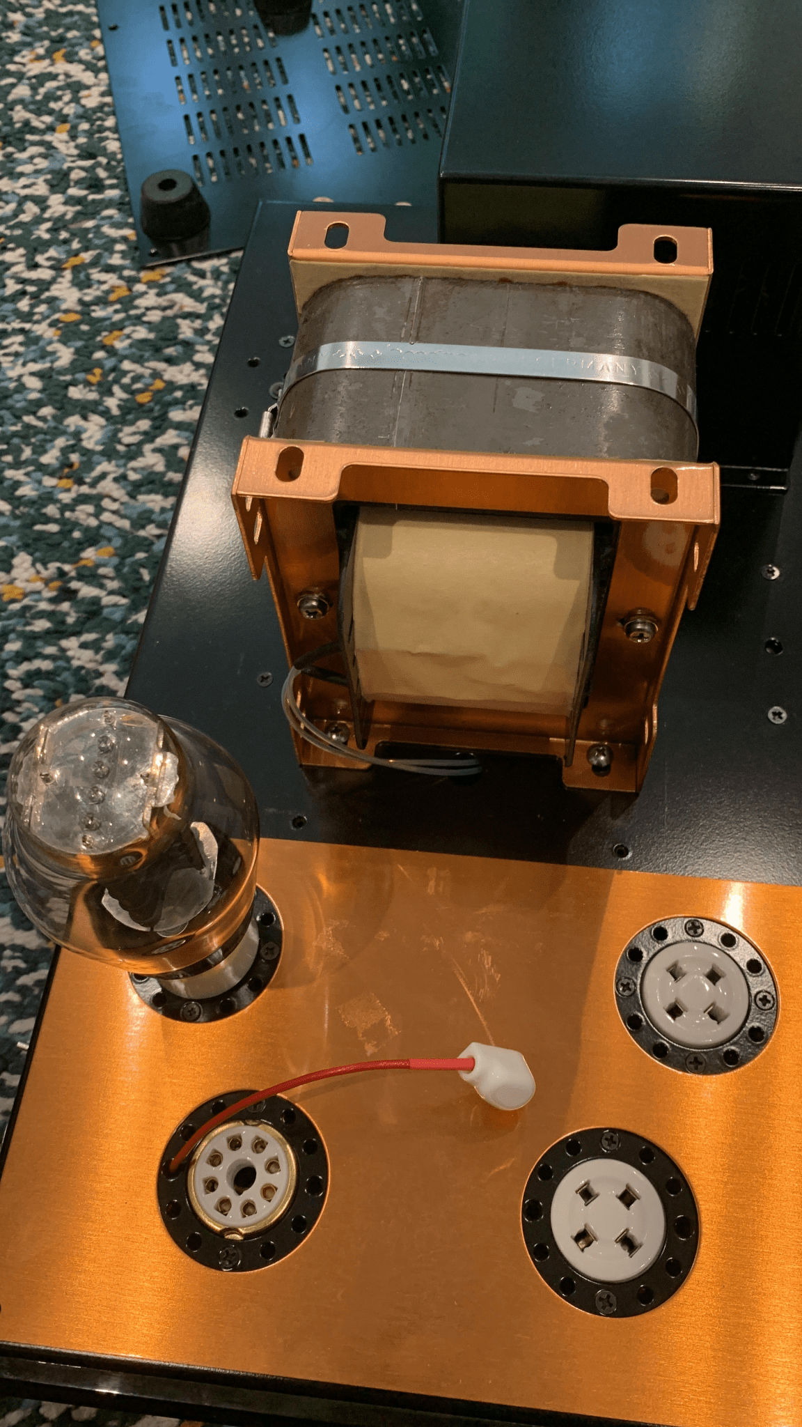

Some questions on 805 Tubeamp circuit design and testing
Recently, I purchased a diy kit of high power class A tube amp based on 805 (shugang FU-5). However, there is no assembly instruction except that they can only provide the schematic diagram and some photos of the finished product. Although I have some previous assembly experience of a low power tube amp based on 6L6GC before, I don't have experience for a tube amp that operates at as high as 1120V. So I have some questions on the circuit design of this amp especially for its HV power supply and its filtering. Also on how the appropriate testing procedure should be.
1. Regarding the HV power supply (1120V), 3 HV caps(180uF 450V) in series. Just wonder if the withstand voltage 450V is sufficiently safe for the shared operating voltage 370V? Supposed I'll add a resistor in parallel with the cap to ensure the voltage is equally shared. Or would it be better to add one more cap (i.e. 4 caps in series) so that the shared voltage will be less. Hence better margin?
2. About the LC filtering. 3 caps in series so that the combined cap will become only 180u/3=60uF. Just wonder if the hum noise is too large? Should I use larger cap value (say 1000uF instead of 180uF)?
3. There is a 100 Ohm VR at the cathode of FU5(805). Just don't know its function? How are we going to tune this?
4. For the filament supply for the FU5(805), there is a 0.1 Ohm in series to provide 10V filament voltage. Is it for the power up delay?
5. As the FU5(805) is directly heated and DC coupled from 6L6, any precaution on the testing procedures?
Need advice from someone who has experience on this kind of HV tube amp. Thanks.

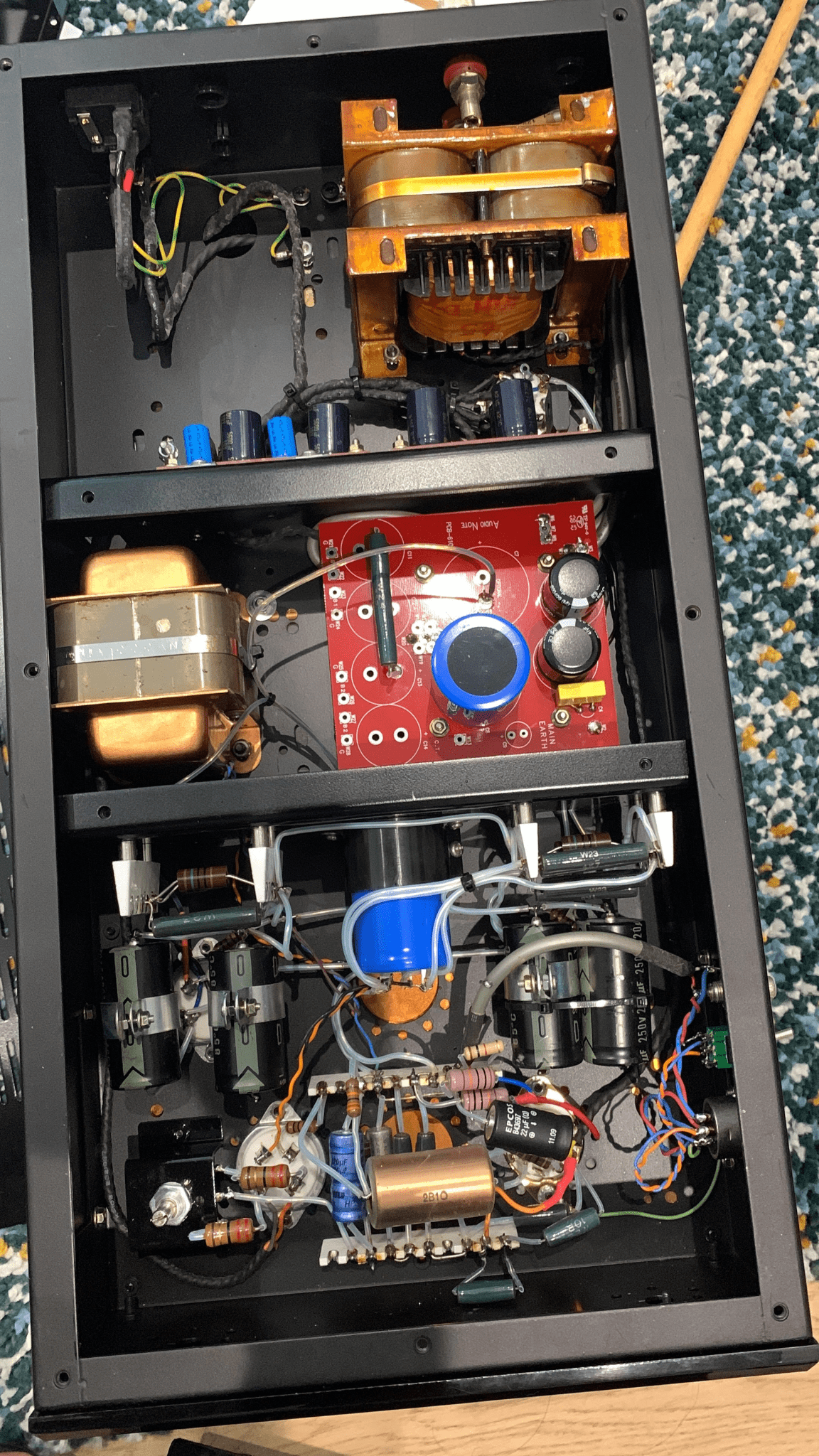

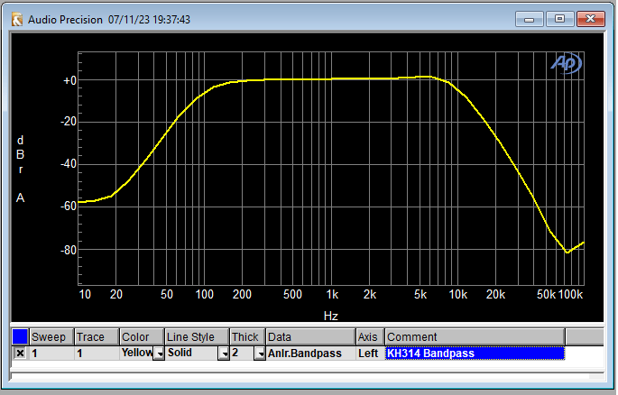

A tube only RIAA pre-pre amplifier build
Hi Forum,
I decided to make a tube only RIAA phono stage and make a nice over the top PCB for it. The design is a bit based on the Luxman EQ 500 with less bell and whistles, but in basic form the same thing.
A friend of mine wanted to tag along.
We ordered 3 main boards, one to prototype on and we only put components for one channel on.
This would not ruin the end result for if we would have had to cut traces and blow up things.
Luckily the board had only one error (a PNP transistor with Collector and Emitter swapped in the foortprint) in the slow start function of the 12.6V filament supply.
So, the concept is a dual 12AX7 based SRPP stage running on 320V with a passive RIAA in between. No NFB. I made a separate left and right regulator with a bit beefy supply. A custom transformer ordered with 2x 350V CT, 14V for the heaters and relays and 6,3V for the Tube rectifiers.
Used an ECC88 for the output stage running on 250V but two halves in parallel. The ECC88 has a low output impedance and 2 parallel is below 50 Ohm. A Lundahl transformer for the MC input and one to make a balanced output. The output stage is also AC coupled with a floating bias resistor to bias the output tubes (way more predictable and a beefy 16mA class A current trough the combined parallel tubes. I also made a reverse RIAA circuit tweaked it to 0,1% and a channel balance of 0,1dB.
I used 30nF and 10,2nF in the RIAA stage and measured with an Audio Precision. The theoretical values would be 72k and 10,6k for the RIAA resistors.
The 72k is way to high as you need to add the output impedance of the SRPP and the impedance of the coupling capacitor and the result is shown in the attached picture. Distortion was -74dB A weighted dominated by the 50Hz mains and no case yet.
So last weekend my friend and I have been working on the main boards see attached pictures for the result.
Missing a few components, and the metal cooling plate in the middle that you see on the proto will be black anodized next week.
Then we can test again, and work on the housing.
Cheers
Peter
