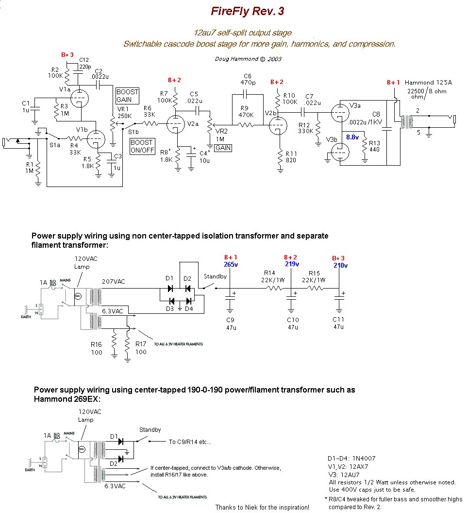

Here is a Cunning Devil Mod by none other then Doug Hammond, you know, the transformer guy! 👍
And another from the distant past.😀
jhstewart9, and others:
U Missed my point in Post # 6:
I said:
"Use a 6L6GC for Push, and an EL34 for Pull.
Be sure to set the 6L6GC quiescent current = EL34 quiescent current (unless you want lots of lamination saturation that even starts at low power out) . . . This might be a new idea for most guitar amplifier designers."
There is nothing in the above statement that talks about a self inverting amplifier.
It only talks about totally different output tube types for Push than is used for Pull.
