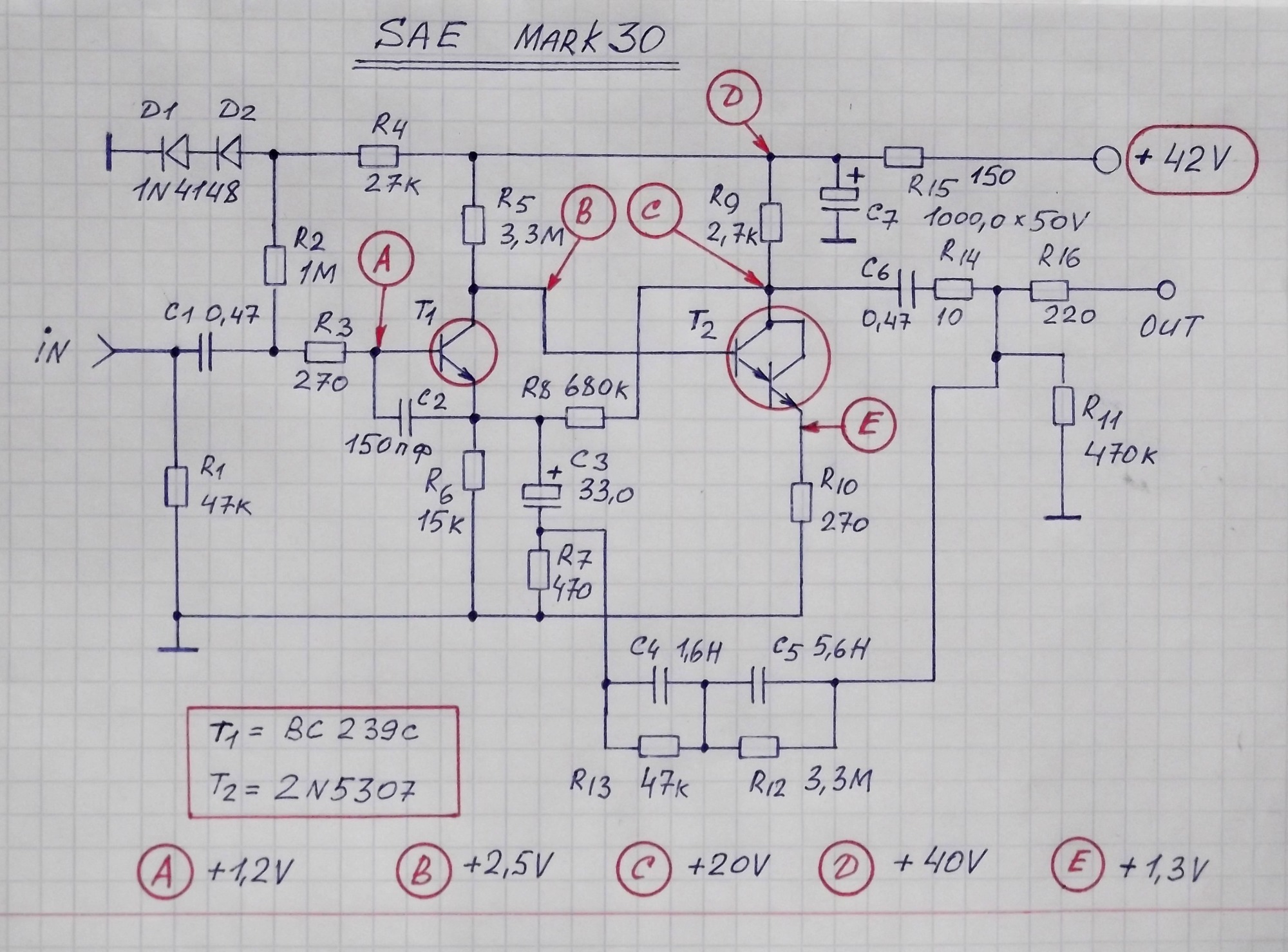

Simple Transistor based RIAA
So the good news. I got my Vintage Woodstock Amp up and running.
The bad news it Ceramic and Magnetic Head Phono Sections seem to be simple amplifiers.
There is no RIAA equalisation.
After spending a month studying the various possible solutions to this I have short listed two.
The requirements are simple. No op amp must be transistor based.
The Akai I have owned back in 79. I know it sounded and worked well. Even though its so basic.
The Self based design I have not experienced.
I guess the long and short of it is that I need to enter up both in a simulator and see how they perform. If you have any such modells pls share.
Reason for this post.
1. Just in case somebody is every looking for a very simple RIAA transistor circuit.
2. If any member has a collection of Transistor based RIAA schematics they can throw up. To compare to this.
3. Any obvious hack / mods improvements to this design.
(Im not interested in using op amp as thats a separate project. )
There is a 3rd option Im looking at but its way to complex I feel And that is the Phono Section from a NAD 2030 it matches the period.
MY only doubt is finding the right transistor to use on the akai schematic but last time I checked it was hard to find anything from that period. This amp Im making as a gift to my dad when its done.

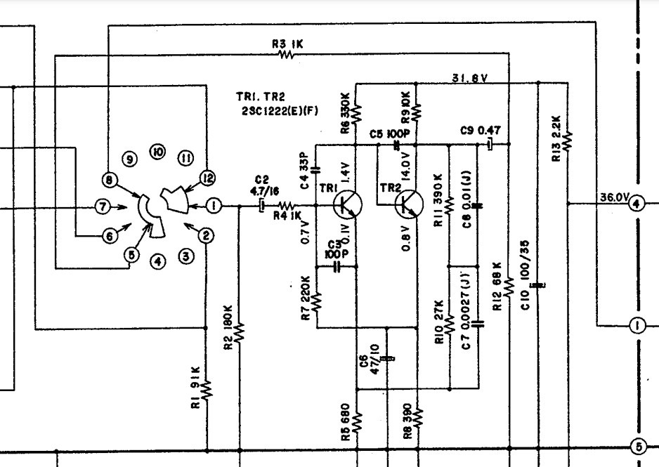

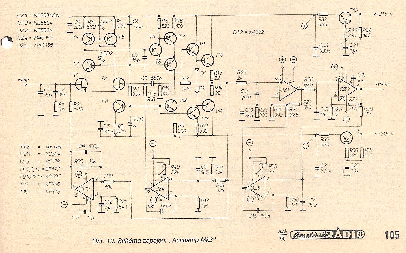

Basically both the Akai and the Self-3 has the same topology, but the Self is smarter with the bootstrapping output buffer - it runs on a lower supply rail!
With such a vitage amp it might not a surprise no RIAA eq-circuit was incorporated. Ceramic has a 'natural' correction (most people won't notice) and high output. I guess the magnetic head input is intended for tapes (NAB correction), not cartridges.

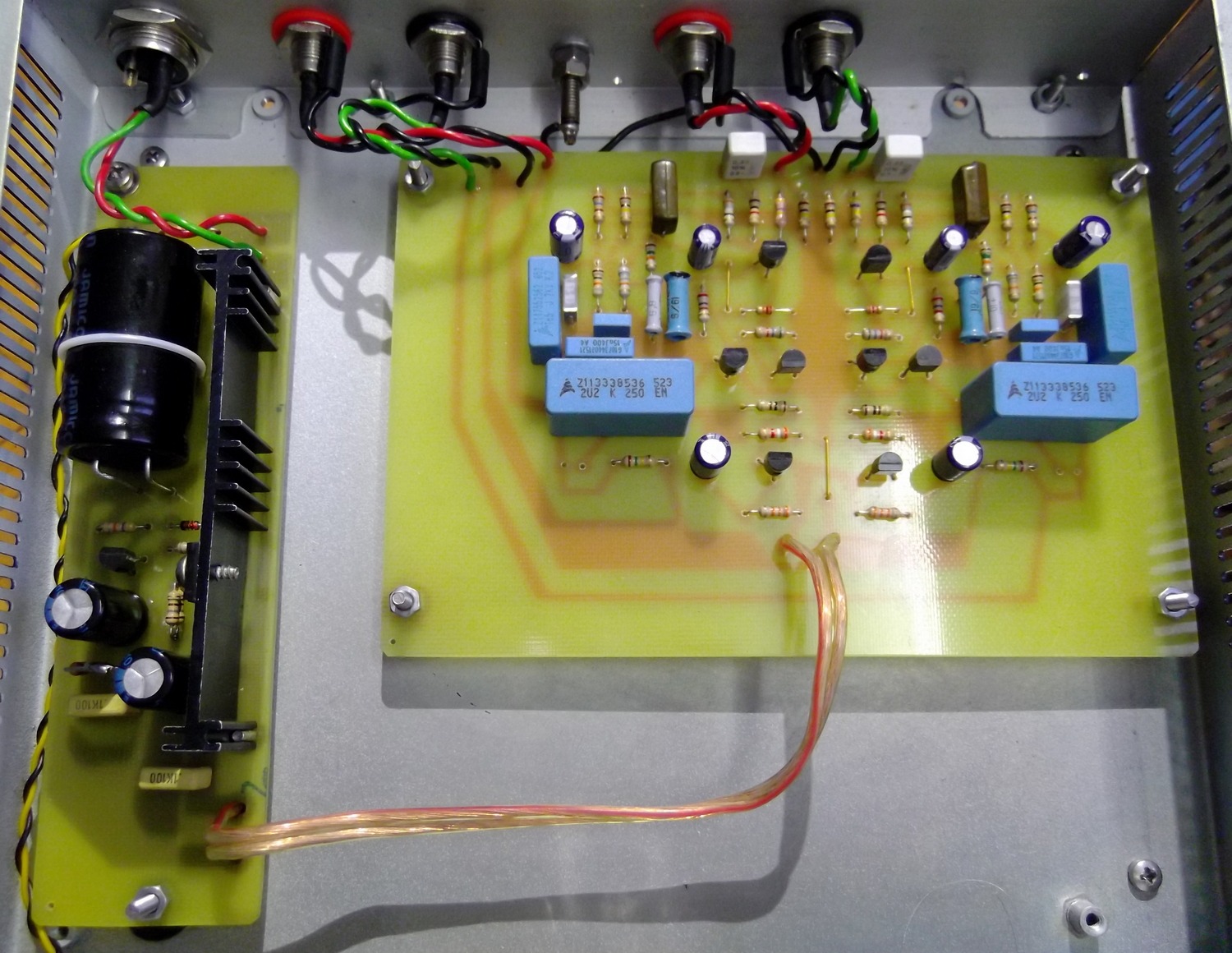

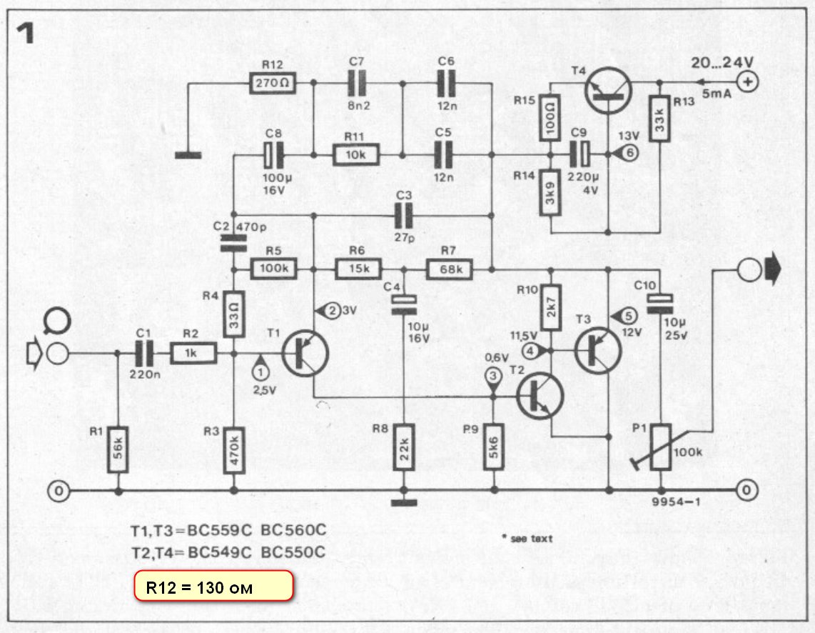

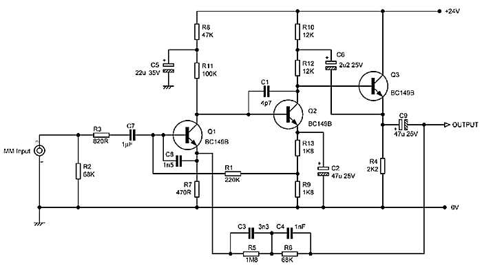

Hello ! One of the simple phonopreamps is Elektor PreConsonant ( its scheme was published in Elektor 1978/07-08 ) . It has a good sound , affordable components . I built 2 such phono preamps - on silicon and germanium transistors . Both versions sound good . Here is the original circuit - it has a gain of about 32 db / 1 khz. To increase the gain , you need to change the nominal value of R12 .

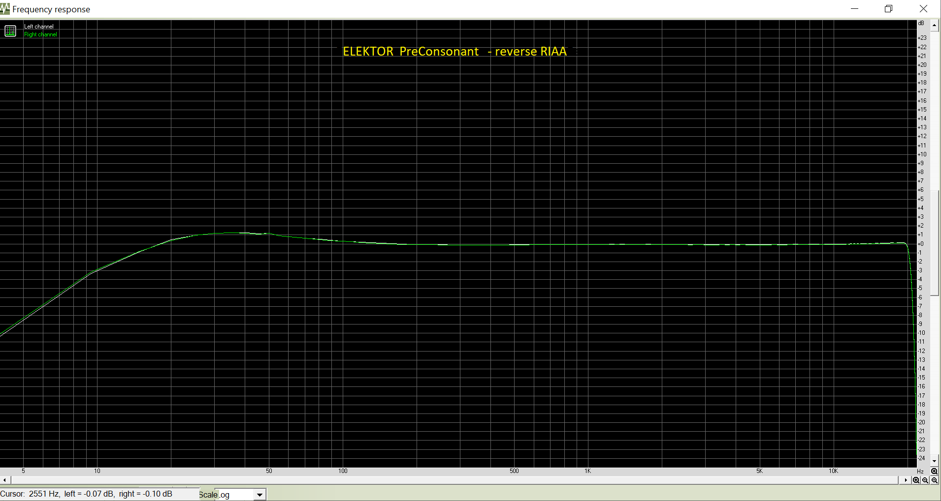

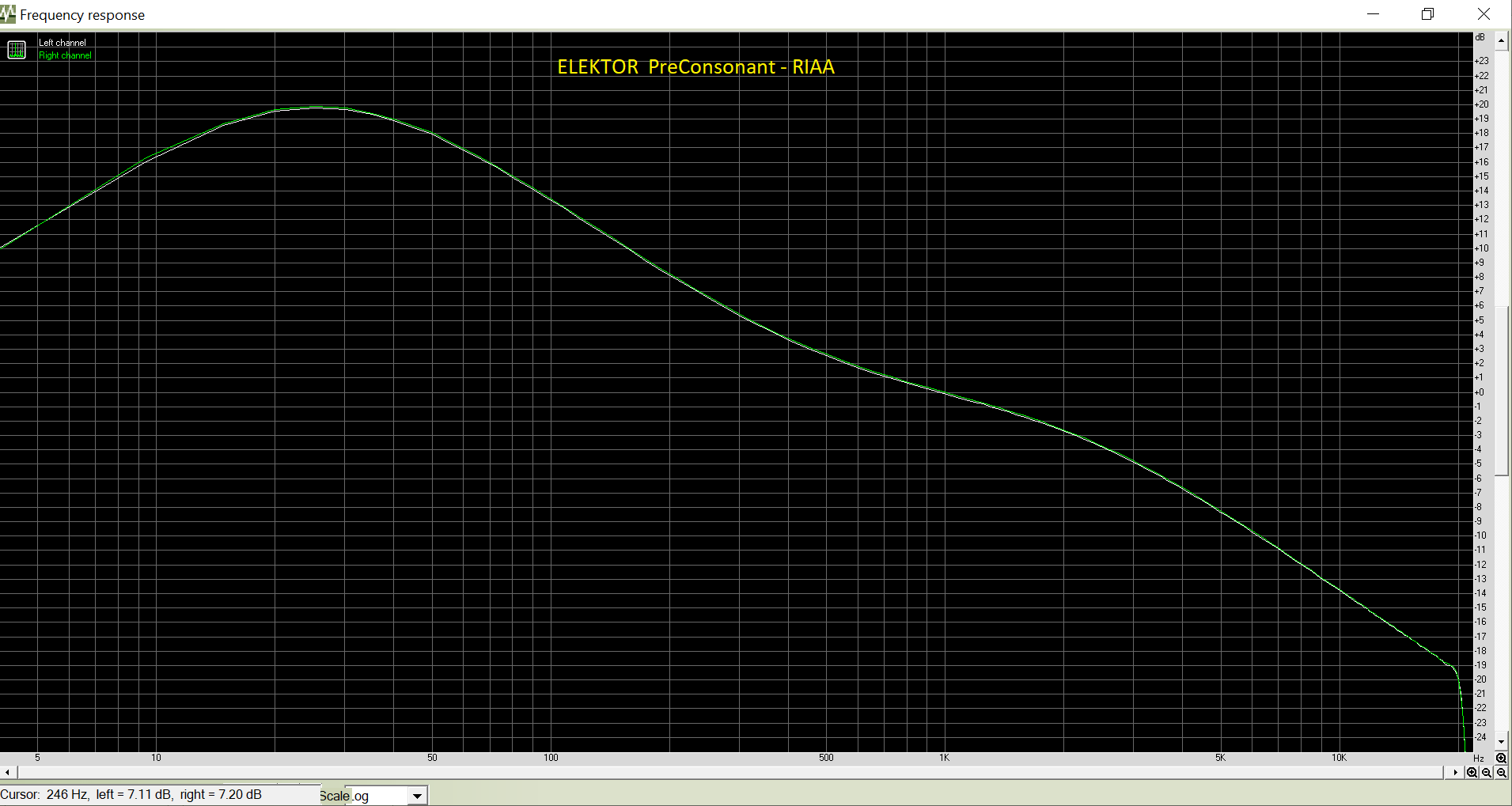

Here are the graphs of frequency measurements of Elektor PreConsonant . This is the frequency response measured using ASUS Xonar and RMAA . The second graph shows the measurement using the inverse-RIAA circuit.

Hello! I have not modeled this PreConsonant scheme . First I saw a video on YouTube where the work of this phono preamp was shown . Then I found an Elektor publication with a description of this scheme . And I built such a preamp for myself . Then I took measurements . The graphs were obtained by measuring a real phono preamp ( my copy ) . I used transistors BC-549/559 ( Motorola ) - from my old stocks ....This is a good scheme. It is better than 2-transistor circuits.

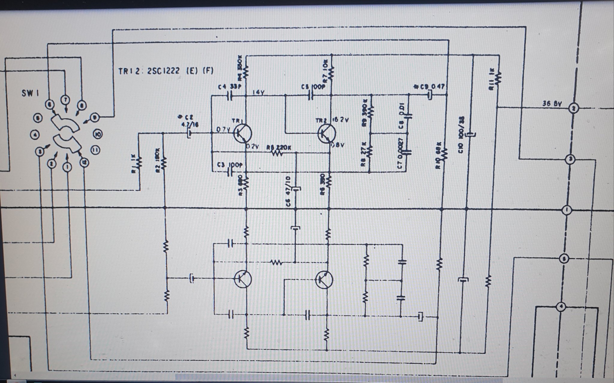

So the amp we owned in 79 was a 2400 I have started to go thru all Akia amps that followed so as to study how this 2 transistor circuit evolved over the years. So far I have reached 2800 the image is more clear. And still on 2 transistors. I know the AMU 310 I just repaired from the 80s uses a Op Amp. For phono which works and sounds good.

I have used 2-transistor phonopreamps. Usually they allowed you to get a pretty comfortable sound .
BUT - many 2-transistor circuits have insufficient gain at low frequencies ( 20-40 Hertz) . This is a feature of such circuitry . This is clearly seen when measuring the frequency characteristics of such preamps .
And many of these circuits had a fairly high output impedance . They were designed to be connected to a high - impedance amplifier input ( more than 100 kohm ) .
More complex circuits - have less deviation from the RIAA standard , and give a deeper bass .
In principle, assembling a 4-transistor circuit is not much more difficult than assembling on 2 transistors.
