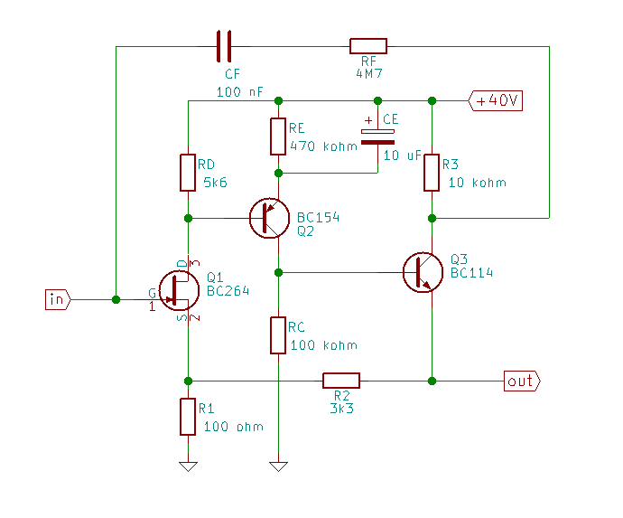

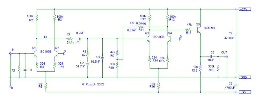

Reason for this post.
1. Just in case somebody is every looking for a very simple RIAA transistor circuit.
2. If any member has a collection of Transistor based RIAA schematics they can throw up. To compare to this.
3. Any obvious hack / mods improvements to this design.

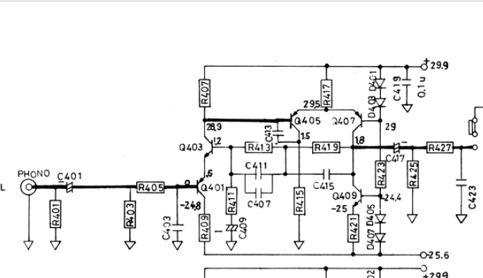

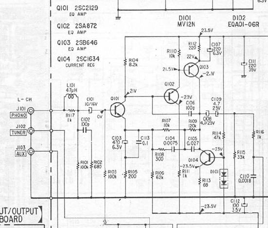

Related to OP #2
Attached is a four-transistor RIAA used by Sony in their TA-f5a, circa 1978. Sharing a few traits with the Self design in post#1. Q3 has no bootstrap and the collector resistor has been replaced by a CCS.
Probably Q4 and associated components could be replaced by a 10mA CCS.

Wow, what an effort! I guess the first, discrete part could be substituted by a JFET input opamp, couldn't it? Anyway, what defines the resistive part of the cartridge load?
Best regards!
The 1M5 resistor is a synthesized 50k load - its driven in antiphase to the input signal such that it looks like an impedance of 50k or so, but with a lot less current noise than a 50k resistor. You can also think of it as anti-bootstrapped, thus converting a high impedance to a low effective impedance.
Related to OP #2

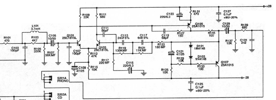

interesting circuit-topology. Concerning the input load R101 (usual values between 47K and 56K) so as C102+R102 in serial configuration (usual are only C - values between 100p and 220p) the question arises whether this is only suitable for a specific MM pickup model from Sony.
L101 and R117 are parts for damping radio interference effects (unwanted SW reception) not often to find - go to
https://www.diyaudio.com/community/...ed-reception-of-broadcast-sw-stations.146351/
and
https://forum.audiogon.com/discussions/radio-interference-on-my-phono-stage
maybe for this reason R102 was introduced additional to C102.
But I don't know exactly. Maybe anywhere is a circuit description in detail concerning this parts around this kind input load.
The phono stage of NAD's model "3130" (integrated amplifier) also use an small inductance with resistor in parallel in it's four transistor phono stage. But without an additional serial resistor at the 100p capacity for input load - go to page 9 under
https://www.fabcollectibles.com/pdf/audio/receivers-amplifiers/nad-3130-service-manual.pdf
"interesting circuit-topology. Concerning the input load R101 (usual values between 47K and 56K) so as C102+R102 in serial configuration (usual are only C - values between 100p and 220p) the question arises whether this is only suitable for a specific MM pickup model from Sony."
Seen from a signal point of view, R101 & R103 are in parallel, thus loading is 50K. Nothing unusual here 😉
The "filter" C102+R102 should be seen as in serial with L101 also. Simulate it in LT, and see what it does 😉

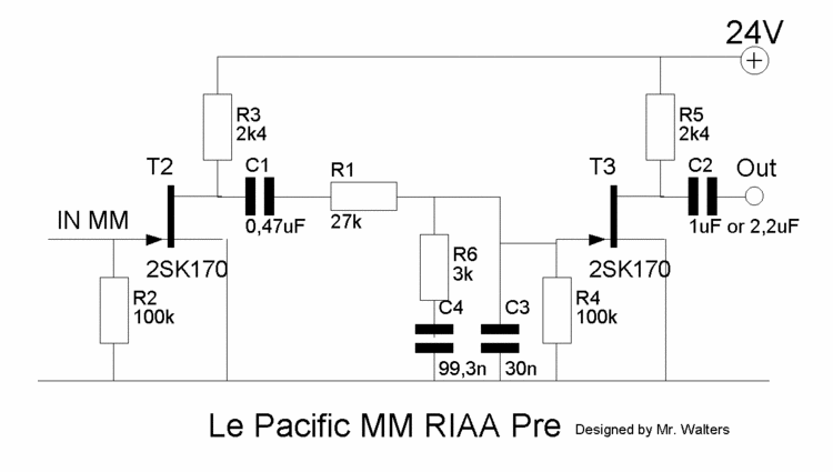

Today Im thinking why even have one transistor.
Lets see how simple we can go. i.e. passive RIAA.
Must have read over 200 pages.
But I like this one the best. It goes without saying. That I will have to enter up all of these in spice. And then the real work starts. Im still stuck at thinking about the input signal to the spice modell. Should I go with a simple mv sine wave. Or do I use one of the fancy circuits people have made to simulate a MM cart.
So much info to process so little time. But its all fun. When you learn something new everyday.

In post 32 I claimed that the Sony had some common traits with the Self design in the OP.
Seems I was fooled by the style of drawing, not looking at the actual topology.

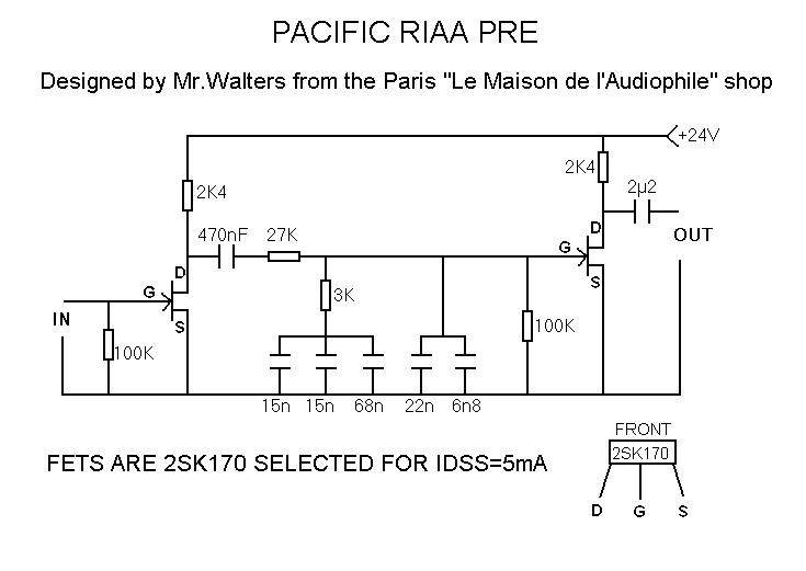

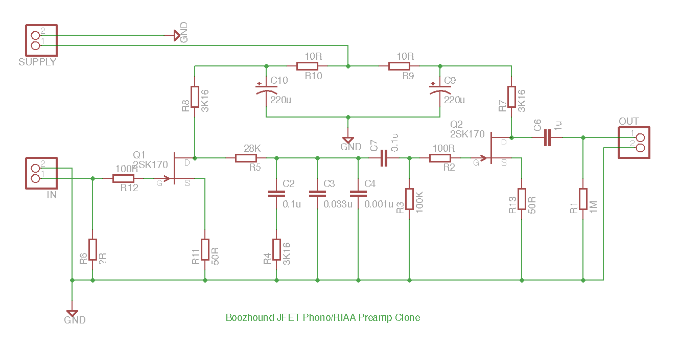

..........Lets see how simple we can go. i.e. passive RIAA...........
As simple as it goes with passive EQ, that must be the Pacific RIAA with JFET as per post #22 above
