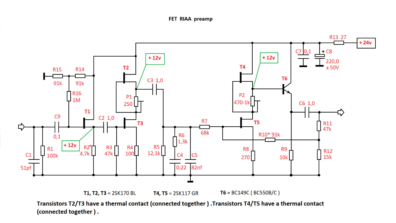

Simple Transistor based RIAA
A scheme with a passive RIAA . But not the simplest scheme . Transistors should be selected in pairs . This circuit gives a good sound . It 's better than Le Pacific .
The scheme from the publication Elektor ( 2004 , No. 1 ) is taken as a basis . I changed the original circuit - changed the T1 bias circuit , and applied other transistors .

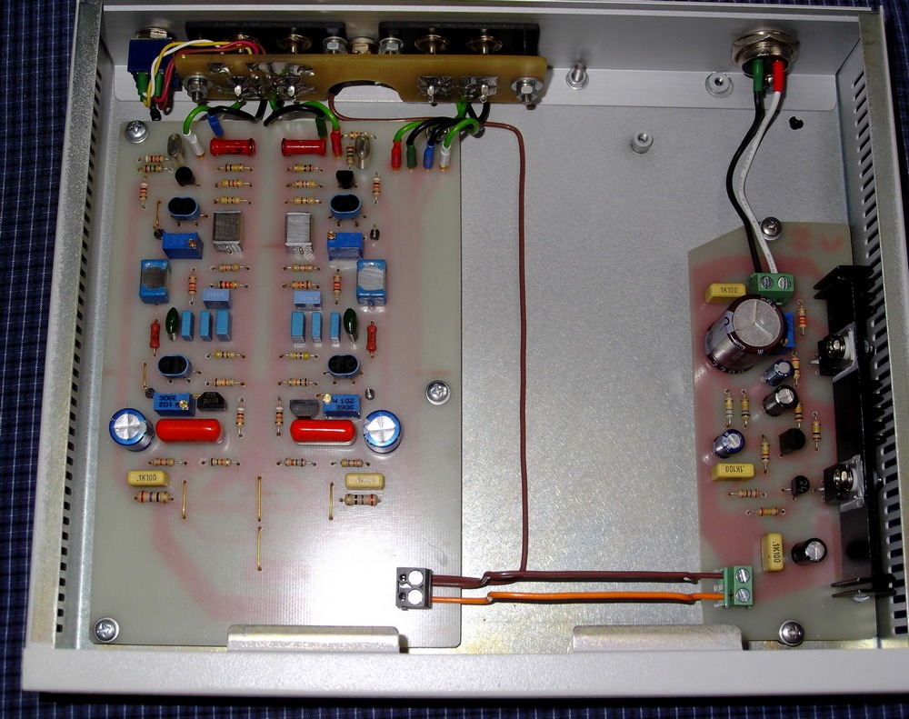

The photo shows my version of the scheme . I built this preamp 2 years ago .

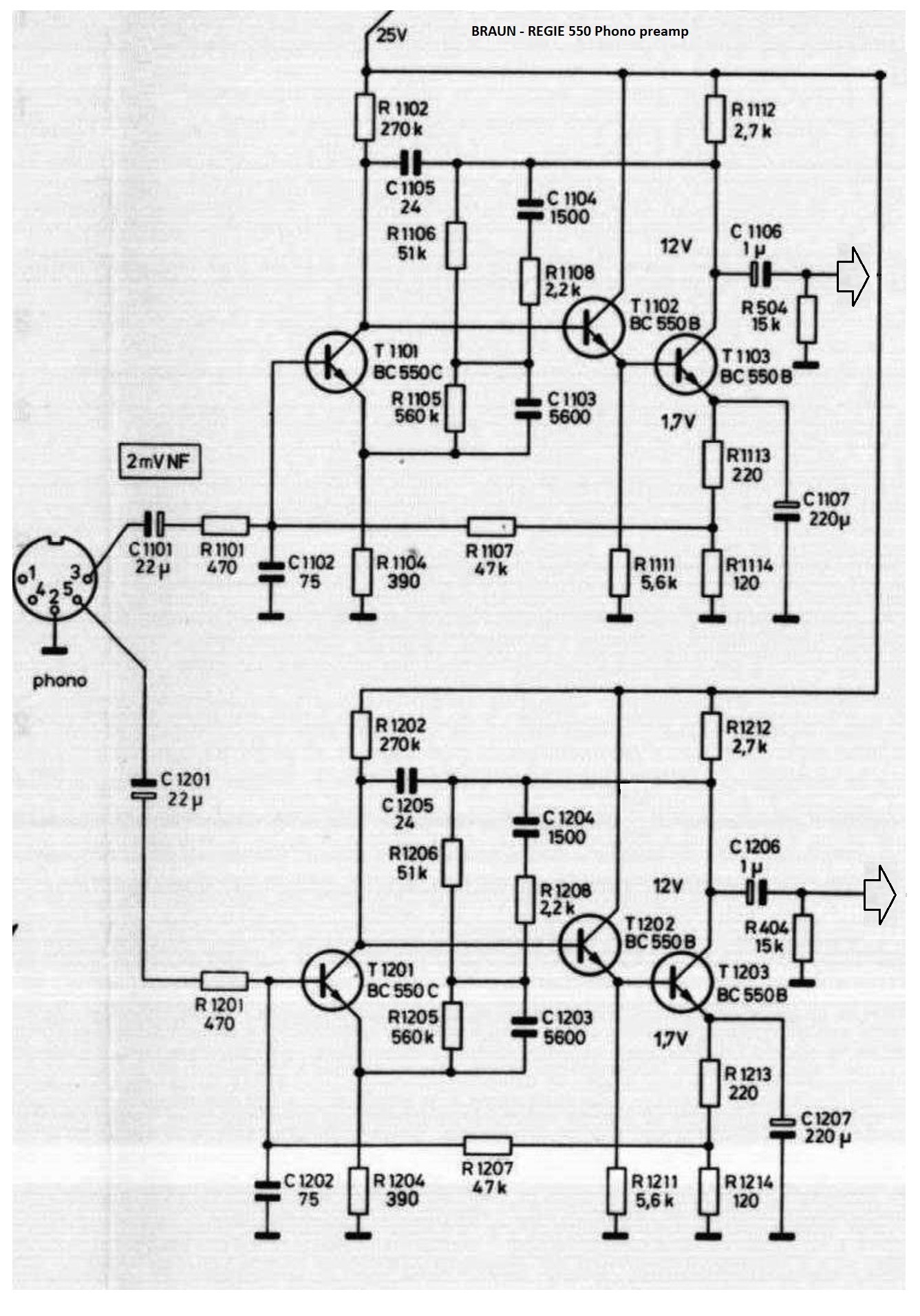

The simple phono preamplifiers are full of electrolytic capacitors. Those are problematic in multiple ways. The designs are from the time when transistors were expensive.
A good preamplifier takes more than two transistors. Transistors are nearly free on ICs and still inexpensive in discrete form today.
Ed
A couple of schemes of 2-transistor topology. The second transistor is Darlington .

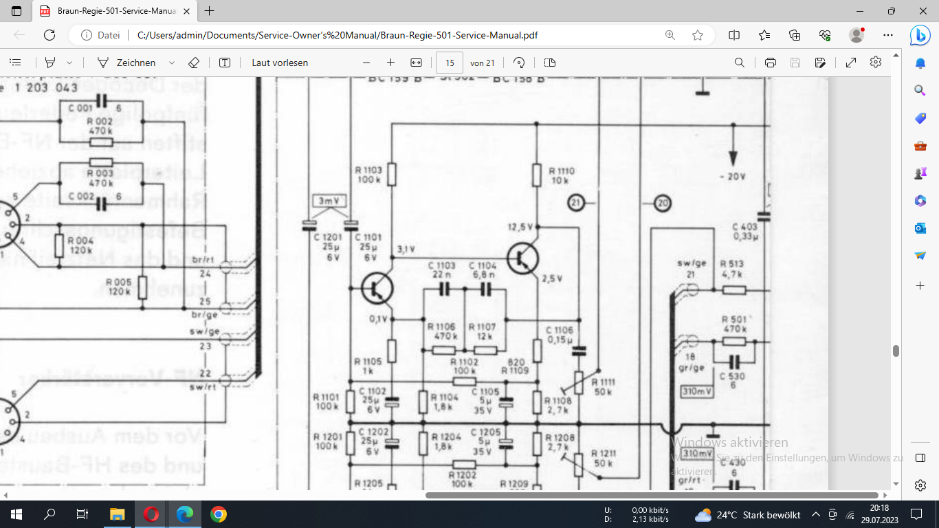

The RIAA stage of BRAUN's Regie 501 uses also a 2-transistor topology (go to the attachment), but slightly different in some details - especially the use of R1102 (100K bootstrap resistor). The effect is nearly the same as the use of a FET instead a BjT input transistor.
Under
https://radio-bastler.de/forum/showthread.php?tid=19414
some images of this model and unter
https://elektrotanya.com/braun_regie_501_k_sm.zip/download.html
you will find the service manual.
