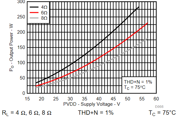

I built an active speaker with a 24V battery some time ago, a DSP ADAU1701 and two TPA3118 and it sounded quite good and loud. I wanted to increase its power and I bought two TPA3255 but the problem is that it has not increased as much power as it should and investigating I have discovered which is because the input sensitivity of the amplifier is 2Vrms and the output of the DSP is 0.9V is there any way to decrease the input sensitivity or increase the output of the DSP? Would it help to change the OP Amps? The specific amplifier is this

This is because the 24V battery limits the output power.I bought two TPA3255 but the problem is that it has not increased as much power as it should...
Im using a 24V to 36V converterThis is because the 24V battery limits the output power.
I don't have the schematic of the amplifier but do you think it would be very difficult to find it with the multimeter?The op-amp gain is set by resistors. You just change one resistor (per channel) to make the gain whatever you want. A schematic with values would make that easy.
The best resistor to change is the shunt side of the op-amp feedback divider, and maybe the associated capacitor. First you have to identify the op-amps, single or dual? Then draw out enough of the circuit. If I could get a good close-up it would be obvious as the R values are on the silk screen, but without solid information, sorry, I'd probably get it wrong.
To get twice as loud you will need 10x power.
So you may be on a hiding to nothing.

Okay, so a couple of things to go over first:
If you're still running the same power supply, you have not much more potential for increased power than with the 3118 chips. The only improvement is heat dissipation of the chip. To get more potential power, we need more supply voltage.
If your 3118 board has higher input sensitivity, it probably gets louder than the 3251 board. I had the same problem with a similar build this year. My board, the shui yuan 3255, has a 10k input shunt and a 10k feedback resistor. I got double input gain from it by finding the input resistor and piggybacking another 10k resistor stop the existing one. My source didn't mind the reduced input impedance, so it worked like a charm. Your mileage may vary.

TPA3251 is more optimized for 36V.Im using a 24V to 36V converter
With the voltage increase from 24 to 36V the increase of power is a little bit over 3dB, if you push the supply voltage over 40V you get another 3dB increase for 6dB total. At around 50V you gain just a bit more control over speaker cone movement if you limit yourself to that +6dB, so slightly less likely to ruin the speaker drivers if you run them hard over longer periods of time.
