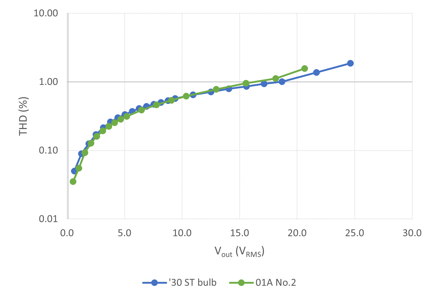

Plotting THD as a function of Vout, the typical ’30 performs very much like the typical ‘01A. In this circuit, gain is about 6.5 and the distortion is low (typically around 0.6% at 10VRMS out), comprising almost entirely 2nd harmonic with the 3rd emerging at higher output voltages (FFTs from AudioTester via a SoundBlaster sound card all alike and not reproduced here).

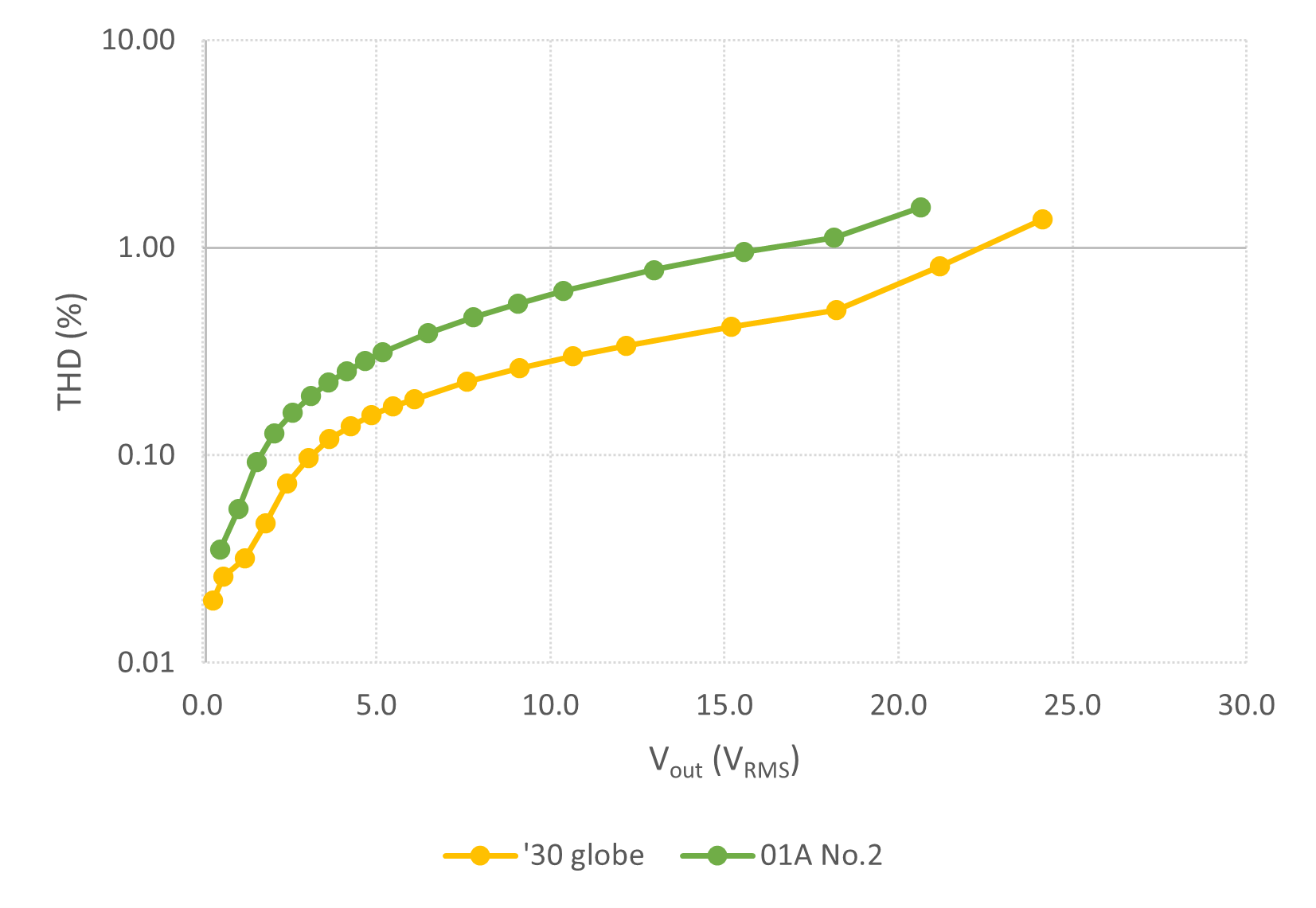

Included in the tests were four ‘30s in S-14 globe bulbs (the other 10 were in ST-14 small-shouldered bulbs). Of the four globe '30s, two behaved just like typical ST ‘30s while two were very low distortion devices. Very low ….

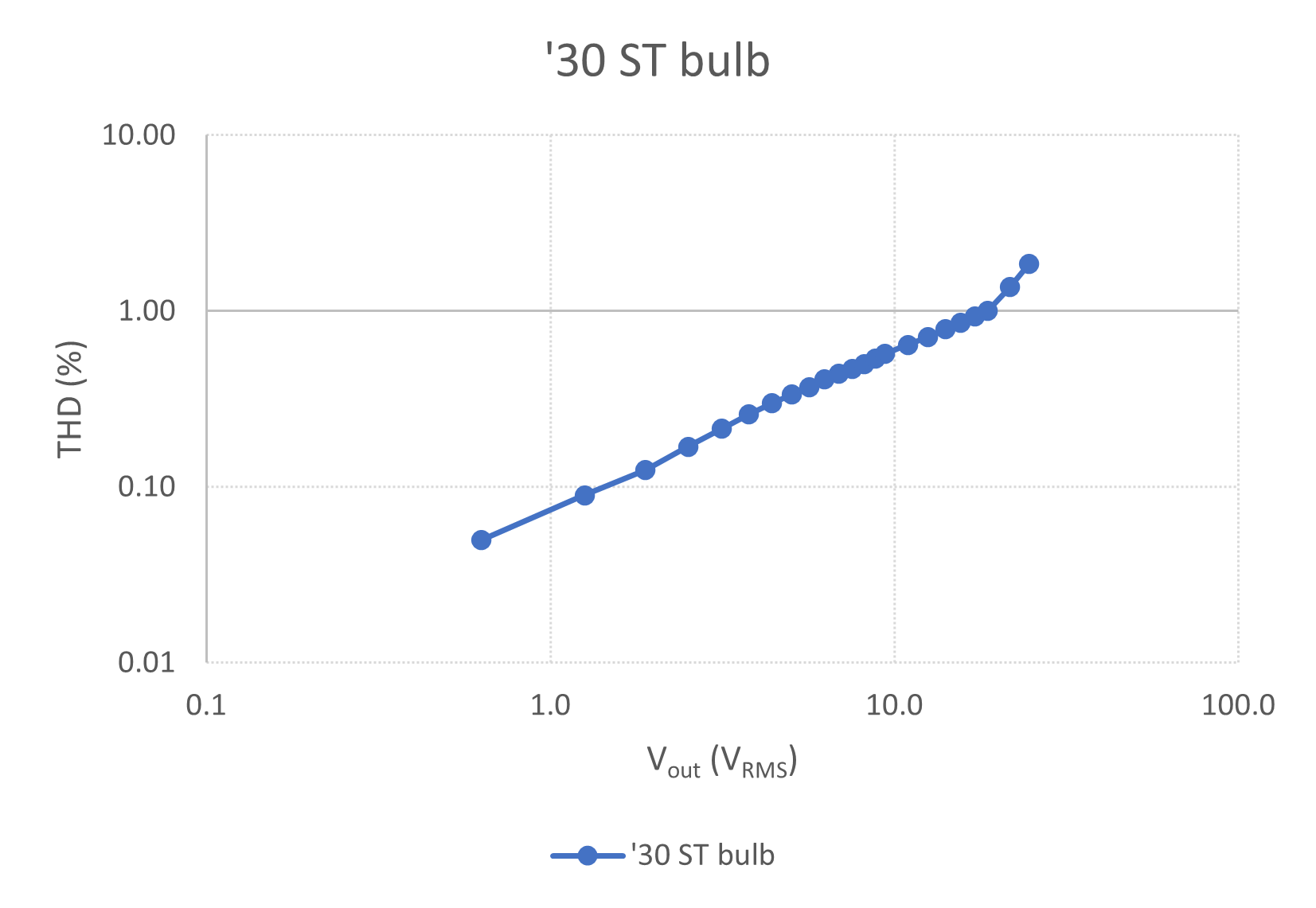

Well-spotted :) The log-log chart attached is for a typical '30 in the ST-14 bulb. Discarding the two data points with highest THD and output voltage, the rest fall on a very straight line. Analytically:
For most '30 and '01A valves tested, c=1.25 calculating using logs in base 10. Using natural logs in base e , c=2.75 for most valves tested.
For the pair of low-distortion globe '30s, calculating with logs in base 10 gives c=1.55

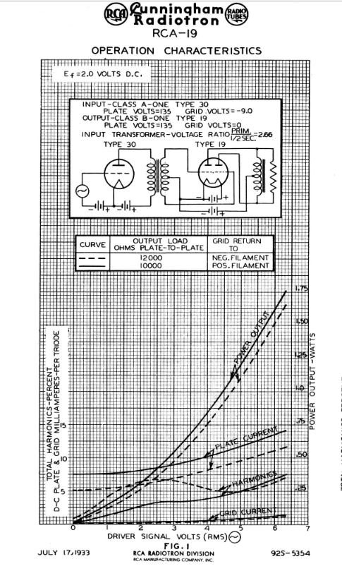

In my experience, 01A and 30 both sound good, but they have different flavors. 30 may be terribly microphonic when used as driver or preamp tube. Not surprising given its flimsy filament, 30 was primarily intended as Class B output tube in battery receivers.

Thanks, jhstewart9 - I hadn't looked at the TungSol data sheets before and, just as sser2 says, there is class B operation plain to see. :oops:

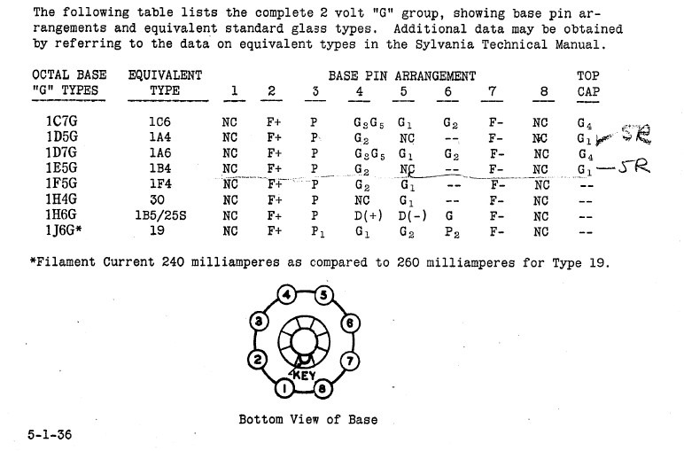

And it's reasonable to think that the octal 1H4G in the ST-12 bottle is likely to behave much like the 4-pin '30 in the ST-12 bottle - the stem, heater suspension and mica supports look very similar and I may yet take the 4-pin base out of the test circuit and replace it with an octal base to test a few 1H4Gs by way of comparison. I have attached a table of pre-octal valves (including the '30) re-based as octal and registered by Sylvania in 1936 that may be of interest to other experimenters.

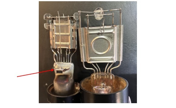

To get a better handle on the matter, I removed the glass from a dud '01A and a dud '30. Both filaments were "V" shape, suspended by a hook at the top and were similar in length (approximately 54mm for the ‘01A and 48mm for the ’30) and diameter. In the centre of the image below can be seen the silvery filament removed from the ‘01A (green arrow) laid across the pale remnant of the filament of the type ’30 (red arrow).

It is worth considering that the filaments alone do not determine microphonic output:
  • Viewed from above, the control grids of both valves spiral around their respective filaments in a flattened oval or “race-track” profile.
  • The ‘30’s “race-track” is narrower than the ‘01A’s – it is 1.35mm at its widest compared to 2.30mm for the 01A, so that the ‘30’s filament is closer to its control grid than is the ‘01A’s.
  • Both types’ grid and filament are enclosed by anode plates, spaced wider for the ‘01A (6mm) than the ’30 (4mm).
So let's say that the filaments of both the ’30 and the ‘01A are vibrating at (say) 0.1mm peak-to-peak - this would represent a 7.4% fluctuation in the filament to cathode distance for the ’30 but only 4.3% for the ‘01A, with a correspondingly greater effect on the electrical output of the ’30 compared to the ‘01A. All other factors being equal, the closer spacing of the ‘30’s electrodes is likely to make it more susceptible to microphony than the ‘01A.

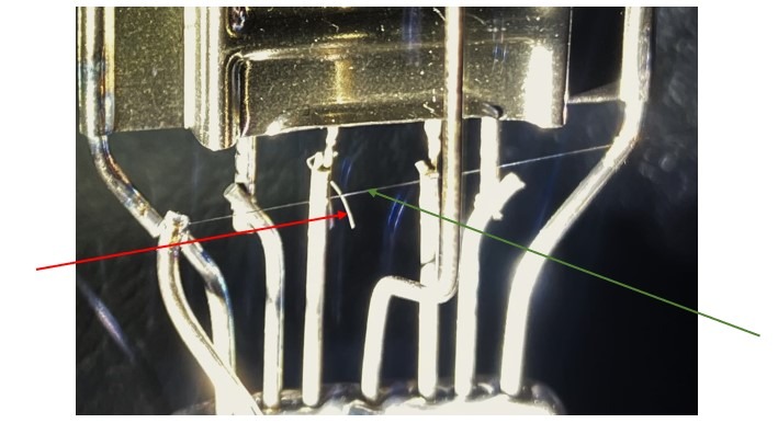

The '30 that I opened included a potential resonant structure in the form of a small getter tray (see the red arrow in the attached image) welded by a connecting rod to the ‘30’s left-hand anode supporting rod near the top of the stem. The tray is cantilevered and is a prime candidate for resonance – in which case it would vibrate the anode and other electrodes. While the getter tray may (or may not) be present in other type ’30’s, it is not present in the type ‘01A which uses other means of gettering.
Mitigating against the effect of the '30's getter tray are the mica insulators at the top of the ‘30’s electrode structure which press up against the inside of the shoulders of the ST-14 envelope, limiting the amplitude of vibration while tending to raise resonant frequencies. By contrast, all the electronic elements in early valves like the ‘01A and the S-14 globe bulb ’30 “sprout” from a cantilevered glass stem rising from the base. In the case of the ‘01A, the cantilevered stem stands free, enclosed by its glass envelope and free to resonate unconstrained like a tuning fork.
