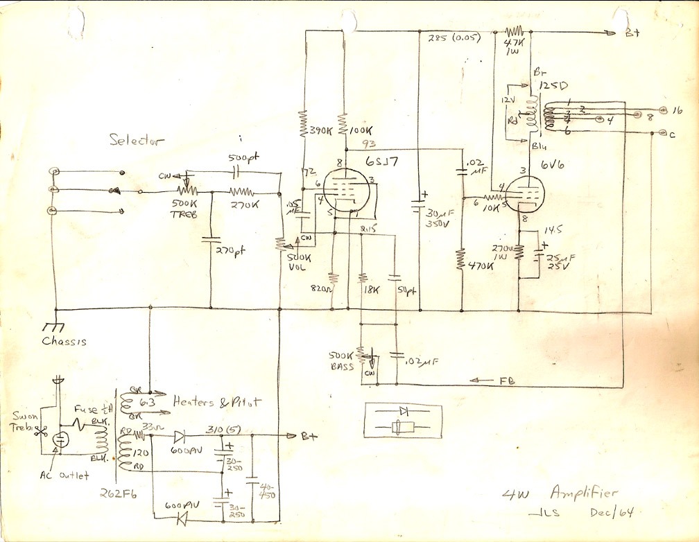

Here is an example of a 6SJ7 / 6V6 amp that was actually built just after the Earth cooled & I still had hair, Dec 1964.
I did this simple amp for a friend using scrap parts to be used with his turntable equipped with a crystal pickup that was a low cost but effective way to go.
The low frequency response control is in the NFB lead while the Treble is in the input signal path. Something used in many low cost amps,
Remote cutoff tubes like the 6SK7 are not suitable for audio, these are designed from the ground up with curvature,
used to control gain in RF & IF amps in receivers.
The PS is a full wave doubler based on what was a low cost Hammond Transformer. Notice the extra cap at the HV terminals of the doubler.
No fancy toobz or otherwise, it just worked (y)
