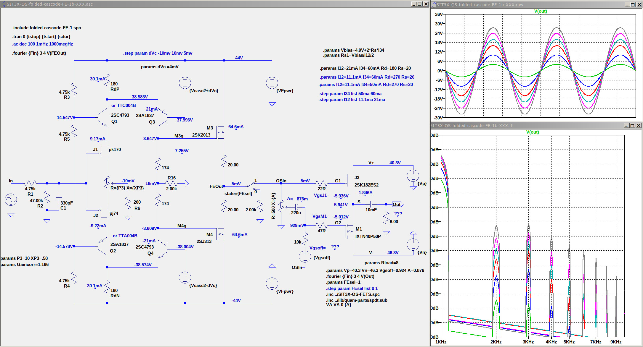

In the newer schematic, it seems that the cascode transistors M1 and M2 can be substituted for a wider variety of small Mosfets, perhaps even some from the ZVN series, such as ZVN2106A and ZVP2106A. M3 and M4 are handling the workload of driving the output stage.
Here is the folded-cascode FE driving the SIT3X OS.
It would be useful if we could find some SPICE models for the folded cascode FET and BJT alternatives. My suggested parameter requirements are:
  • M1/M2 (2nd stage of folder cascode):
    • Vds(Vce) >= 80V Watts >=1W
  • M3/M4 source follower output stage:
    • Vds >= 80V Watts >=3W
Just for fun, here are some models for the lateral Mosfets that I would try in place of M3/M4.
Also probably close enough for the old Hitachi parts and the newer Exicons.

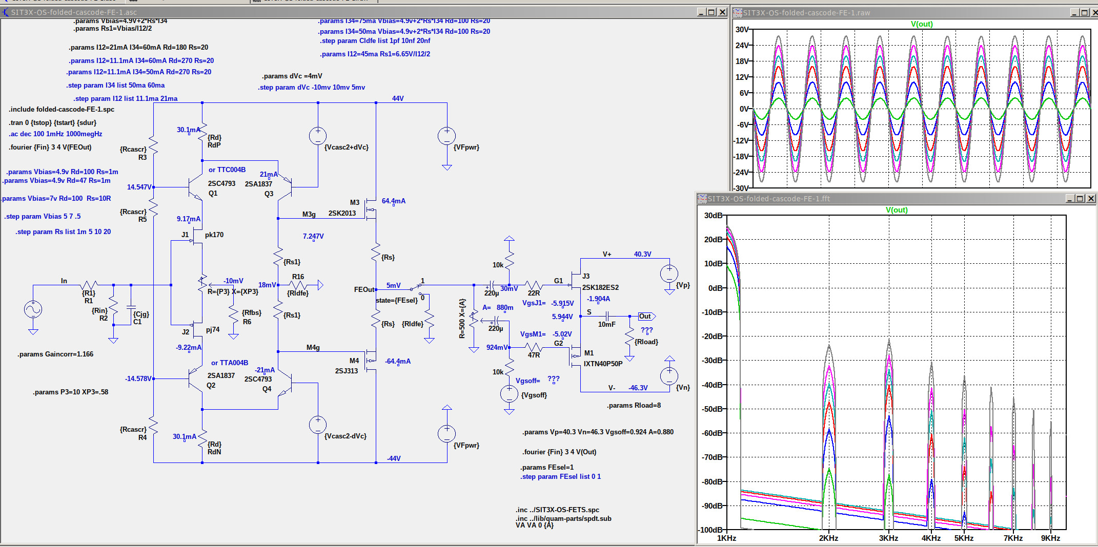

Pushing around equations today (no solder fumes) to better understand WHY the distortion cancellation circuit works. All of my previous analysis was of the 1st order small signal behavior which does not include any non-linear harmonic behavior. I do not know if my attempt at 2nd order behavior will succeed in discovering anything useful or not.
