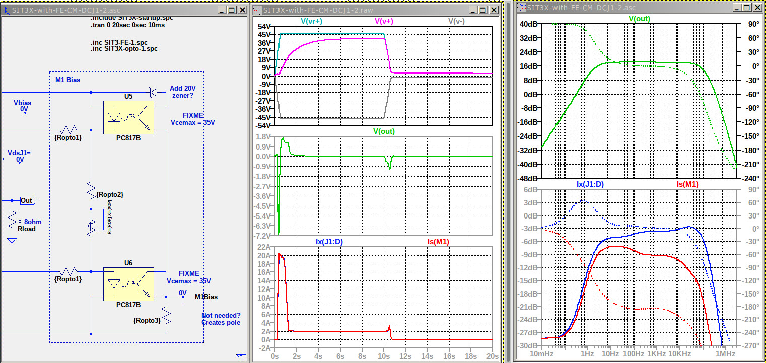

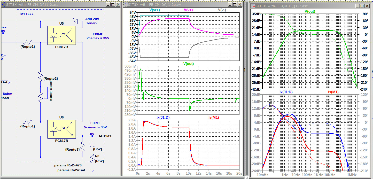

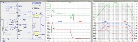

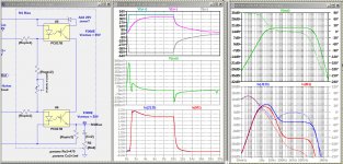

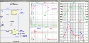

The first image below shows the power on/off behavior of the circuit shown in post #157 and the AC analysis. The "thump" in Vout is quite acceptable, but the AC analysis is troubling at low frequencies. That problem is due to a pole created by the combination of Co2 and Cx driving the gate of PFET M1, which is totally eliminated by removing Co2. But eliminating Co2 creates serious power up/down thumps as shown in the send image.
I am trying to figure out a way to switch out Co2 after a time delay. Any suggestions?

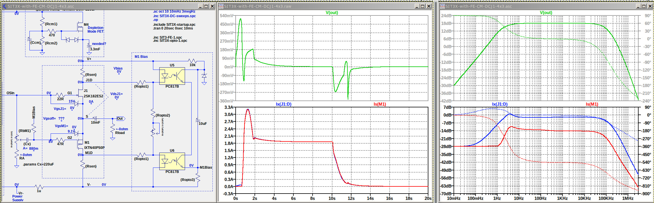

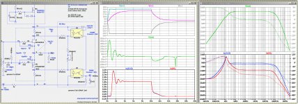

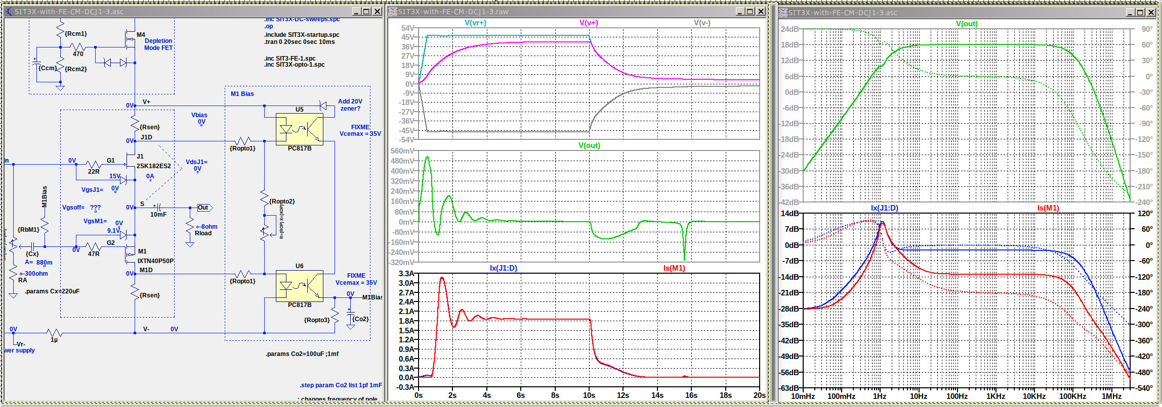

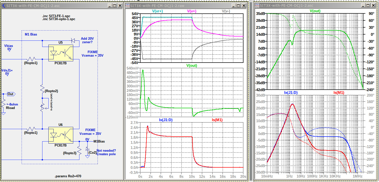

I think I found the capacitor values that produce good results for both power up/down and AC analysis. Increasing Cx from 10uF to 220uF and reducing Co2 from 1mF to 100uF gives the results shown below:

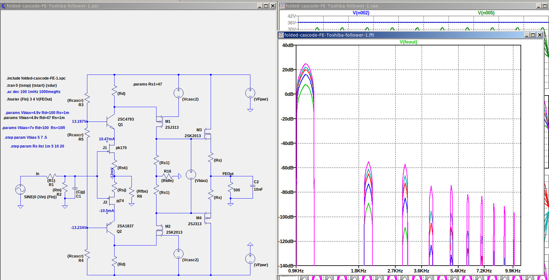

Here is a complementary folded cascode, non-feedback front-end that looks promising. At 28V peak outout, the THD is <0.02% into a 500R load shunted by 10nF capacitance. There are details yet to be revolved for controlling the bias to the follower stage, and tweaks to parameter values.
Since Nelson doesn't count cascodes, after adding the output stage there would be only 3 gain stages, but I am not sure whether the folded cascode should be counted as a gain stage or not. But the result would be a very low distortion 50W amplifier without any feedback loops. I haven't yet done a simulation of the complete amplifier.
