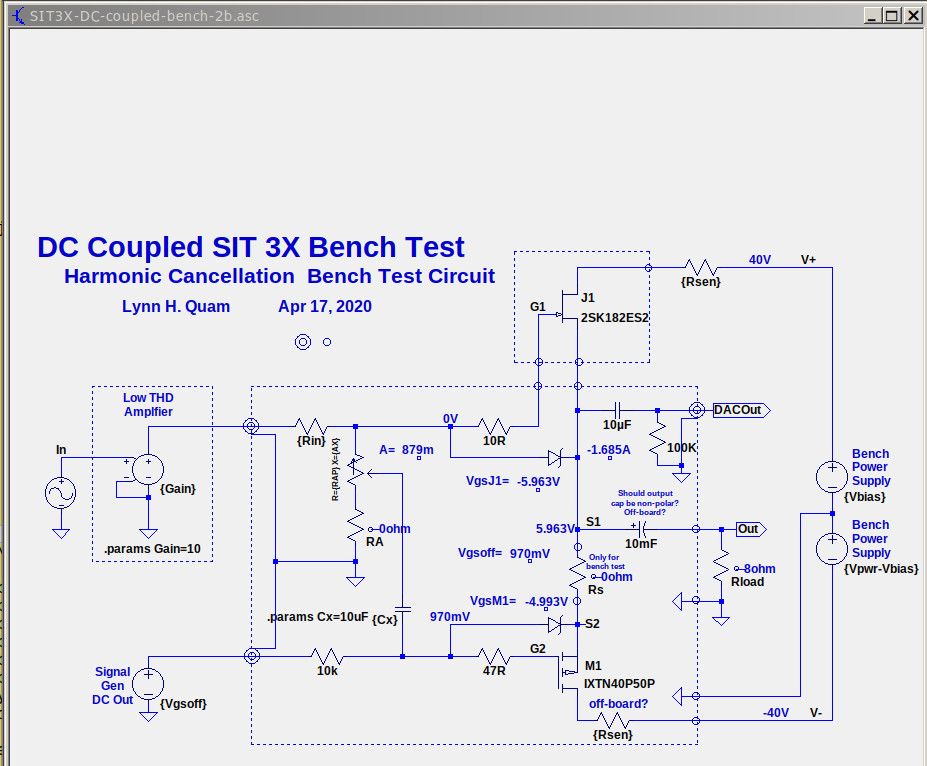

Next step: bench tests using the circuit shown in second image.

Just curious, would moving point 'A' to the load be beneficial?
I also looked at equations for that circuit and the behavior certainly allows gm matching, in much the same way as degeneration. Thus far I cannot find circuit parameters that provide harmonic cancellation. In that circuit, the pot changes both the Vgs offset between the FETs and the effective gm of M1, making the parameter search somewhat more complicated.
don't forget Schade tricks, if you want to alter Mosfet's behavior
as seen in my fun with Schade M2 ( my Uncle Bubba Flocchini is one of rare Greedy Boyz who tried it), there is no big price paid in frequency domain, when source follower arrangement is in case
After closer examination, the circuit equations for source degeneration of the PFET M1 vs. a resistor divider between Input, M1gate, and M1source are equivalent.
For both cases, the only situation where harmonic cancellation is possible is when there is no degeneration, the transconductance of the PFET is "optimal" for the SIT operating point. This is because source degeneration inherently introduces harmonics.
With the attenuation of the input signal as shown in post #142, no harmonics are introduced due to degeneration.
Thank you lhquam for the explanation; I suppose on reflection, It would be the inverted ac difference between the IN and S1 that needs to be injected into M1 to cancel the SIT harmonics, but not M1's.... not sure if performing the same trick for M1 could be done without making an oscillator.
There is some magic going on related to the triode nature of the SIT. My equations describe the small signal behavior of the circuits and do not say anything about the harmonic structure, which would require more complete mathematical for the SIT and PFET, making the systems of equations too complicated for direct solution.

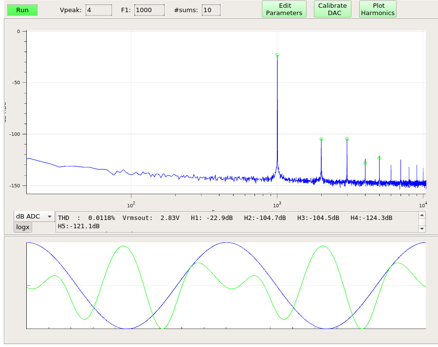

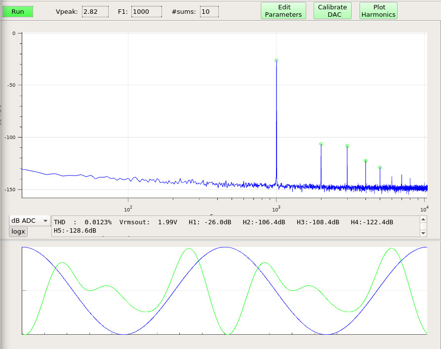

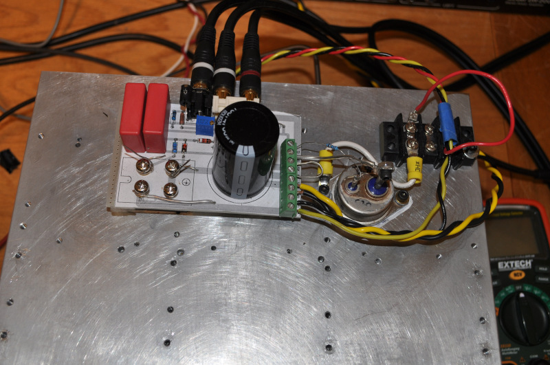

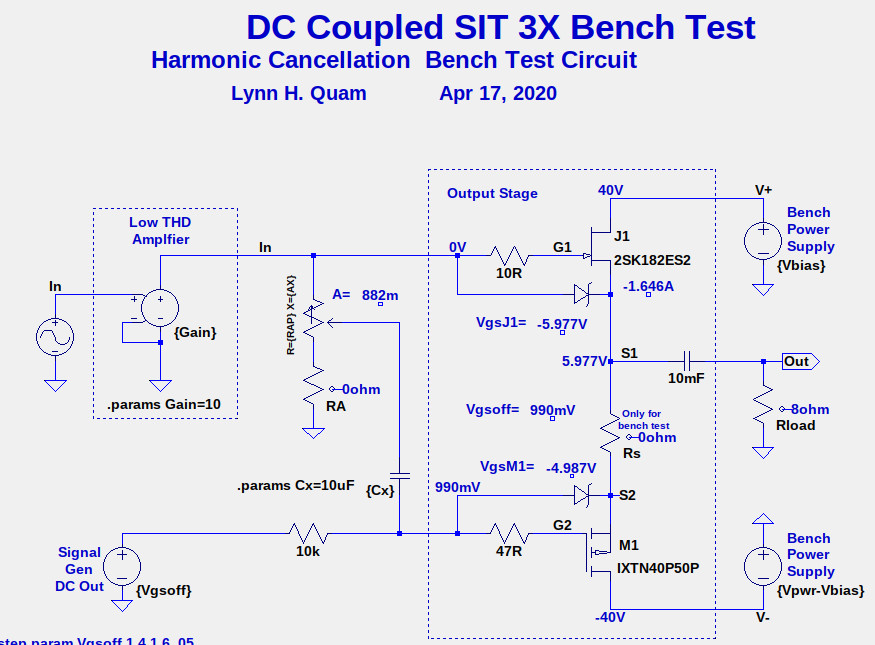

SIT3 harmonic cancellation works:
Finally, some bench measurements of the harmonic cancellation. Below are the bench test circuit, a photo of its build, and spectra of the at 1Khz, 1Watt, and Rload=8 and Rload=4. The M1 PFET gate input is adjusted for the "sweet spot". The operating point was:
  • Vds(J1) = 34.5V
  • Ibias = 1.8A
These measurements agree well with the simulations, but thus far have been limited to 4VPP because of the input source. The 1st image should show Gain=1, not Gain=10.

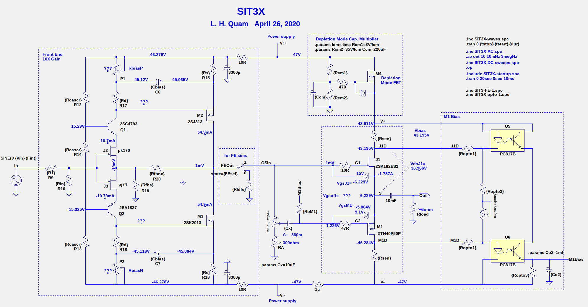

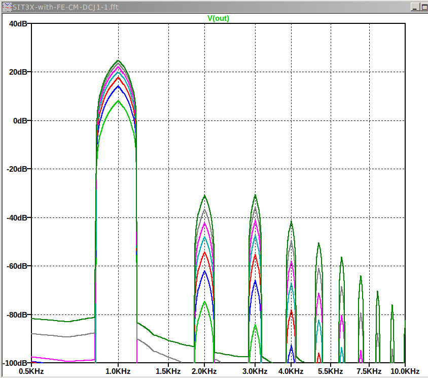

I have made considerable progress on a complete design of the 50W/CH Tokin 2SK182ES based source follower amp without and degeneration in the output stage. The front-end still requires feedback in order to provide sufficiently low output impedance to the OS. The specs in the latest design are:
  • 2SK182 SIT IXTN40P50P PFET
  • No feedback around output stage
  • adjustable attenuation of signal to PFET gate enables distortion cancellation
  • XA25 based FE with feedback from FE out
  • Optocoupler bias current control
  • Depletion mode capacitance multiplier on SIT drain
  • At 1.8A bias current, +/-47V rails
    • THD<.01% at 1W
    • THD< .1% at 25W
    • THD<.25% at 50W
  • <100uV PS ripple
  • Startup/shutdown "thump" tests look ok
Images below show the schematic and spectra at 1W, 4W, 9W, 16W, 25W, 36W, and 49W.
