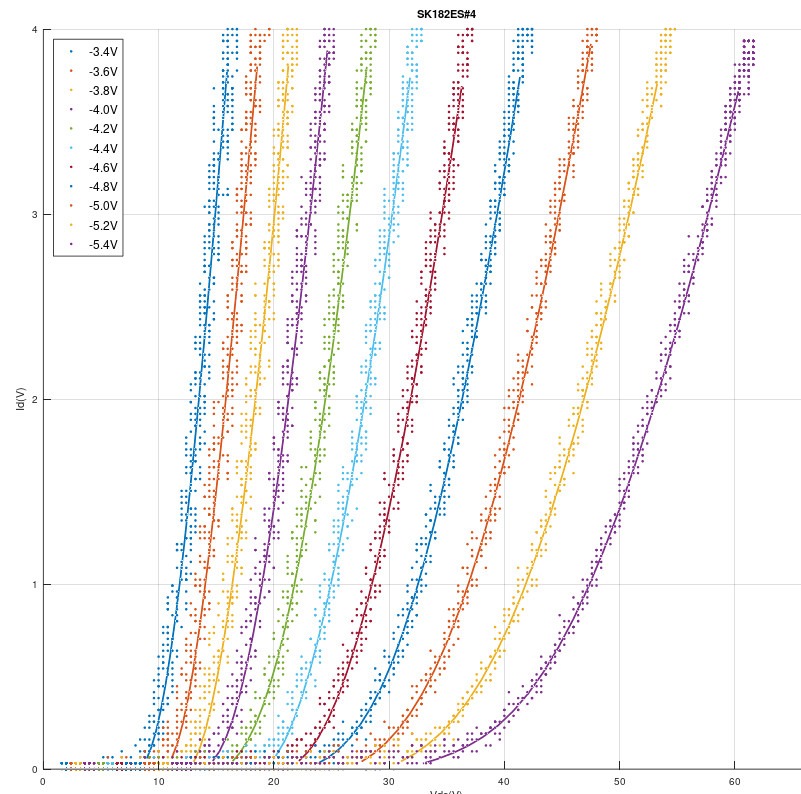

In the first plot, the "raw" FrankenTracer data captured from my Rigol DS1054Z digital scope is shown as dots. The "ragged" nature of the data is due to quantization by the scope's 8-bit ADC. The solid lines show the data after smoothing is applied.

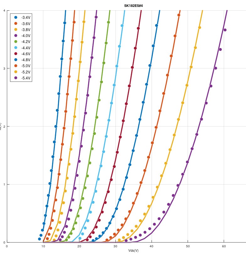

In the second plot, the smoothed FrankenTracer data is shown as dots. The solid curves show the SIT model least-squares fit to that smoothed data. The SIT model parameters for 2SK182ES#4 are:
MU = 133.57​
N = 1.2592​
K = 4.6096​
Vct = 0.7153​
X = 2.4821​

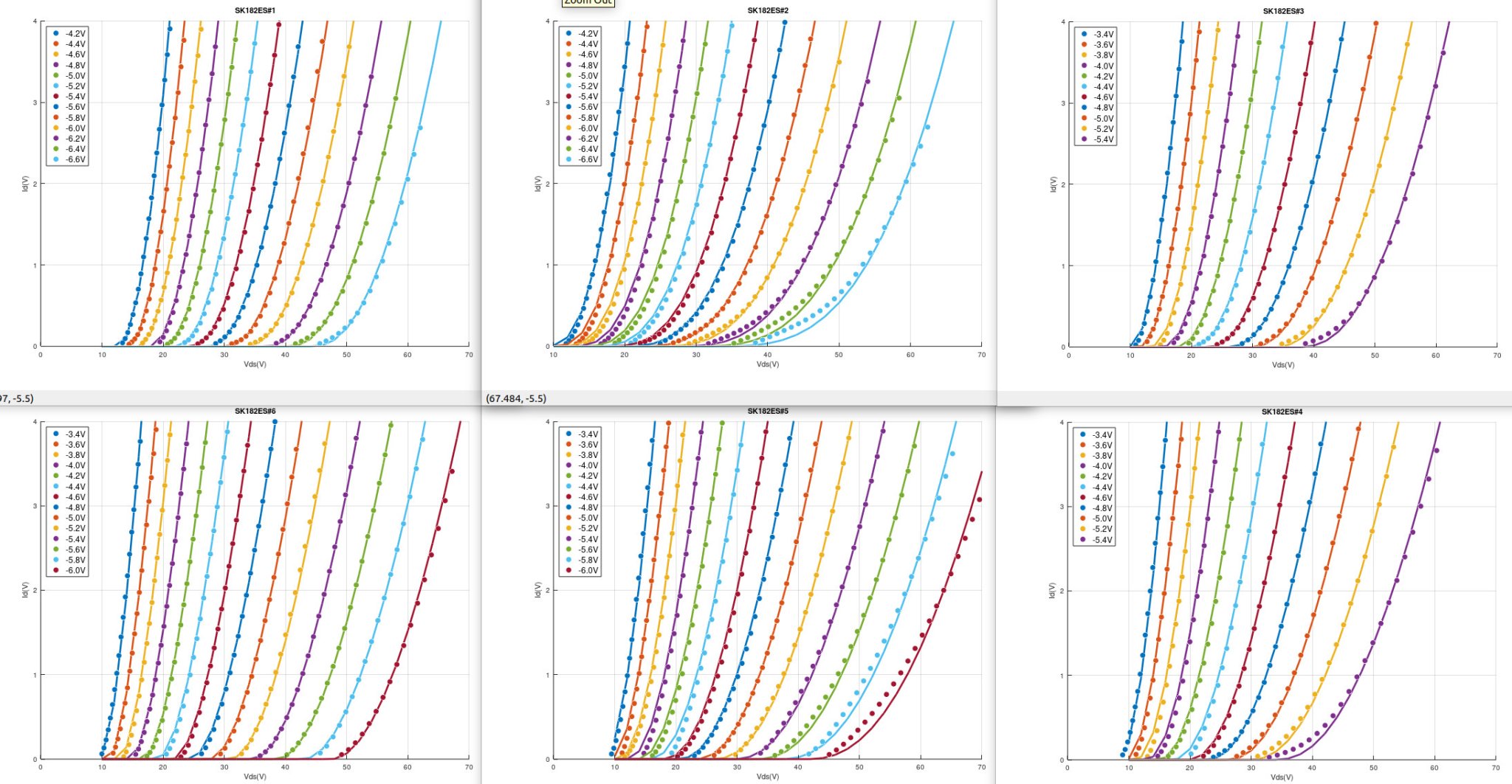

The final plot shows a collage of the Rothacher SIT model fits for all six 2SK182ES SITs.
The least-squares model fits look very good except at the low Id drain currents. There are several possible explanations for this:
My instrumentation Id measurements have a bias offset.
The Rothacher SIT model doesn't capture the load current behavior.
My least-squares fitting isn't properly weighted.
For practical purposes, I am very happy with these results.
