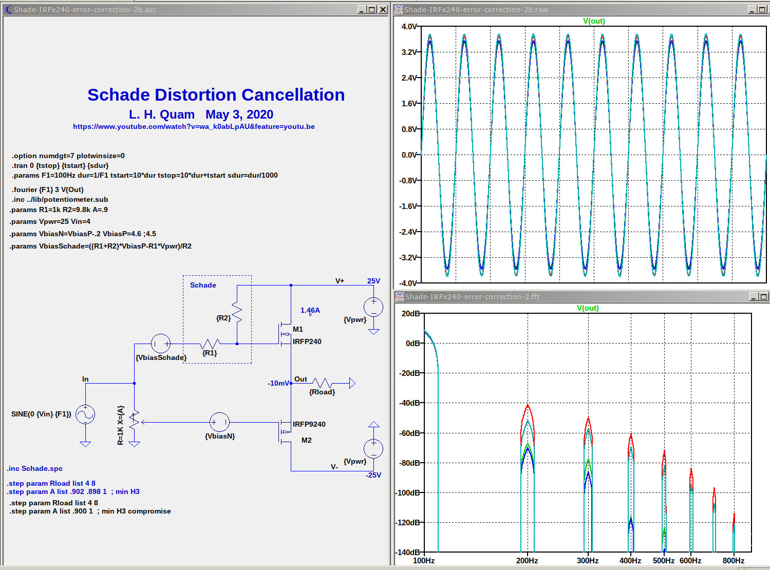

Schade Distortion Cancellation
While working on an explanation for SIT3X distortion cancellation I decided to see if Schade feedback actually behaved like a SIT in the SIT3X circuit. Here are the results using IRFP240 and IRFP9240 FETs. In the 1st image spectral plots, the colors are:
  • Rload A
  • 4R 1 red
  • 8R 1 cyan
  • 4R .9 green
  • 8R .9 blue

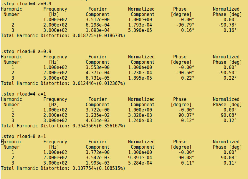

The value of A=0.9 was chosen to minimize H3 (3rd harmonic). The 2nd image shows the numerical .fourier for the spectra.
I did some equation pushing and derived the triode parameters of the simple Shade common-source circuit, shown in the 3rd image. It is important to note that μ is the common-source gain factor with a constant current source as a load, and gm[FET] is dependent in the bias current, thus the values of Rdrain and gm[Schade] change with bias current. Plugging these equations into the equations in post #142 SIT measurements, Mu Follower, and amplifier build should provide the cancellation behavior shown in the simulation.

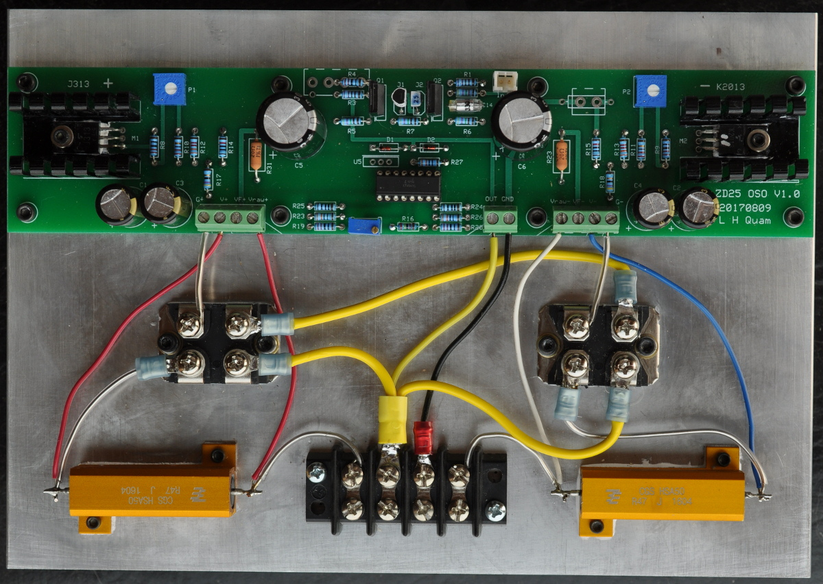

My personal inclination is to go for V(V+)=0, cap multiplier, folded-cascode FE, and 2nd gen XA25 opto bias. The PCB designs should be able to accommodate various combinations for the above options. I have been biased in favor of making PCB that conform to the UMS (DIYAudio Universal Mounting Spec), which I did for my ZD25 (similar to XA25), shown below:
That s the configuration I've been most interested in as well. I will be inclined to make some of the part substitutions I mentioned in the folded cascode front end. I have a couple different cap multiplier designs that I'm already working with.
Basic PSU would start with an Antek AN-10435, which has four 35V secondaries. I have a set of Prasi's CRC boards with the LT4320 based rectifiers. These can accept a cap multiplier in between the bulk supply caps, or not, as needed.
The UMS spec isn't a consideration for me, as the chassis I want to use doesn't have those holes drilled in the heatsinks. In fact, I can't think of a chassis that supports the necessary power dissipation and also has the UMS hole pattern. I've become pretty adept at drilling and tapping.

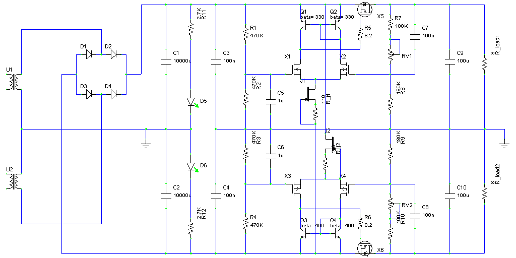

I am also getting impatient with myself. :scratch1: Here is the plan. There will be a new thread for the build. Although I have been calling the output stage the SIT3X, I haven't yet decided on the final name for this amplifier. I will clean up the schematic with rational partitioning and part numbers. Ultimately there needs to be a BOM, and PCB layout(s). Different folks might choose to do different PCB layouts to accommodate their packaging requirements.
I have been working on a variation of a low dropout capacitance multiplier based on one used by Mr Evil. It is not a simple as the "easy cap multiplier," but it has very low dropout by virtue of using a low RdsOn P-channel Mosfet.
Schematic is the positive portion of the attachment.
For the SIT3X output stage, some adjustments can be made:
R1 and R2 are 22k. C5 is 100 uF, preferably a low impedance organic polymer.
Q1 and Q2 are KSA992, grade F. X1 and X2 are ZVP3310A.
J1 can be a simple CRD such as E-562, taken to ground instead of the negative rail.
X5 is a IXTH52P10. R5 should probably be 47 Ohms.
R7 is 100k, RV1 is 100k, R8 is 220k.
C9 is 100 uF, same as C5. Add 4700 uF to 10,000 uF as needed for energy storage.
A protection diode should be added from the Drain to Source of X5. Probably 1N4003.

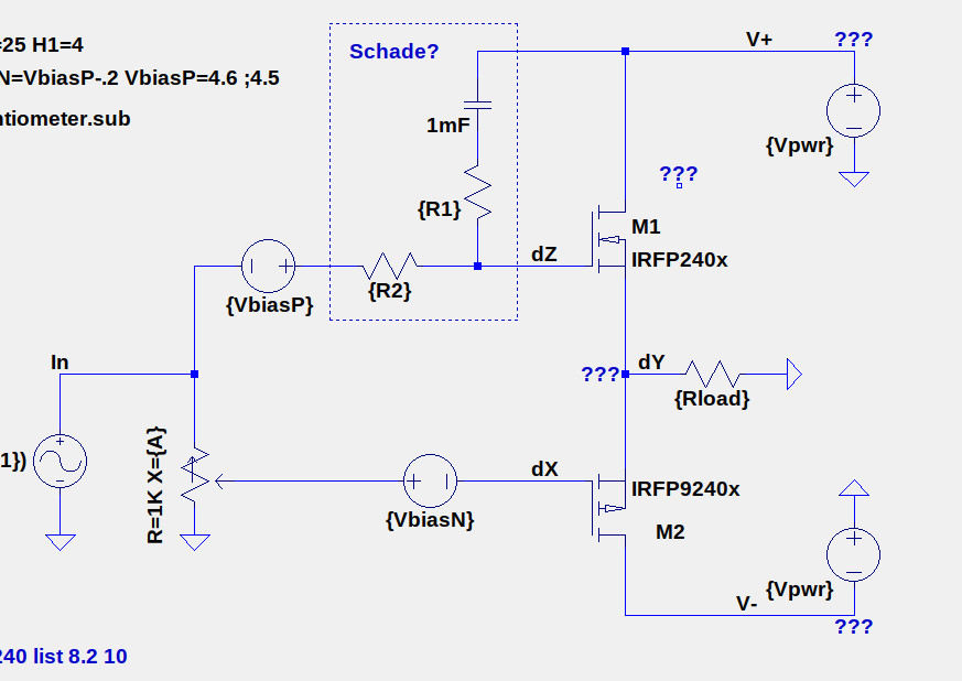

I am not sure that the circuit shown in Nelson Pass's 2015 Burning Amp video behaves that same as Schade feedback in my previous post (50w Single-Ended BAF2015 Schade Enabled).
I believe that the circuit behaves more like that in the schematic below, which behaves as simple feedback, without a dependency on the DC voltage on the drain.
Cancel post #209. I found an error in my simulation FFT and fourier results. In LTSpice I forgot to turn off data compression. I now get identical results to the circuit without the capacitor, except for a DC offset at the input. Both circuits provide harmonic cancellation with proper adjustment of the potentiometer.
