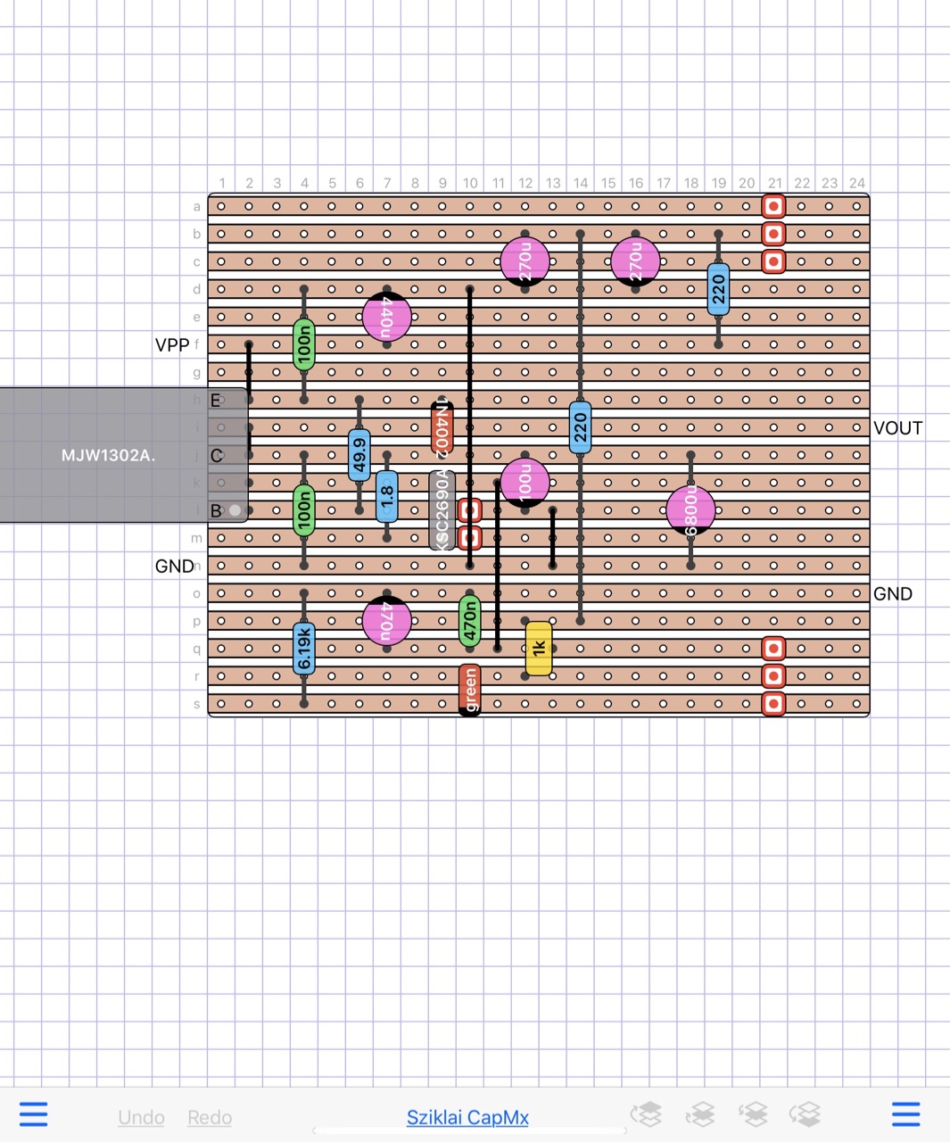

I need to make a correction to my notes in post #219:
X1 and X2 are ZVN3310A.
I had been ruminating about which of the cap multipliers to document, and suffered an overwhelming urge to write a post just before bed. Kind of like not having enough coffee.
The cap multiplier shown in the document by J. Hofland is an unusual implementation, which I believe has some weaknesses. This design formed the basis for the one suggested by M. Johnson, and the one eventually used in the SLB power supply. I used a slightly modified version of the SLB in my F6 with success, and the modifications I made were essential to the performance I was eventually able to get from it.
For the SLB, I substituted the MJW1302A for the power transistor Q10, and the KSC2690A for the driver Q9. I used a set of NOS Panasonic FC series 1000 uF caps in the C15 through C18 positions, as the quality of the capacitance being 'multiplied' makes a difference. After some listening to the F6, I finally added KEMET ALS70 series 24,000 uF capacitors to the outputs. These were necessary for energy storage, and make a very noticeable improvement to the sound of my amp. I will also note that the SLB includes a 1N4004 diode from the Collector to Base of the power transistor, as necessary to safely discharge the bulk capacitance on its output during power down.
The SLP works pretty well as a ripple eater, but has limited adjustment capability for output voltage. I am currently using another variation in an ongoing MoFo project. One of the things I have found is that the CFP type of capacitance multiplier needs some tuning to be optimized for the particular load it is presented with. The main change I've made to the SLB circuit addresses the limited adjustment capability. I replaced the 200R trimmer resistor with a 1k, and drove the base of the KSC2690A from the wiper terminal of the pot. The RCRC network now consists of 220Ω -> 540 uF -> 220Ω + potentiometer tap -> 470 uF, with a green LED and 10k resistor (recommended for SIT3X) to ground. Implementation is shown below.
This is still a work in progress to get best performance with my MoFo. It is likely that the SIT3X may need slightly different values. I think the Mr Evil version that I wrote about earlier is more general purpose, and won't need much tuning for best performance. That's why I covered it first.

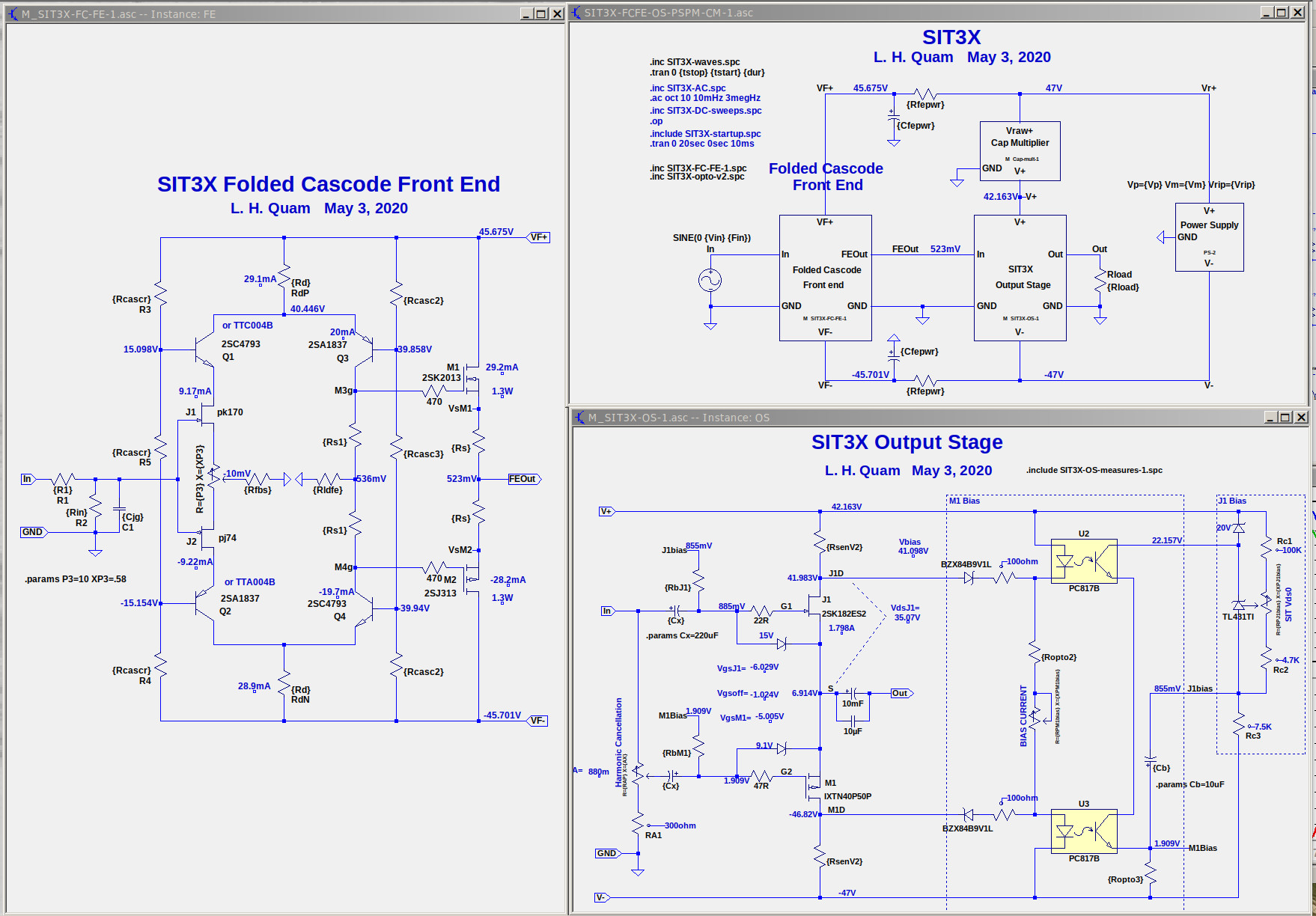

I have partitioned the SIT3X schematic into modules which are intended to correspond to the PCB partitioning. Two combinations of front-ends and rail voltages are shown in the images below.

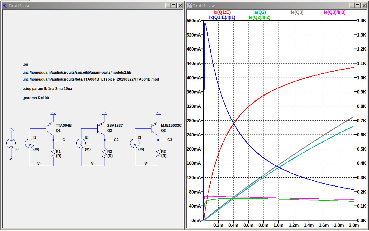

However, the 2SC4793 and 2SA1837 don't seem to be available anywhere,
Some other BJT alternatives for the cascode transistors are:
  • MJE253G PNP 100V 15W TO-225
  • MJE243G NPN 100V 15W TO-225
  • MJE15028G NPN 120V 50W TO-220
  • MJE15029G PNP 120V 50W TO-220
  • MJE15030G NPN 150V 50W TO-220
  • MJE15031G PNP 150V 50W TO-220
I plotted Ic vs. Ib curves for 3 PNP transistors for which I have SPICE modes, The TTA004B curves look suspicious.
