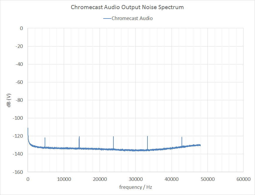

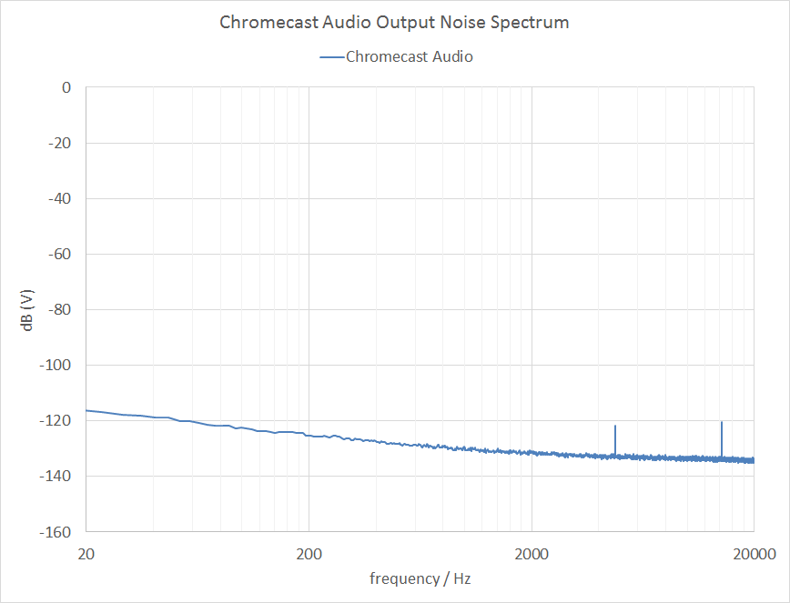

Chromecast Audio Output Noise
Posted 26th February 2016 at 12:11 PM by rjm (RJM Audio Blog)
Updated 27th February 2016 at 01:18 AM by rjm
Measured at 24/96 with my Asus Xonar STX soundcard (~ -147 dB noise floor)
The Chromecast Audio output noise powered with the included USB wall wart supply is -130 dB at 1 kHz, rising gradually at lower frequencies and showing some switching power supply noise peaks at 4763 Hz and higher multiples, never exceeding about -120 dB.
This is respectable performance given its price point.
