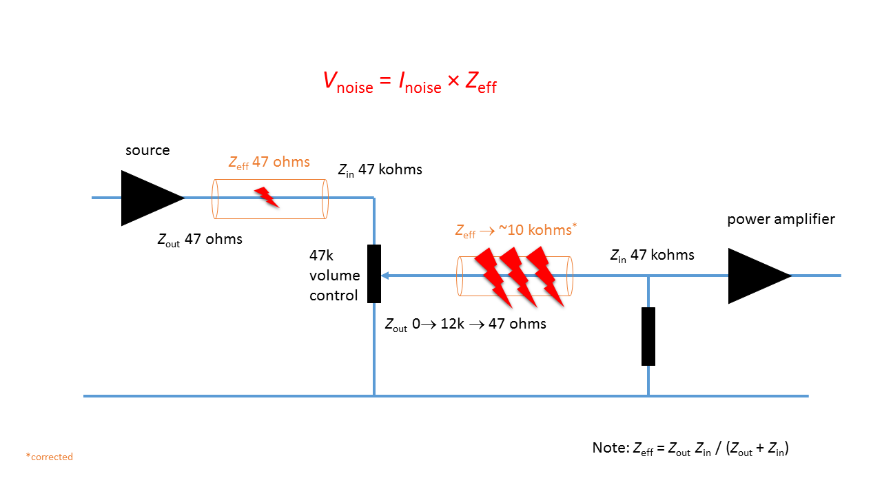

I actually had occasion to try this the other week. I had a box with a volume control followed by the bboard unity gain buffer and in preparation for replacing it with a similar buffer with voltage gain (a power-derated Sapphire 3) I removed the buffer and briefly used the box as passive preamp, i.e. just the 47k stepped attuator, with 1 m interconnects to the amp and 2 m interconnects back to the phono stage. Sure enough the system noise increased, depending on the position of the volume control, with some nasty low level buzzing interference.
Why does this happen? It's pretty simple really. Noise is usually induced as a current, and the larger the resistance (impedance) this noise current is forced to flow through to reach circuit common, the larger the noise voltage since by Ohm's Law, V=IR. Noise induced between the volume control and the amp is faced with the high impedance of the amp (47k) or the output impedance of the...

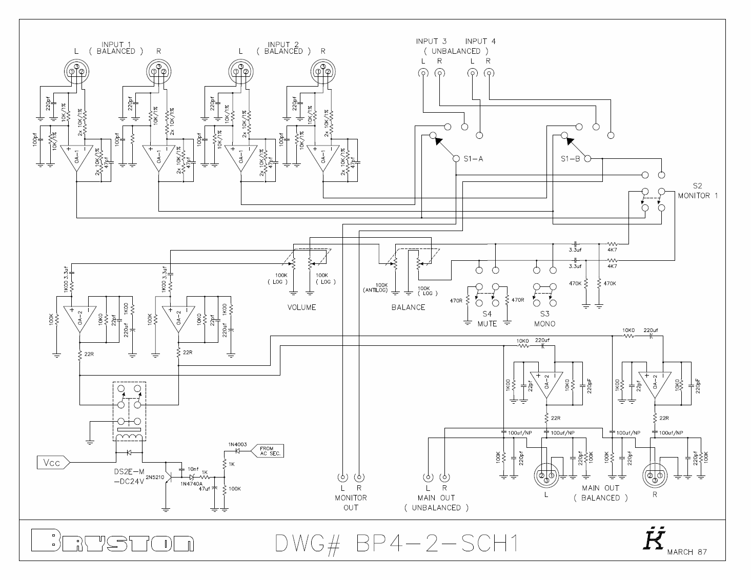

I'm often asked "which op amp sounds better".
The reply is usually a scowl and muttered "does it look like I care!?" Which is something of a lie... I do care about getting op amps to sound good. It's the phrasing of the question I dislike.
Op amps do not come in "good, better, best" flavors. All it is - and this is pretty obvious I would have thought but apparently not - all this is about is matching an op amp to the job it's going to do; the circuit it's going to be sitting in.
The op amp you'd choose to use as a DAC IV converter is different from the one you'd choose to back a 100k volume potentiometer in a preamp is different from the one you'd choose for an MC phono preamp input stage...
Why do you think there are like a thousands of different op amps to choose from in the first place? It's because there are thousands of combinations of op amp characteristics and properties ... not because companies...
