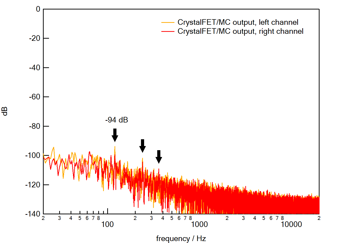

The Phonoclone 4 applies a major revision to the board layout, making it more logical with grouped, standardized I/O connections. The X-Reg has been replaced with the S-Reg shunt regulator circuit. Overall the BOM has been considerably simplified and the parts cost reduced.
Rev. 4.4s boards are back-compatible with earlier Phonoclone revisions, with the anachronistic 2.5"x3.5" mounting holes, so I can drop it into my existing chassis. 4.5b moves to 70x90mm mounting holes to be compatible with the Sapphire, VSPS200, and CrystalFET boards.
Build Notes
4.0b had some low level residual ripple on the output as a result of capacitive coupling or ground loop error. The boards were respun as 4.4s (special test run, limited, unsexy green color) which work as designed. The next wide release is 4.5b.
The BOM and board connectivity checks, no issues.
The Bourns trimmer, R21, comes from the factory...

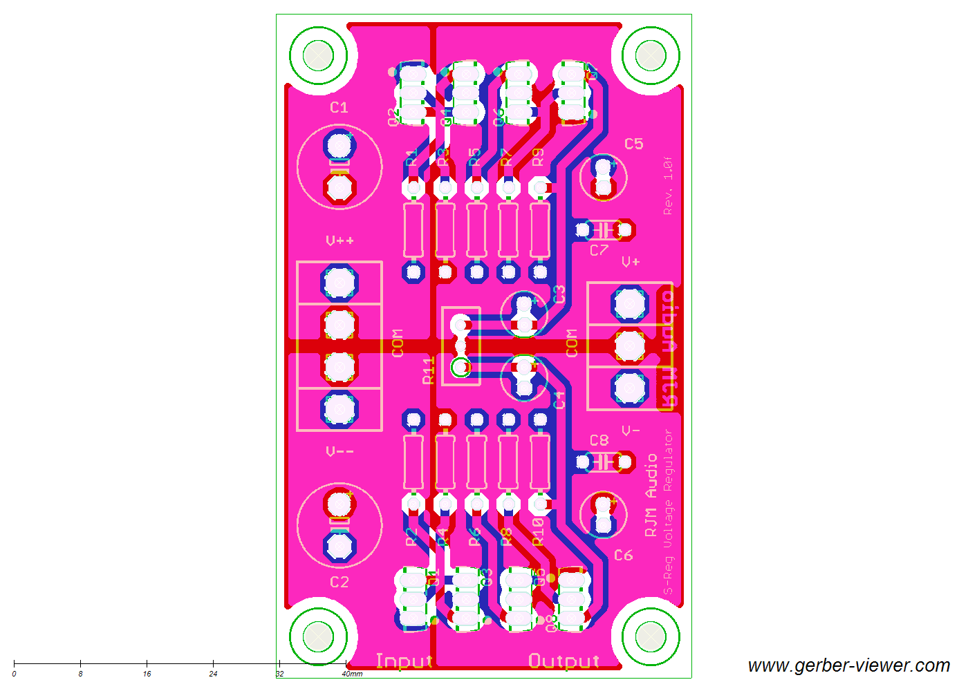

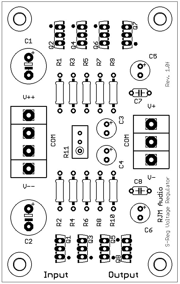

The (Shunt-Source) S-Reg Voltage Regulator
Posted 19th December 2016 at 12:09 PM by rjm (RJM Audio Blog)
Updated 4th May 2017 at 12:39 AM by rjm (added BOM)

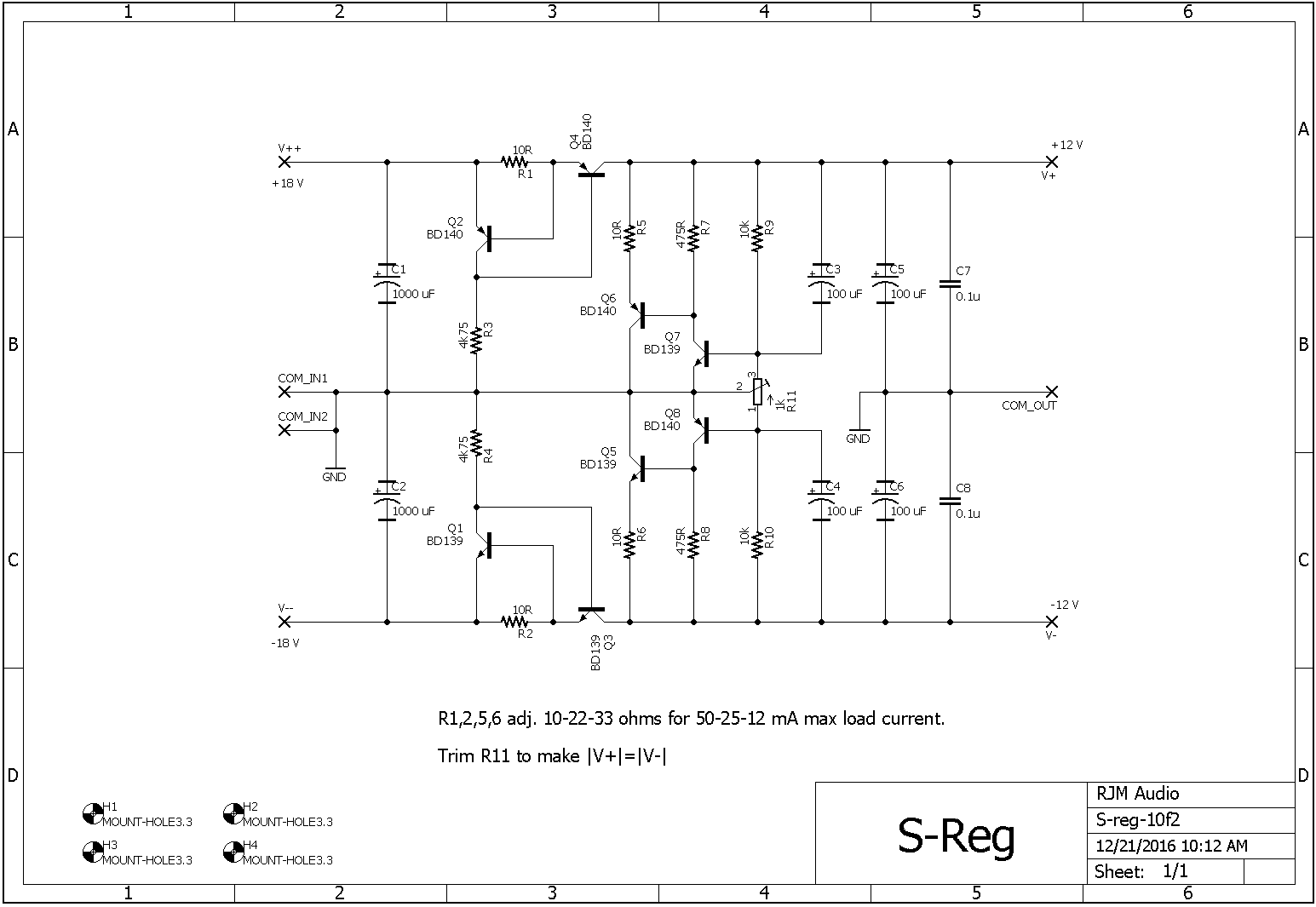

S-reg voltage shunt-source regulator for line-level audio circuits.
This is designed to accept rectified 12x2 VAC input, producing +/-12 V output split rails.
Features soft-start and over-current protection, standard configurations for load currents up to 50 mA. High performance: 80 dB ripple rejection up to 100 kHz.
update: BOM uploaded
update: web page (stub)

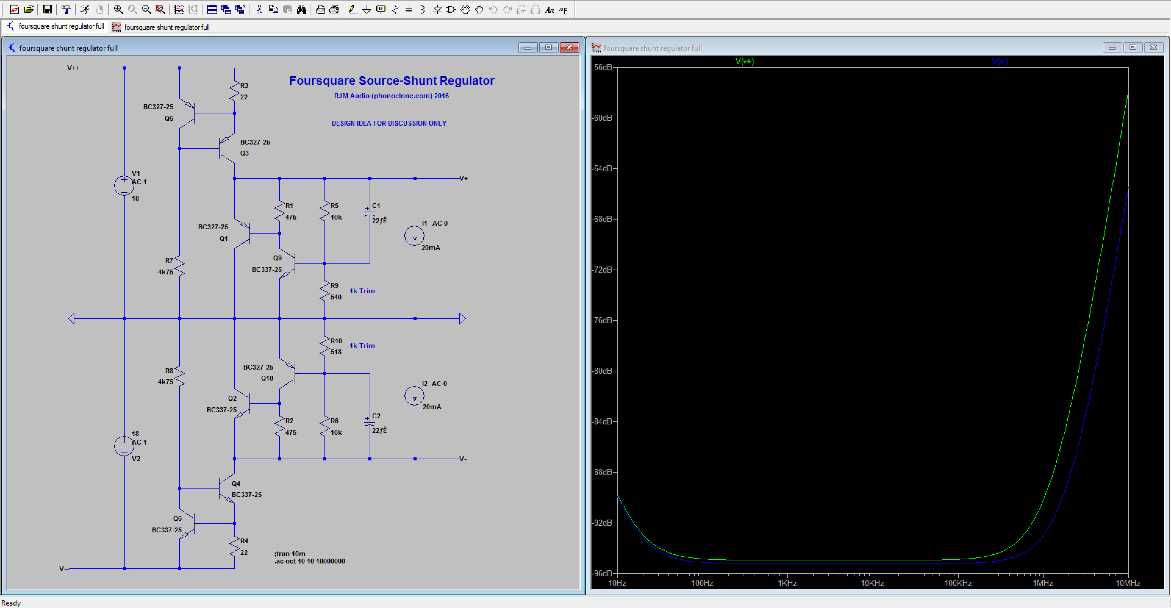

I'm not totally sure this would work as advertised, but I can't see any obvious reason why it would not...
It's pretty much the same circuit as I used in the CrystalFET, which started out in a previous blog post in the Voltage Regulators for Line Level Audio series, but here I've replaced the MOSFETs with bipolars. It is shown configured to deliver 20 mA @ 12 V, split supply. Enough to power an op amp phono stage for example, or a preamp, or the voltage gain stage of a headphone amplifier.
[developed further under the S-Reg name, with pcb layout.]

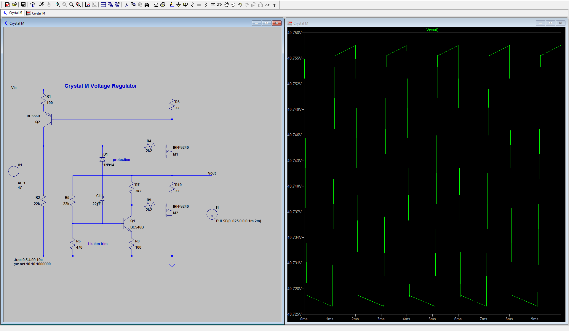

Voltage Regulators for Line Level Audio. Part 11 : The Crystal M Shunt
Posted 20th February 2016 at 01:49 AM by rjm (RJM Audio Blog)
Updated 22nd February 2016 at 09:35 AM by rjm

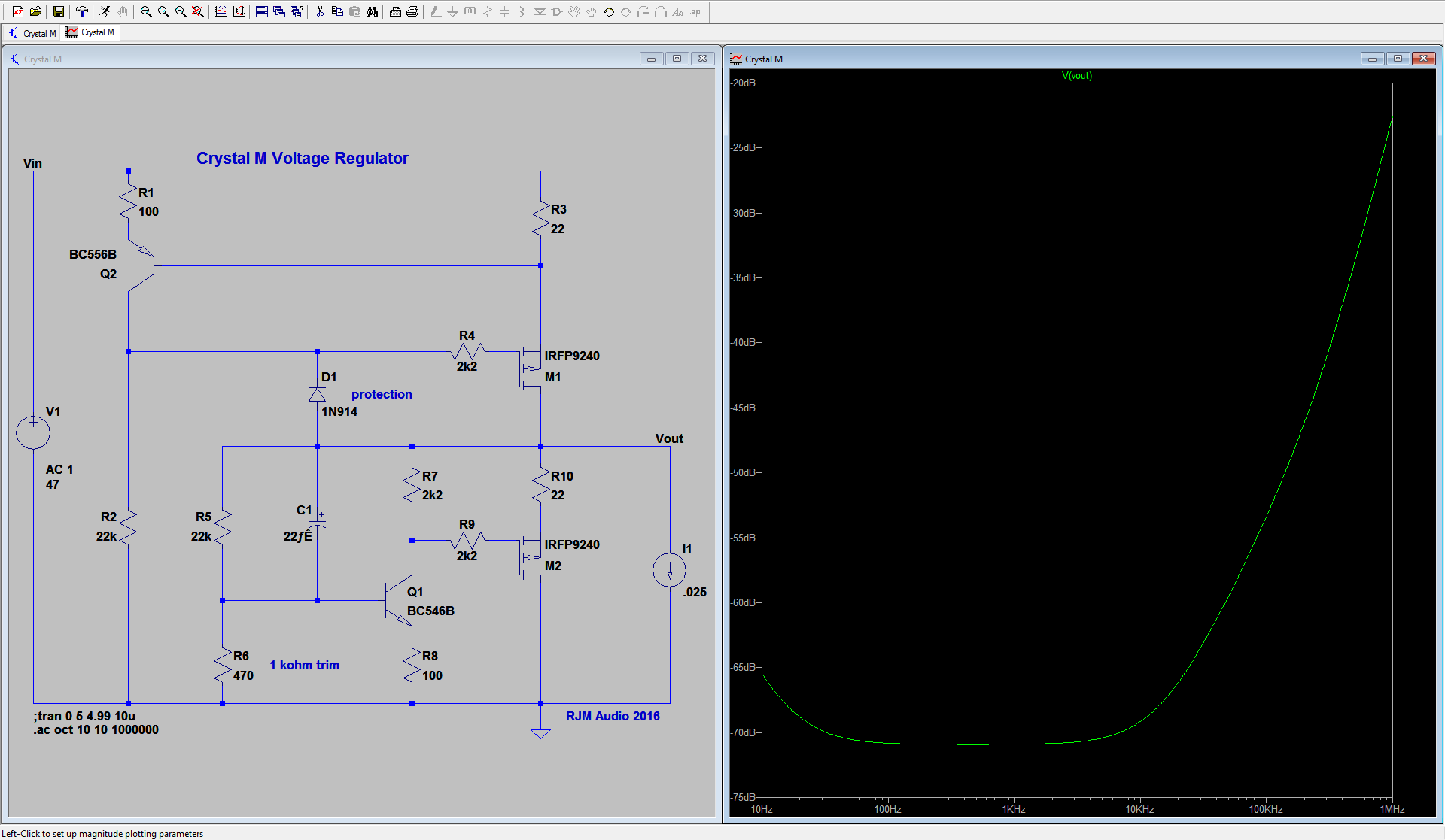

A while back I did a series of blogs on voltage regulators. Back with a new entry today: The Crystal M, configured here for 40 V DC output and a 25 mA load.
The circuit is based on two p-channel MOSFETs, the top one is a constant current source, the bottom one a constant voltage source. As the load current changes, the voltage source adjusts its current to balance.
It's lifted directly on the Salas shunt design (as reworked by me for my own jFET phono stage), but the circuit can also be considered a distant, DC-coupled relative of the Zen amp.
I trick, I discovered, to getting it to work nicely - the attached screencap shows it well-behaved while handling a full-swing output current pulse - is the source resistor R10. This resistance dials-down the current gain of the MOSFET, damping out the overshoot.
The ripple rejection is about 70 dB over the audio bandwidth. The output impedance is about 0.05 ohms over the same frequency...

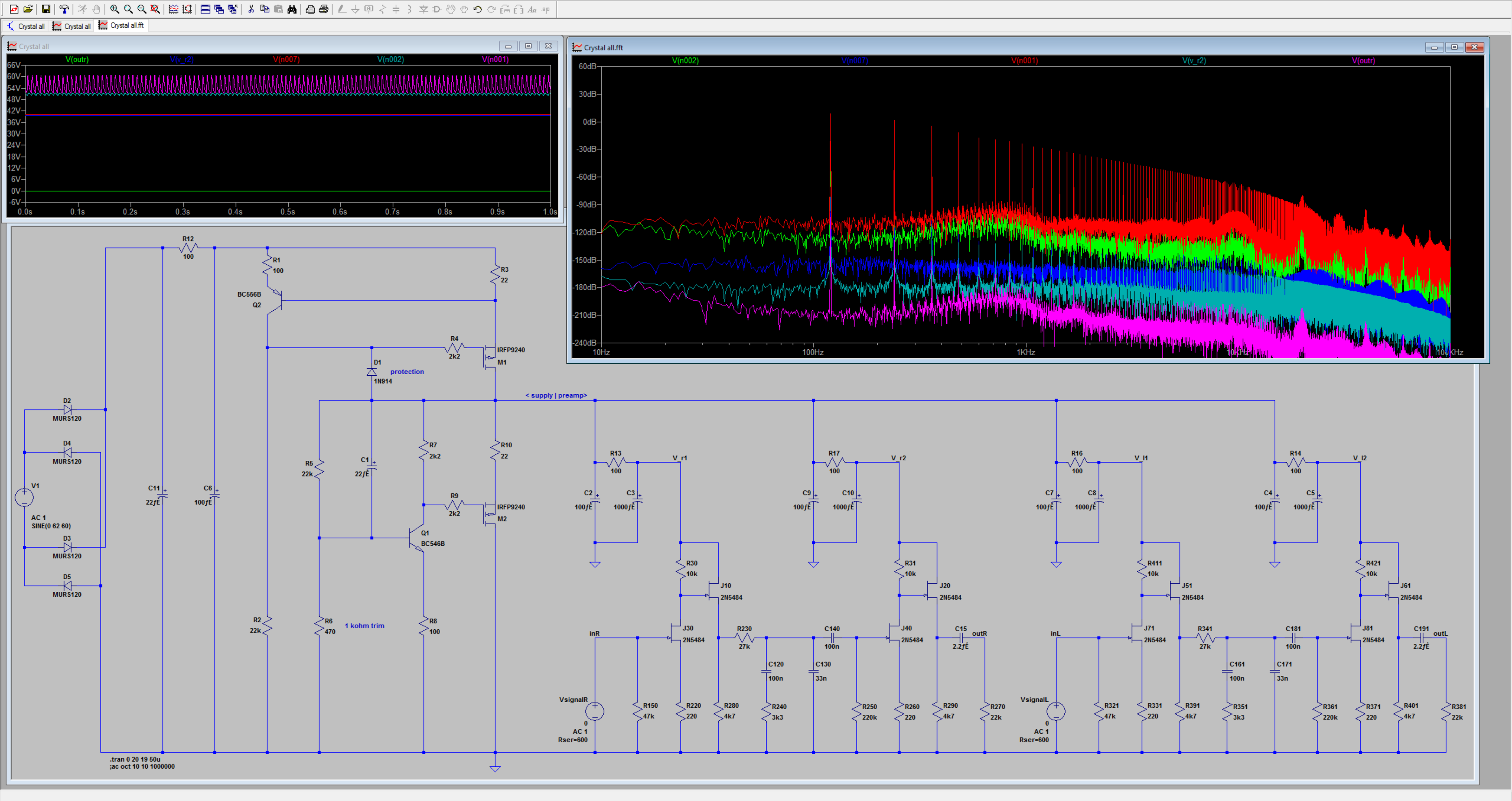

LTSpice filter simulation masterclass: 0 to -100dB in five easy steps!
Posted 19th February 2016 at 12:14 AM by rjm (RJM Audio Blog)
Updated 7th April 2016 at 06:58 AM by rjm
I've never put everything into a single LTSpice worksheet like this before: I find it fascinating. You can really pull apart a circuit to see what makes it tick, before solder ever hits the iron.
Power supply ripple, frequency response, gain, and crosstalk can be established. You can look at turn on and turn off transients, inrush currents, and conductance angle, and check peak currents in the filter capacitors. It's all there if you care to peek in and poke around.
I'm such a huge fan of LTSpice...
The only problem, really, is it is too perfect: all devices are perfectly matched, every part value is exact, and the temperature is always 25 C. Ground loops, wiring inductance, and thermal runaway do not exist. So no, of course there are no guarantees - but as a tool to get you 90% of the way there with the minimum of fuss and bother it is truly indispensable.
Actually I find the more experience you have the more useful LTSpice...

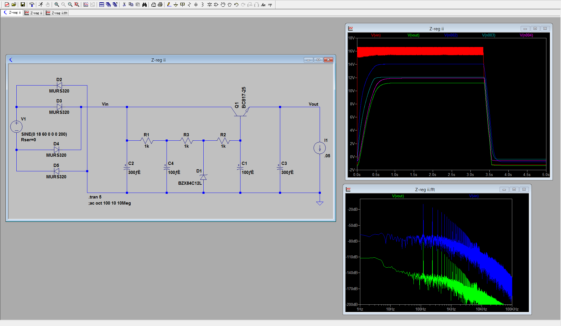

Z-reg II improved simple Zener voltage regulator
Posted 22nd February 2015 at 02:24 AM by rjm (RJM Audio Blog)
Updated 28th February 2015 at 07:17 AM by rjm
I've added an additional RC filter stage (R3, C4 in the schematic below) before the Zener diode, substantially reducing the amount or ripple on the transistor base by cleaning up the voltage applied to the Zener reference. (The original Z-reg is described here.)
Circuit shows C2 with a value of 300 uF. Typically much larger values are used. I kept the filter capacitance to a minimum here to show circuit working with a reasonably high ripple (1 V p-p) on the input. The rectifier diodes used here are of no particular consequence, I just wanted the simulation to generate a realistic sawtooth for the input.
OK, this doesn't do as much as I originally thought. The improvement is mostly below 100 Hz, whereas the ripple is mostly in the 100Hz-1kHz band. There's perhaps 3 dB less output ripple, but that's about it. You can verify this yourself in LTSpice, just cut the wire between C4 and the junction or R1-R3 and rerun the sim.

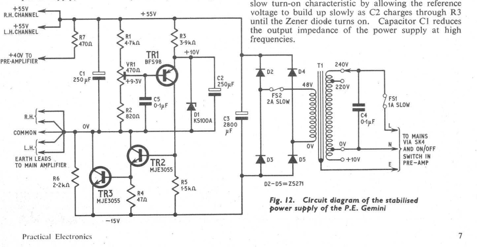

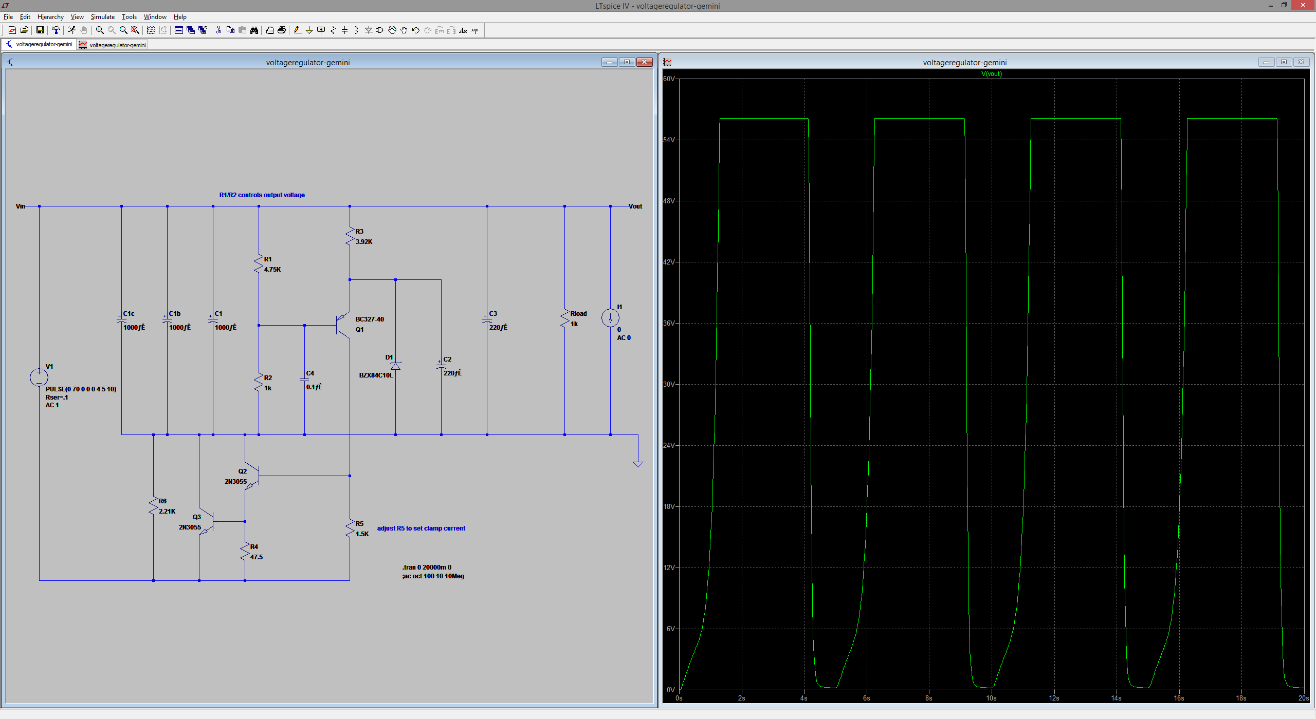

Voltage regulators for (line level?) audio: The GeminiPS
Posted 22nd April 2014 at 01:40 AM by rjm (RJM Audio Blog)
Updated 23rd April 2014 at 11:40 PM by rjm
Part of a series.
The GeminiPS is another discrete series voltage regulator, with a Zener reference and bipolar pass transistor. It's an old circuit, published in Practical Electronics in 1970-71, and written by D.S. Gibbs and I.M. Shaw. I happen to have a reprint, but there's a nice overview here.
For reference it might be worth checking back to the two transistor regulator. The GeminiPS circuit is related in the sense that it is a more sophisticated take on the same basic principle. With just a handful of components we have a stabilized, 30 W output with soft turn on and short circuit protection. The circuit can be scaled up and down relatively easily, and the complimentary (negative output) version is an easy modification.
The pass transistor (TR2/3, Q2/3) is between the circuit common and the rectifier anodes. This may seem odd, but it was relatively common back in the day when high voltage transistors were both expensive and rare. The...

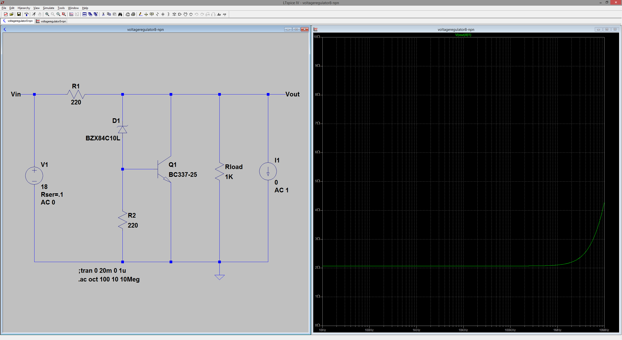

Voltage Regulators for Line Level Audio. Part 10 : Simple Shunts
Posted 11th April 2014 at 06:59 AM by rjm (RJM Audio Blog)
Updated 15th April 2014 at 11:52 PM by rjm

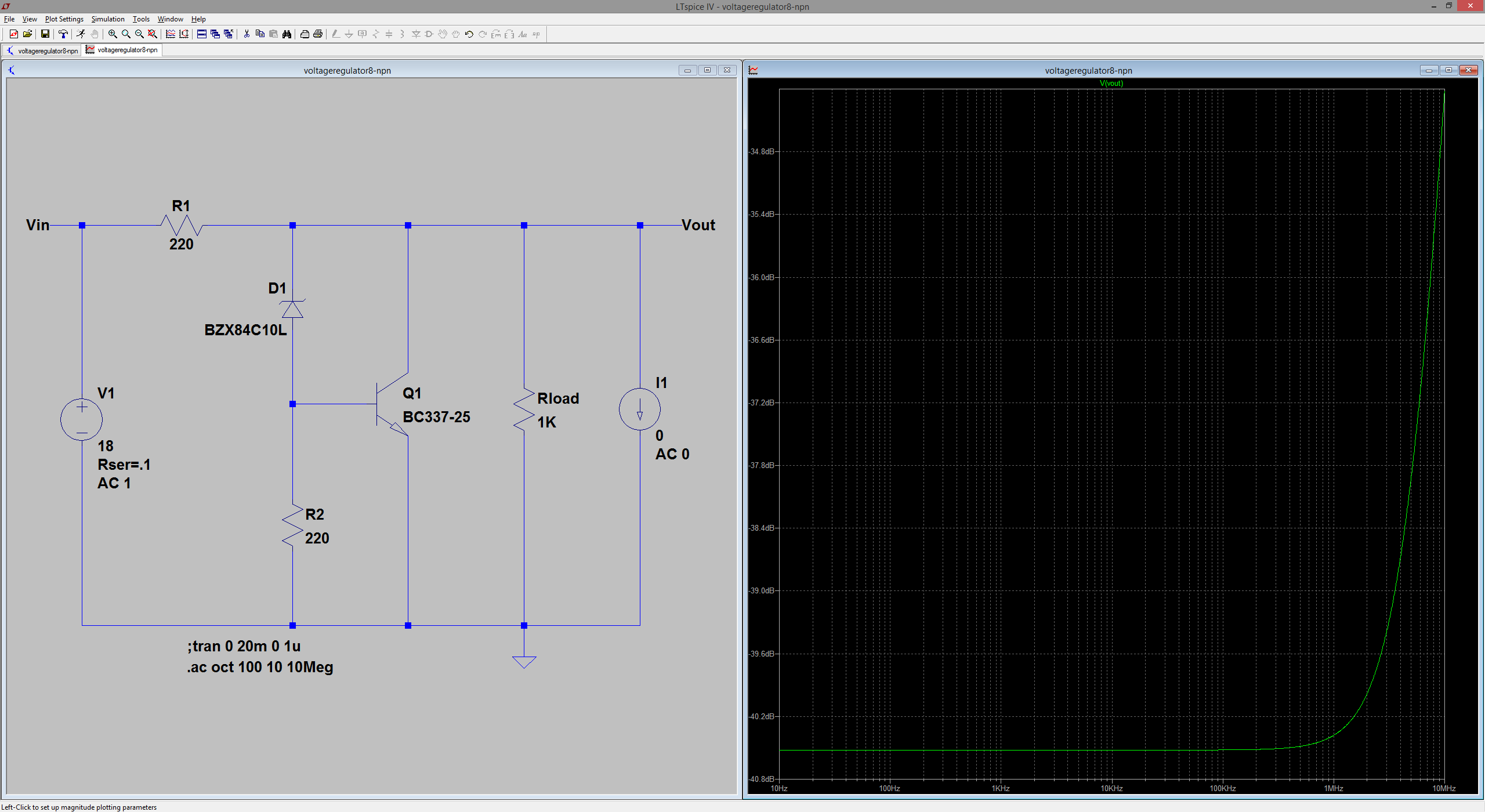

Part of a series.
I've been meaning to take up shunt regulators for some time. I've never got around to building one myself to try, so I'll have to make do by playing in simulation.
Today's circuit is the shunt analog of the Z-reg series regulator: no feedback, Zener reference, single transistor regulation. The output impedance and ripple rejection-characteristics are similar too, with about 40 dB of RR and an output impedance of just a few ohms. It can be built equivalently from either an pnp or pnp transistor. (See attached LTSpice .asc files.)
The difference between shunt and series regulation can best be explained by considering the upstream power supply: In a series regulator an increase in current demand by the load causes the regulator to increase the current to compensate. In a shunt regulator an increase in current demand by the load causes the regulator to decrease the shunt current to balance, so there is no net change in current flowing...
