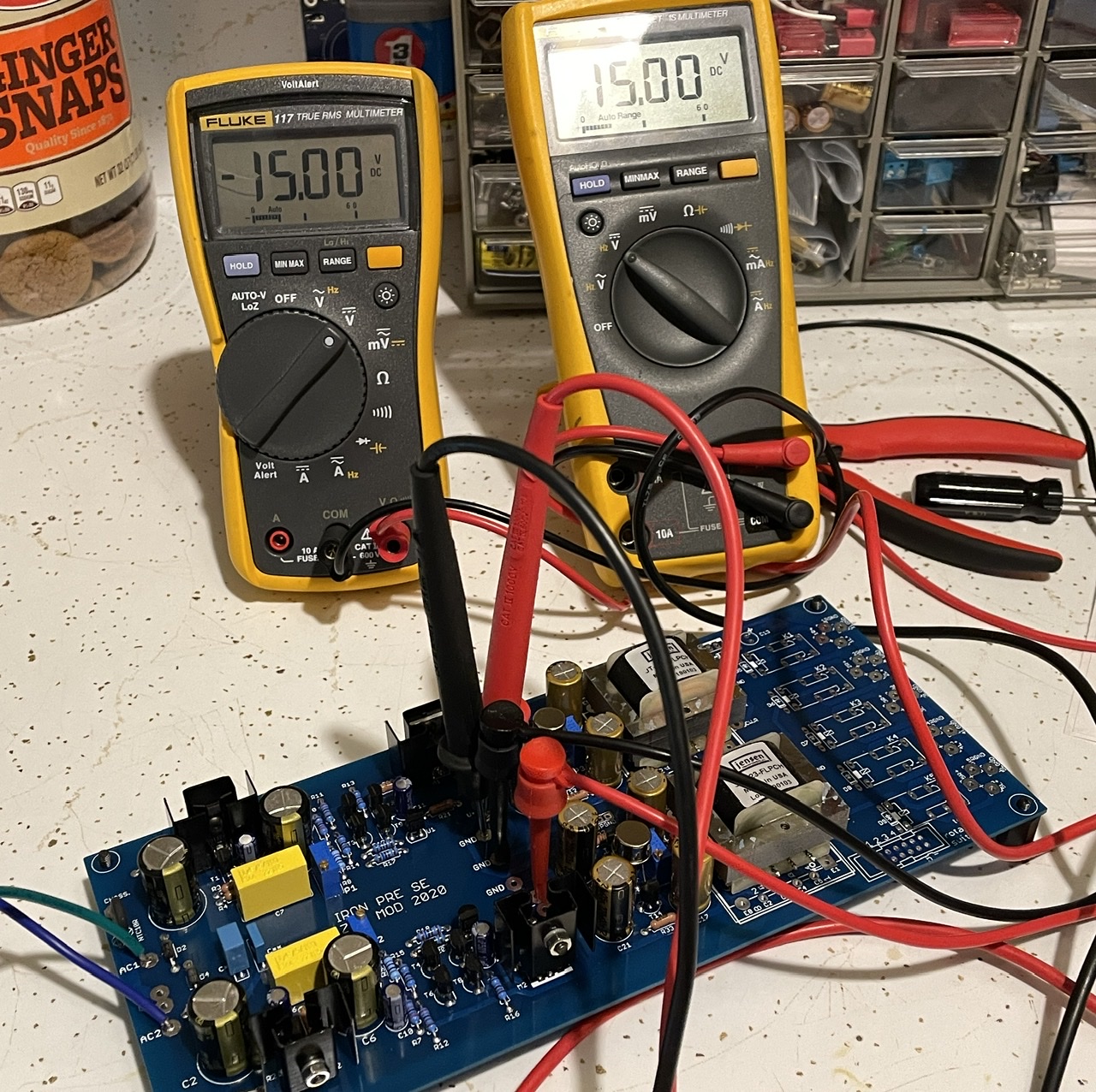

That's a good question. I have this Iron Pre SE board sitting here, unpopulated. I successfully desoldered the Jenson JT-123's from my F6 last night, so I have iron to use. My goal is to go iteratively – first build the Iron Pre as intended (with Jensen and a regular pot for attenuator), then pull the Jenson and swap in a Slegle (intactaudio) AVC. I'm partly doing it this way because it'll be a bit before I can afford the AVC
Another scenario – I build the Iron Pre as-is and leave it that way. I have a nice Salas shunt reg and a B1v2 on a breadboard that I may use with the AVC instead. We'll see...

Board went together nicely. Rock solid voltages and buffer offset. Now it’s time to round up a chassis. Plan to listen to stock Iron Pre for a bit, then phase 2 will be AVCs.
Thanks to ItsAllInMyHead for the board and bullet-proof BOM! Accolades to ZM coming soon
