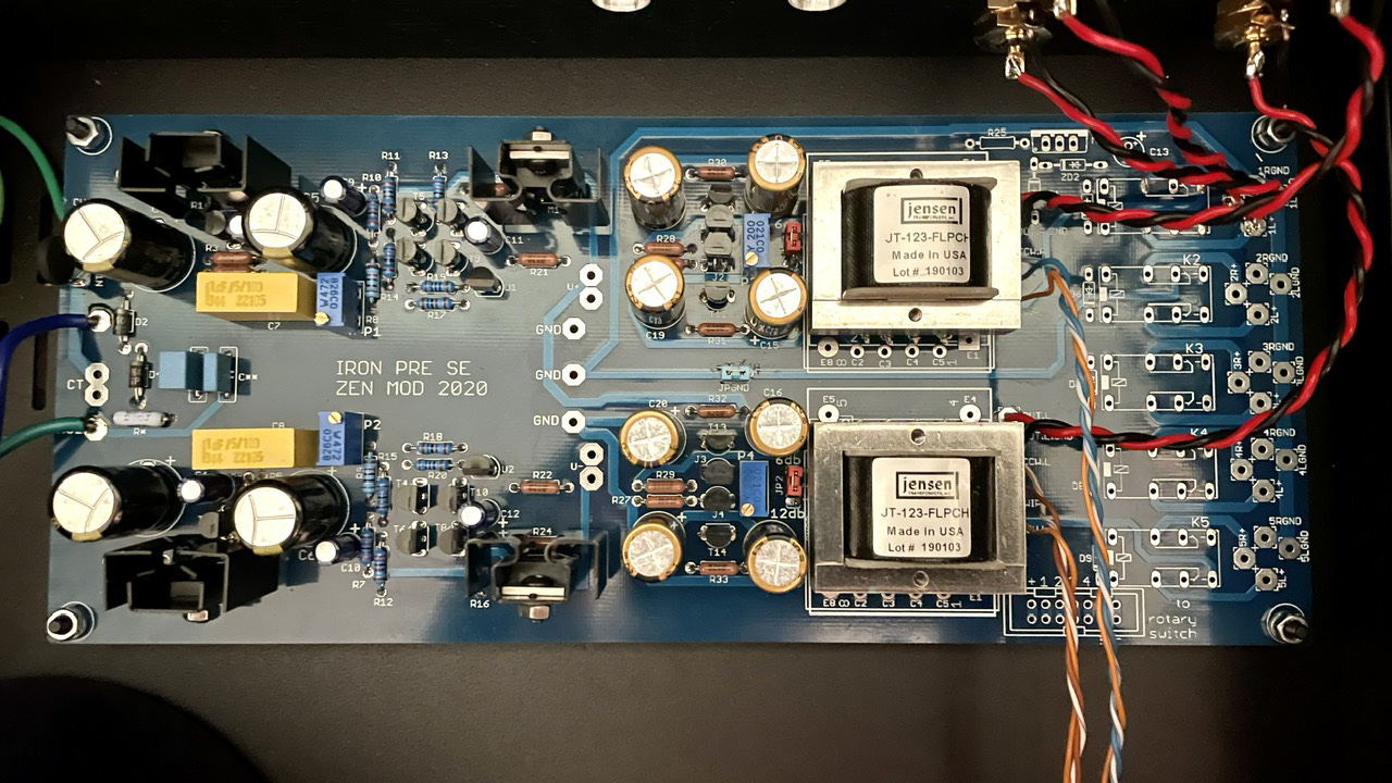

Finished up my stock Iron Pre this afternoon. Sounds really nice so far! Was a breeze to build and setup. I only ever use a single source at a time, and bypassed the relay's and twister for now. As stated in a previous post, I'm using a regular old pot for attenuation to start with, and then hope to swap in the Slegle $200 autoformer pair for attenuation soon. Shooting for an Iron Pumpkin Lite, if you will 🙂
Thanks to ItsAllInMyHead for the free prototype board! I used his BOM for anything I didn't have, and it worked perfectly. I say these are definitely ready for the store.
Last but not least, thanks to ZM for the superb design, layout, and constant help. You're the best!! :worship:

After doing a bit of side-by-side listening with my DAC source, I'm noticing a fair amount of LF roll-off. Is that the norm for these little autoformers? I have a feeling its probably an issue with my build, but haven't spotted anything yet.
I may need to double-check resistor values? I kinda feel like it may be an output impedance issue. I was also looking back to see if the Jensen required any clipping, bridging, etc
*Edit* Since I recovered these Jensen's from my F6 boards, also considering the fact that perhaps I boogered up a winding..

Nothing is hooked up to CT thru holes. The transformer has two 18V secondaries, wired in series to get my 36V. Voltages in the reg are rock solid at +/- 15V. 1263 is the final wiring. Also included a better board shot here. Signal ground is coming from RCA in (confirmed isolated from chassis) to the input. PCB is grounded at a single star point in chassis (via onboard NTC). I confirmed continuity to chassis.
Confirmed correct resistor values in the buffer section.
Out of curiosity, I hooked a powered sub I have. Take a parallel set of RCAs from the pre out to the sub. Normally there’s no detectable change in sound, but this time I noticed what sounded like even more roll-off. The sub had a pretty high input impedance, so not sure how/why it had that impact, but perhaps greater minds will prevail.

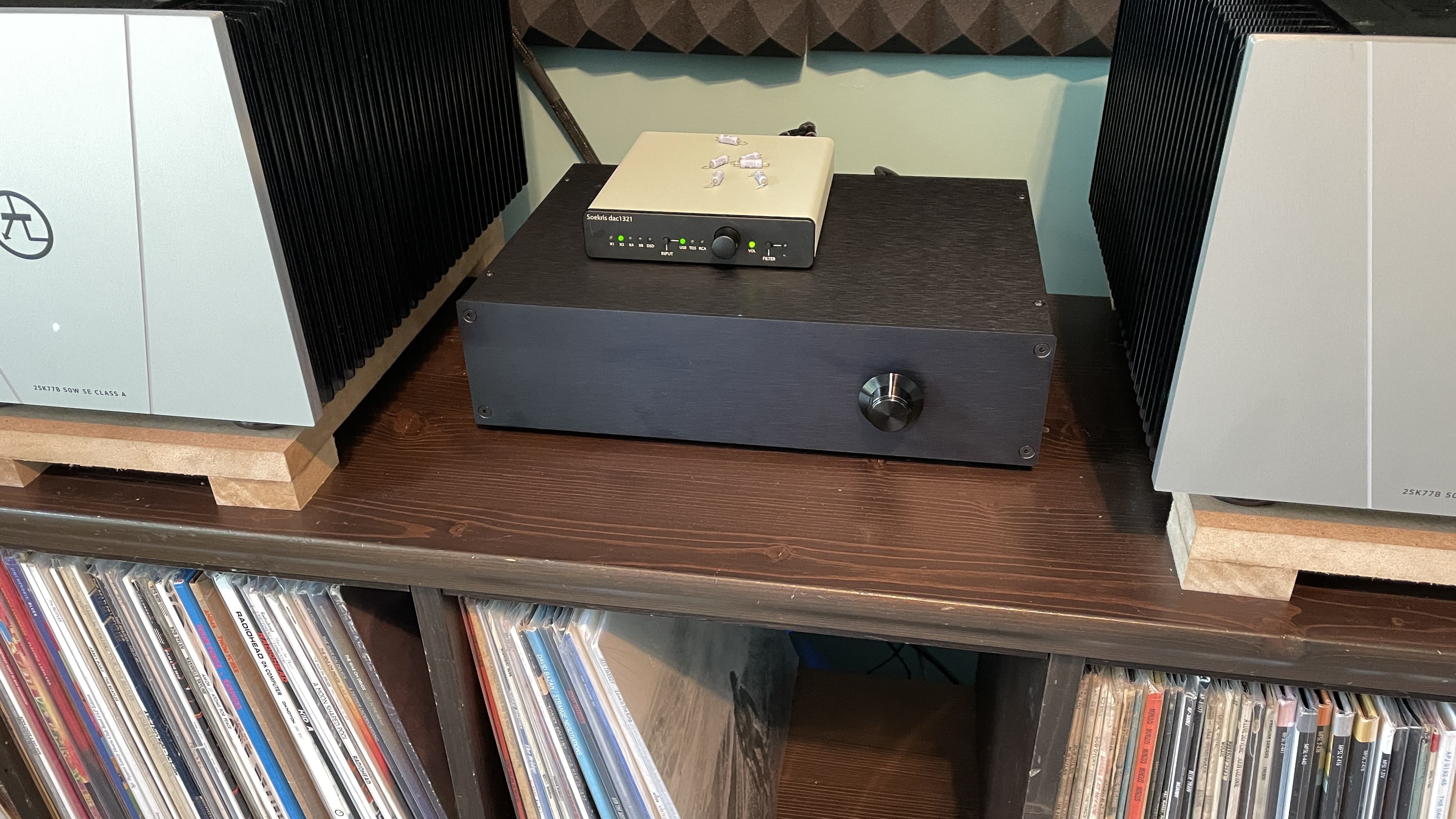

I do plan on measuring the output tomorrow to confirm the roll-off. It’s a very real possibility that’s it’s not actually an issue, and I’m just being overly sensitive to a gear change. In other words, may not be worth digging too far into troubleshooting yet. 🙂
Hey, problem solved! 6L6 noticed that I'd tied my two secondaries in series at the transformer, as opposed to running those legs to the CT spot for the series connection. I just made the switch and I've now got full range and full power. Thanks Jim!
