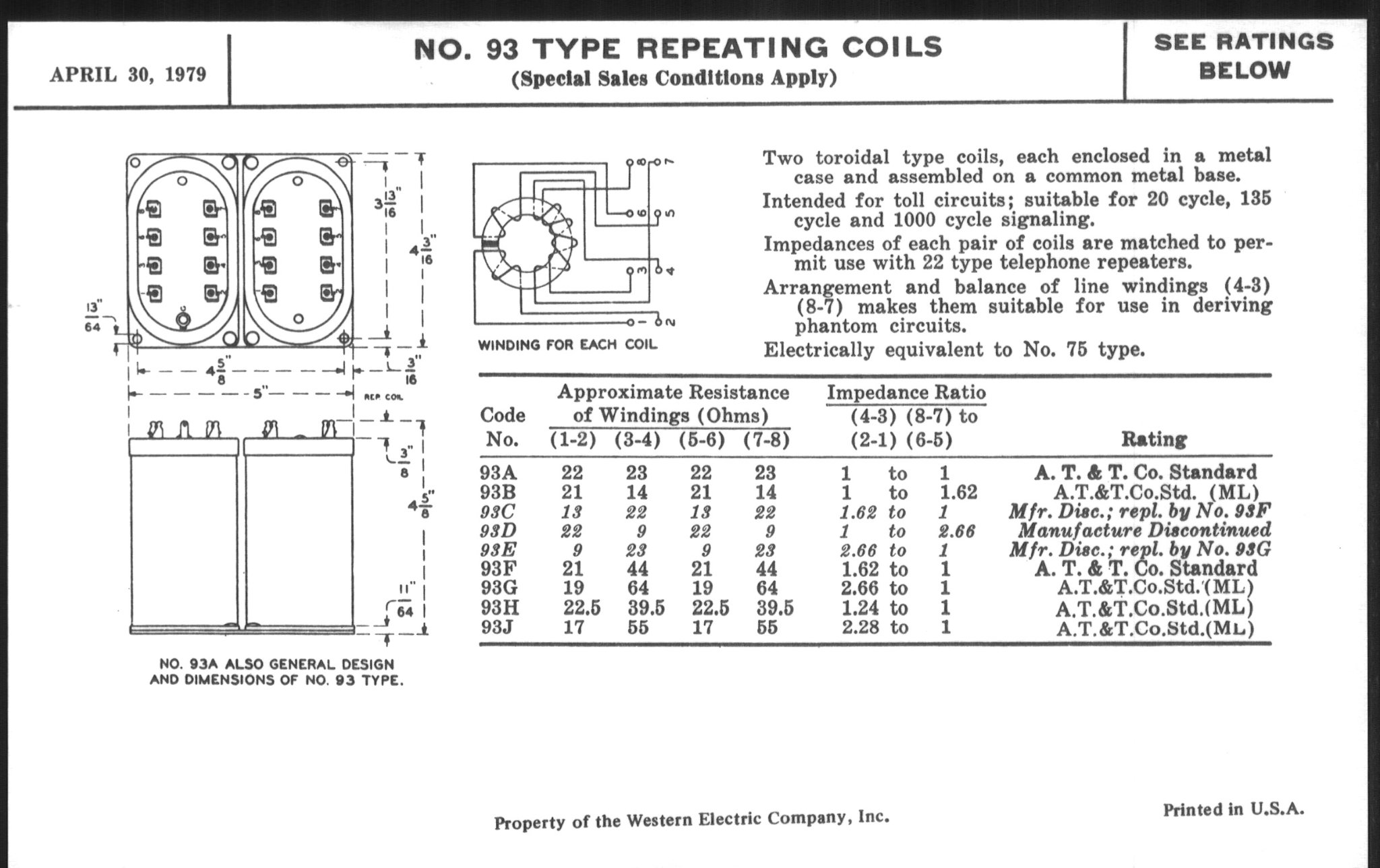

Oh no, more reading for me to figure out why this is.... I've never quite understood how transformer primary Z is determined. Sadly the specs for my repeat coil aren't too clear (93A, attached)
Thanks again,

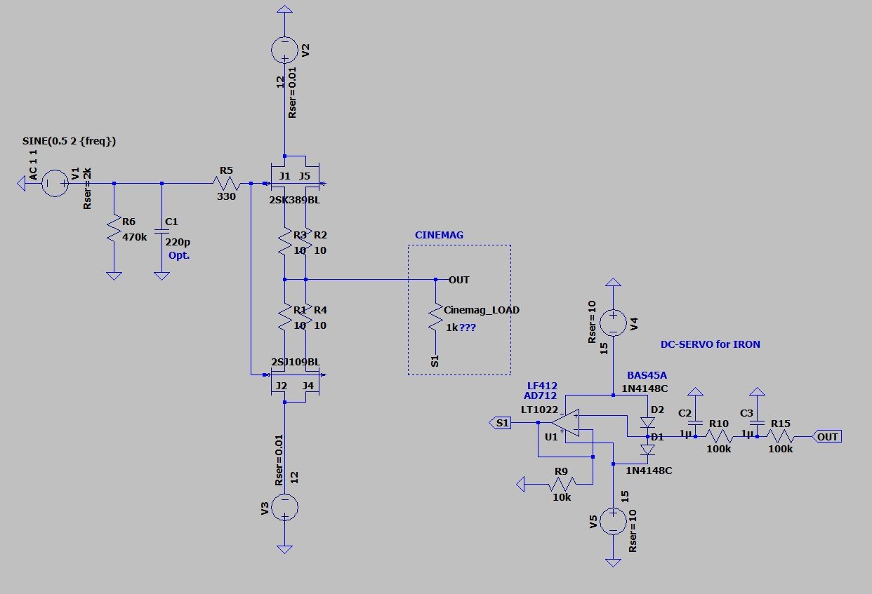

I just quickly build the buffer as below with below 0.1mA matched K389+J109, connected to the Cinemag for 12dB.
The DC-offset behind the buffer is arround 9..10mV.
I don't like trimmers, especially not in the signal path, and was thinking how to implement a DC-servo.
Below is a concept (works in LT-spice), to not connect the cinemag primary to the GND, but to the output of a DC-servo (NOT INTEGRATING, so actually a gain 1 buffer with a low pass RC).
It this a silly idea? What can I improve to have as less impact as possible soundwise?
Other options to implement a DC-servo?

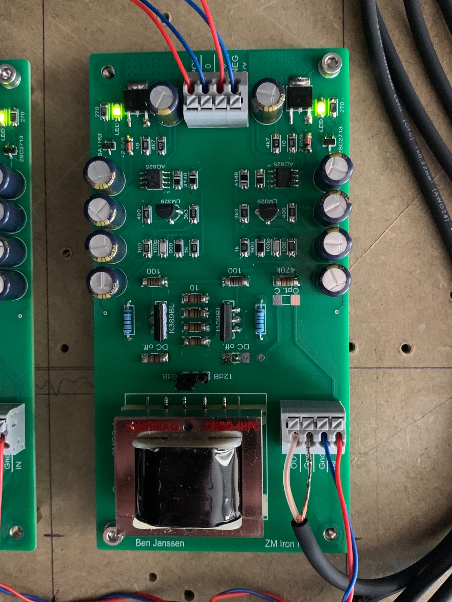

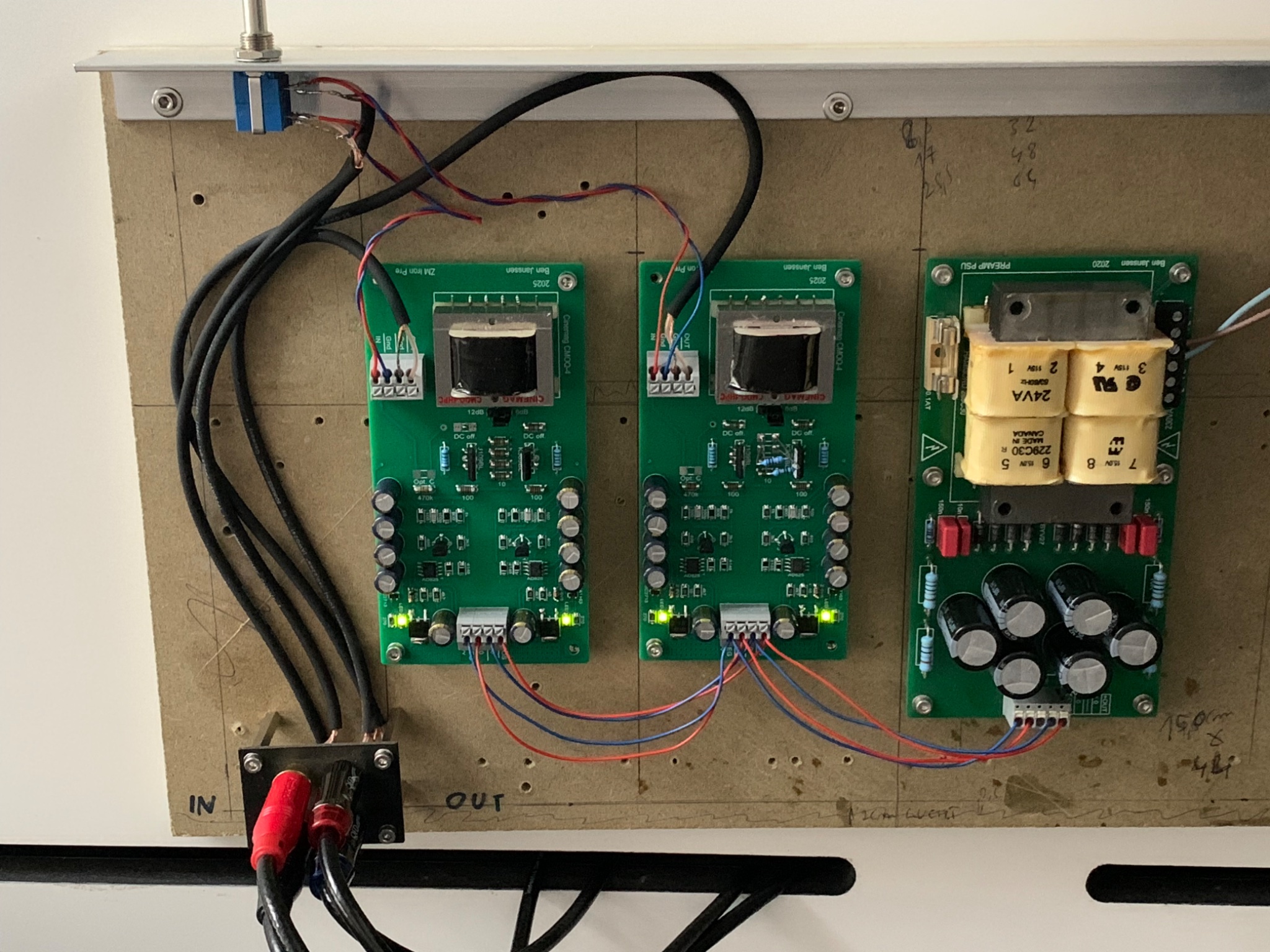

Have done a fast mock up on a planky.
Have use 2sk389bl and complement matched at idss of 10,00-10,03mA.
Regulators are Jung/Didden superreg’s with sense connections at drains of jfet’s.
