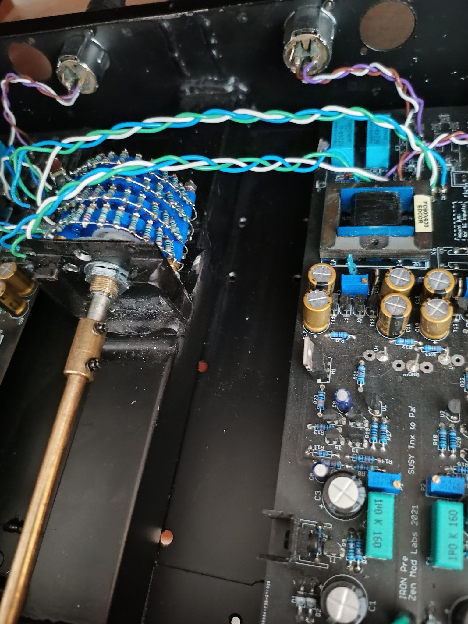

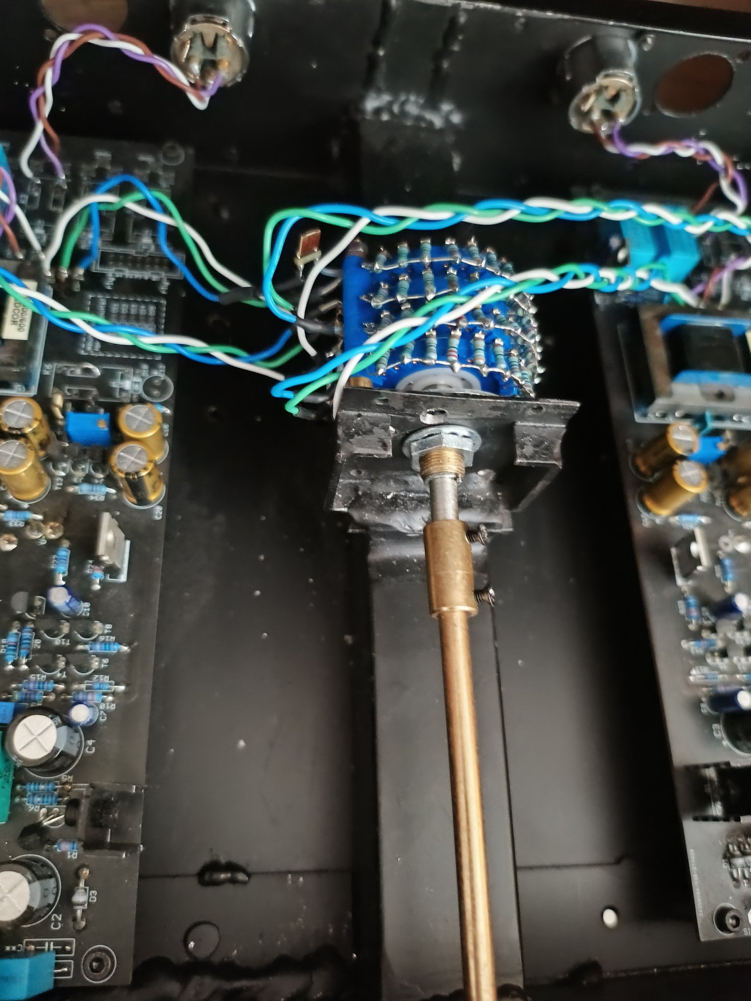

I finished my Iron Pre "SMD" SE build. I bought the SE bundle from DIY Audio Store, thus with Cinemags. Everything measured fine: steady (positive and negative) 15V0 rails, offset nulled and 14mV across R34 and R37 as indicated in the schematic. It has been running in for about a week now, but to my ears the LF (still) sounds somewhat rolled off compared to my previous setup. Is this normal or is there something wrong?
My previous setup was far from perfect, but the bass always sounded quite natural to me, not bloated or overemphasized.
Those thick cables are not coax, but Sommer Albedo shielded interconnect cables; pot is according to BOM Alps blue velvet 10K. I had some difficulties soldering a number of the transistors, which might have become rather hot. I don't know if that can cause problems (they apparently work fine)?
if static measurements are fine (rails, buffer Iq, offset), no reason to doubt basic functionality
anyhow, more details (about rest of your system) could help ........
again, if Iron Pre us assembled by the book, I'm doubting everything else
it's made to have all impedances optimized and more than sufficiently linear

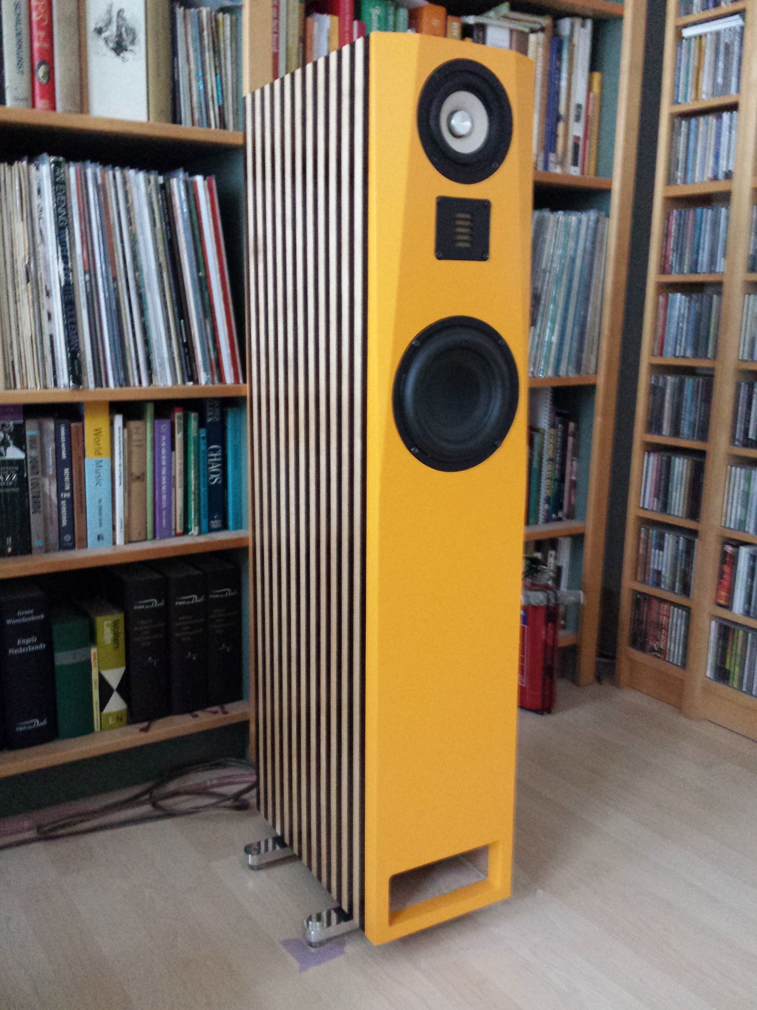

My old setup was a Denon PMA360 integrated with Infinity RS20 speakers. New setup is apart from the Iron Pre a F5 turbo v.2 (with DIY Audio PCB's and transistors), I posted about that before because of a groundloop hum, and DIY TL speakers with a ridiculous low efficiency of 81 dB. But a swaped those out with my old speakers and still had less bass than when driven by the Denon. Rest of my system is the same as before: Rega Dac mk.1, Cambridge Audio CXC CD transport and my DIY Lenco/PTP turntable.
