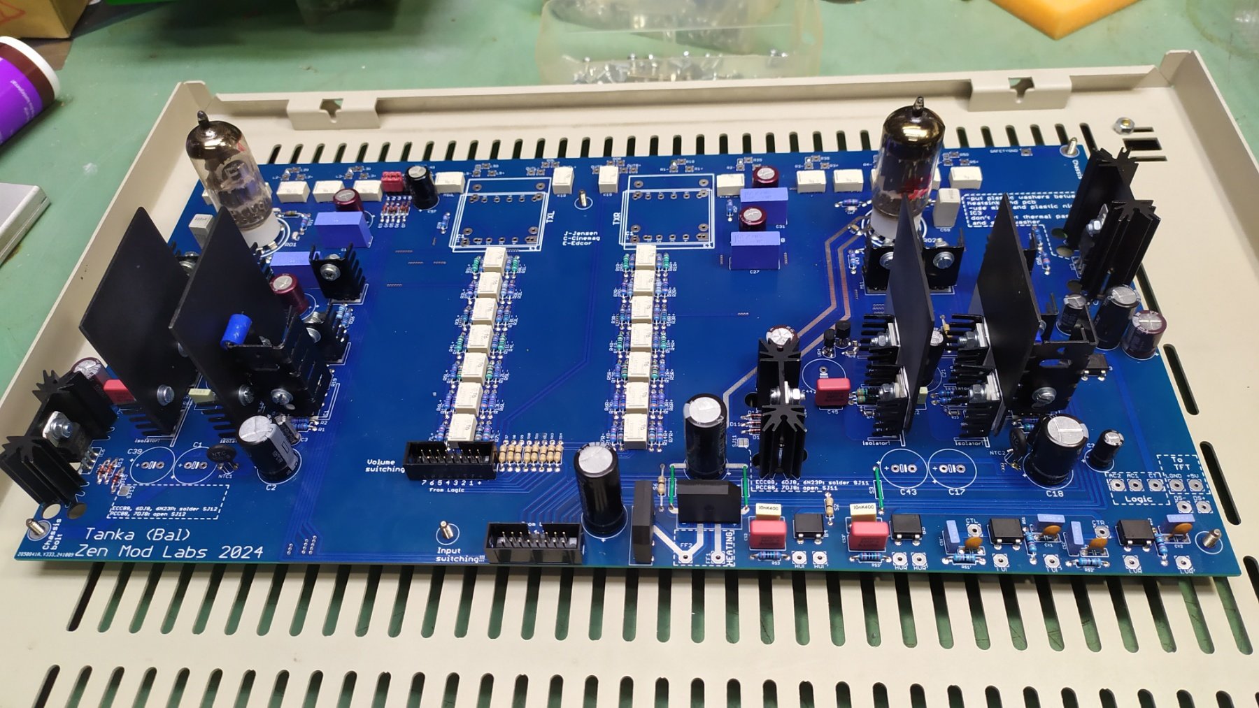

as always, ZM Omni, working on several things in same time, finishing even less :rofl:
need to order Donuts, so it'll be few weeks time

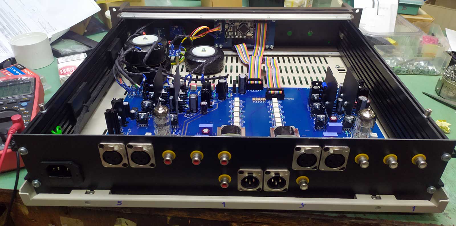

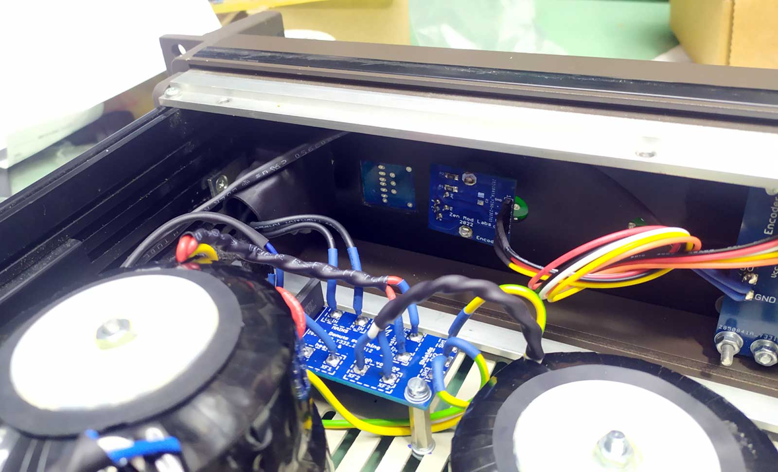

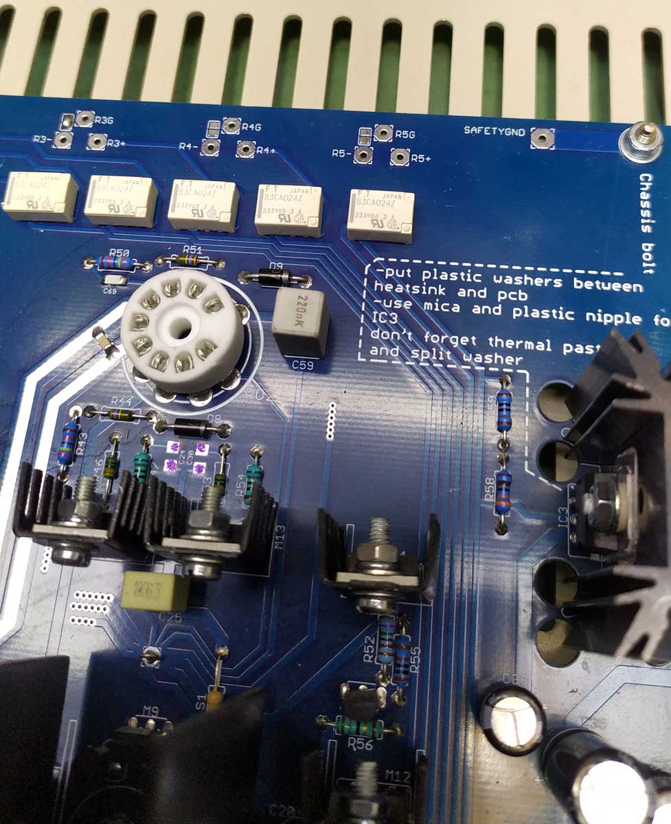

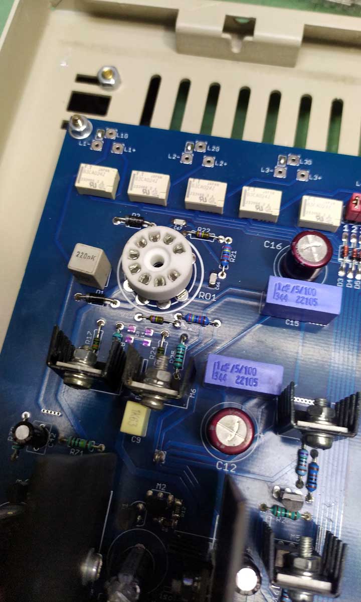

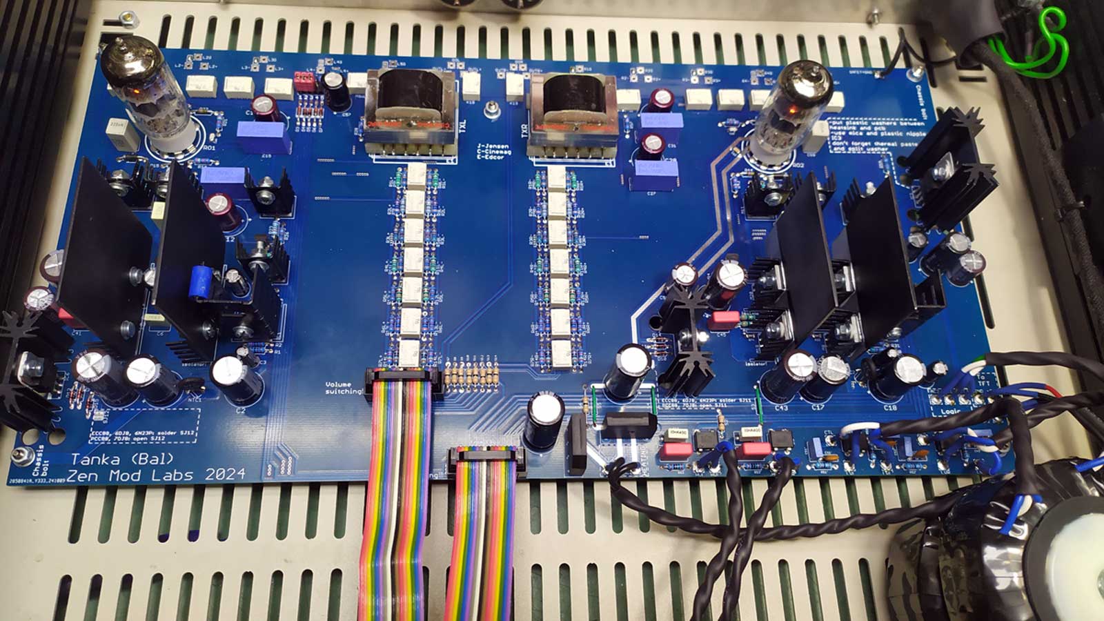

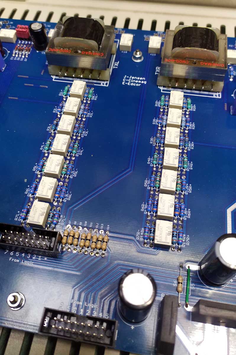

repetitive work?

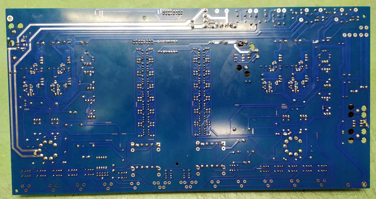

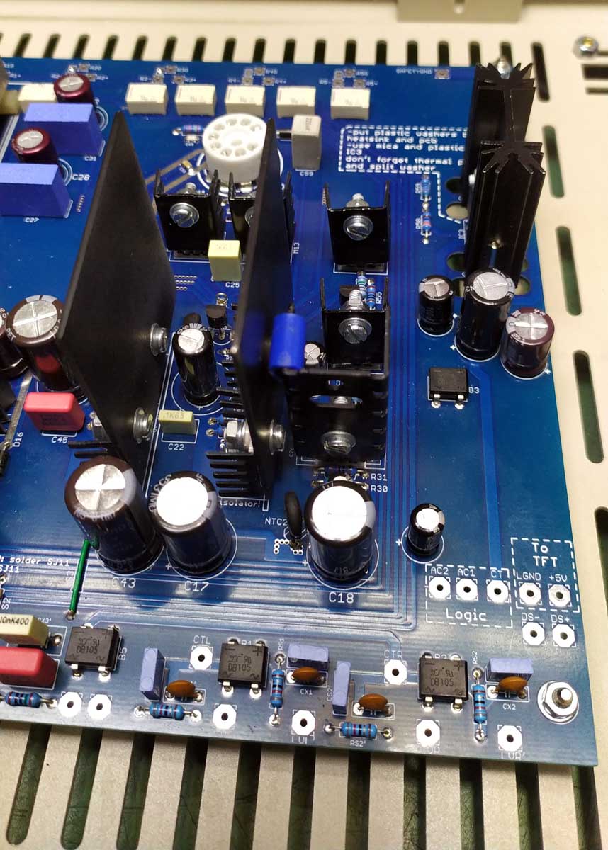

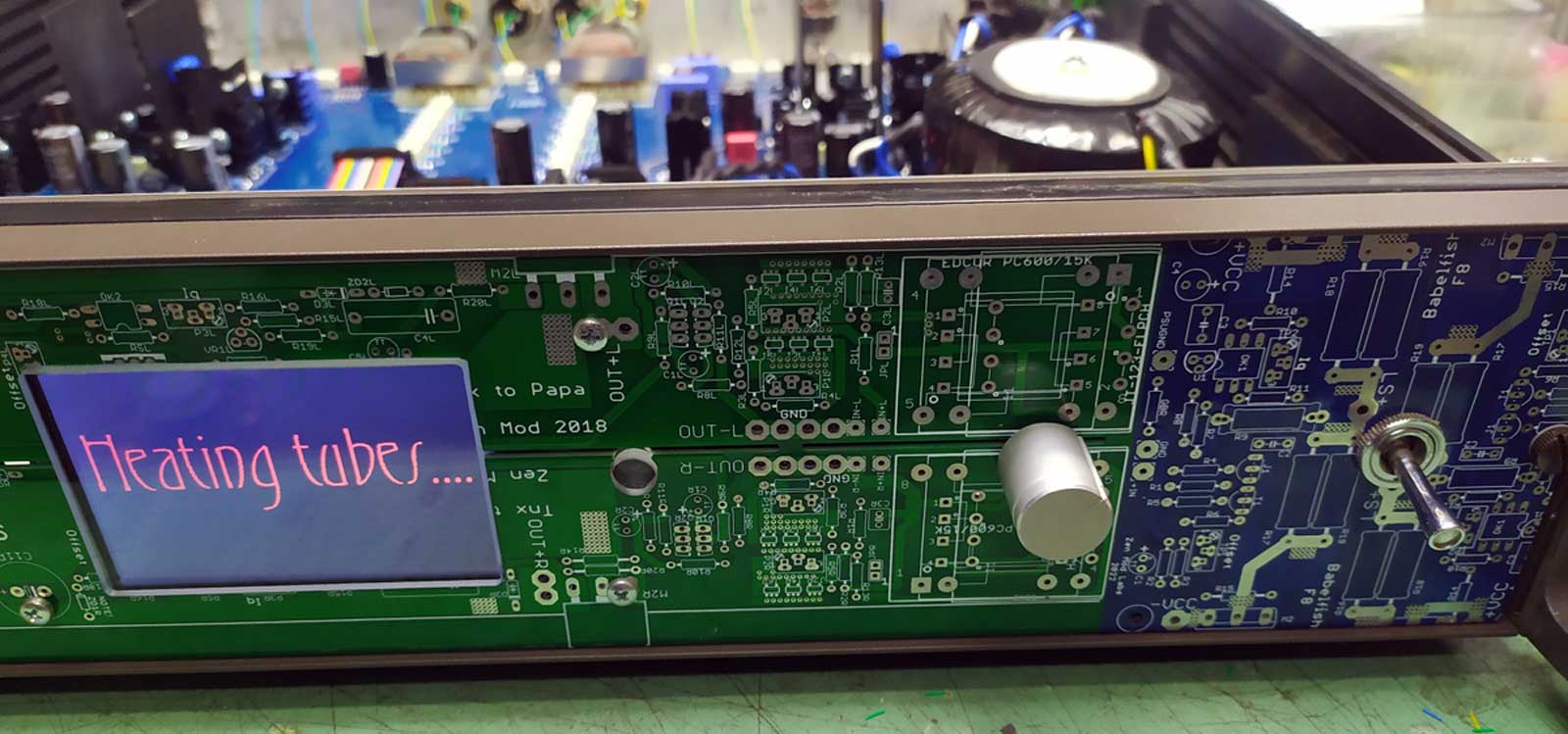

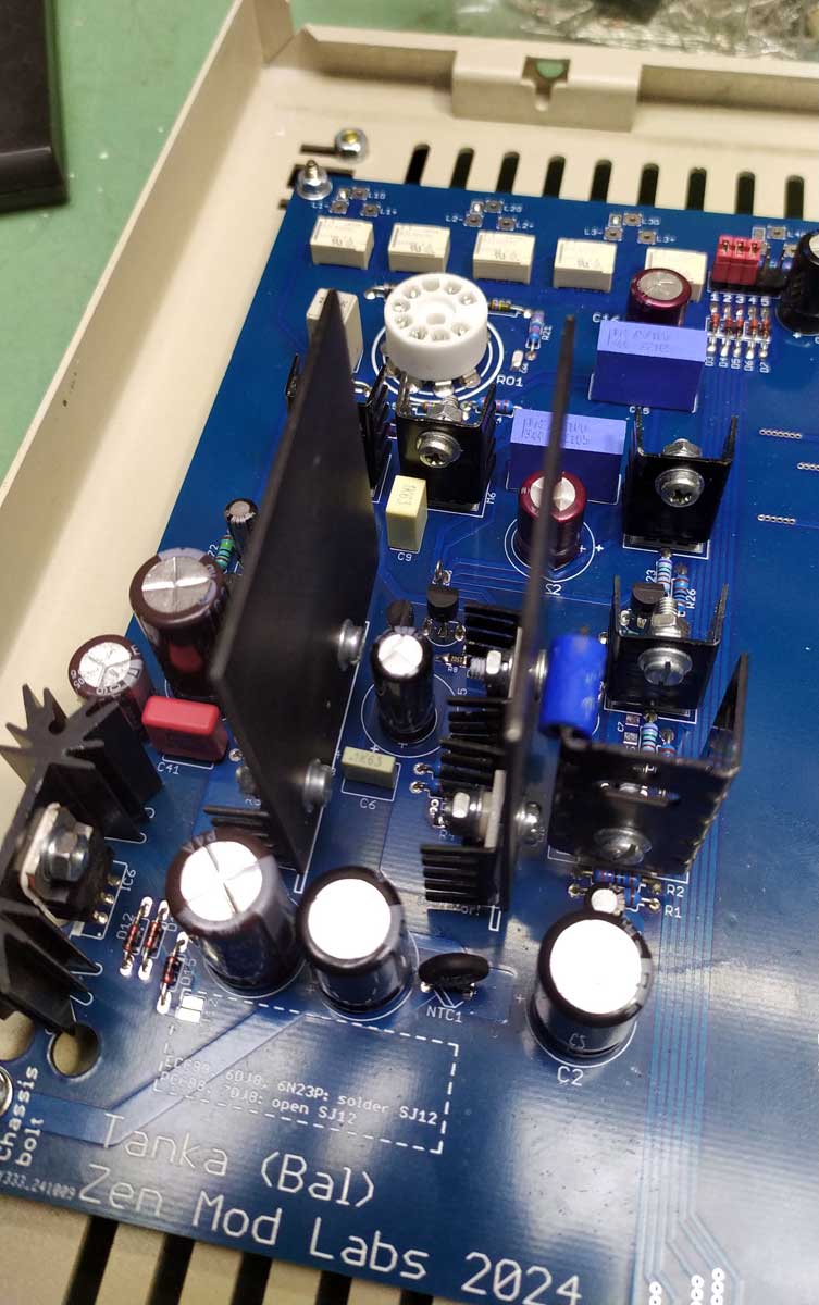

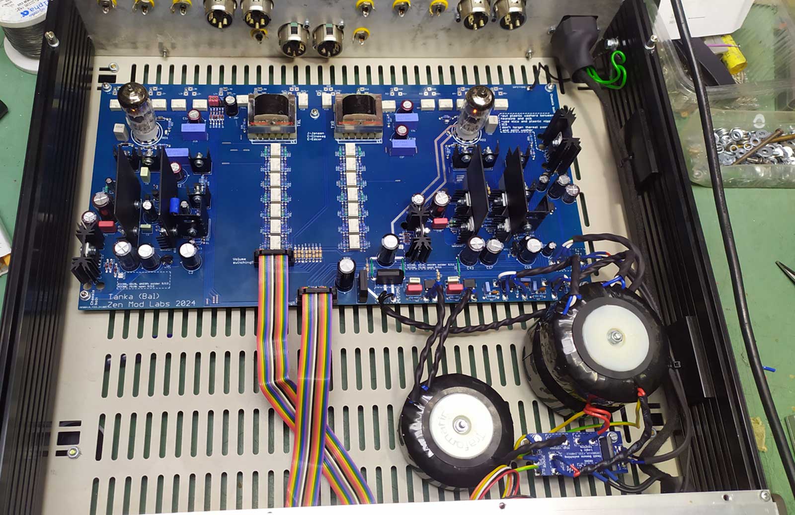

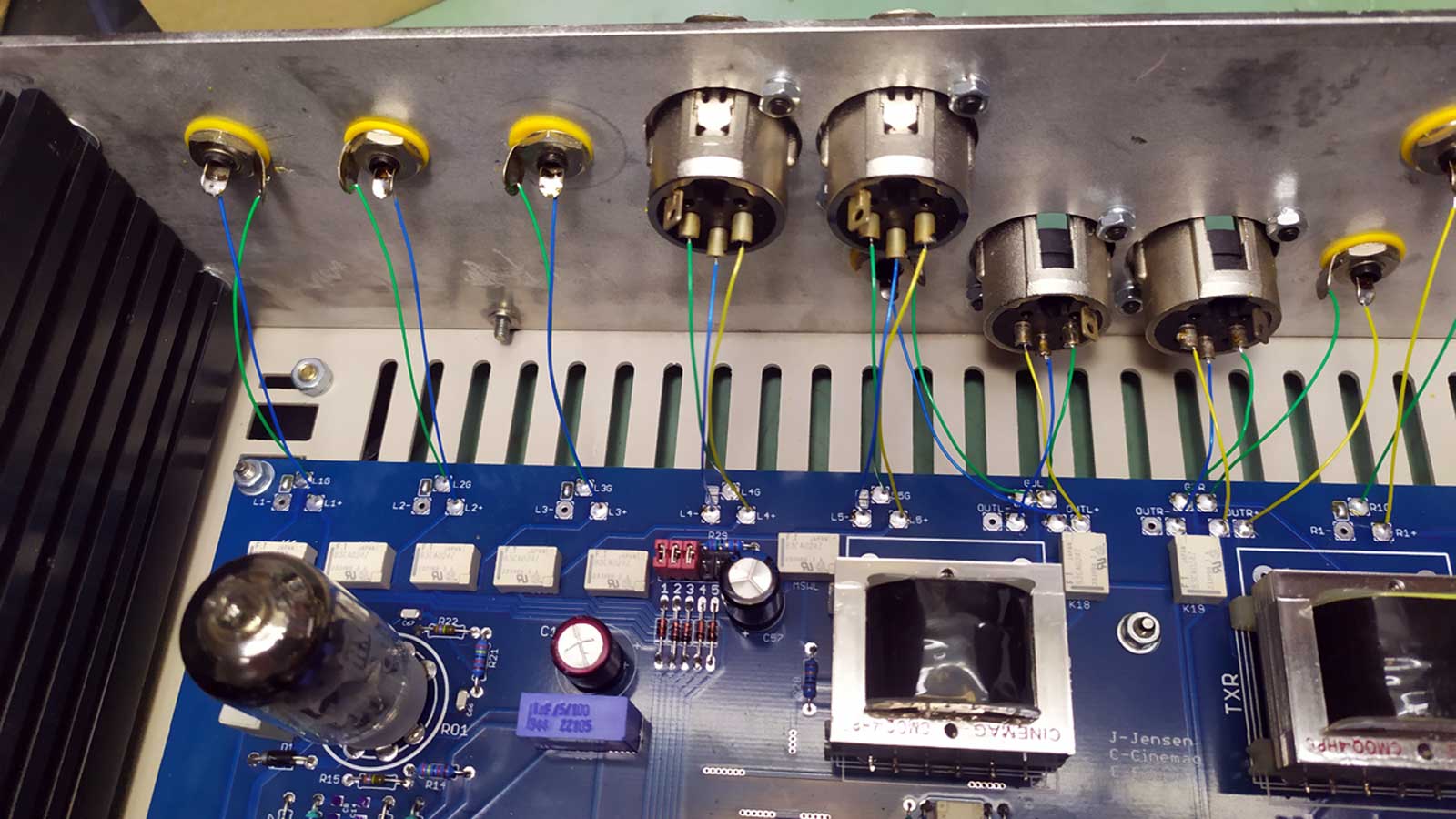

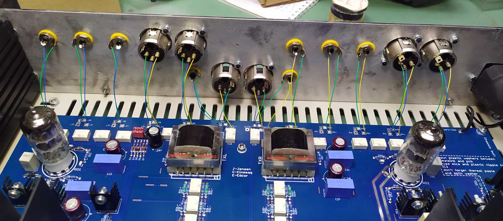

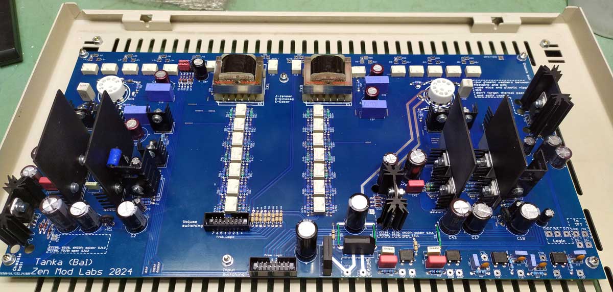

when things are optimized in SE iteration, with pcb area strategically left for necessary addition of functional blocks for Bal ........ and I pushed all dilemmas about unavoidable dissipation issues in Bal iteration
first option was - re-routing/re-arranging shunt regs, so I can stumble mosfet pairs to one common Fischer fancy hsink (same format as those already for heater regs and most right one - for logic/relays)
second option was - keep existing routing/arrangement of shunt regs, add custom heatsinking to existing small hsinks
compromises:
first option - resorting to less optimized trace routing, not so energy traces but sense traces goes wakoo
second option - fabrication of additional AL plate is trivial, but assembly of mosfet-goop-small heatsink-goop-AL plate is tricky - calls for use of existing mosfet pads as tool for keeping mosfets in orientation while tightening the screws; easy in fact- flipping MoBo and doing explained from bottom side , so almost piece of cake
well, I hate tracing done to itch me later, so be it - second option
waiting for few missing caps, Donuts ....... practically what's left is one nice cozy day for assembly work

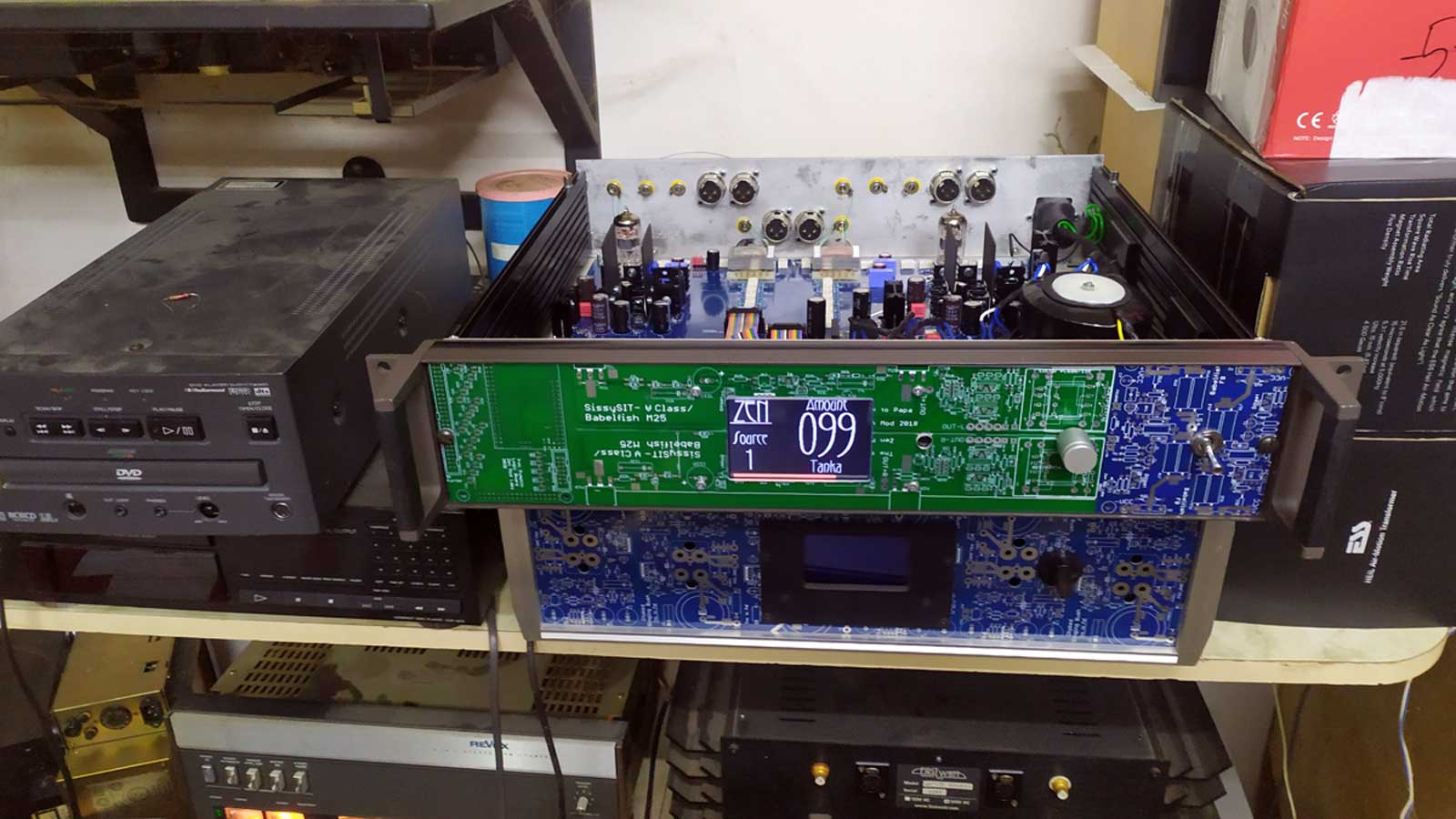

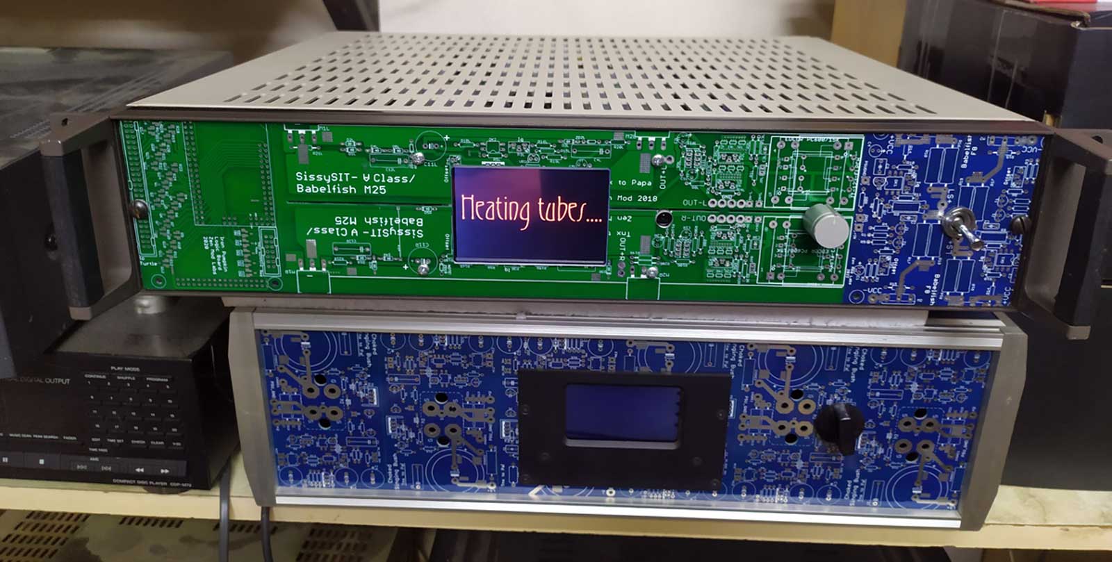

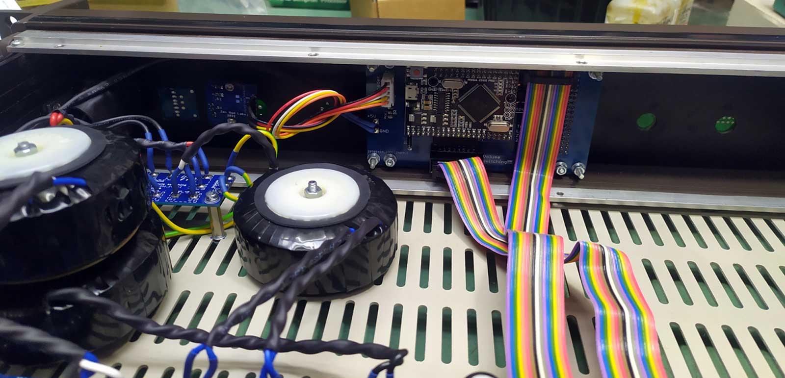

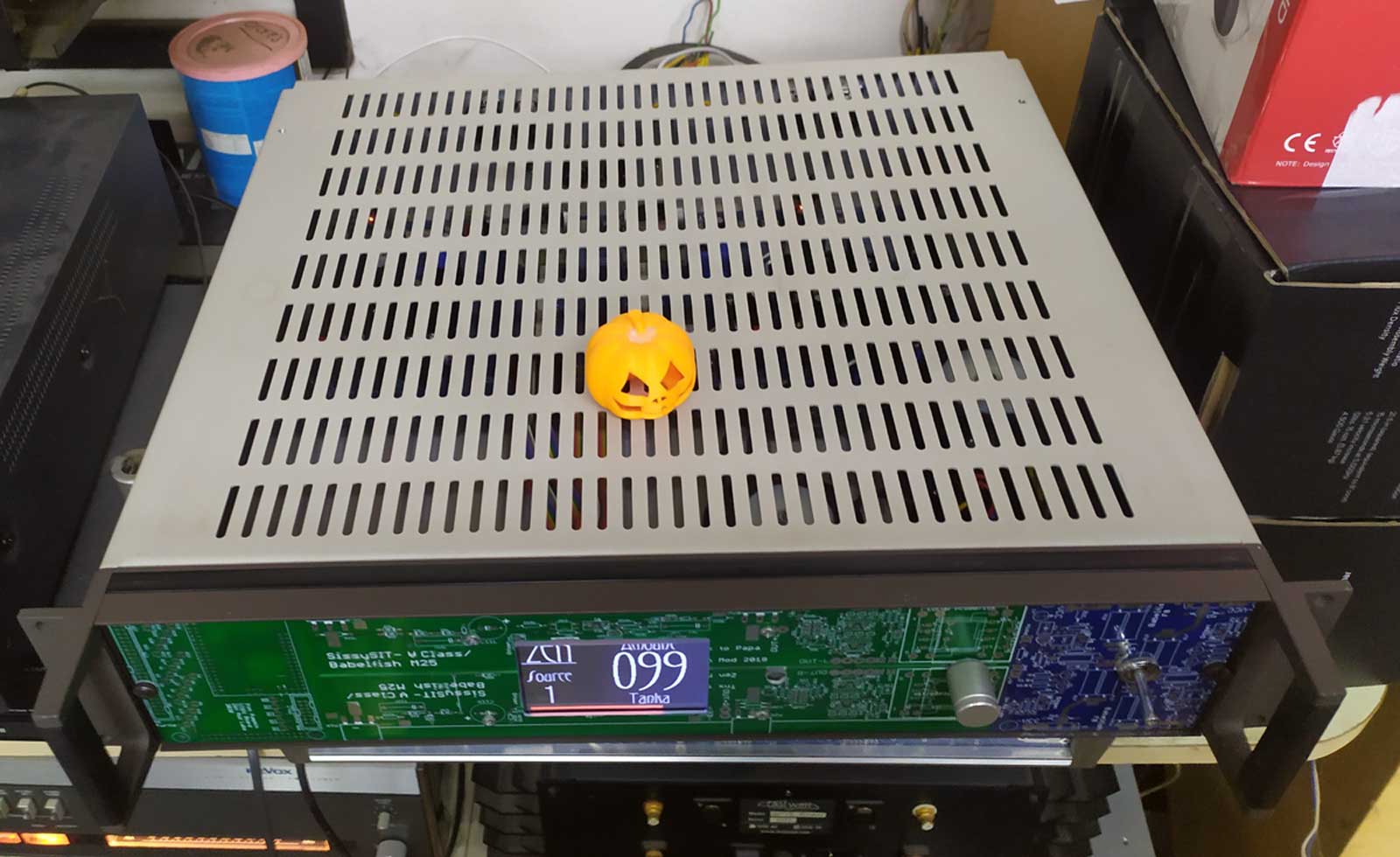

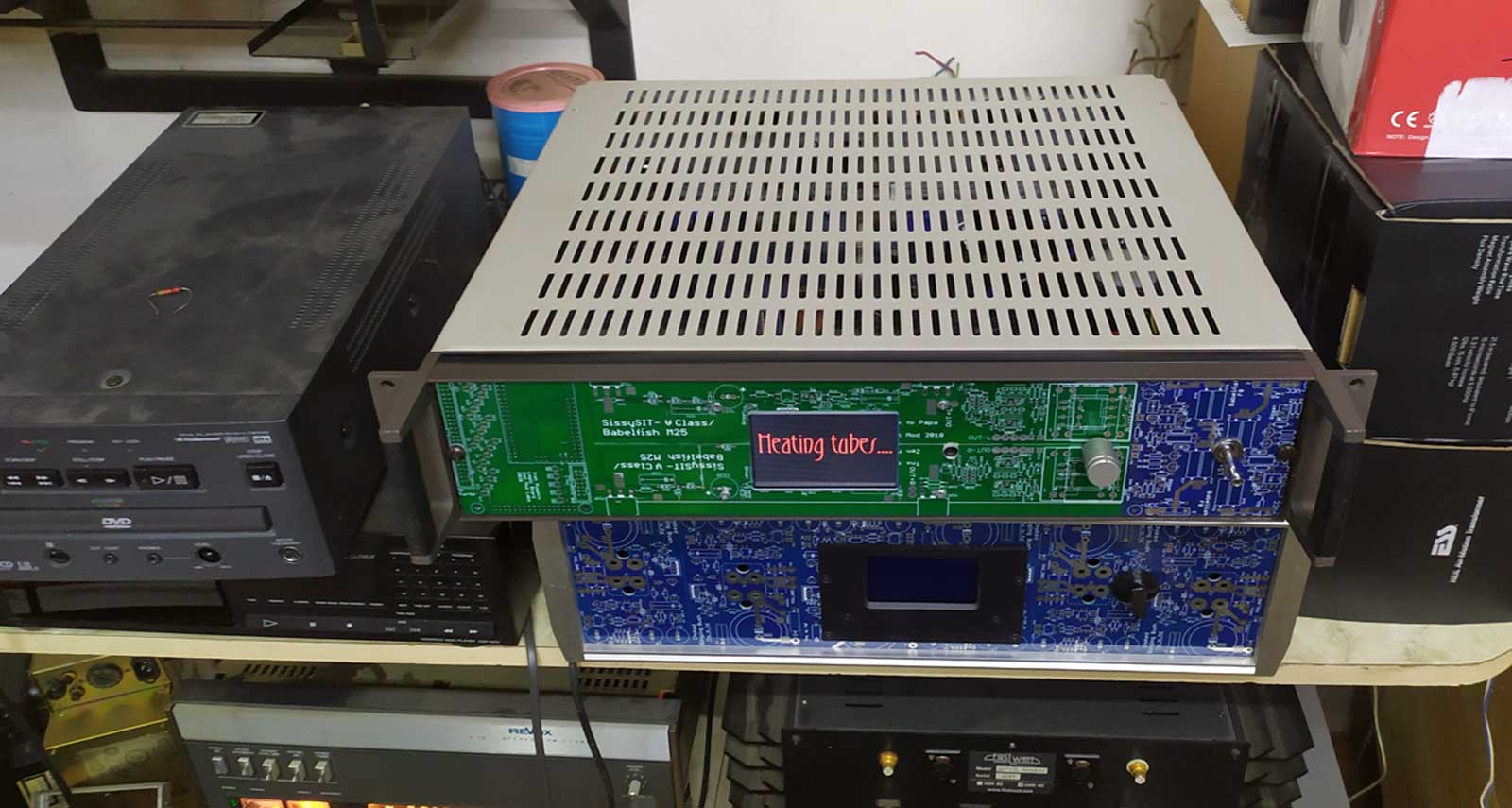

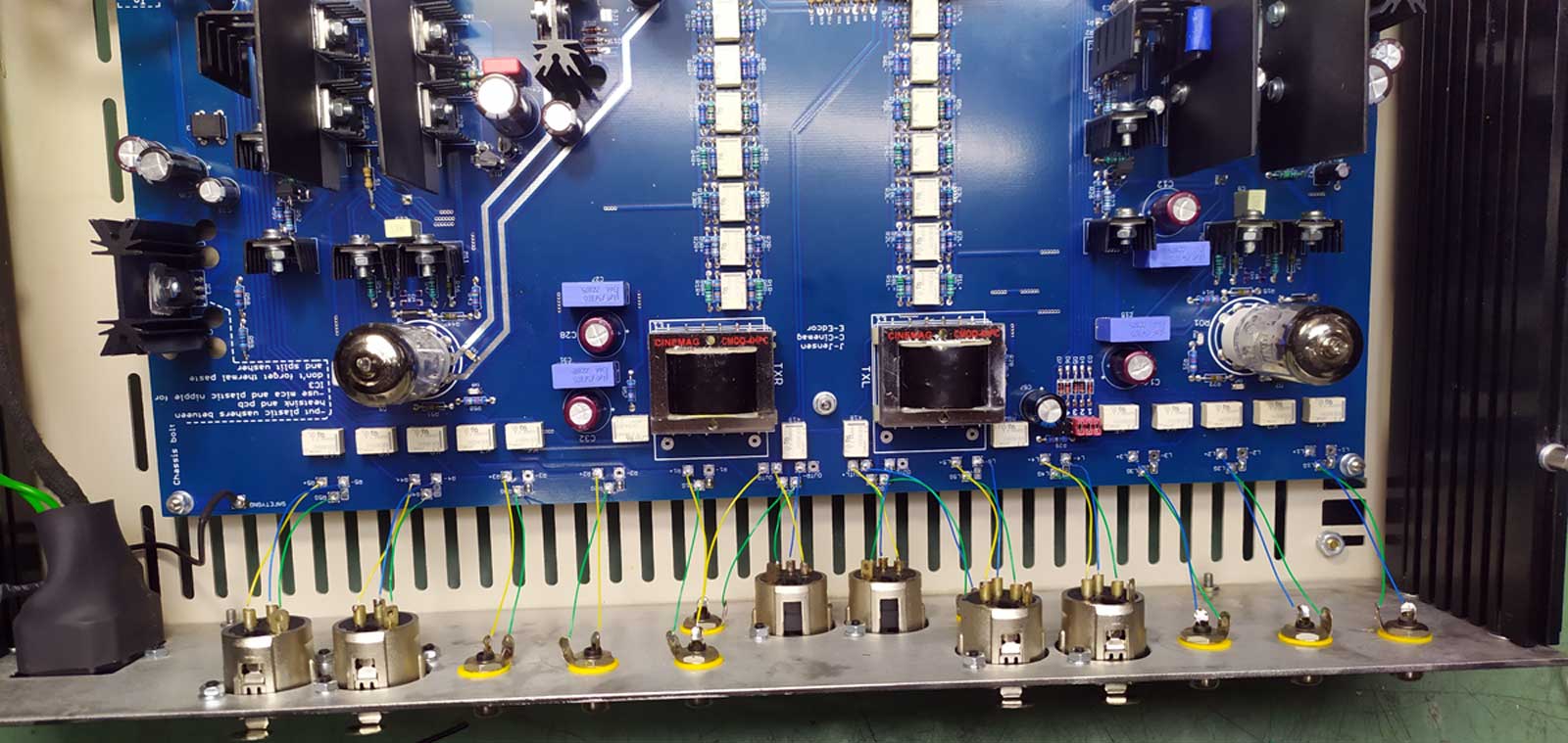

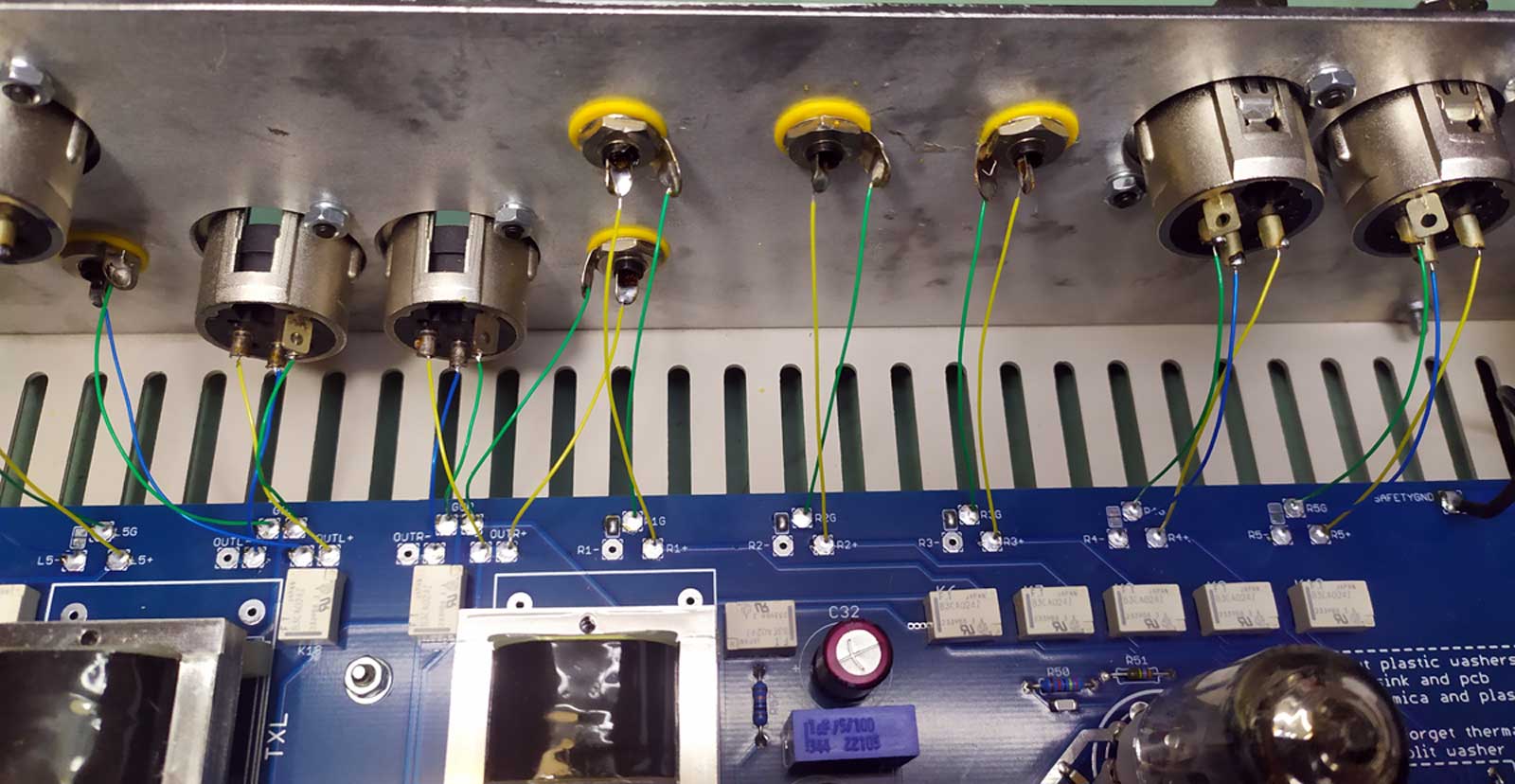

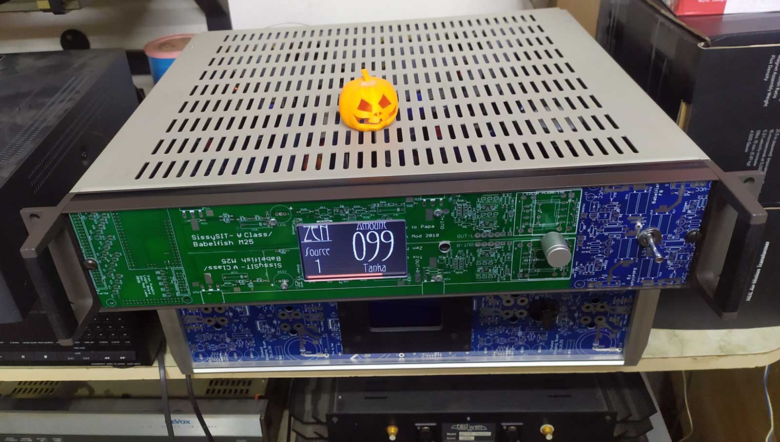

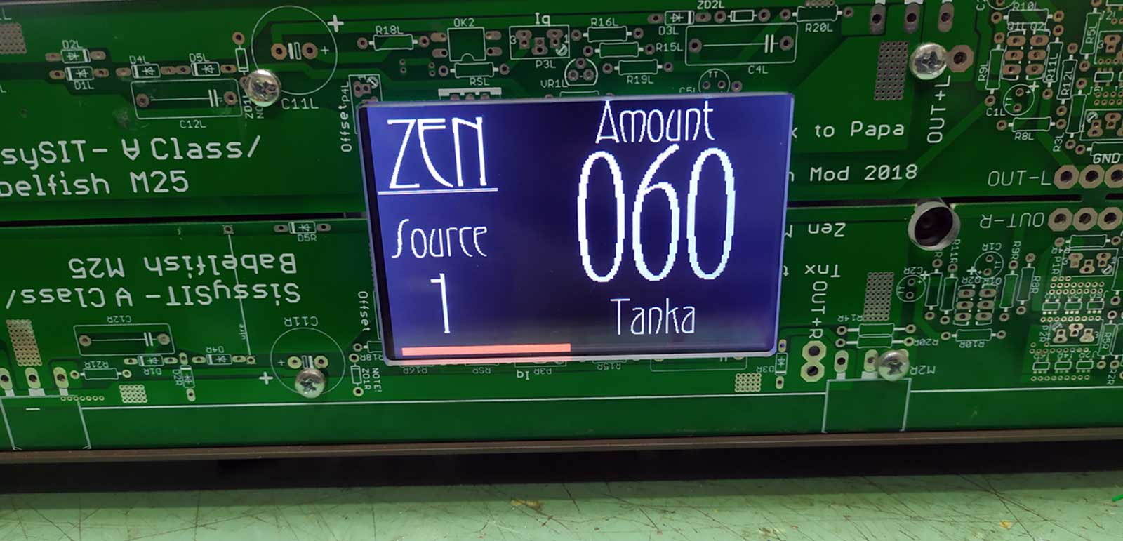

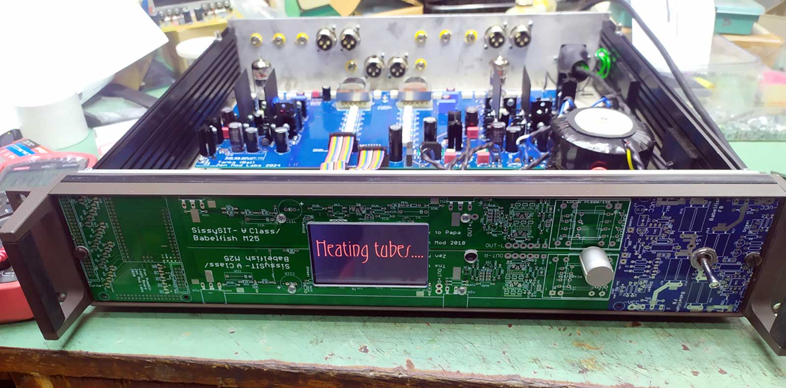

another one, through needle-eye, Public Disgrace avoided by smidge :clown:
edit: my own specimen, deliberatelly made in fugliest! industrial case, adequate front plate, so (hopefully) no one will try to buy it

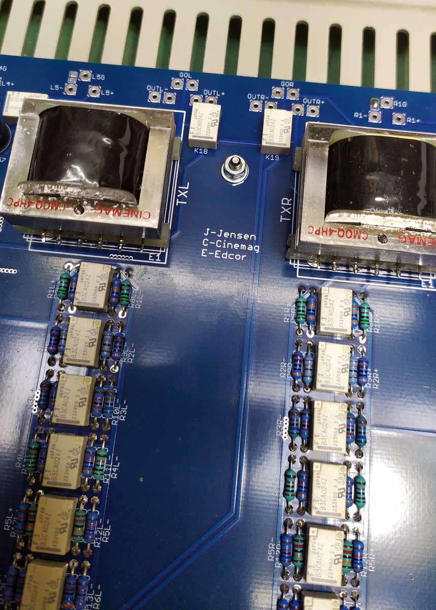

that recipe works ...

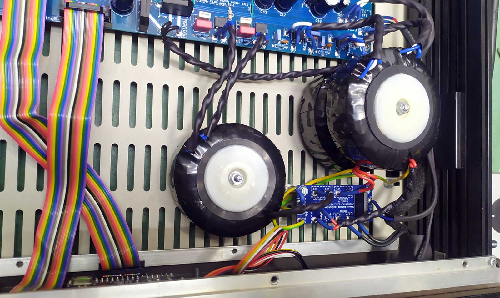

3 Donuts are custom jobbies, static+magnetic shields, mains wires from back to front are shielded then taped with my fave Cloth Tesa
HiNi Cinemagzzzzz are happy, and undisturbed
