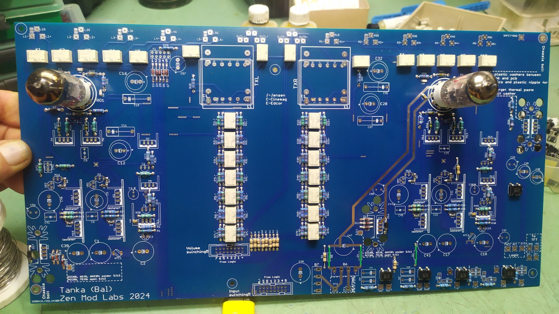

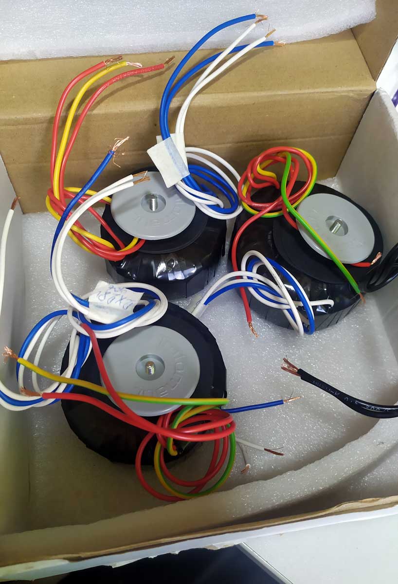

small pcb shown bellow; there are 3 small Donuts wired to
when power switch is flipped, Donut No.1 (heating and logic) is connected directly to mains, so tube heating regs are getting juice and tubes are heating. In same time Arduino Is Alive!, there is (already famous) Greeting screen, written with N. Tesla handwriting font, shown for 10sec, then switching to "Heating tubes..." screen for 20 secs more; then Arduino is powering SState relay, giving mains to Donut No.2 and Donut No.3; 20 secs later ("Heating tubes..." shown all the time), Arduino is energizing all input relays, Volume relays and also "output mute" relay (practically un-muting), flipping in same time to functional screen
All in all, from switch flip to singing , there is a pause of 10+20+20=50secs (first 30 just heating, then 20 unnecessary long to all things to settle), pretty much same as if you're powering preamp in the morning, to be able to watch 20.00 Clock News :rofl:
Donut No.1: 30VA, 24Vct 650mA (TFT, Logic, relays), 9V 1A6 (heaters)
Donut No.2: 30VA, 56Vct, 56Vct ....... is having separate secondaries for each channel, for +/-25Vdc rails; positive is shunt regulated, negative is simple LM337, good enough because there is "just" CCS on negative rail, giving darn good isolation per se; reminder - last pic in #1944
Donut No.3: 20VA, 100V, 100V......... is having separate secondaries for each channel, for shunt regulated +90Vdc rail
difference between Tube-Mos buffer and JFets buffer being not just addition of 2 PSUs per channel (heater, HiVoltage) but also Plethora of details needing attention ........ outcome pretty much as expected - I can live with either/both of them ..... but major bingo is sheer intellectual enjoyment I had while developing it as full package

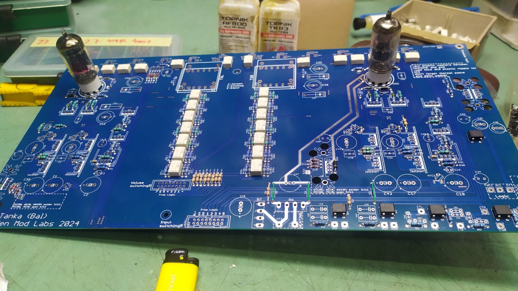

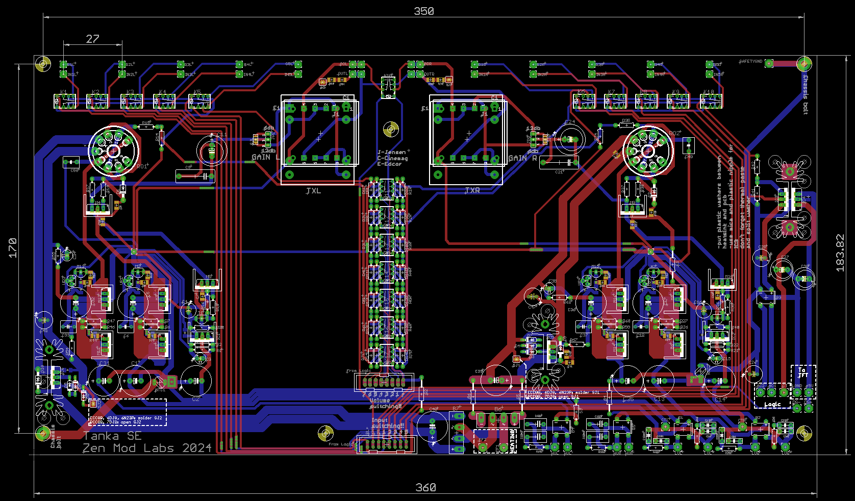

was thinking how to increase useful area of already big Motherboards ......... there is no other way than to move something out ........
anyhow, main idea with Motherboard approach was to avoid messy wiring and zillion-small-pcbs-connected-with-zillion-wires

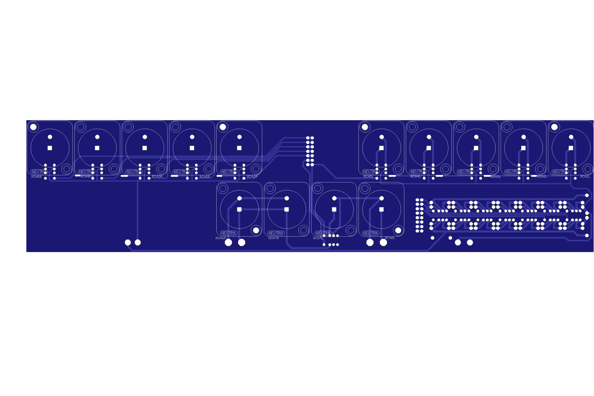

one of these days will make one strictly for RCA, even if that one is less likely to be needed

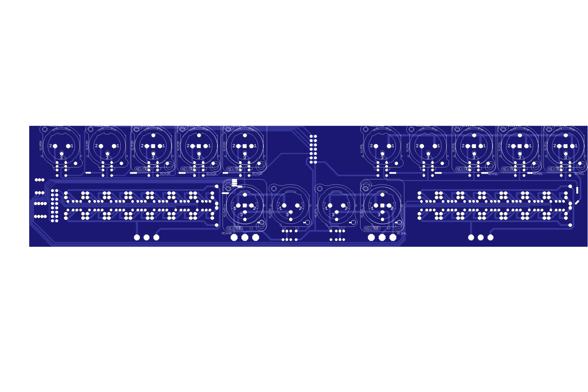

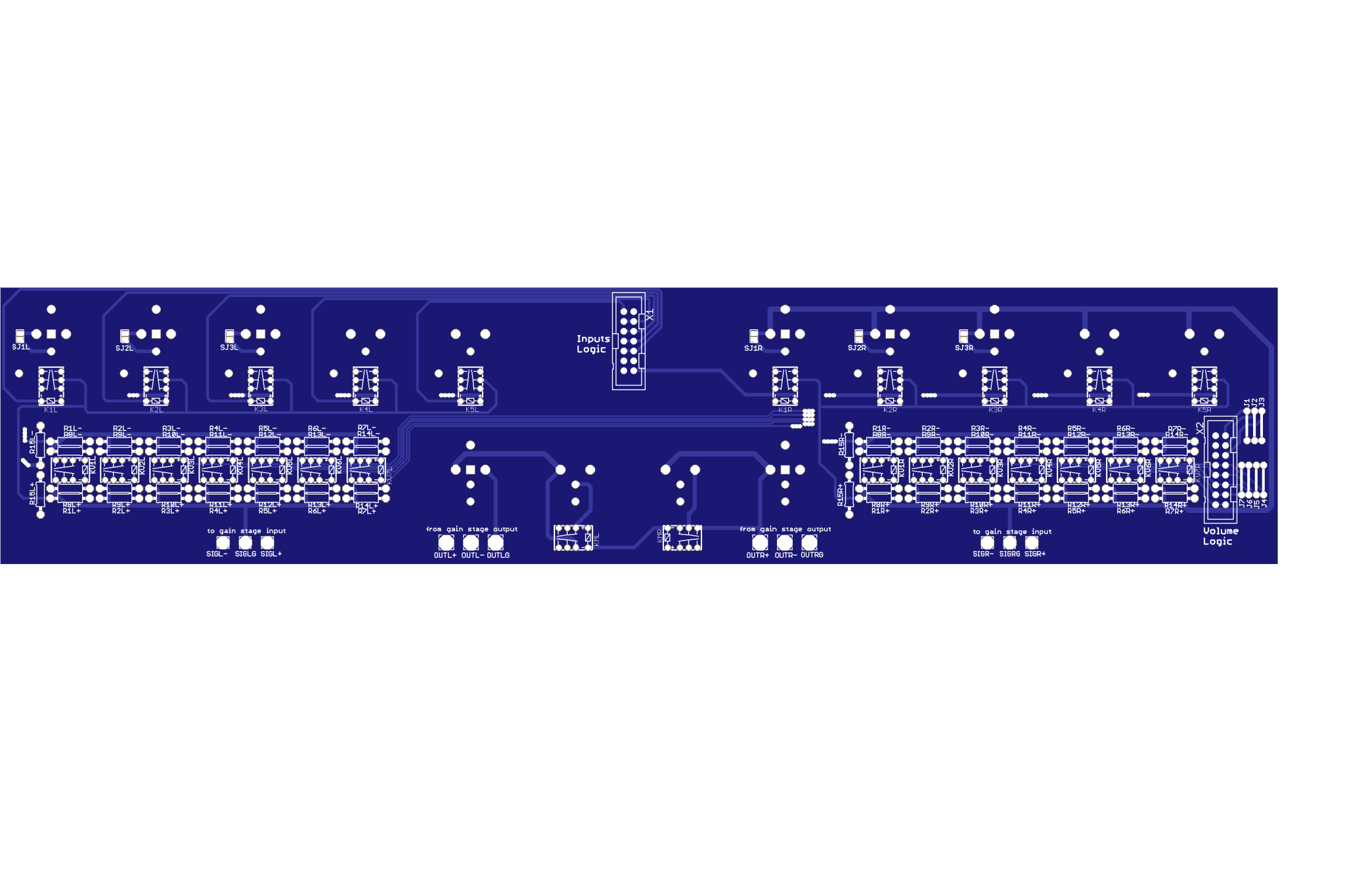

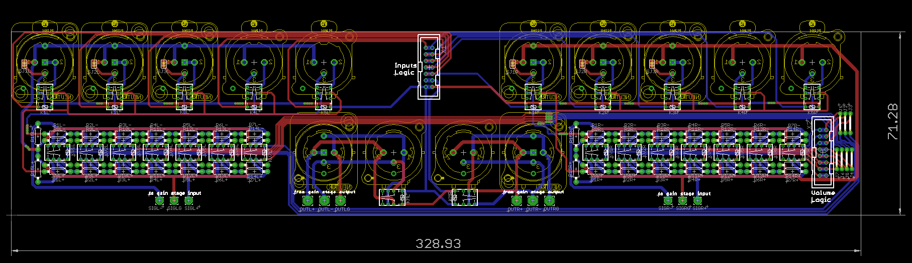

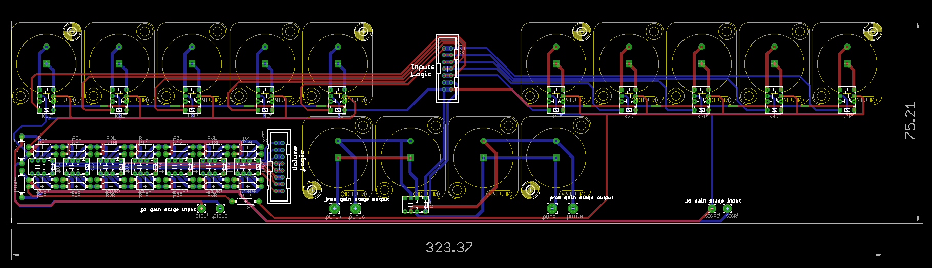

Reactions: pfarrell

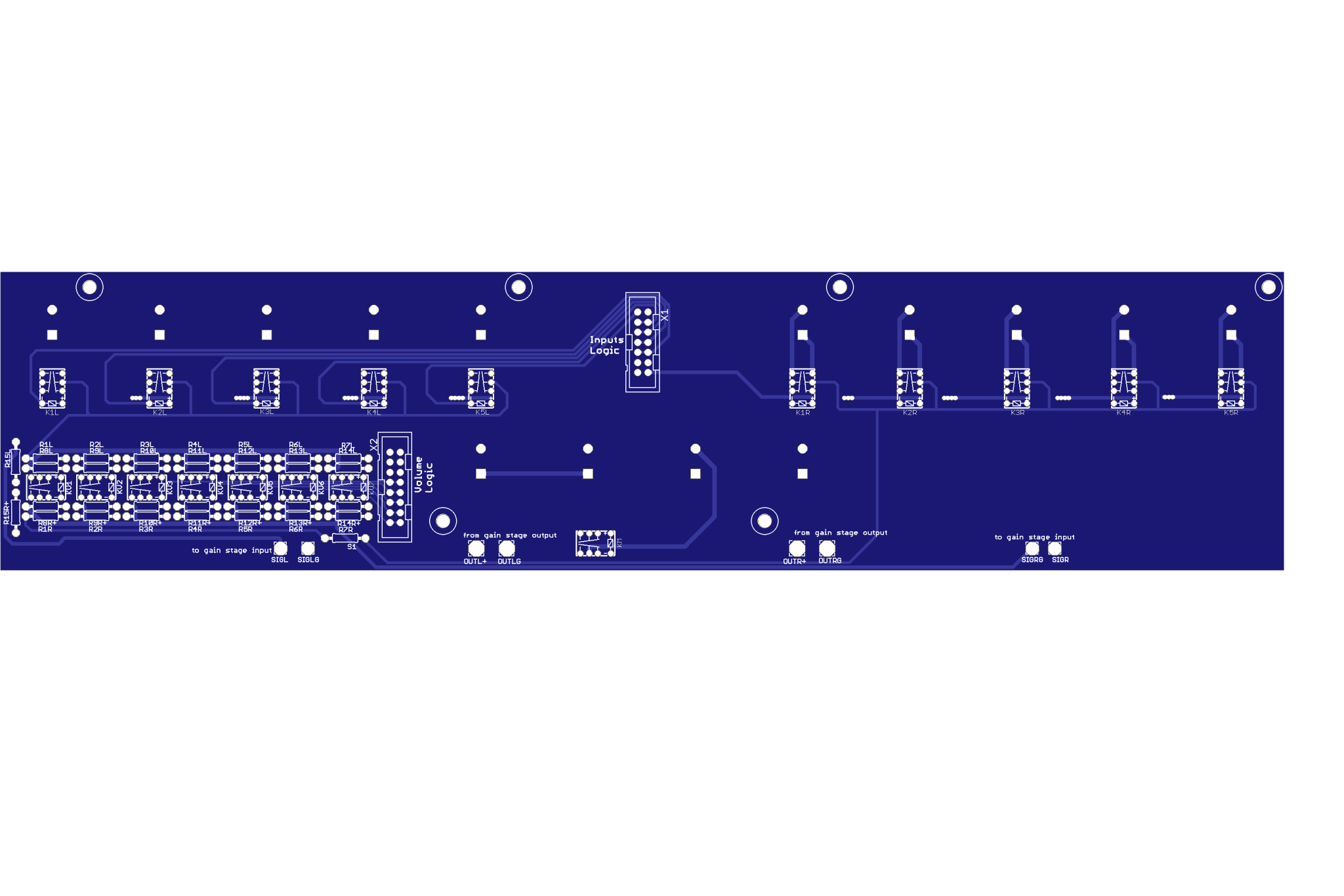

moving selector and volume to back plate pcb
resorting to straight solder pin Neutrik XLRs and - for case with RCA - regular "cup" Neutrik RCA, so shown pcb soldered ditto to connectors, no other fixing points needed
(though, for RCA, will include screw holes, to mount pcb practically on long screws fixing RCAs)
when all that moved from main big pcb, there is even less wires from back plate of preamp to main pcb, while huge area on main pcb freed for all shenanigans
