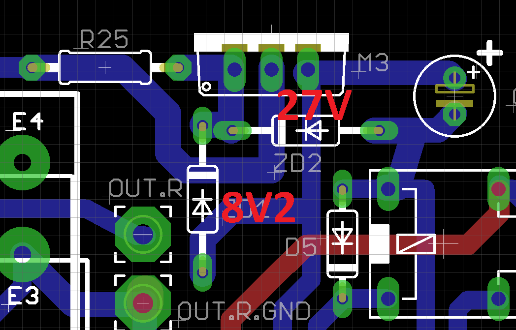

if there is any mistake, blame me ........ or even better - blame Pa 🙂
this will help
edit: ignore ZD1-ZD2 designation
as I wrote somewhere, due to mishap with my PC years ago, I unfortunatelly lost consistency between sch and brd Eagle files for this project, so had to wrestle with that even until now, evidently
red written numbers are how zeners needs to be placed

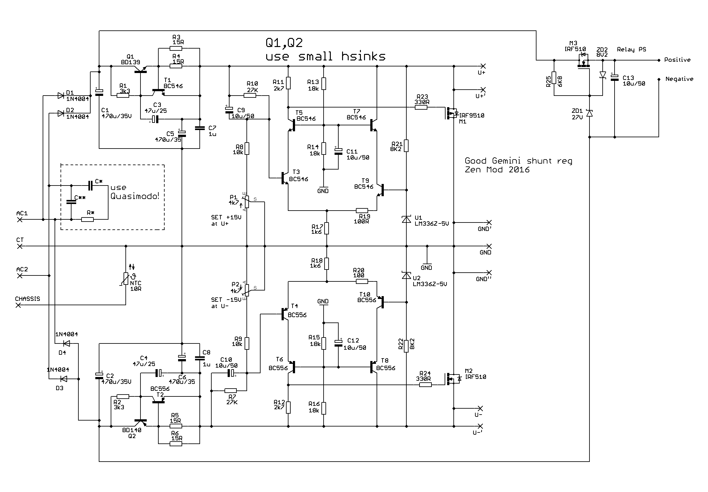

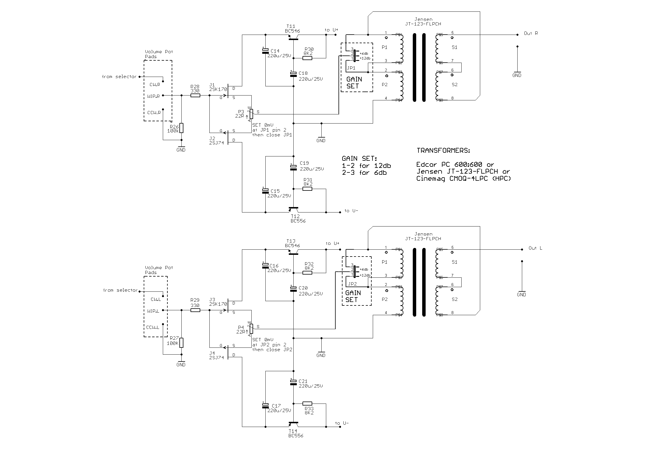

I was just following traces on the PCB I have, but looking at the schematics makes it a bit more straightforward. I don't see an issue, but you may 🙂
yup, no relays, no need for parts situated in upper right corner
and yes, input ditto at wiper and gnd beneath
then to AVC of your choice and World is your Oyster

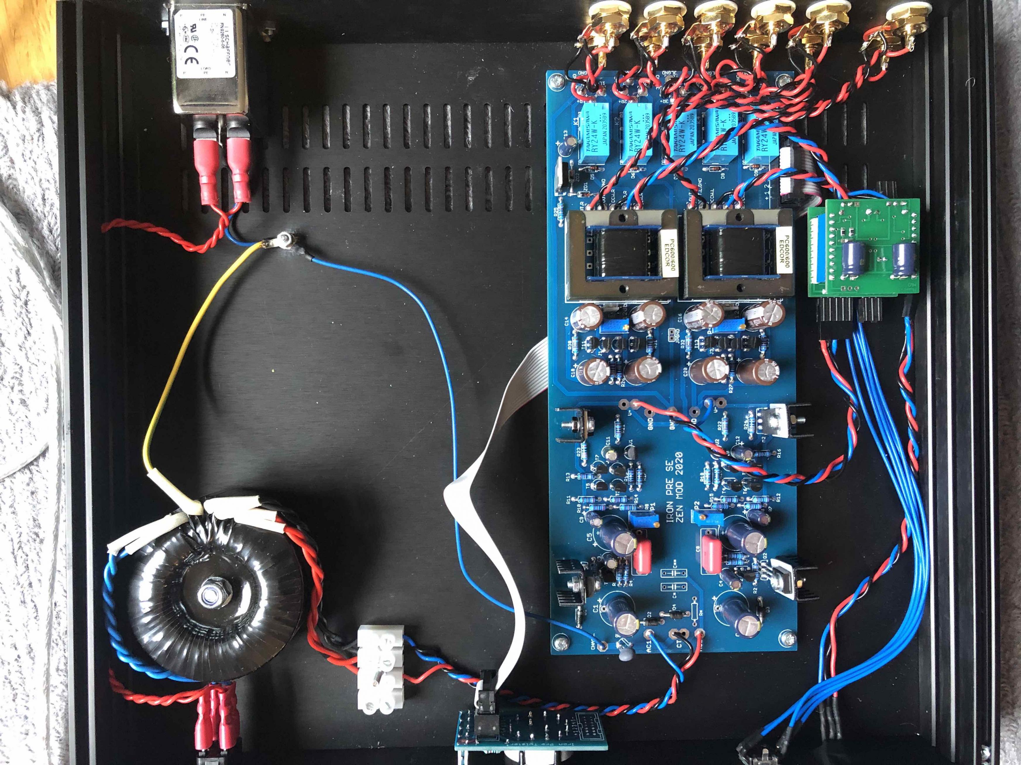

Following up with the 2016 board, stereo.
I changed my speakers from Pioneer SP-FS-51LR to Polk lsi15. This increased the hum. I cut the ground trace and this resolved the issue.
Still sounds sweet, with babelfish 2j as the amplifier.
Thanks again ZM !
I also built the 2016 boards, and had a similar hum. I forget now without going back in this thread to where I built mine, but later to clear up some other minor deal. I went ahead and also cut those other traces around the relays that ZenMod suggested. Total quiet, no popping between channels, etc. Really love the PS and relay board (I usually use a teabag Inselect here) all on one board.
