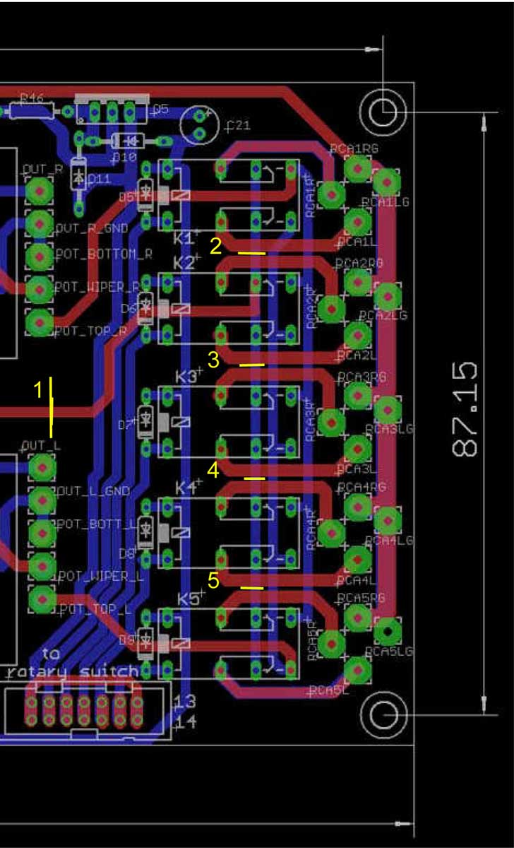

You guys are always kind to teach me... So, here goes nothing. Per schematic attached, the relays are in the open position for a normally open relay, correct? So, wouldn't all the input GNDs be shorted together when powered off per the schematic? Do I have it backwards or just plain wrong? It looks like the positive input leg connects when the relay closes for a normally open relay.
Under power, if they were all normally closed, wouldn't all the relays, except the input selected, be closed when in normal use? If the input selected switched from closed to open, it would not send a signal through the pre-amp when powered on, right?

Dennis - remember that all prototype series pcbs are having muting arrangement for unused/not selected inputs - they're simply grounded
go back and see , few pcb tracks need to be cut with exacto knife

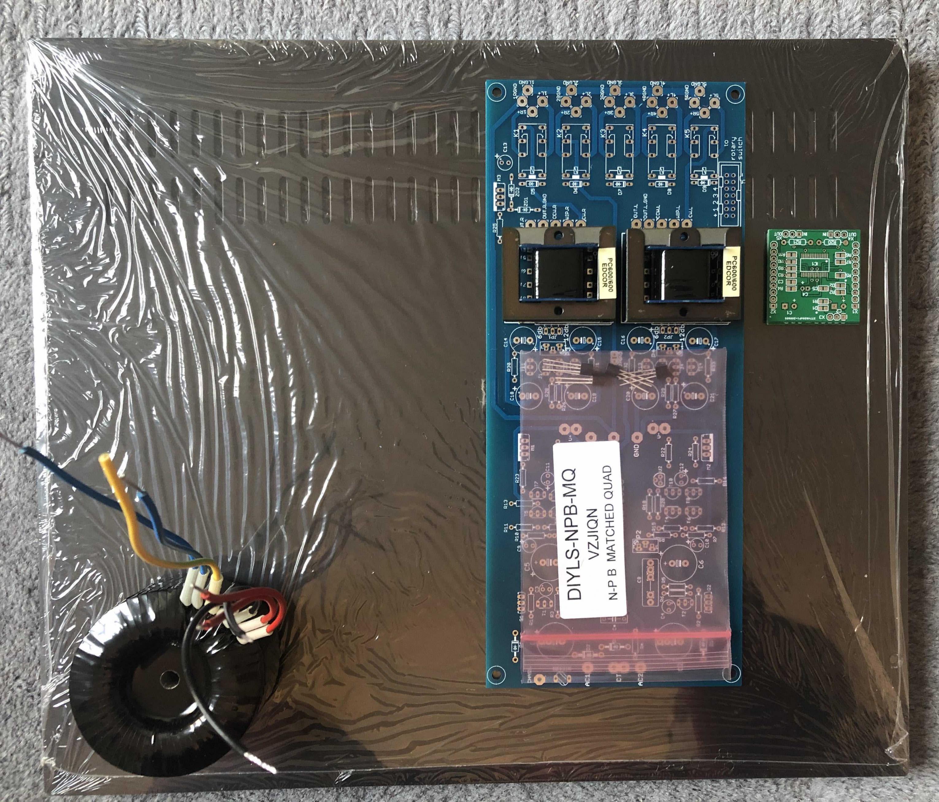

Thanks to the generosity of Jim, I have received one of the Iron Pre boards (2020 version). I also got meldano's Muses Volume Kit, which conveniently needs a +/-15V power supply. Should be a good project!
The case, transformers and Jfets already arrived, so now I just need to collect all the remaining parts.

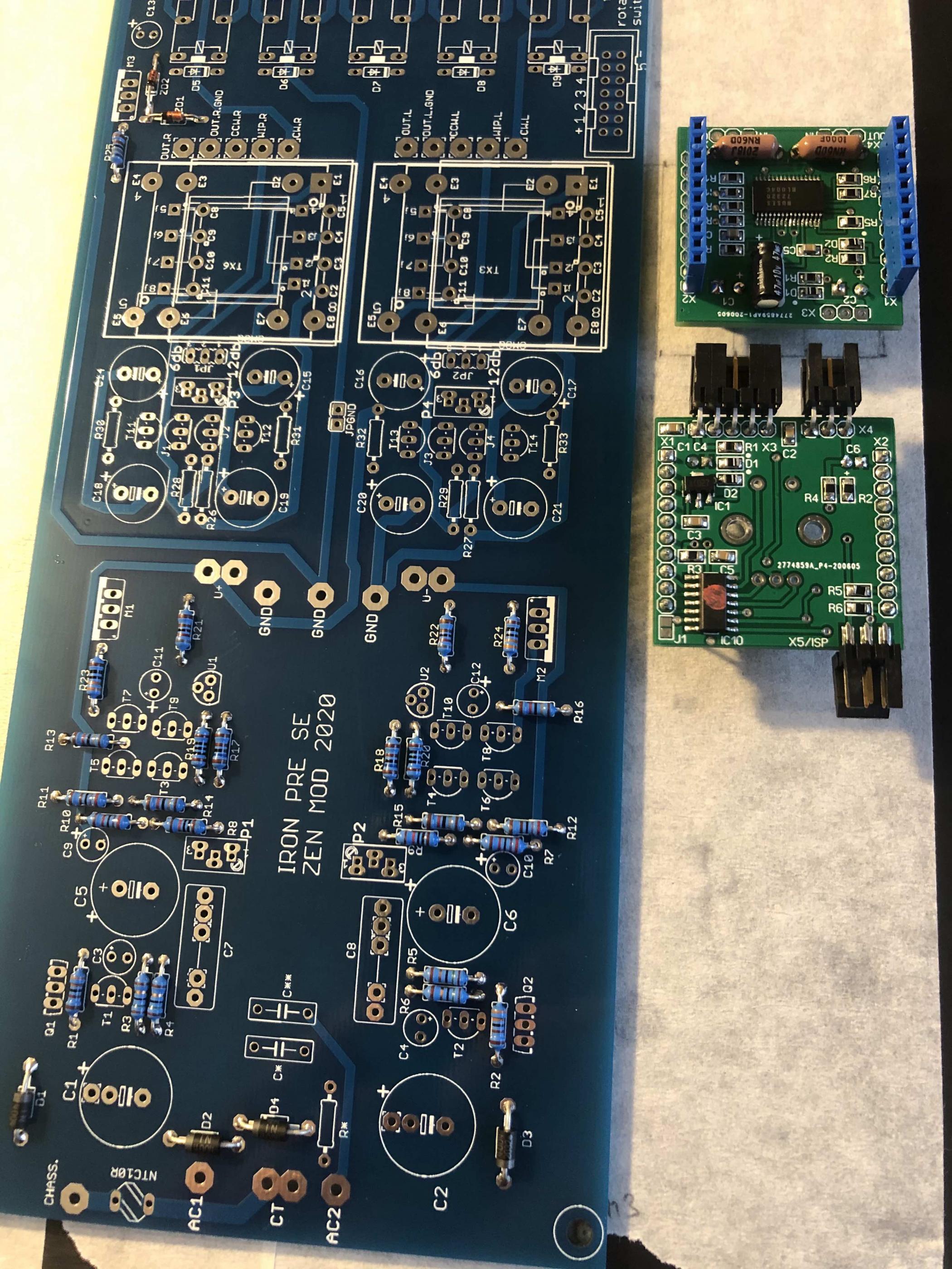

Made some progress this week. PSU diodes and resistors are populated...
The Muses volume control is finished (the encoder will be wired to the front panel). My first time soldering SMD, which was actually a lot more fun than I expected!

cut them all , except 1, do not mount jumper
to avoid summing of unused inputs
with commercial sources, having higher Rout, we can have some xtalk.... which is not case with Pro sources, from where muting scheme is taken

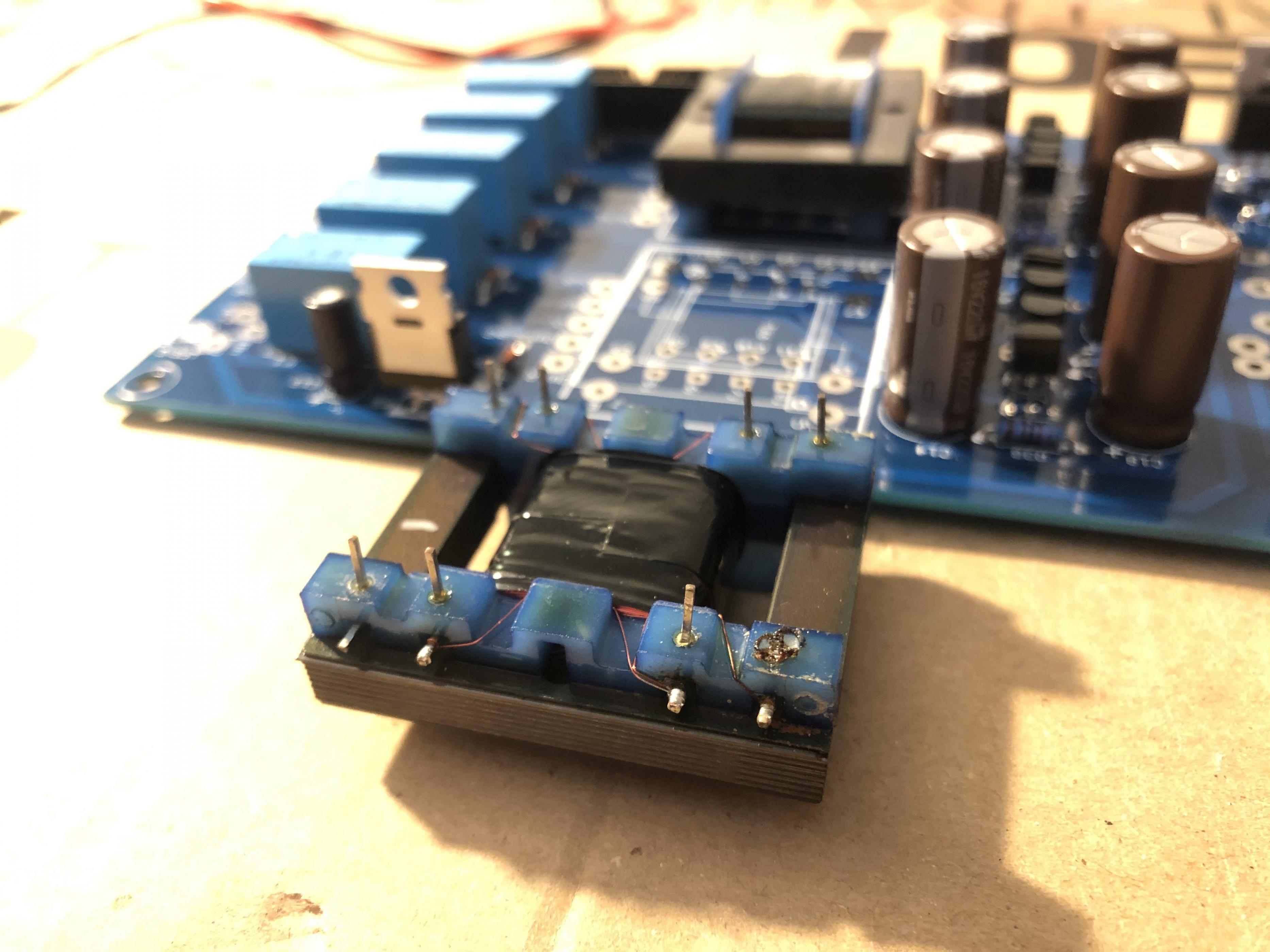

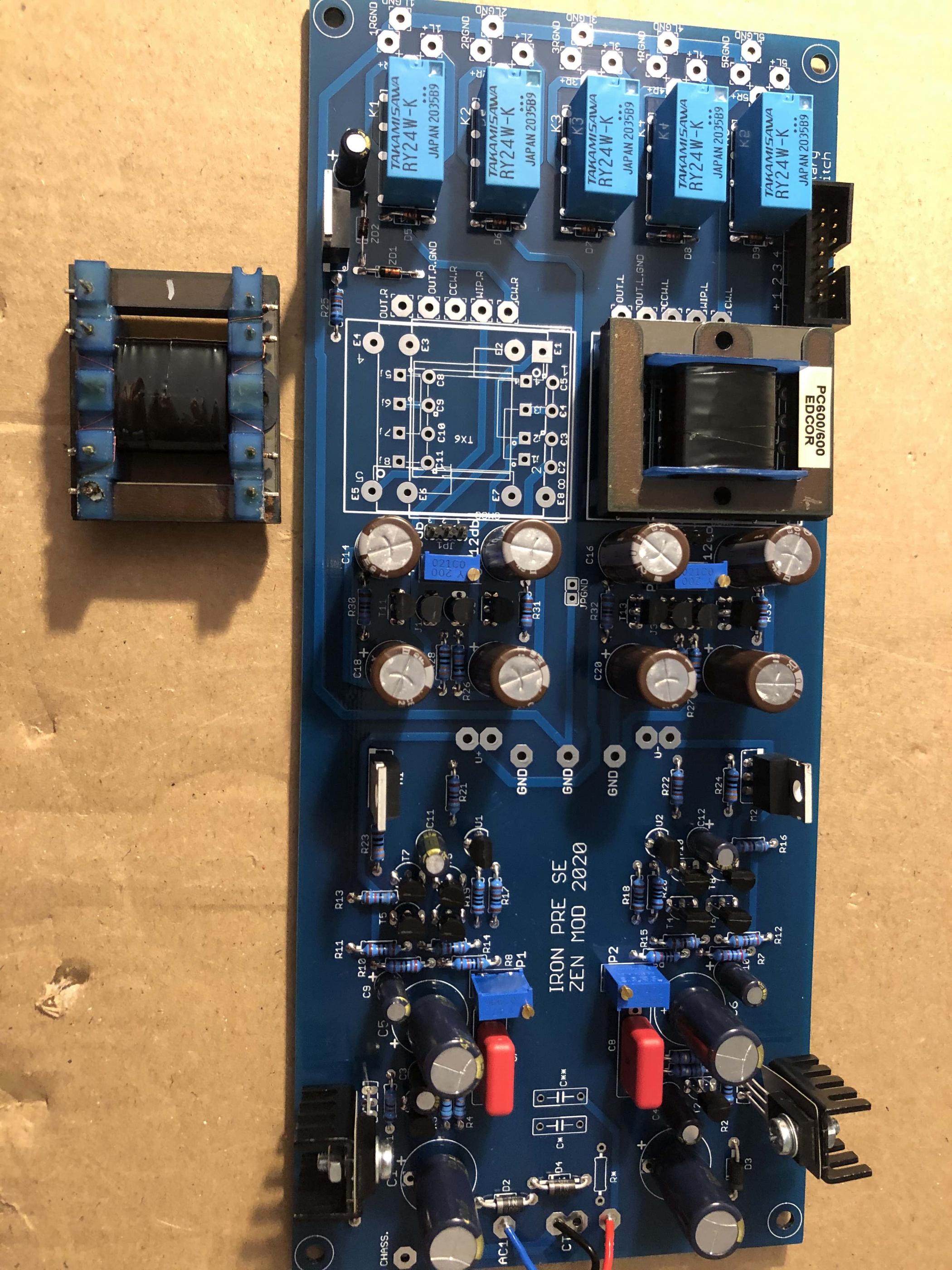

I did the "surgery" and the boards are stuffed sans iron. Then, a leg of one of the Edcor transformers snapped off as soon as I touched it...
I tried to solder in a new leg, which was unsuccessful to say the least. So, this won't be finished this side of the holidays unfortunately.
