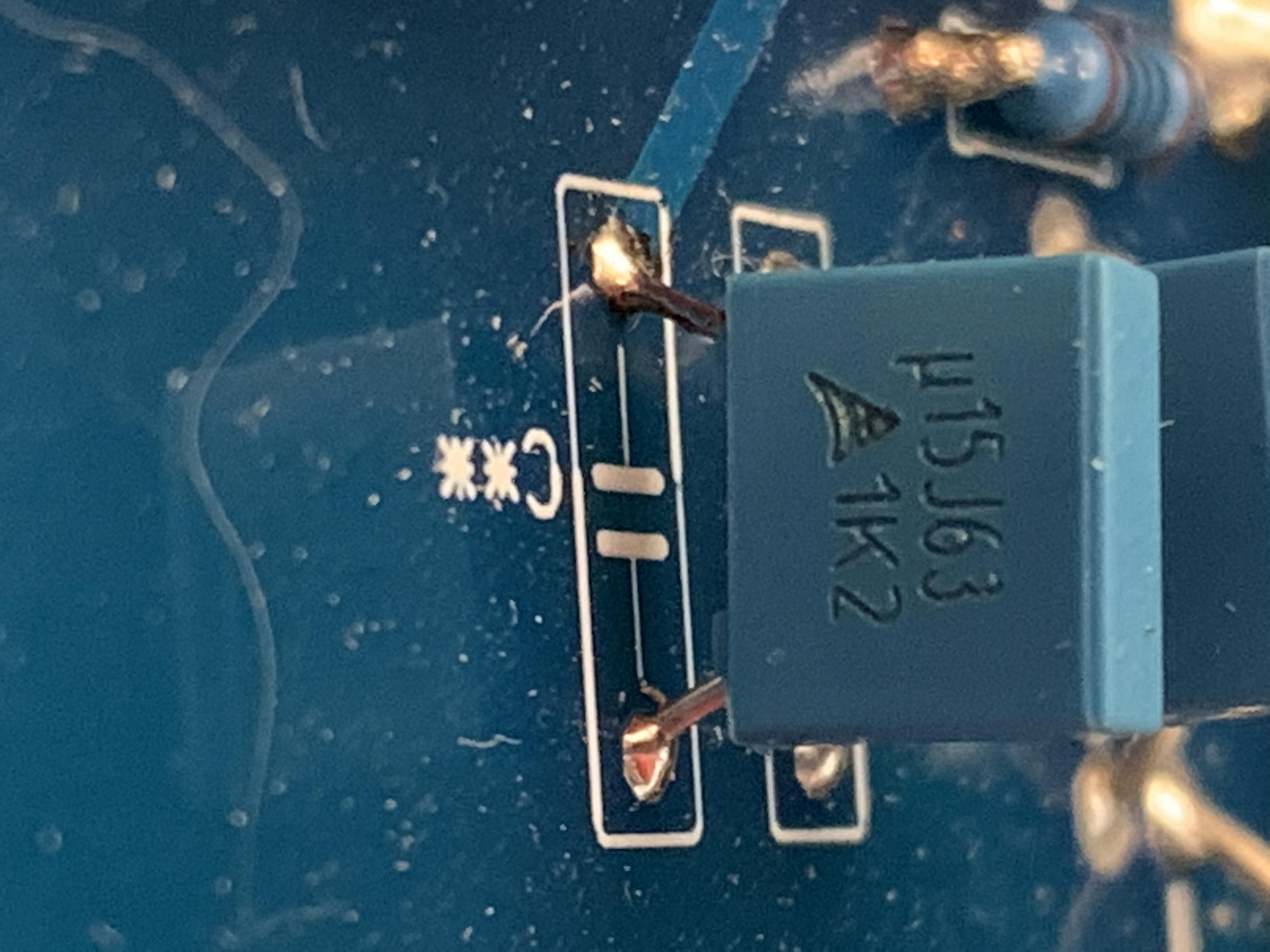

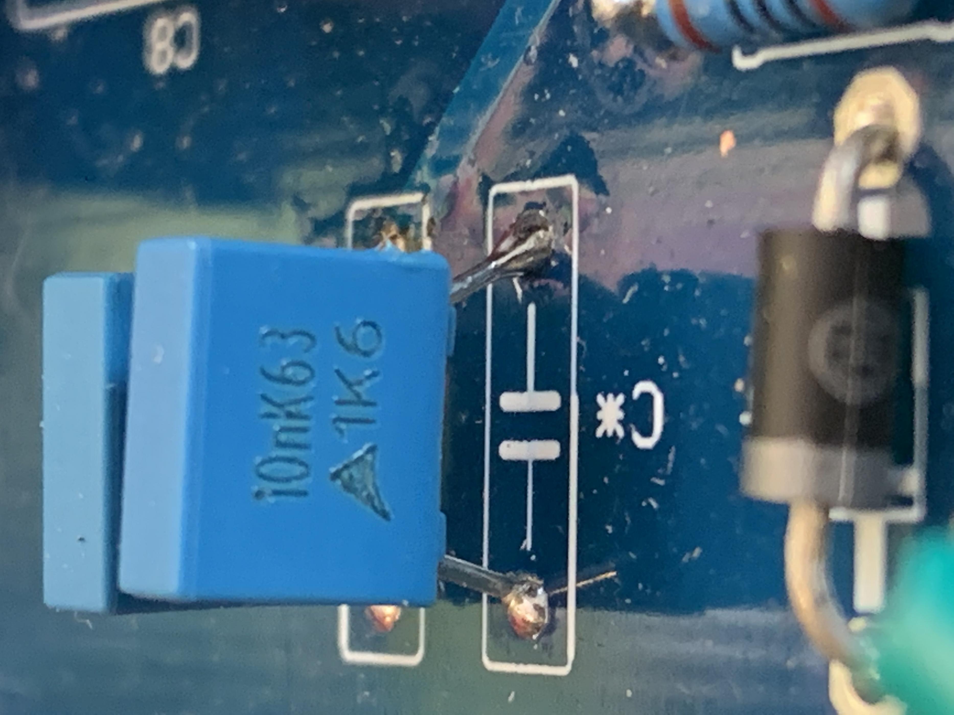

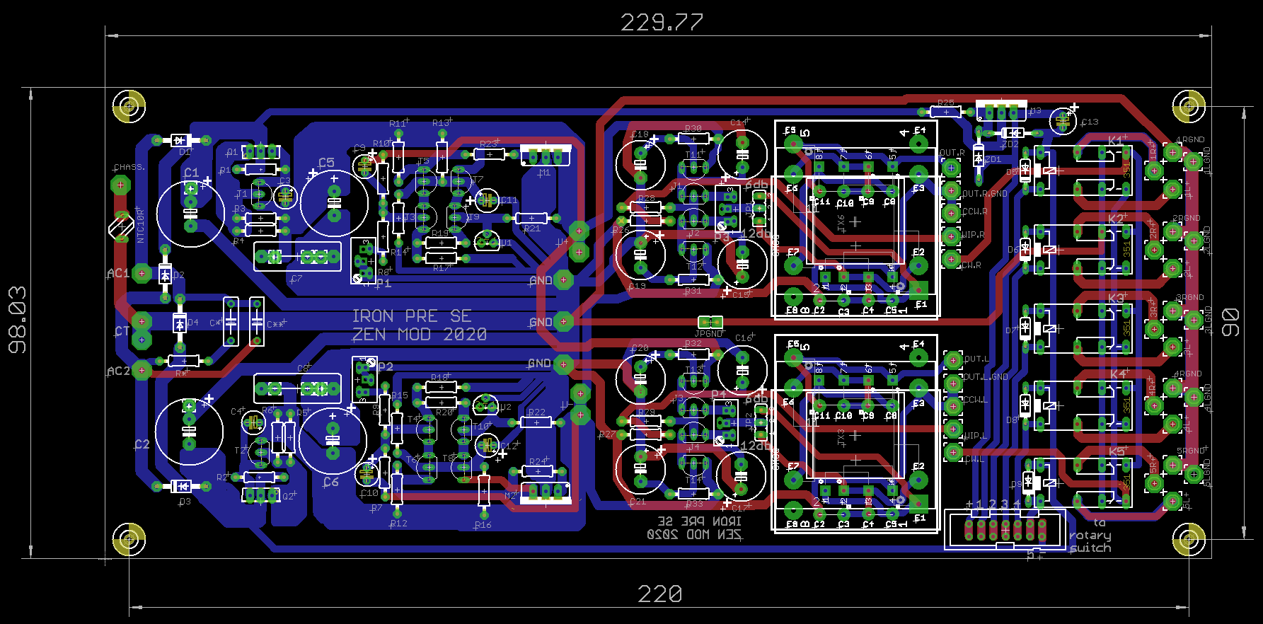

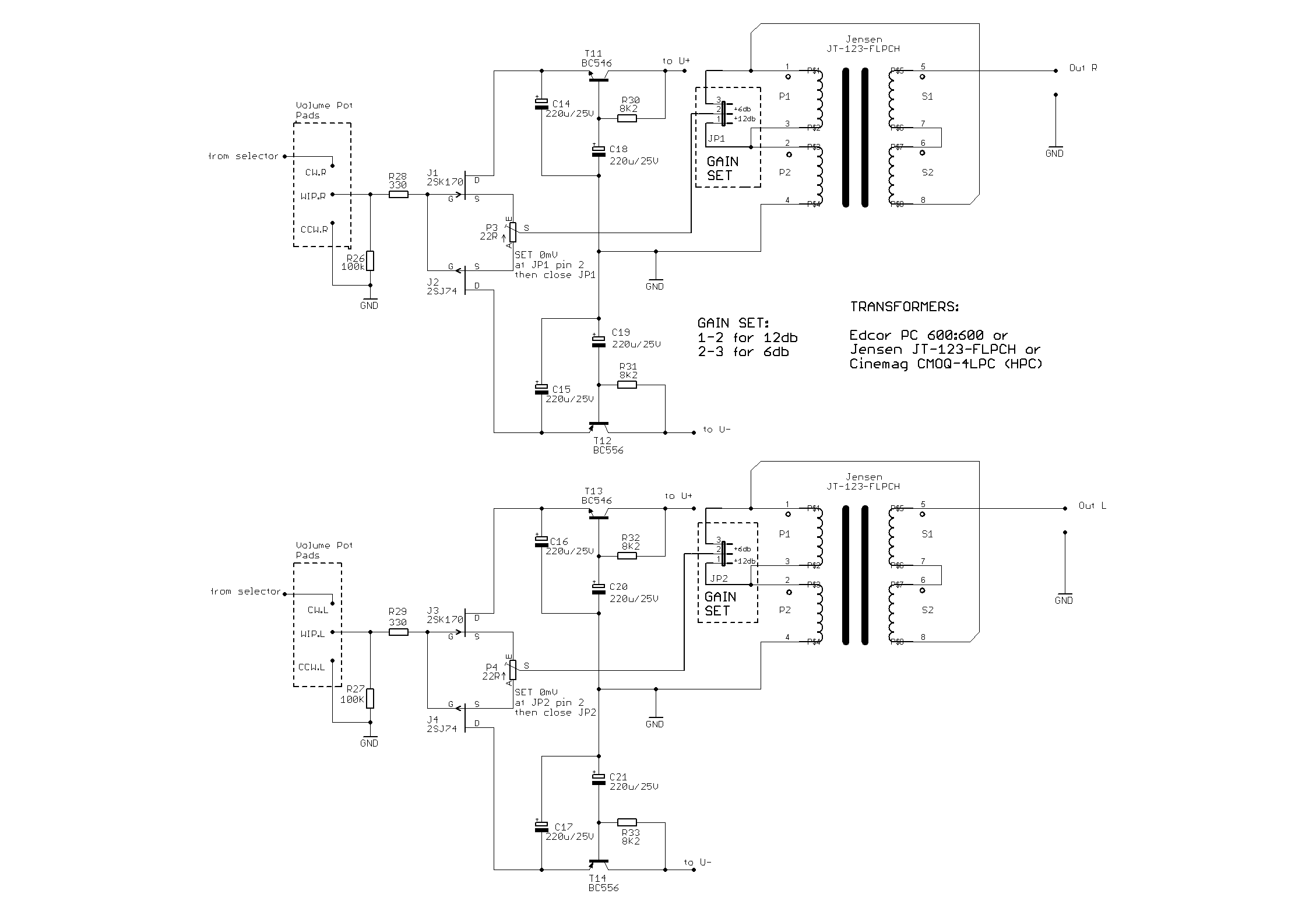

A few more checks. Still on single board powered up only.
Psu is 14.98 +/-
Pin 2 is 0.0mV
I removed the jumpers / bypasses I installed for cinemags and used 12db jumpers. Still hums. Shorting an input silences that channel. Other channel still hums.
try routing your input twisted pair directly to buffer input
hot to end of R28, gnd to central GND point
Still humming into R28 hot side and straight to ground.
I'm poking around the transformer traces.

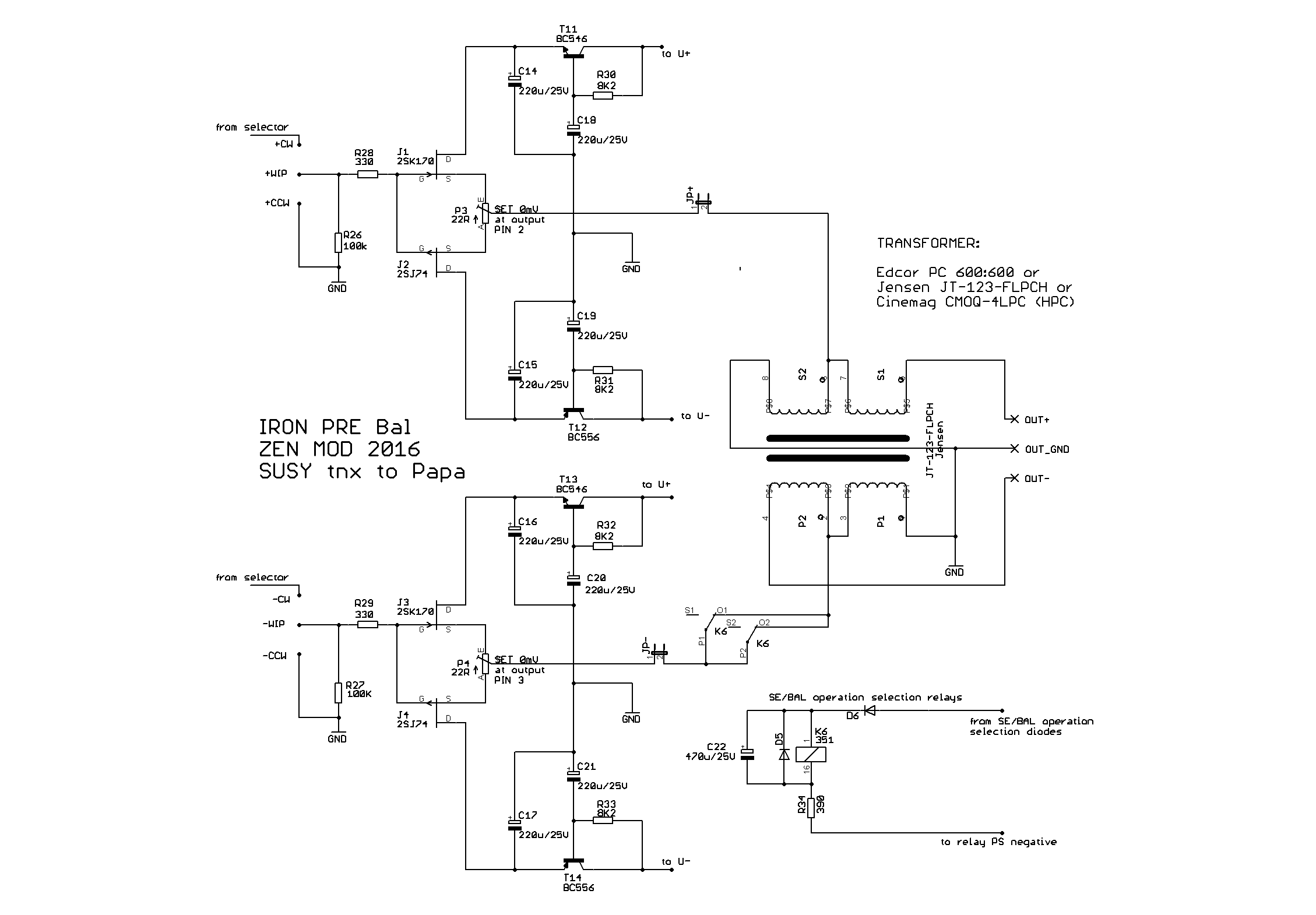

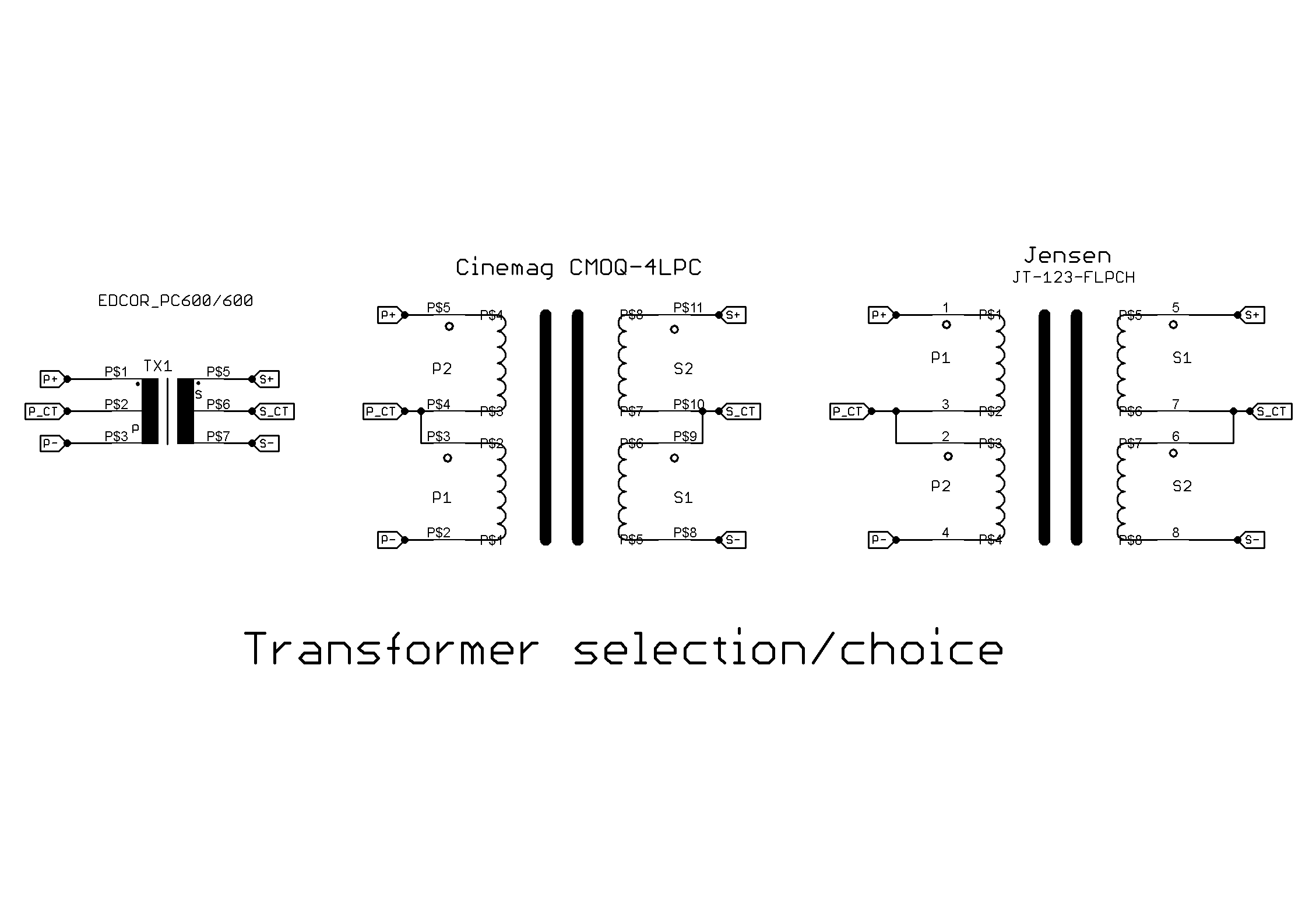

Pin 1 goes to: J2&3, C3&4, E2 Appears OK
Output - J5, C11, E5 Appears OK

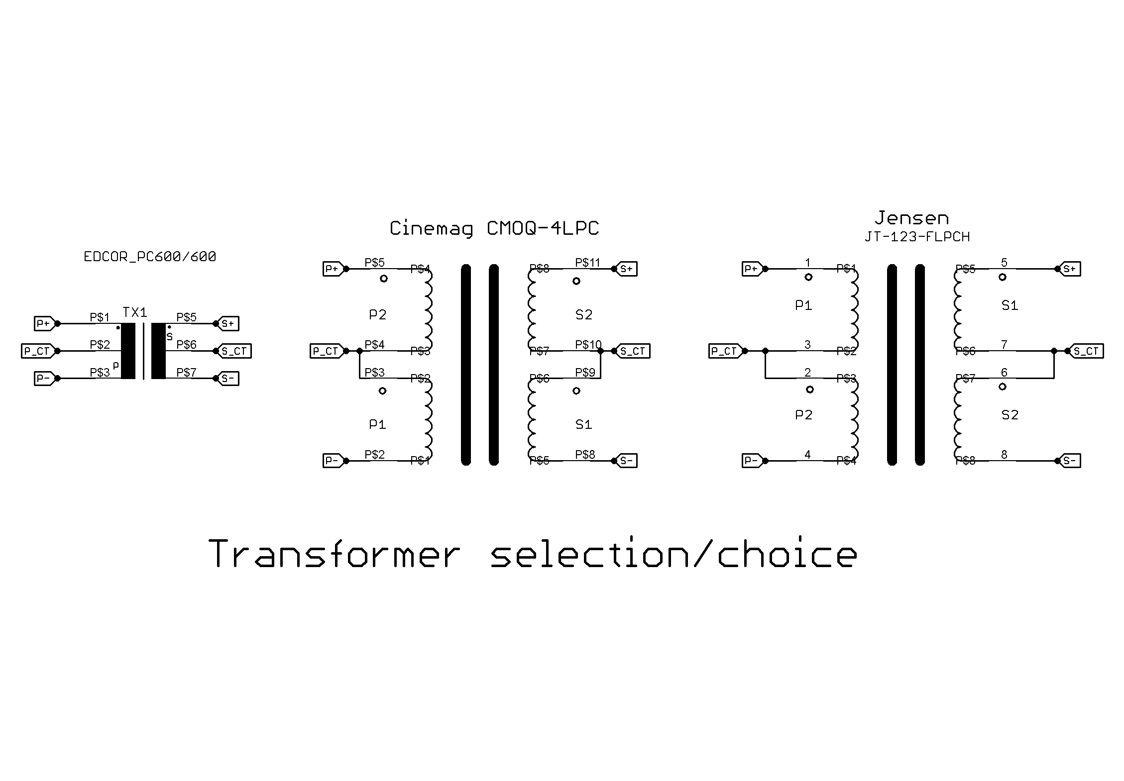

Pin 3 goes to: J1, C5, E1 Should it be C2 instead of C5?
Ground: J4, C2, E3 Should it be C5 instead of C2?
Does the swap of C2/C5 really matter? Is it P1:S1 / P2: S2 for Jensen and Edcor P2: S1 / P1:S2 for Cinemag? Does this matter?
I can't find a trace for the connection on the schematic from Pin 3 / J1 (Primary 1) to J8 (Secondary 2). That's the jumper added. It appears this won't work for Jensen, Edcor, or Cinemag. Is that true?
Well.... upon closer inspection I think my snubber caps are swapped! I’ll let you know results after a correction.

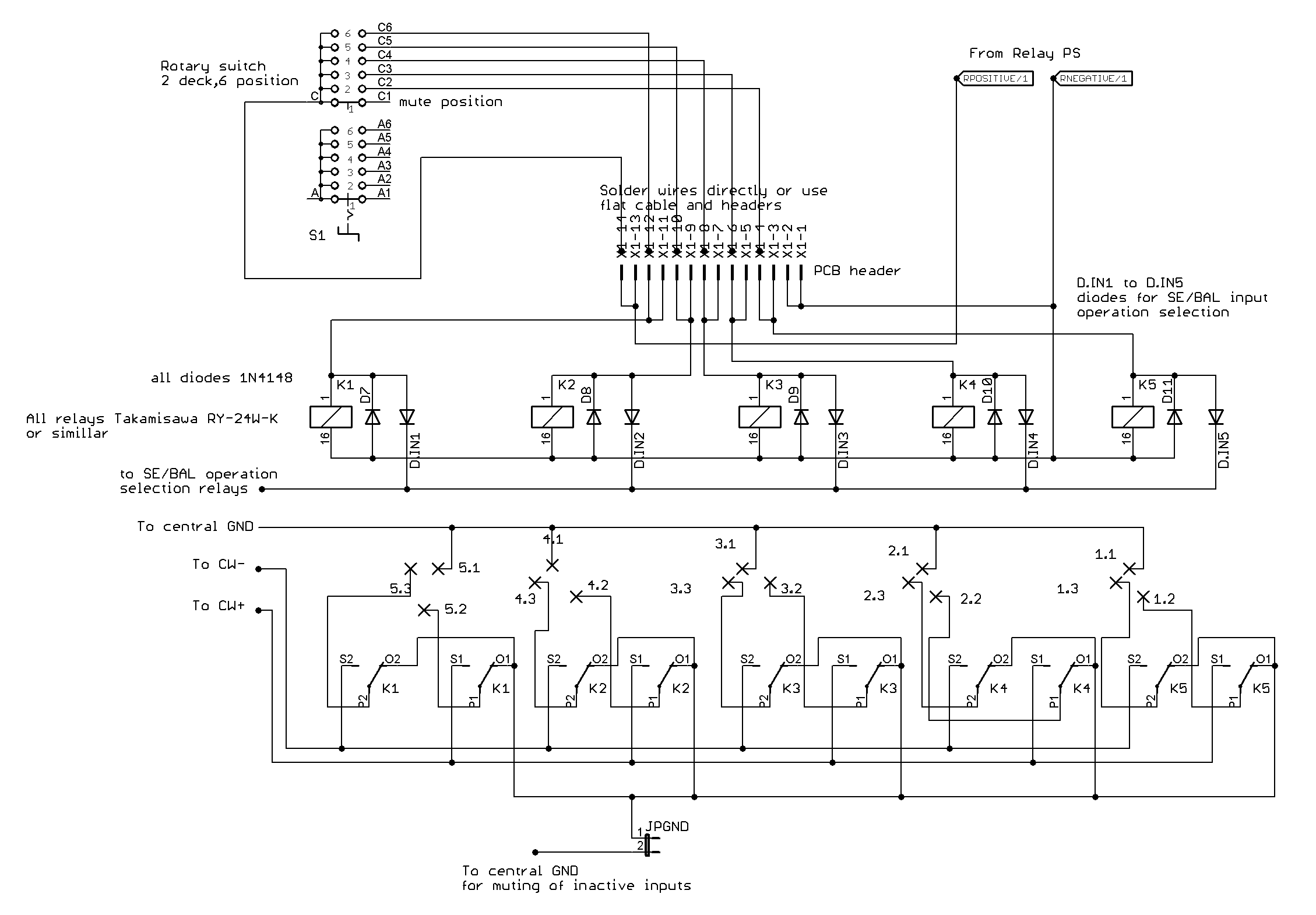

Iron Pre SE files
you can make your own from enclosed files
print parts placement in proper size then use ruler to get pinout for few parts - elcos for example
all resistors are regular metal films (600mW, 0207 size)
caps - none of them needing more than 35Vdc rating
note: one pcb for stereo (two channels)

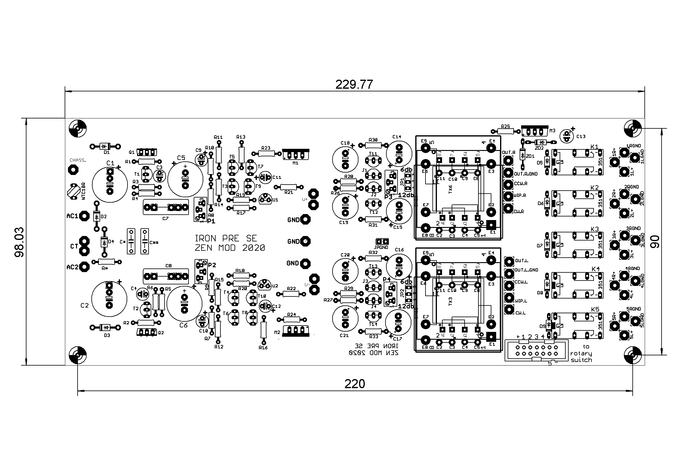

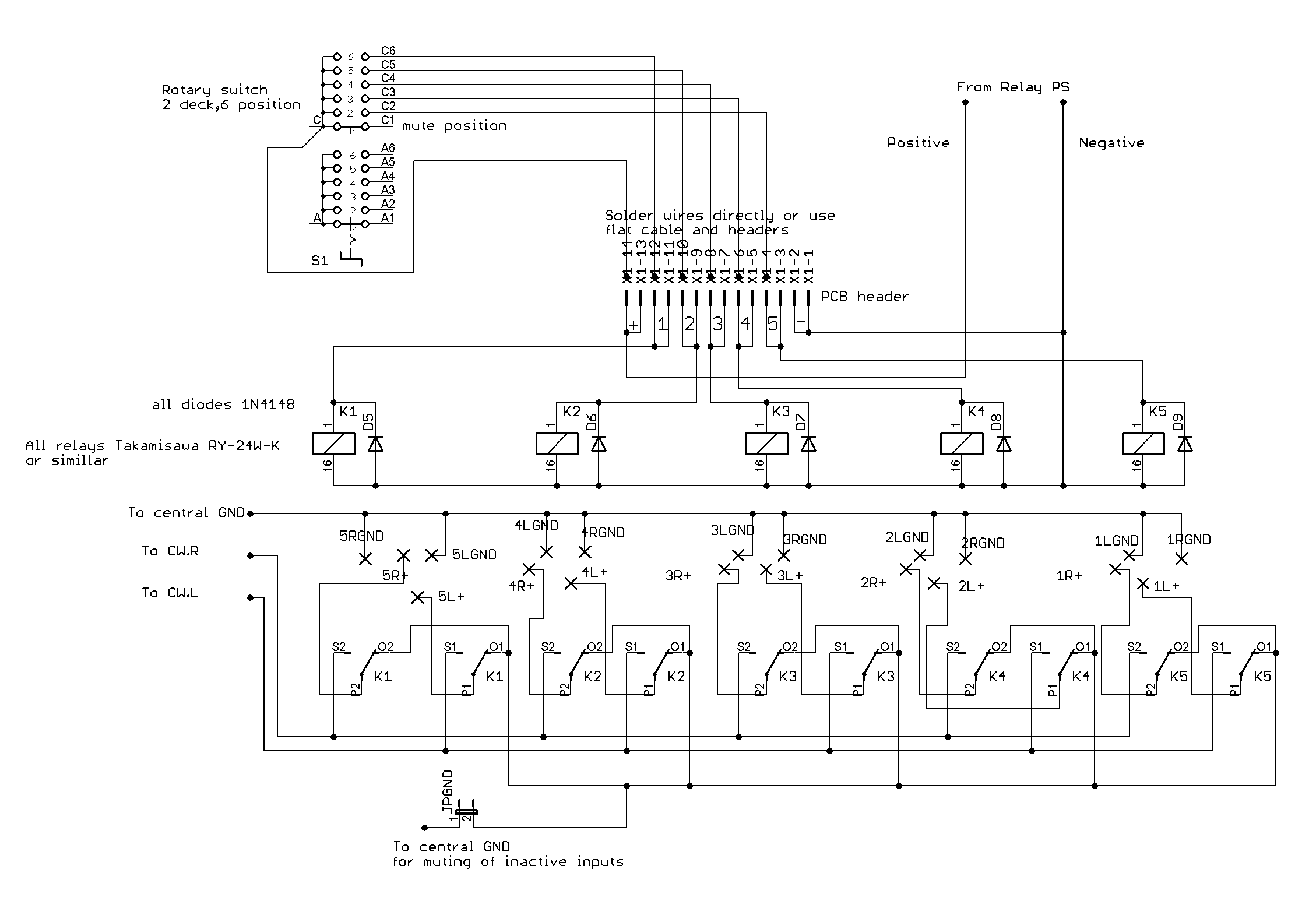

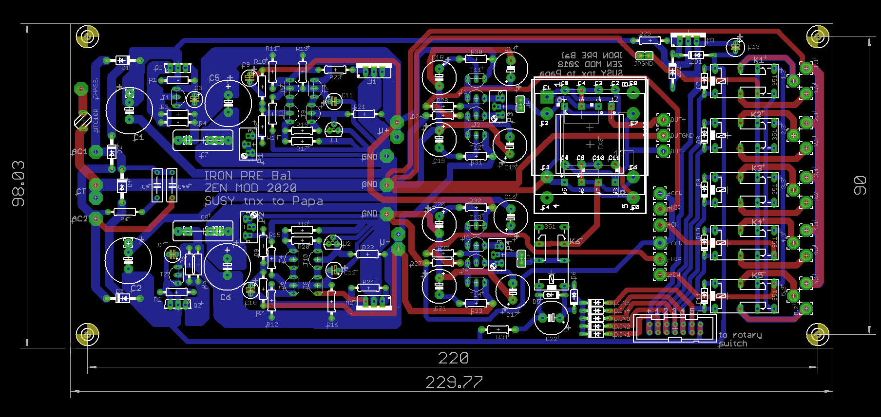

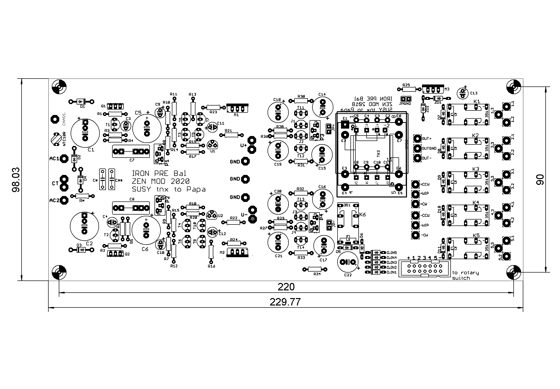

Iron Pre (Bal) files
note: one pcb per channel
