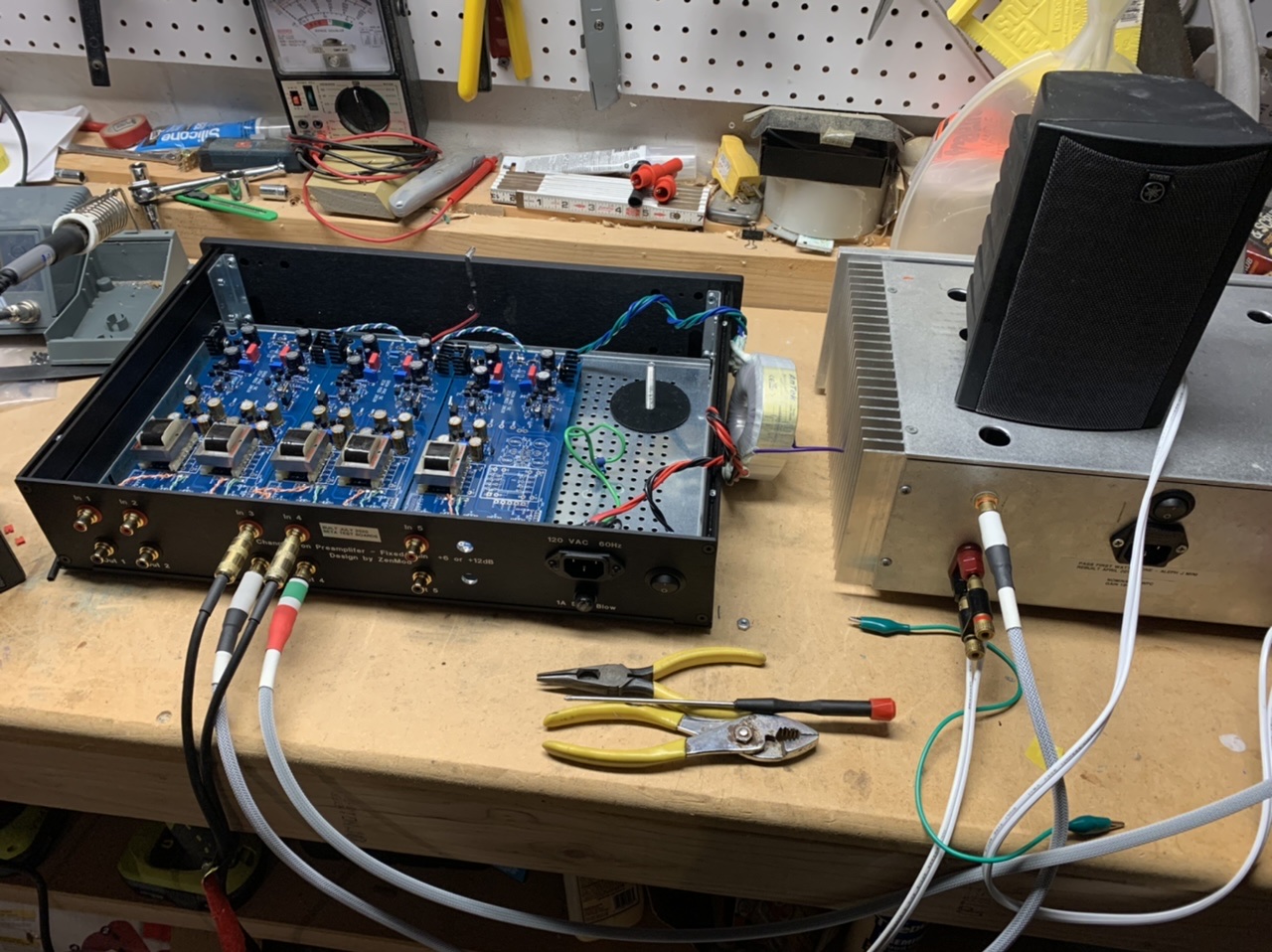

With first trace cut, first test positive. Streaming a video, sound did not bleed through when I turned it to laptop/DAC input, silent.
Now to try it the other way, with TV playing, stream music from laptop and see if TV bleeds through. Trying now and no bleed through! Oh no...now I'm 150 hr trace cut.:Pirate:
In short, first cut being the deepest, did the trick.

I retested with a Sharp TV and a lenovo laptop , nothing fancy on either.
I get similar behavior when laptop alone is playing and TV is off. Volume pot has to be > 80% for me to hear. If laptop is off and TV is playing, nothing. I'm using a 100k alps audio taper pot. Unconnected inputs are quiet.
So Rusellc, it isn't you.
I dont think this will bother me 🙂
The plus part of this test, analog audio output from TV is great. Laptop is not.
While problem is mild distraction, it is easily remedied in couple of minutes.
One cut and done. I didnt do the cuts around the relays yet as this first one seemed to fix it completely.

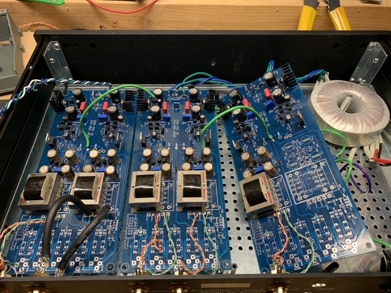

Hum update. Still humming.
I rotated the donut. I removed the donut. I moved wires around (ac, led, board to board ac, grounds). I disconnected grounds briefly. I moved in/out signal wires. I added ground jumper (shouldn’t matter in my build I think). No real difference with any of the above. Other ideas?

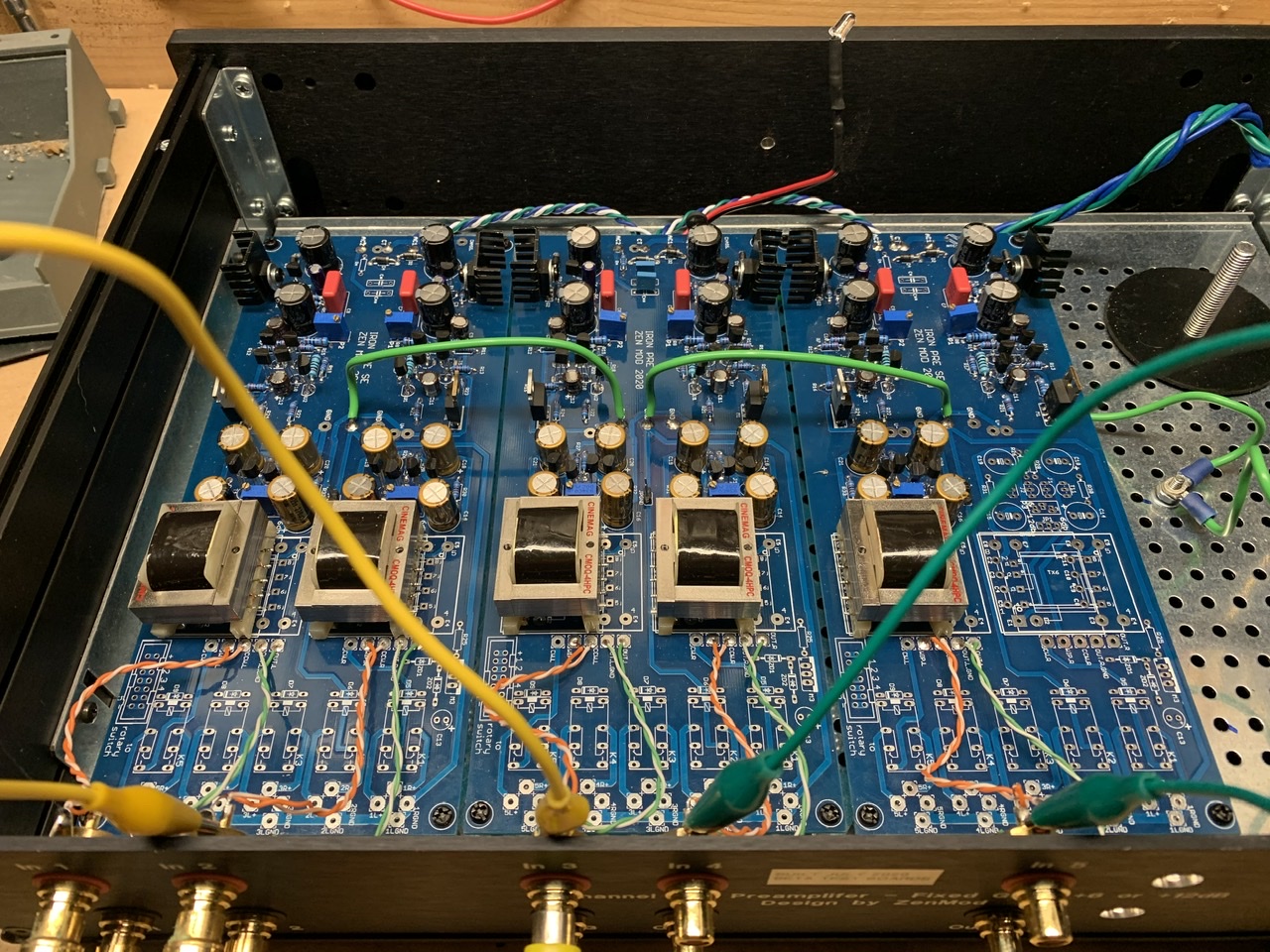

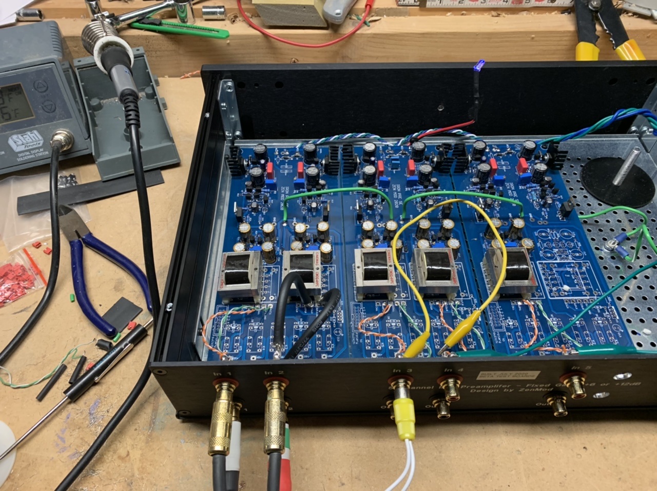

Still humming.
I added bridge wires from center of pcb ground points. I also played with clip leads at the rca grounds. No difference. I used a shorting rca on an input, that one went dead silent.
Would it make sense to change out twisted pair to shielded cable to RCAs? Or possibly going to 3 mini donuts?

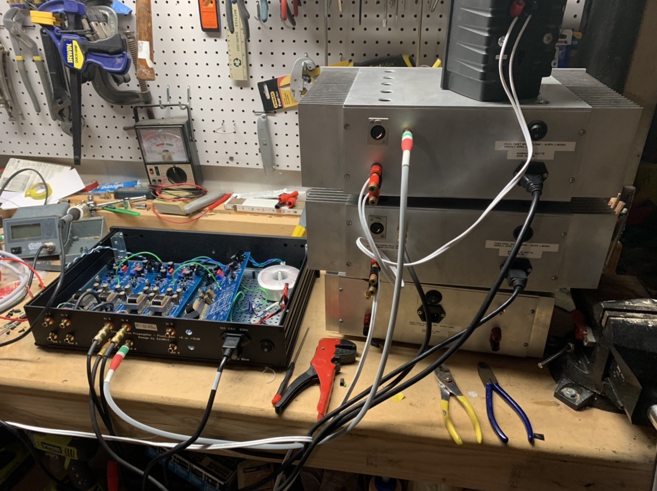

Still humming.
I went down to a single board.
I swapped interconnects.
How about Aleph j mono blocks instead of AJ mini stereo?
Removed LED.
What to try next?

Do you have a non-AJ amp to try? Random I know...and I'm no grounding expert. AJ and Iron is super nice though—My AJ isn't quiet however. And I've tried a lot of things to make it so....Noise went up a hair with Iron Pre for some reason, and Iron Pre alone was quiet. Inputs shorted—headphones on the outputs—stethoscope style (Don't fire it up with headphones on your ears!).
