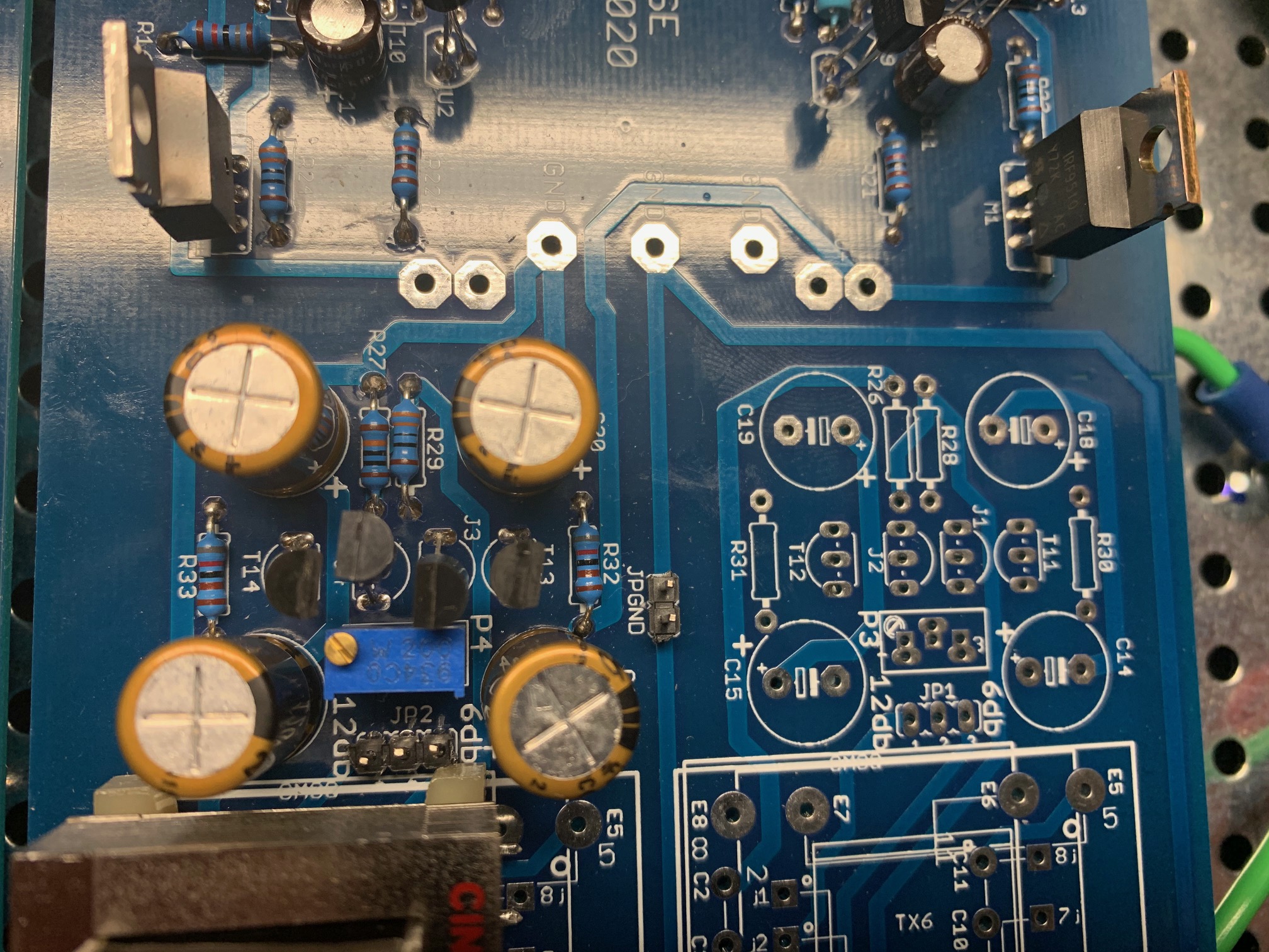

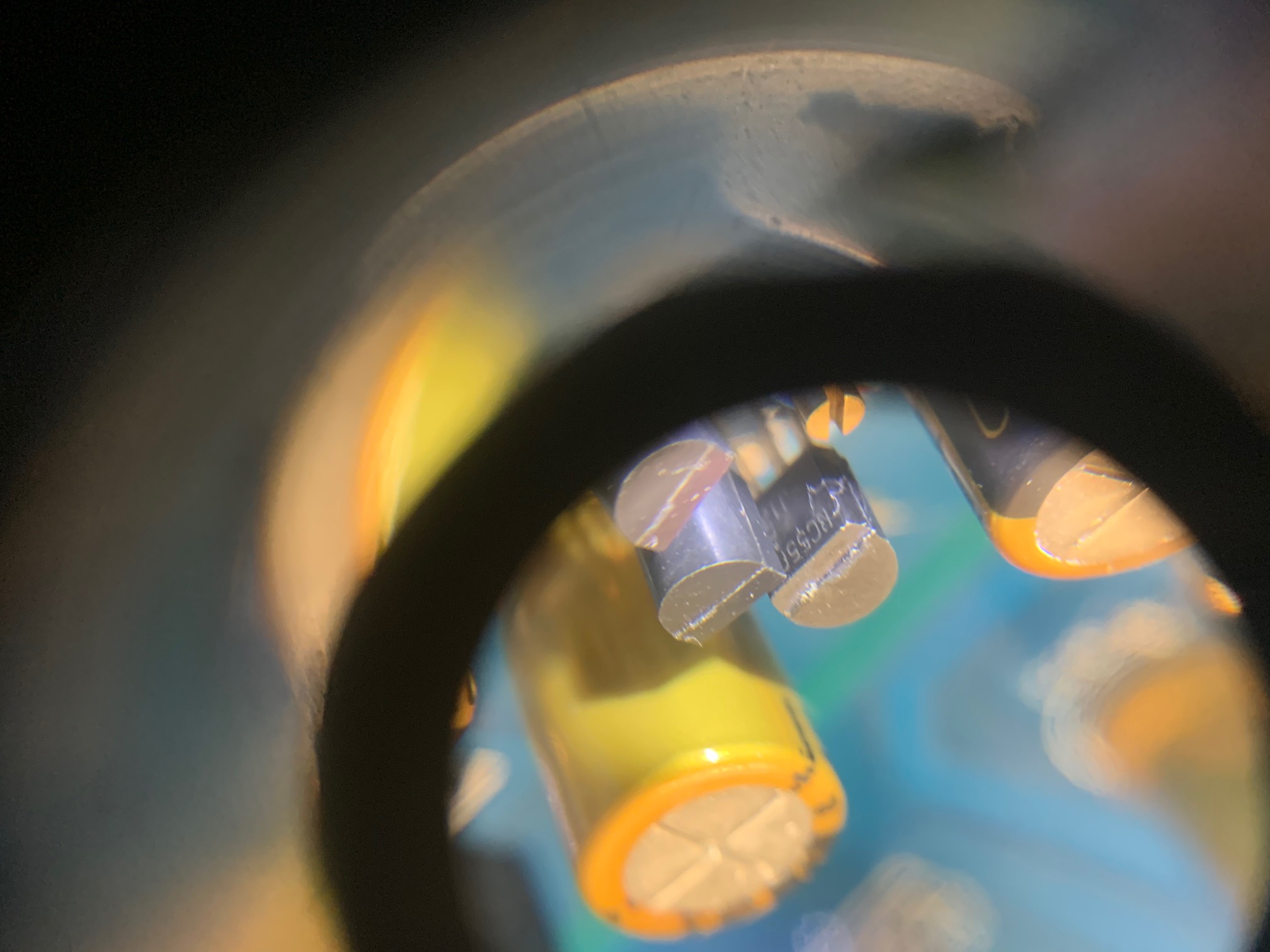

My cinemags arrived today. One of the 5 has a label backwards from the rest. I used the notch by the pins to locate pin 1.

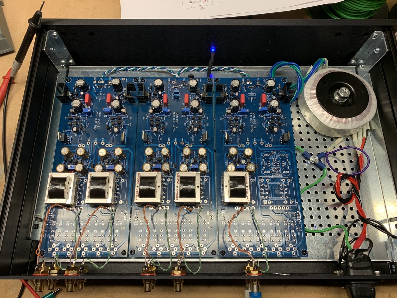

I finished wiring and proceeded to testing. PSU +/-15v was quick and easy. Setting 0mV was also easy. I did an initial set and then noticed a little drift. I let it warm up a little and did a final adjustment once it settled down.
Installing jumpers is a very tight squeeze with the cinemags. I bent the pins a little and they worked.

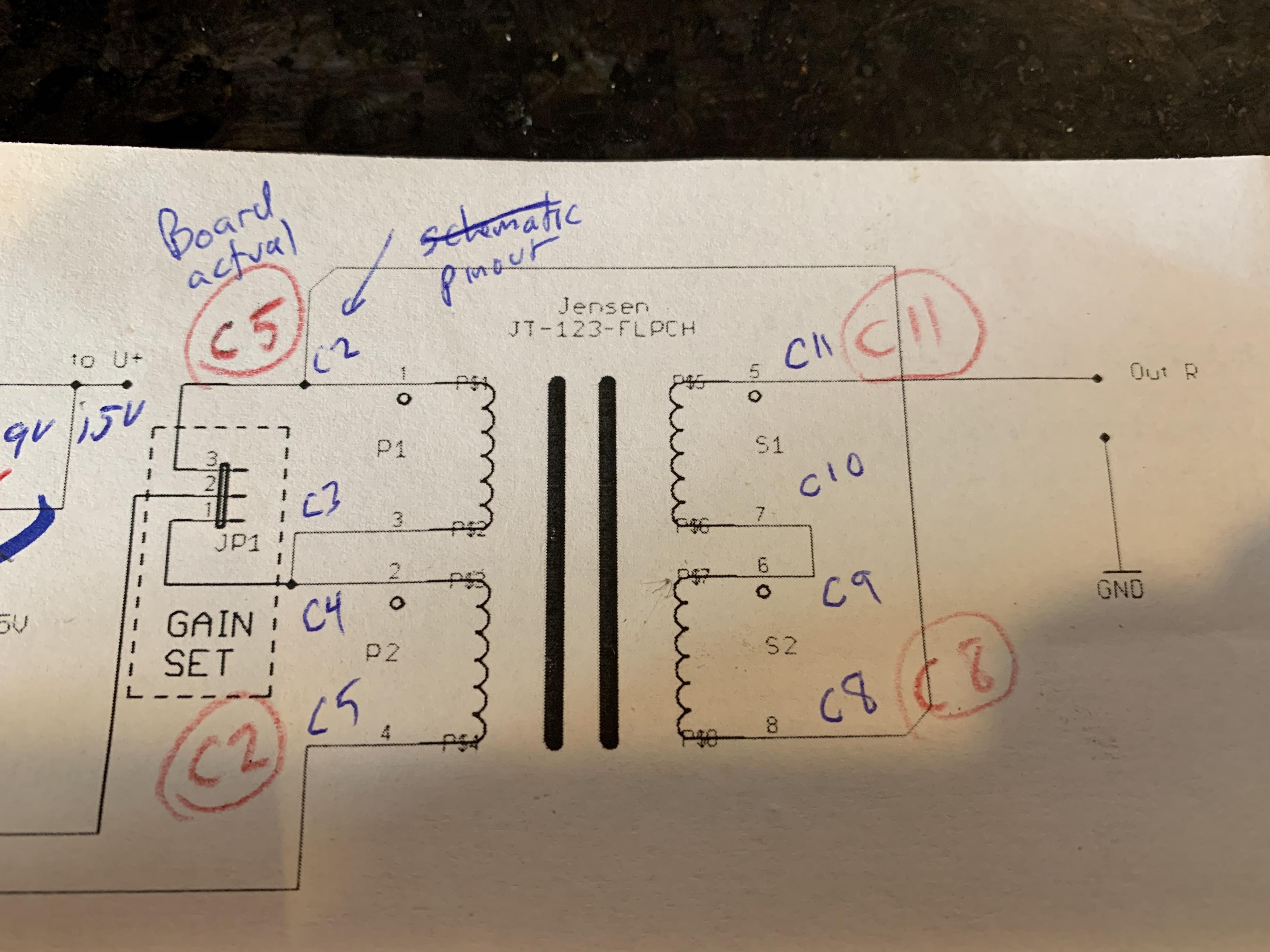

Here’s where I need input from mighty ZenMod. At 6db setting I’m seeing minimal gain on scope. On 12dB setting I’m seeing ~6dB gain. Did I install cinemags in reverse? I snipped the unconnected pins and dropped pin 2 into the C2 hole on the board. Any ideas?

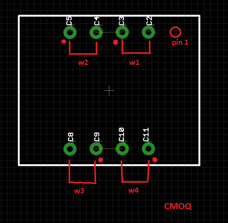

be careful , to not melt them
though, as far my 2 cells are working these days, rotating CMOQ is resulting in same functionality, so there must be something else fishy**
confirm that you have same level of signal pre and post buffer
**see enclosed
w means winding, red dot means phase
anyway, while I'm preparing this post, I see you wrote in a meantime
confirm that signal pre-post buffer

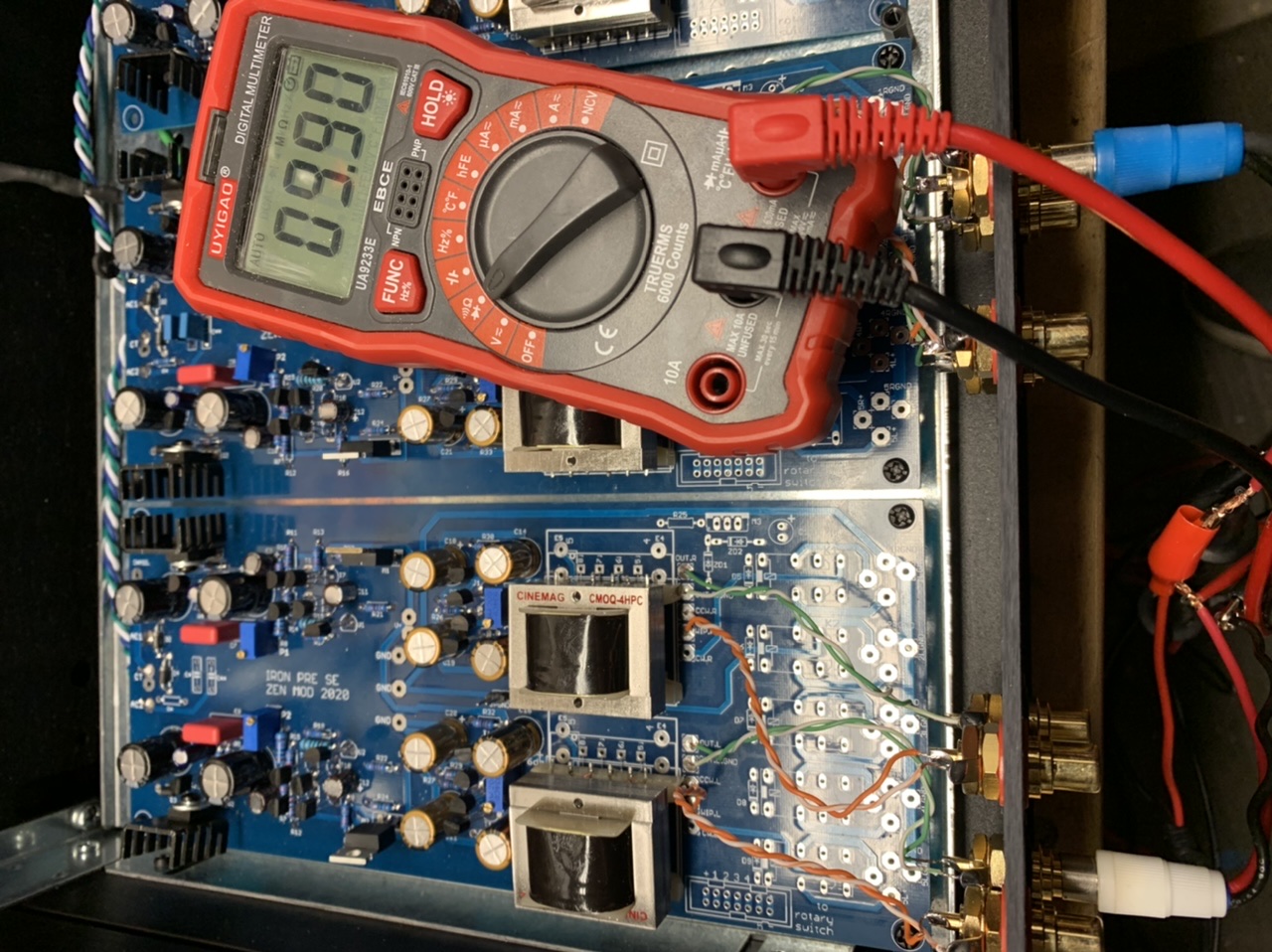

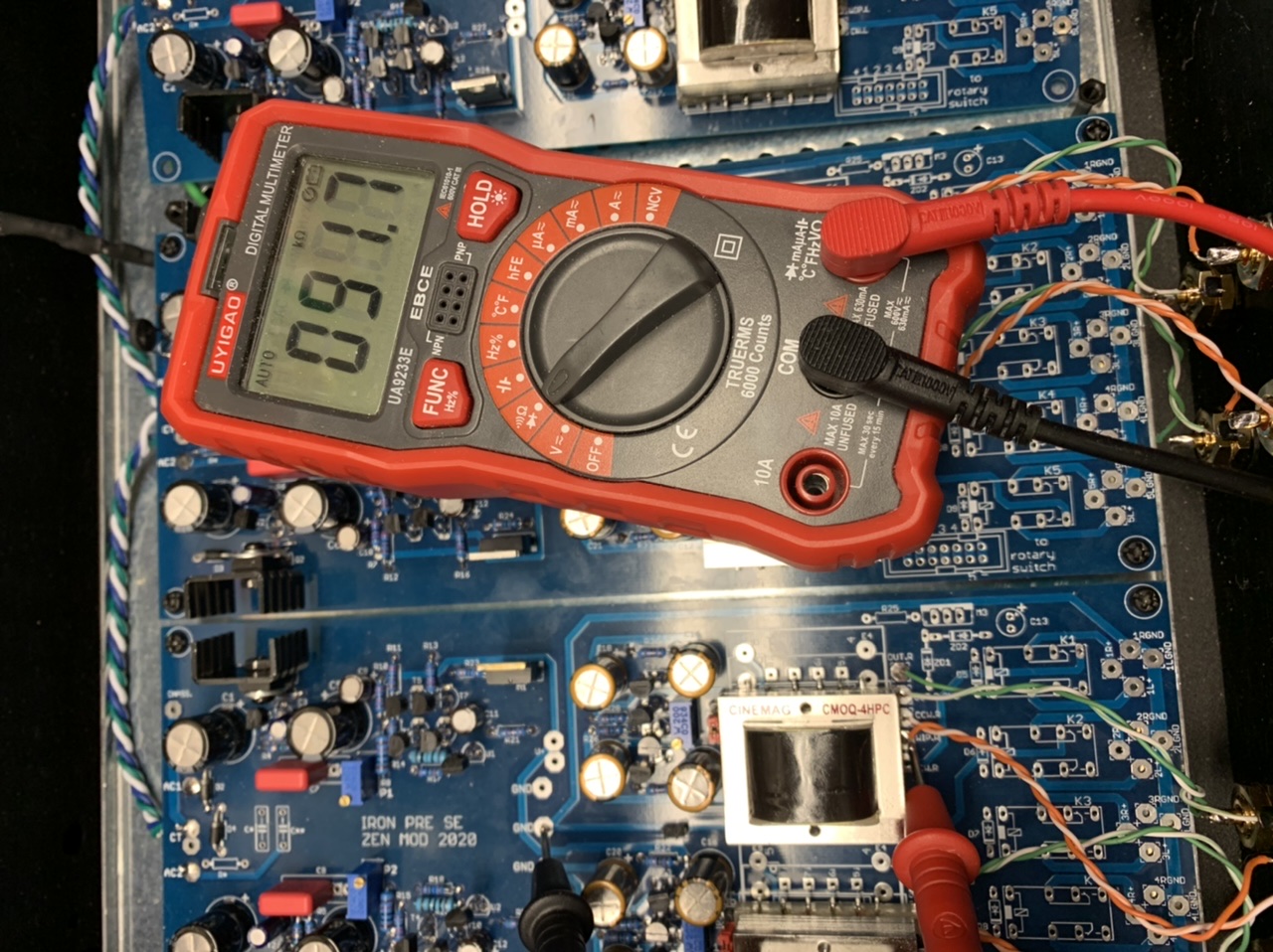

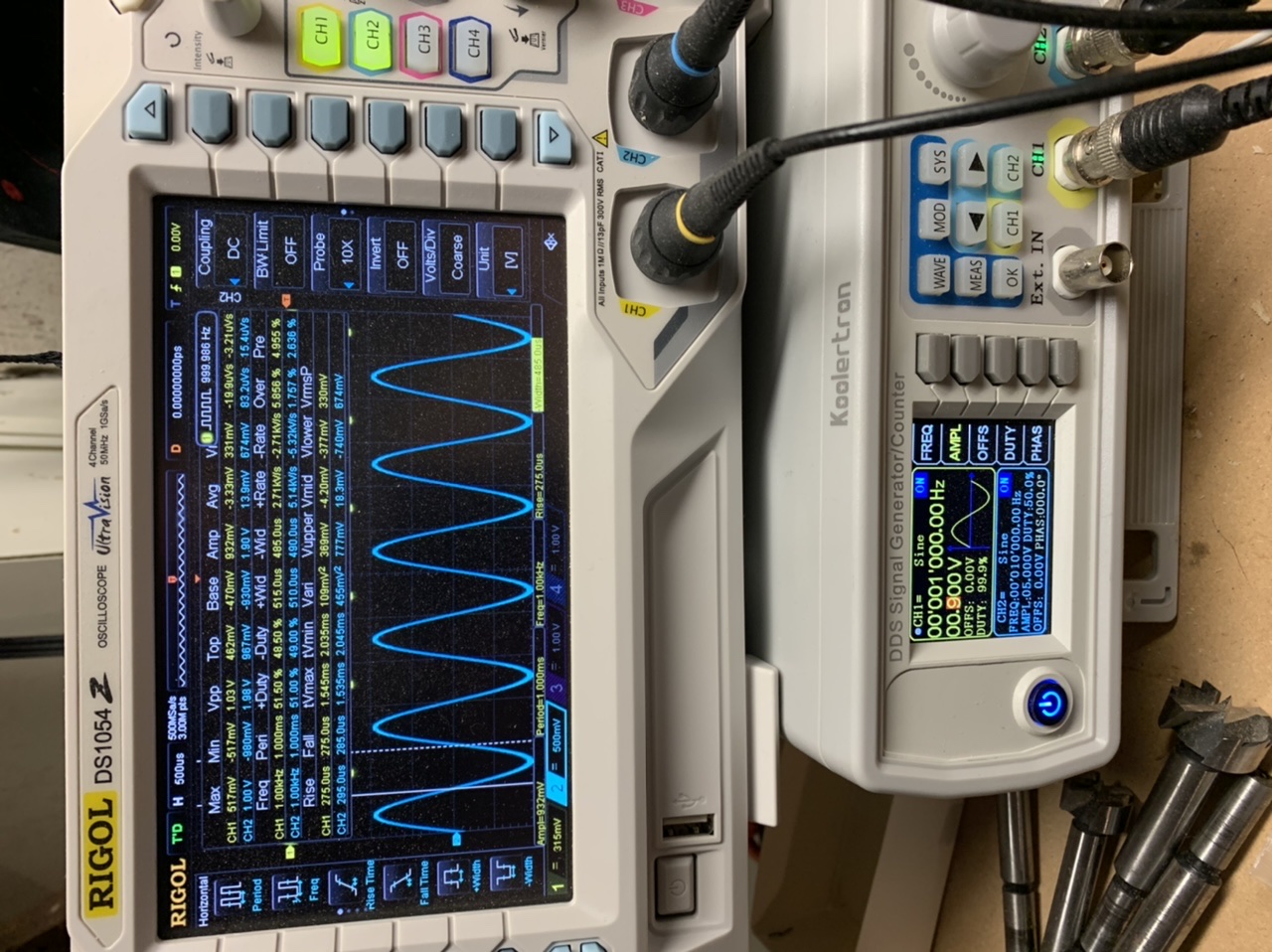

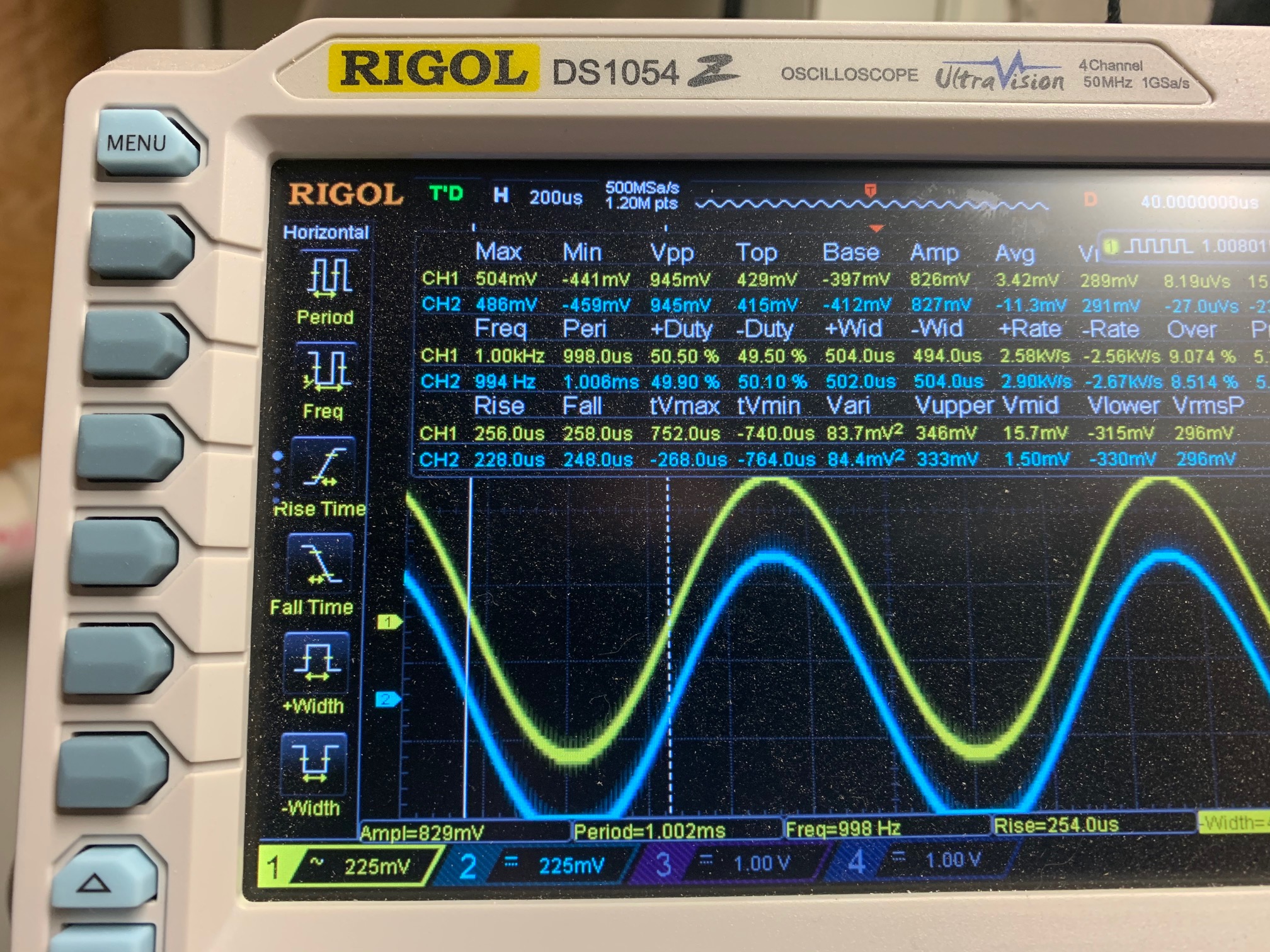

ZM - Pix attached. I tried to measure and take many notes to see if something is obvious.
Before and after buffer voltage is same - so unity gain. See scope pic. Values dance a little on the scope, .918V, .923V, .945V, etc.
I'm getting good +/- 15V from PSU.
All boards perform the same, so I assume when I find the gremlin once, I'll be fixing it 4 more times. I started with the 1 channel board so it's easier to investigate.
I'm assuming PSU is good based on good +/-15V readings. So I'm focusing from signal input to output.
I compared resistors to schematic, measured spares of the same value and put them next to the ones on the boards to visually confirm they're right.
R26 = 100k
R28 = 330R
R30/31 = 8k2All good.

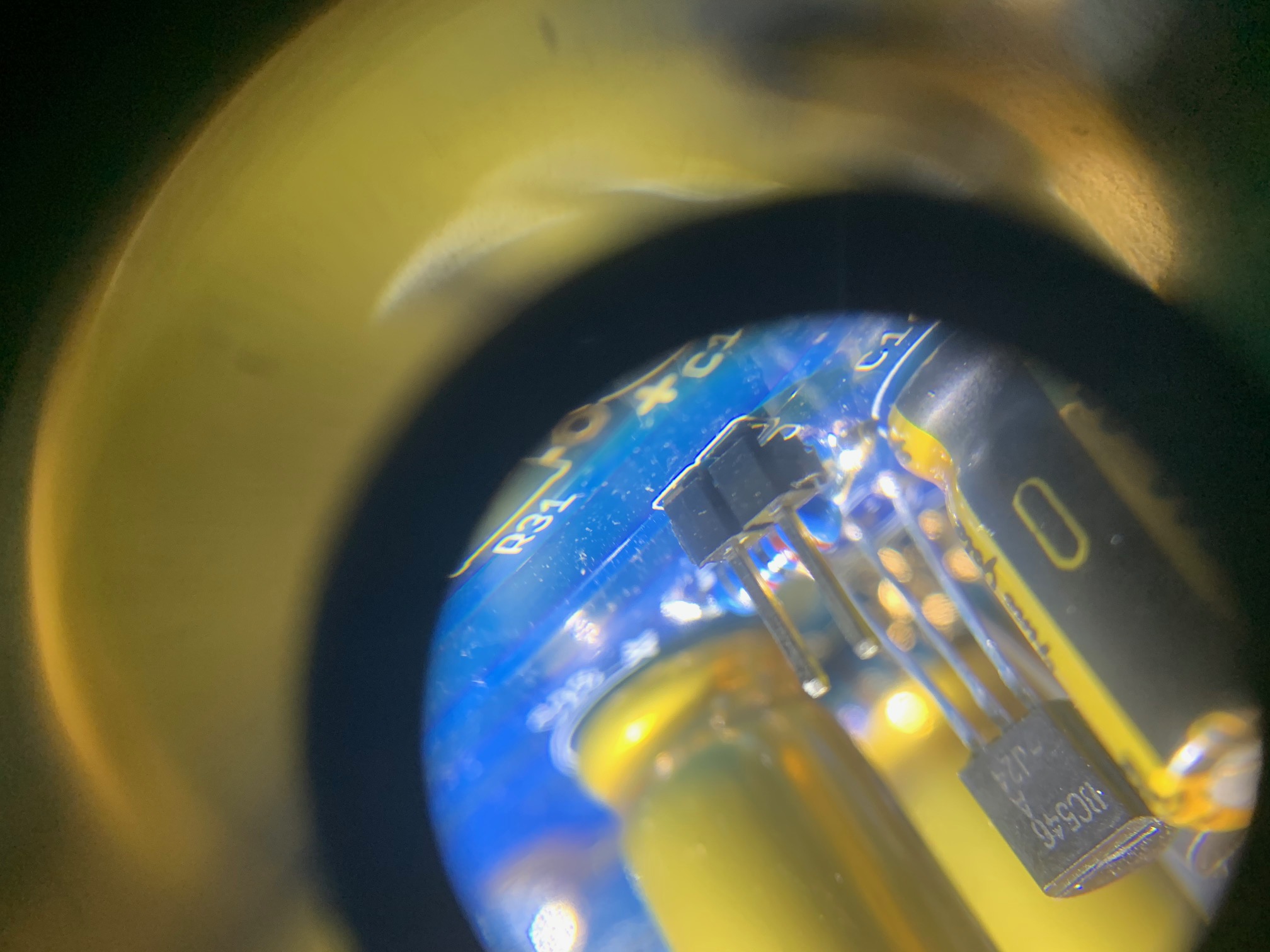

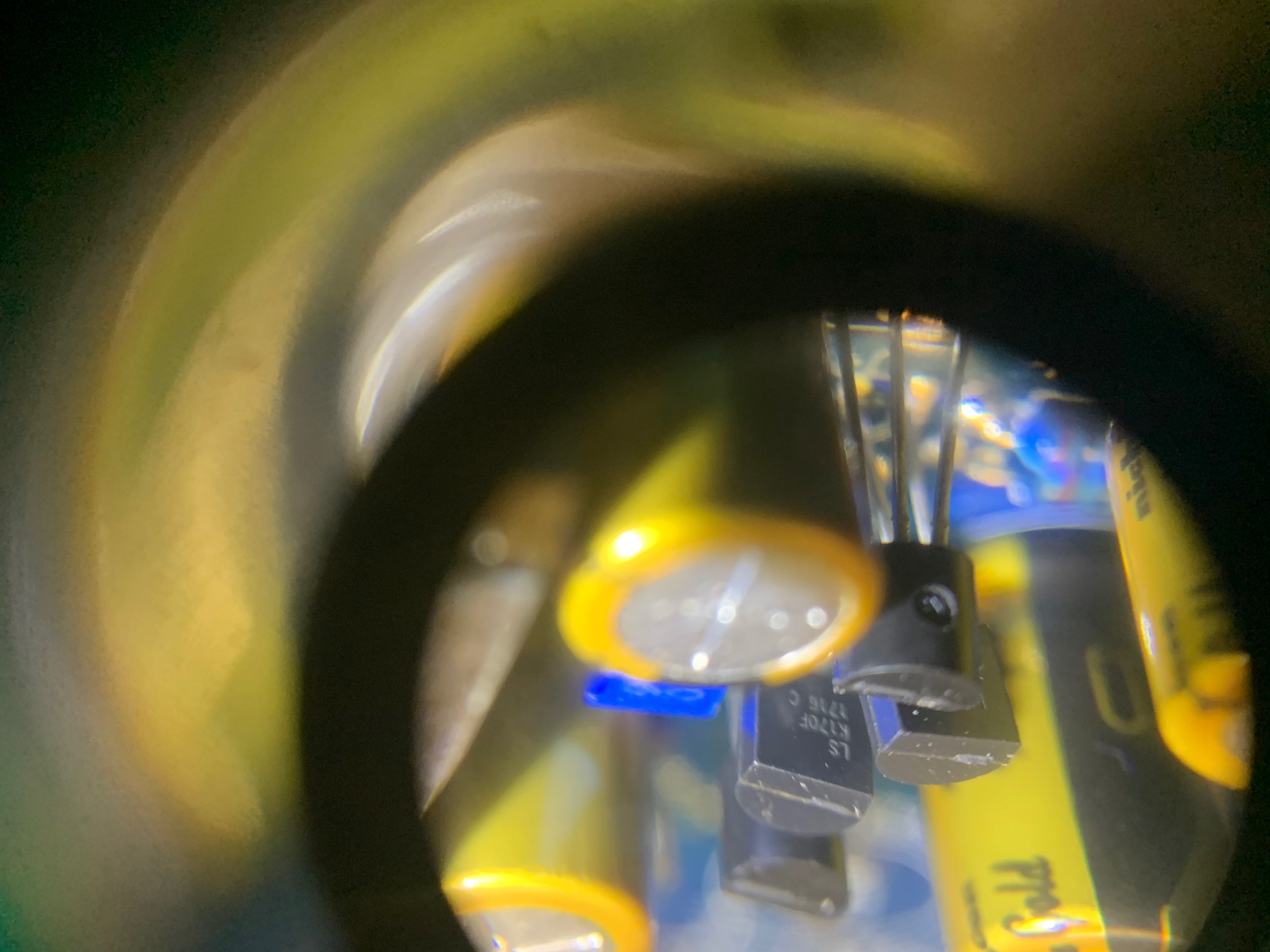

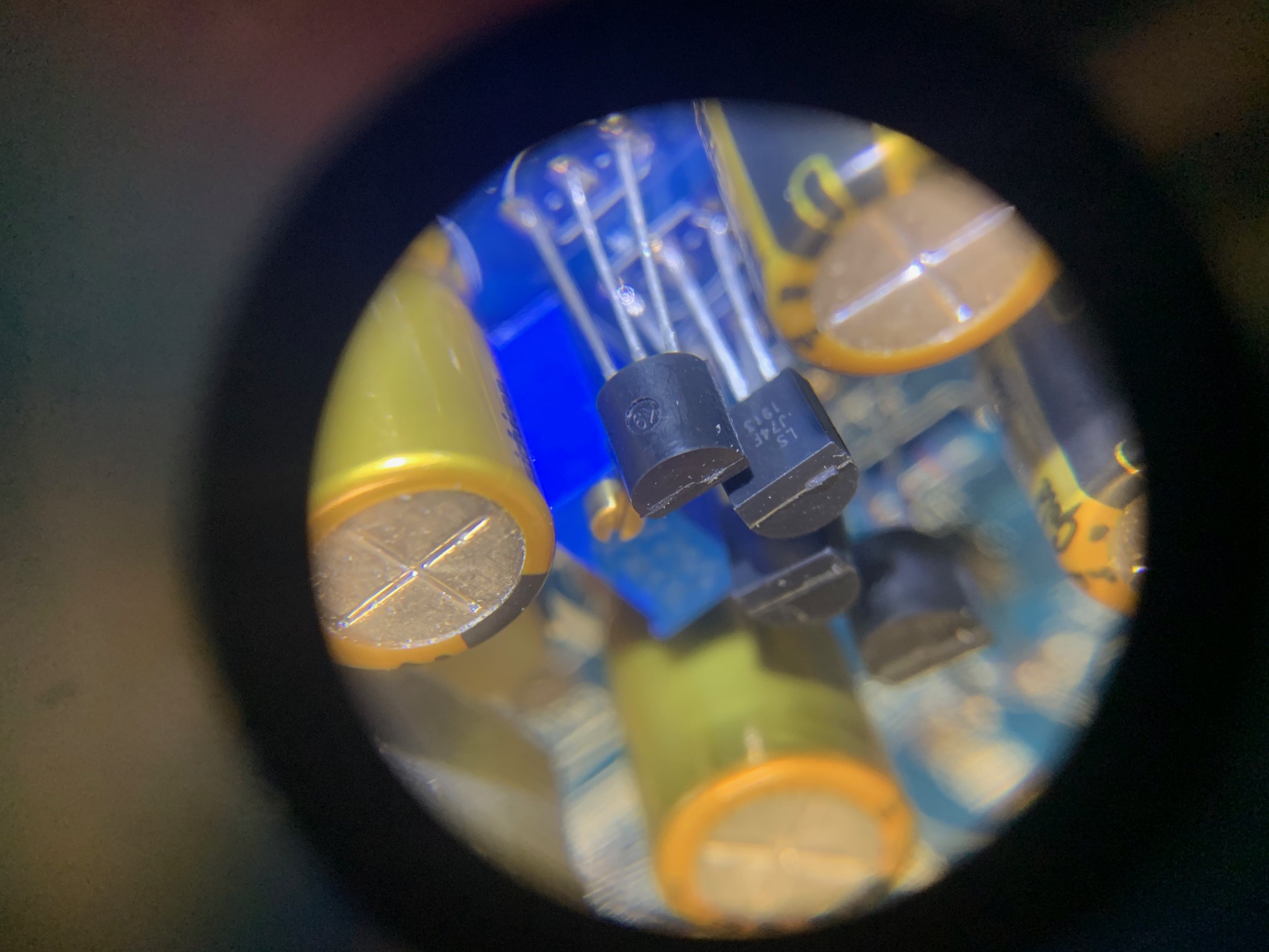

I checked to make sure transistors were in correct locations and orientations. See pix using loupe over iphone camera. All of that looks good.
Measurements:
BC546 & BC556 Base Voltage = +/- 14.69V
JP2 Pin 2 = -0.4mV (got a little drift..., need to tweak again)
JP2 Without jumper, power off:
Pin 1 to gnd 27.3 Ohms
Pin 2 to gnd 17.87k Ohm
Pin 3 to gnd 54.6 Ohm
WIP.R (input +) to gnd 55 Ohm
CCW.R (input -) to gnd 0 Ohm
Since I'm going fixed gain and no selection, I'm using the following:
Input + = WIP.R
Input - = CCW.R
Output + = OUT.R
Output - = OUT.R.GND
Thoughts? Will other pix or measurements be helpful?

if you have same signal level on input and output of buffers (shorting pins- easiest to get with probe) , than you're good with buffers
now - take ohmmeter , nothing connected to output, off state
do you have approx 100R from output hot to gnd ?
if yes autoformer is in continuity
if not, I ooked one trace - that one connecting pin 5 and pin 8 of CMOQ ; if that's the case, take a look at last picture for clue where and how and solder thin wire between pins 5 and 8
