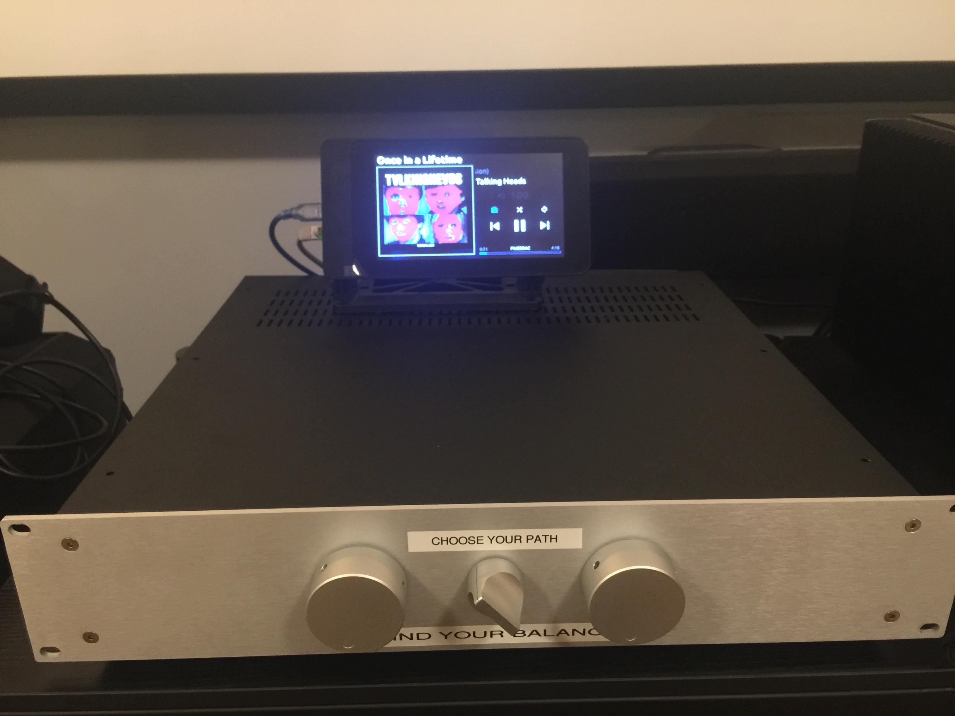

Well - It's in the system 😀

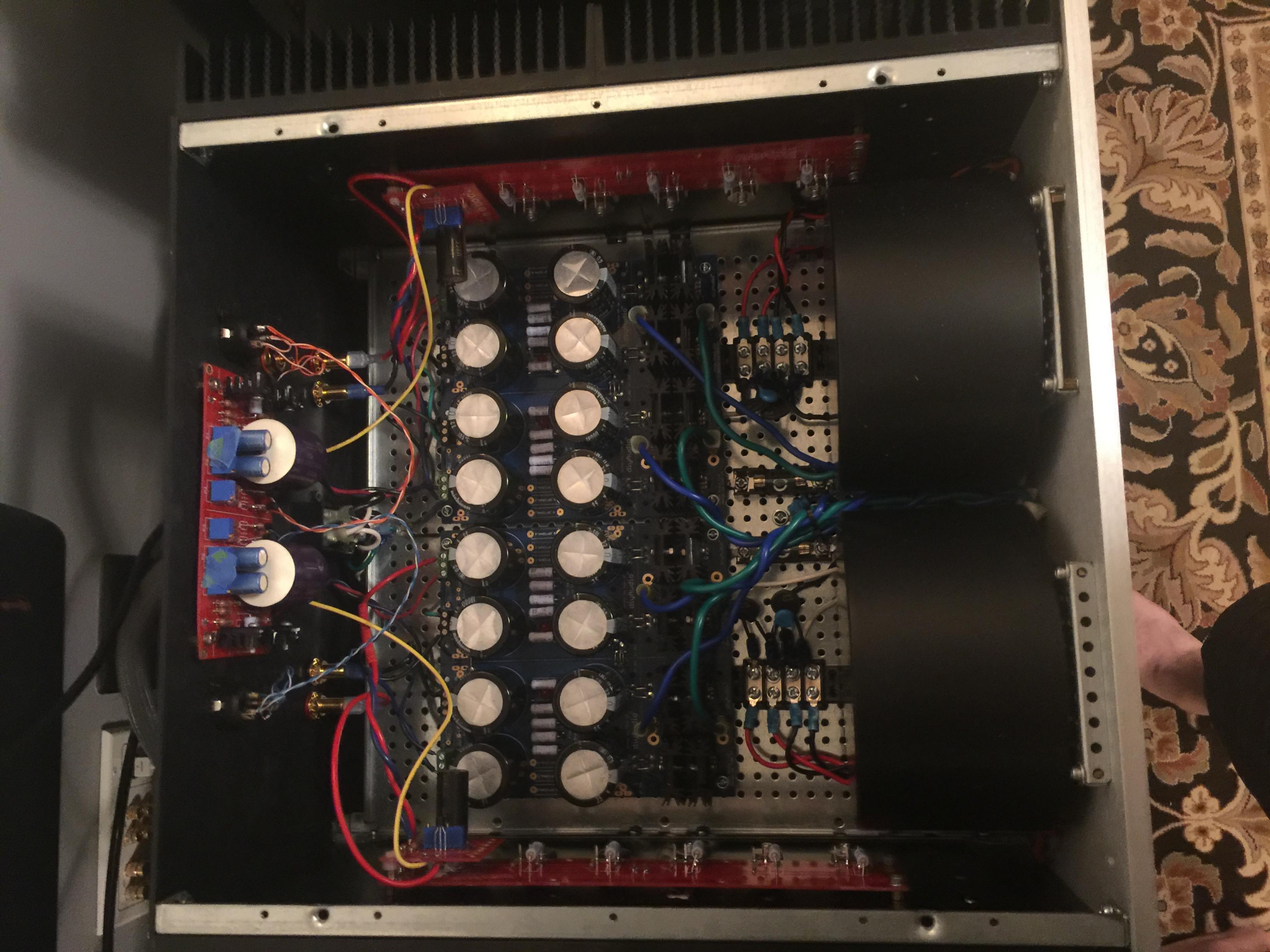

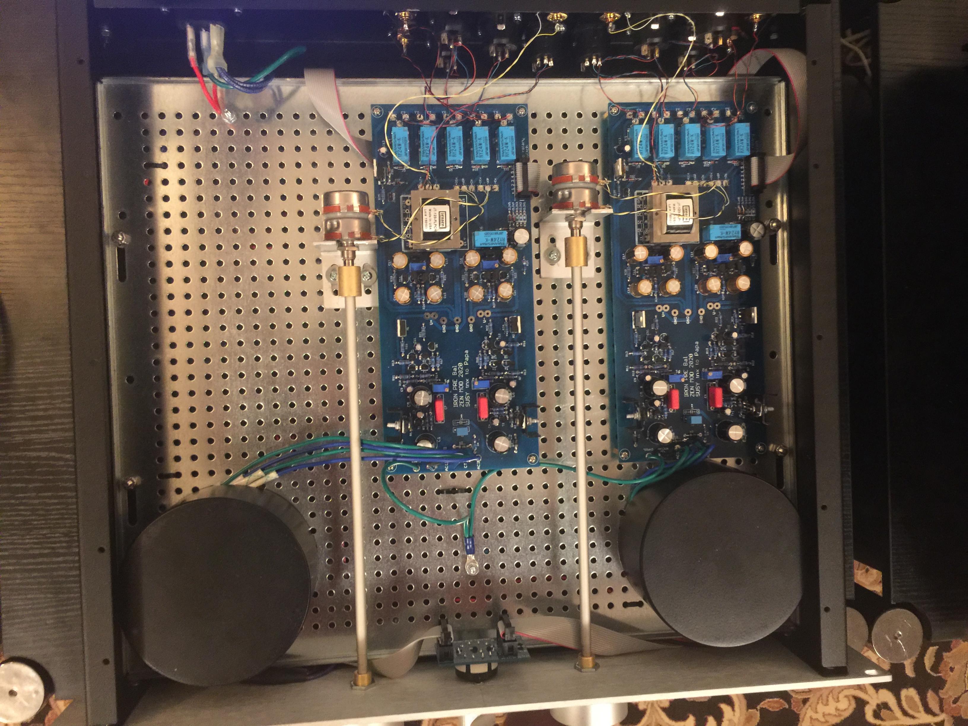

I was a huge scaredy cat. So, I checked... rechecked... checked again... Then I checked all inputs and that the "Bal to SE" was working.
I had to repair and put some strain relief (just little bends) on a few of the 30 AWG itsy bitsy wires, but no worries.
All good!
Then, because I am crazy, I took the bottom off and put some rubber in place so there is no chance that the toroid bolts can touch the bottom. I'm still never 100% re: shorted turn, but I feel like some thick rubber from an old toroid mount and some proper adhesive is a safety check I can do for peace of mind. Then, it took me far too long to get the pots aligned and the way I wanted them for a smooth turn.

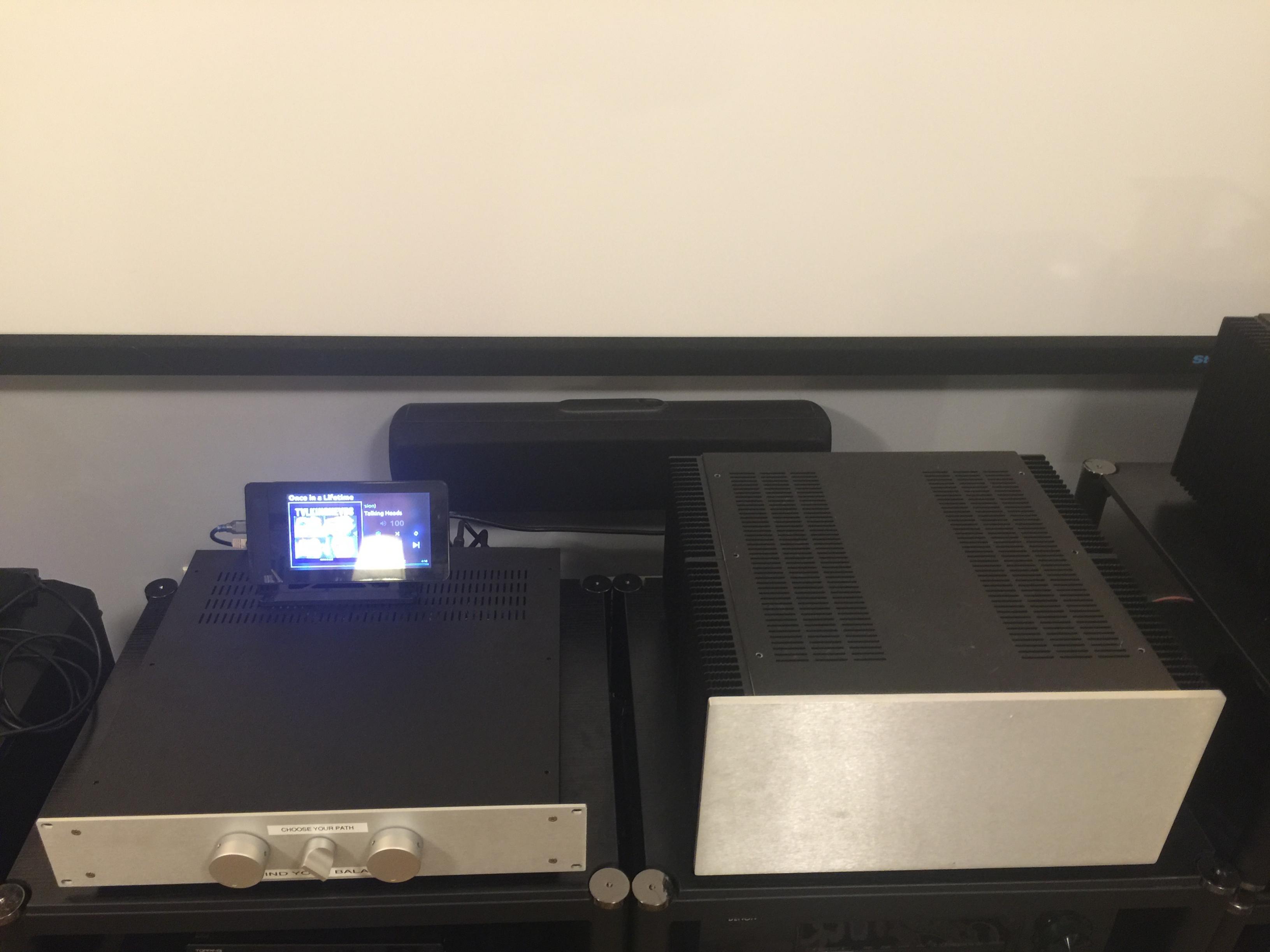

Here are some pics of it in the rack and topless with the BA-3.
ZM, the Babel J2 is literally sitting right next to the BA-3. So, I will definitely get it warmed up and try balanced in. I have it wired properly already for that. 😀
First song was "Once In a Lifetime". I thought that was appropriate.
