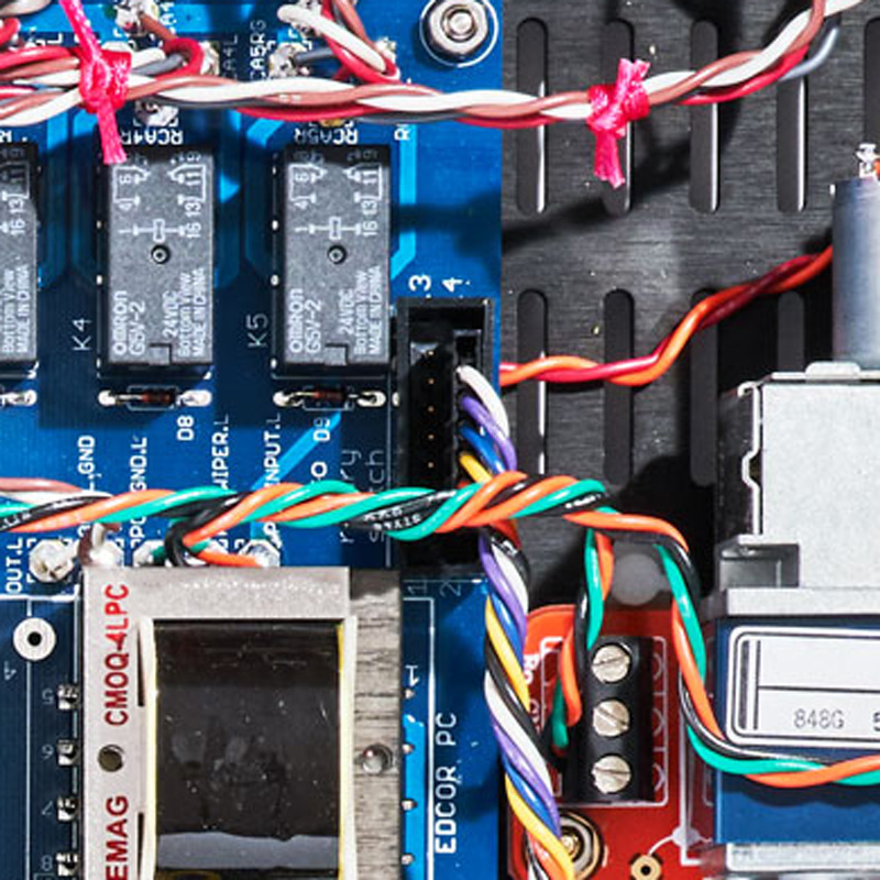

Could somebody give me the Mouser or Digikey part number for the 14 pins Header and its cable please

in any case - buy plasticky and buy cable and make your own , by length you need

cable is 14 conductors (or 16 or 25 - strip redundant ) , pitch 2.54mm
note: even if you buy standard cable with ends, and if Mighty ZM didn't follow standard orientation , cure is simple - shaving a tooth on one connector, so you can rotate it for 180

The 14 pin male and female that ZM linked should work. I got mine off of Amazon along with the tool. The tool may not be strictly necessary, but it was nice to have.
There are also a number of places (hopefully one near you) that sell cables pre-made.

More options—you can also make your own cables with the following parts and whatever color weeney wire you want:
https://www.mouser.com/ProductDetail/Molex/16-02-0104?qs=UAyrm/nZ%2BChKxEH6%2BQ7nkw==
https://www.mouser.com/ProductDetai...ha2pyFadugQXtaFqb17%2BkikTlBMNC7nYPhffcHQTn8=
Kinda my preference personally—you can also get a 2 row version of the header.

I really like that option also. Just don't be like me and short the pos and negative rail together when testing the relays using the individual wires. This (I think) only applies to the BAL version, but it's still a cautionary tale just in case. That was a costly error in terms of time and frustration.
