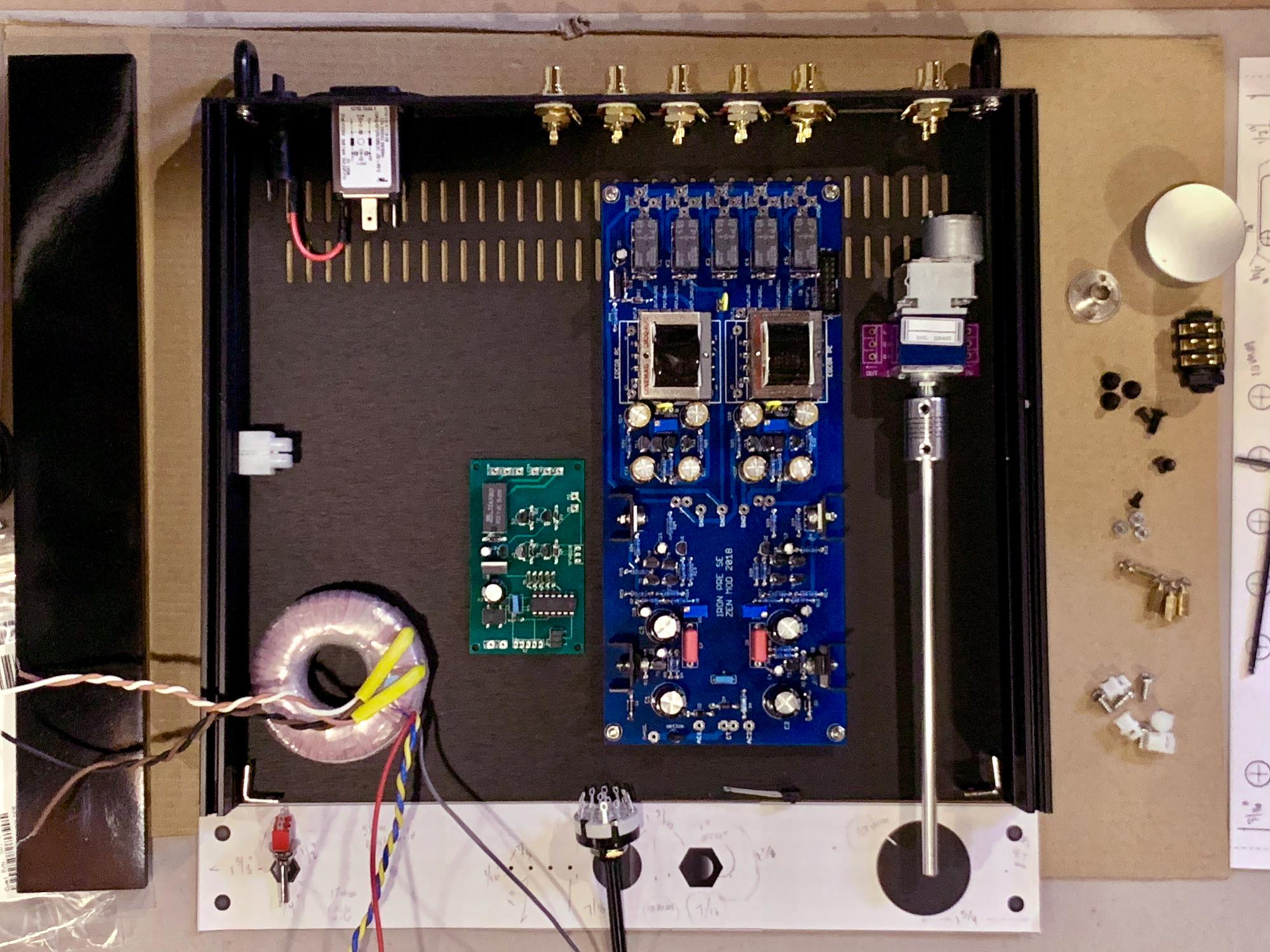

ZM—noob question—do I need to run power to the switch from Iron board center (kinda how I wired up Waynes BA18 with same switch)? Or do positions 1,2 and 13,14 have me covered from the header pins? I think the answer, based on schematic, is the header pins give the juice? 2018 SE board.

Better?
much!
btw, looking at IDC connector , connector to you , rest of pcb back - there must be "1" on left side
so , counting from left , you have pins 1+2, 3+4,5+6,7+8,9+10,11+12,13+14
pins 1+2 & 13+14 are positive leg of supply , going to common pin on front switch
then you have return wires as :
3+4 are for input 1
5+6 are for input 2
7+8 are for input 3
9+10 are for input 4
11+12 are for input 5
say that you're using 6 position switch ,leave pin 1 free (for mute position) , then pin 2 goes for input 1 wire(s) etc.
if you want lighthouse on front , you can steal positive ones from switch , route negative common from , say , relay 5 (nearest to IDC), but include series resistor there ; for 12V relays/voltage say that 12-15K is OK; for 24V relays/voltage use 25-27K ; quarter watt is Jumbo good
Thanks ZM!

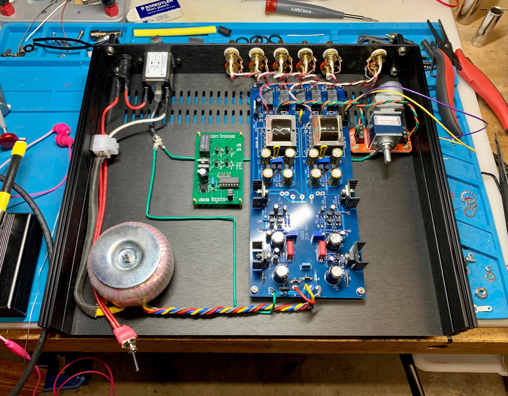

I wanted to jam this into 1U and Antek didn't have anything between 25 and 50VA and the 50VA—which I have—is too tall for a 1U. I sourced one from the Netherlands that's 30VA 18X2 and is comfy in a 1U—it's not shielded though... But I'll risk it.
2x 18V toroidal transformer 30VA

Im probably going with 2U, so either should fit fine. Might just install board into a 3U I have, but my Wayne's 2018 line stage is in there....rather keep it running.

This played the sweet sweet sounds of Iron Pre tonight in test mode! No real dramas.
Took a minute to figure out perma-switching to input 1. Didn't have to touch the DC offset—born at zero! Also born at around 15.5VDC+/-....twiddled those to spec.
.... No real dramas.
