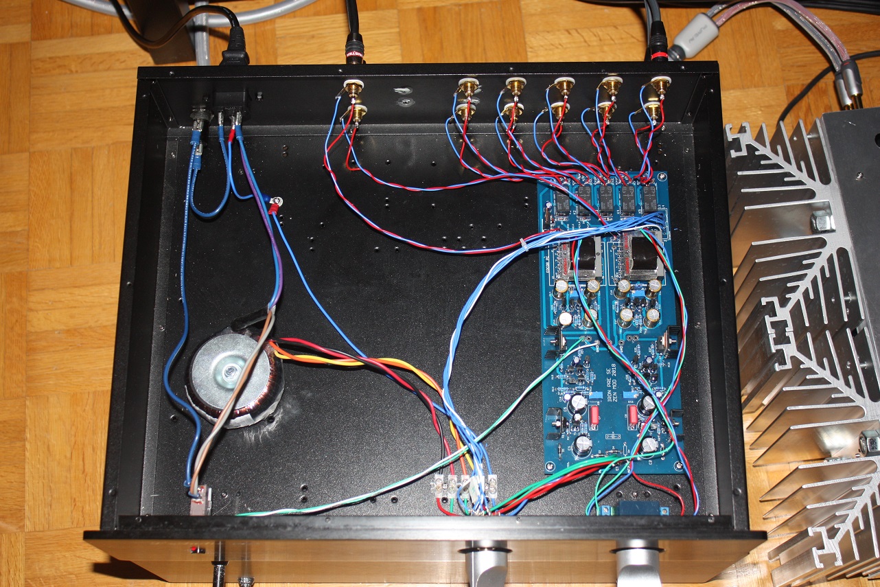

It took me long enough but I finally got mine working. This was bult
using the '2018' pcb. The transformers are the low nickel Cinemags.
Currently it is configured for 12dB gain, running into a DIY F4.
A big thanks to the Mighty Zen Mod and 6L6, who made this possible.

Hi Jim,
At 12dB gain I can get pretty loud volume with my sources. With the DAC's
max 2V RMS output I can get a max of about 8W into 8 ohms. I have been
listening the volume most of the way up but not wide open, so while I
cannot get full output from the F4, it seems to be loud enough for me.
As for the sound, it's still early days, but so far I am very happy with it.
Dennis
