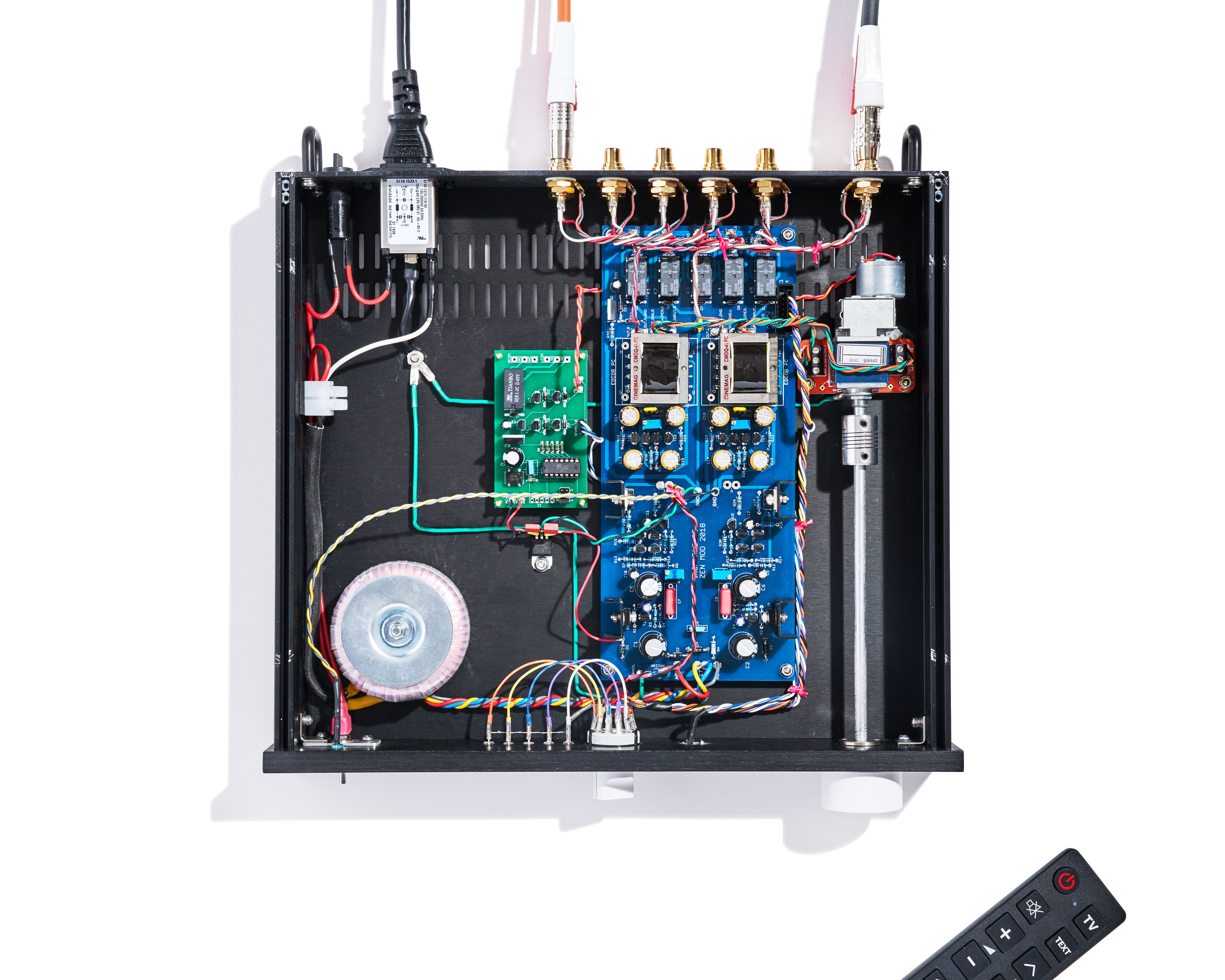

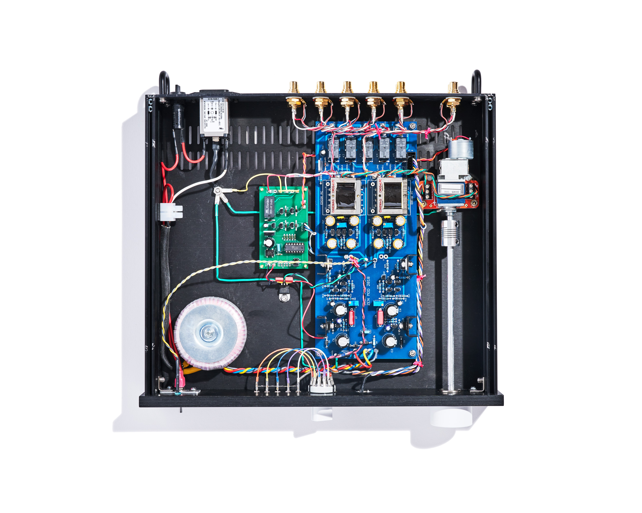

btw, looking at IDC connector , connector to you , rest of pcb back - there must be "1" on left side
so , counting from left , you have pins 1+2, 3+4,5+6,7+8,9+10,11+12,13+14
pins 1+2 & 13+14 are positive leg of supply , going to common pin on front switch
then you have return wires as :
3+4 are for input 1
5+6 are for input 2
7+8 are for input 3
9+10 are for input 4
11+12 are for input 5
say that you're using 6 position switch ,leave pin 1 free (for mute position) , then pin 2 goes for input 1 wire(s) etc.
if you want lighthouse on front , you can steal positive ones from switch , route negative common from , say , relay 5 (nearest to IDC), but include series resistor there ; for 12V relays/voltage say that 12-15K is OK; for 24V relays/voltage use 25-27K ; quarter watt is Jumbo good

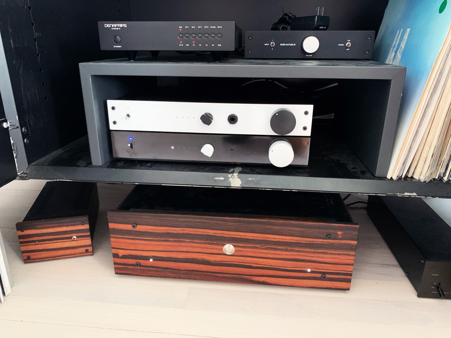

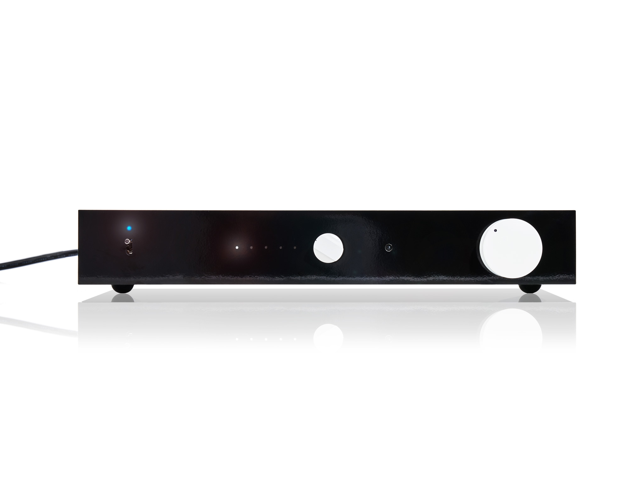

Tomorrow IRON gets plugged into AJ! Super happy with how it came out—remote control and all—little voltage regulator there to drop to 9V—thanks of course to 6L6 for part suggestions. Datasheet for regulator had a simple circuit. Only DRAMA was jacking the voltage in half when plugged in to the power outs of IRON on the V+ side—that wasn't happening (and there was a noob frying of circuit scare—6L6 had to stop ALL of his cookie baking routines to sort me out Haha.).... and the remote board has a muting relay—not sure if I'm gonna see if I can use that or not—not sure it's possible since ZM has thought of everything.....
Pics of the front later if anyone's interested—gloss black and white knobs.

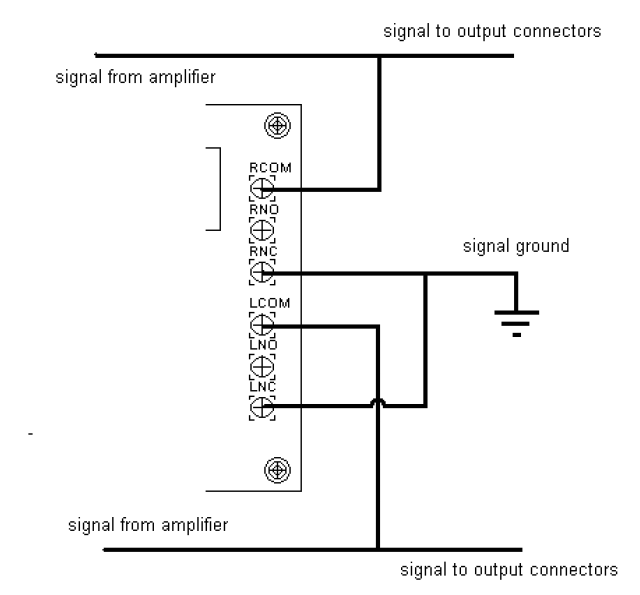

it'll work , but I don't like it, due to fact that there is no series resistor from JFet buffer, and why harassing them with dead short to GND?
instead of that hard mute, try sort of softer mute - include series resistors between signal routes and your mute circuit - put there 100R in each line (RCOM and LCOM)

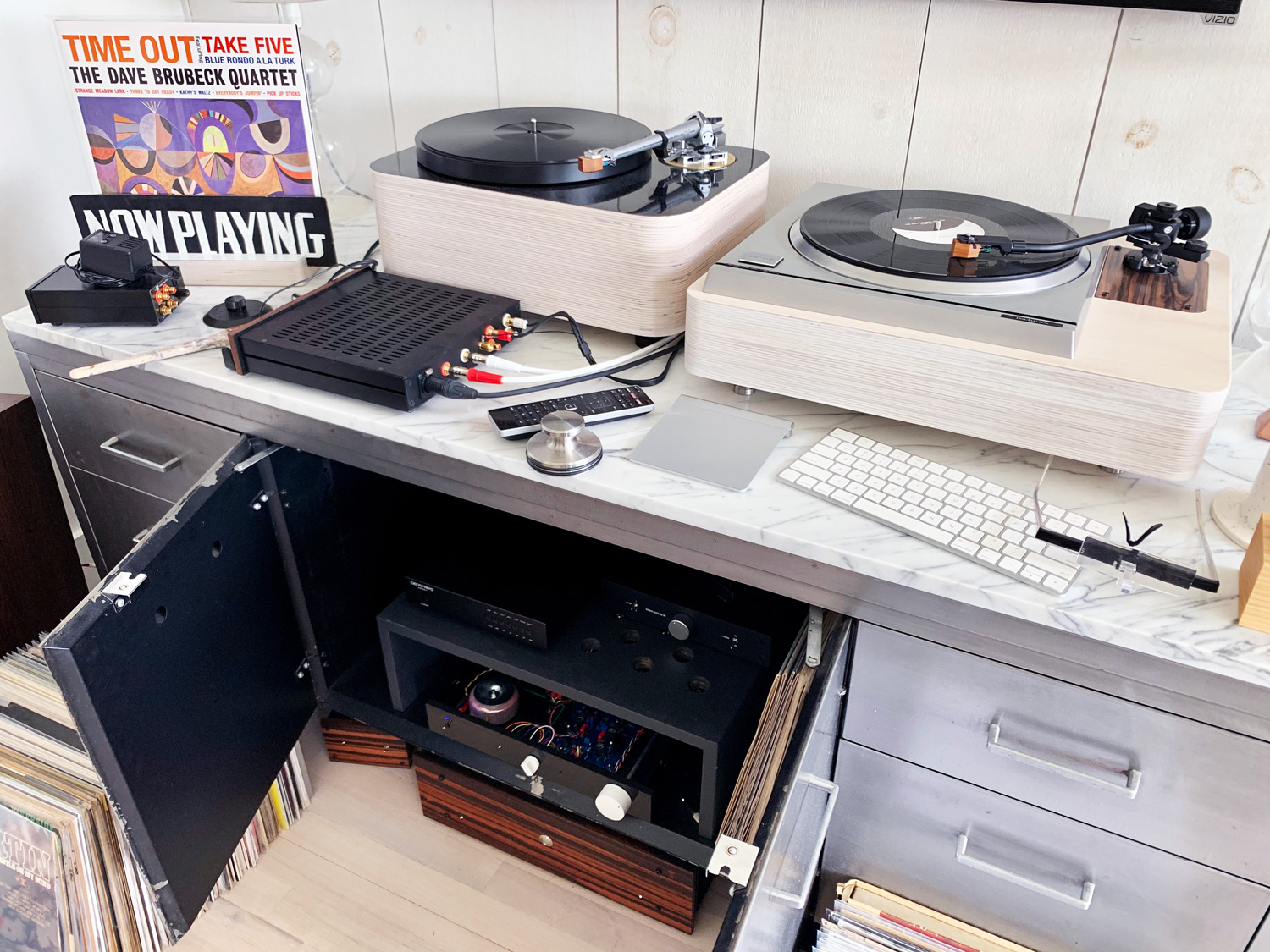

ZM— Couldn't be more happy. Gave this a good listen today with family too who say "they don't have opinions"—right—they DO!) ... —A/B vinyl on two decks (HOLY SH&$ SP-10MKII). Some random family movies—Hi-res digital via Tidal and an R2R DAC—Opera (Mozart at the Met free on the interwebs due to Covid).
Learned a TON. It's warm and lovely—but not overly so—FULL—RICH—DETAILED—LAYERED—PUNCH—audio descriptions are so subjective. This is with AJ—already on the meaty side—I like meaty. Will try with F5 and report back. A/B with Wayne's—which I also love but has a different character. SO FUN. EVERYONE NEEDS TO BUILD BOTH.
This is a total WINNER—Hats off bowing. Soft mute is pretty trick. I didn't know what to expect. Pretty cool really. Works great—love having a remote. Tried 12 DB jumpers... think I prefer the 6 setting. AMP is quiet.
