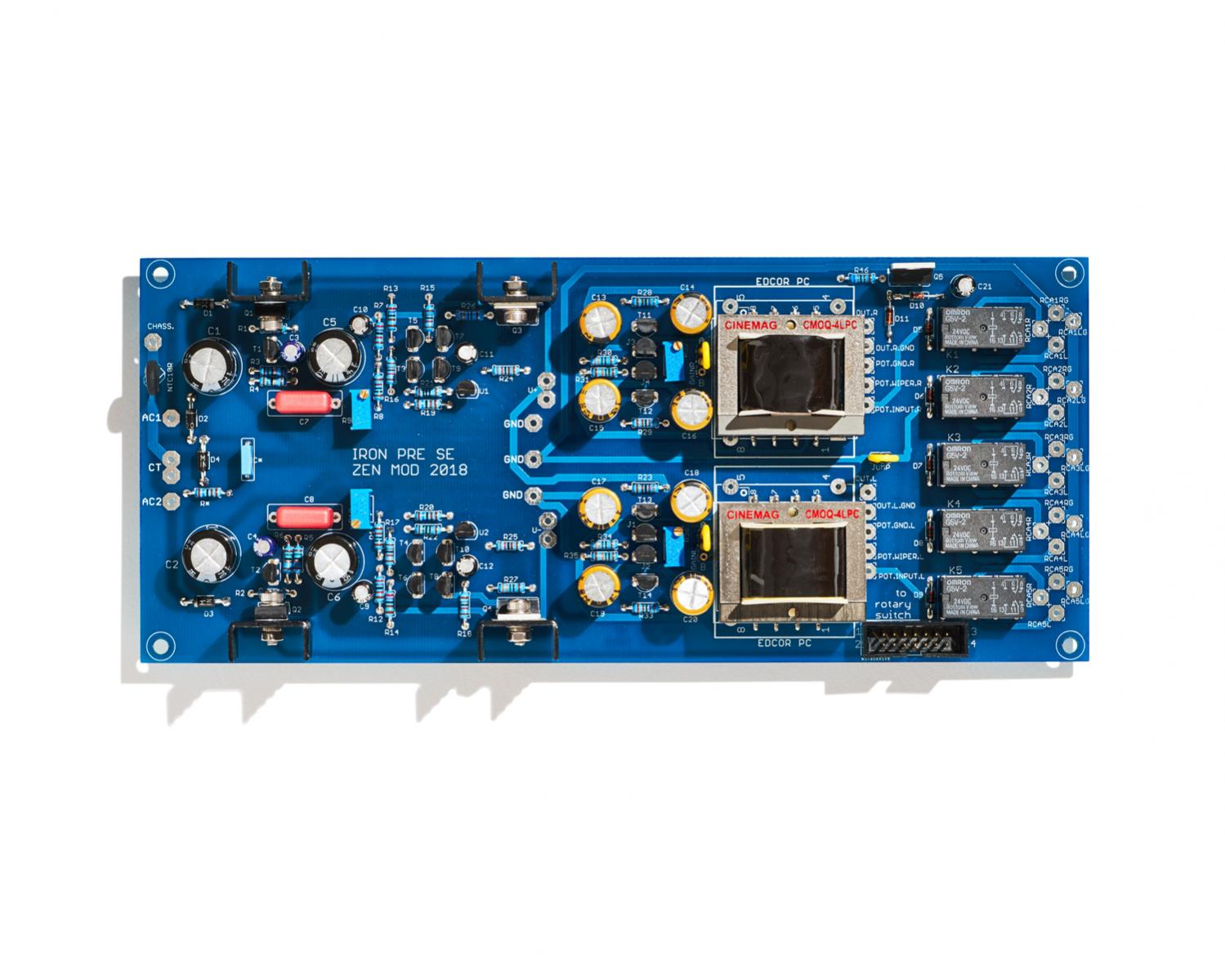

PF - Oooooh - Pick me too! Thank you for posting that. I have the same Antek Russellc is using with the 2018 boards (one C and one R). Any help with the values for the 2018 board with the Antek is very welcome.
I have 2020 boards for the balanced build I'm planning. I think I just got my wiring plan down for it and a basic understanding of the schematic. I hope by the time, I'm ready to assemble it, I'll have learned how to do Quasimodo on my own. <crossing fingers>

"We found that the optimum two component snubber for
the Antek 50VA transformer in Jim's house, and your assumed
diodes, was series_C = 0.15uF series_R = 68 ohms."
My transformer was not that Antek—so I had the pleasure of doing my own testing—and came up with a value for my 30VA—1U friendly—transformer...

Yes, you are coming up with a snubbing R value to deal with a transformers individual ring characteristic (the PDF I linked to is some awesome reading—most of it over my head at the moment to be sure—but Mark is a DIYaudio treasure.). My understanding being that any extra noise you can get rid of translates eventually into more music.
Certainly I have experienced this farther down the chain. My first F5 was very noisy. All the fine peeps up here gave a million suggestions to change the internal layout—including in a big way ZM—and when I did that—the difference was unbelievable. I could state that I hadn't "really" heard the amp to begin with. Also recently have been changing just power cable vs signal cable arrangements in my "metal cabinet of audio death" where all these projects are housed at the moment... and am realizing A. that my AJ is actually freaking quiet, and B. that it's sounding better than ever the more I get rid of environmental noise sources...
Pretty sure you can just leave the spots empty and move along—similar to the diode portion of the DIYaudio PSU.

I figure offset is measured at the R out and R out G, as well as L out and L out G, right?
The 15 volts set with pots measured at the 4 large pads in the center of board G and U on each side?
I checked your board pics and the schematic you sent me.
Yep - per your schematic.
You got it. Rock on. Not to influence the outcome, but I can't wait to hear what you think.

same as with any bridged gadget , most important offset is between two hot outputs - that's what your speaker will see and respond to ; as usual , clock it to 0mV , keeping on mind that up to 100mV is tolerable , steady state
second offset you need to think of is DC level of both outputs (together) ref. to GND
up to 500mV is ok , more than that will cut of available voltage swing
say that's on +10V ; rails are +/-25V ; there is 15V space to upper rail , and 35V space to lower rail ; guess which side voltage swing would first hit the ceiling :clown:
resulting in usable range of just 30Vpp , instead of 50Vpp (not counting losses)
I'm notoriously forgetting established names for these two offsets, one is Relative, other is Absolute ...... and I believe I got them in this tutorial (but lazy to check, so it's easier again to reveal my dumbness in Public) : Pass Labs X150.5 , checking/adjusting offsets ,Iq and gain | Zen Mod Blog
regarding actual tricks on particular pcbs, can't help - I'm not familiar with them , so better to ask someone who got them in hands
btw. - offset - taking in account that BBA3 OS - each group- is having independent DC offset setting mechanism , you can do each group in simplest possible way - setting DC offset between Hot and Gnd, fine tuning it on end as offset between two hots

Well poop. Everything going fine. ramping up variac. Rails up to 10 v, going to turn back off set which was below 2 mv dropped the tiny screw driver and the very small c21 exploded!
Let's find a spare and give it another go. On my boards this is the tiny cap next to the transistor back by the regulators. It now looks like a very small cotton ball.
Would attach a pic, but recently up graded from Windows 7 to 10, and don't seem to be able to upload pics now. I'll try a sim reader and see if that is a work around.
