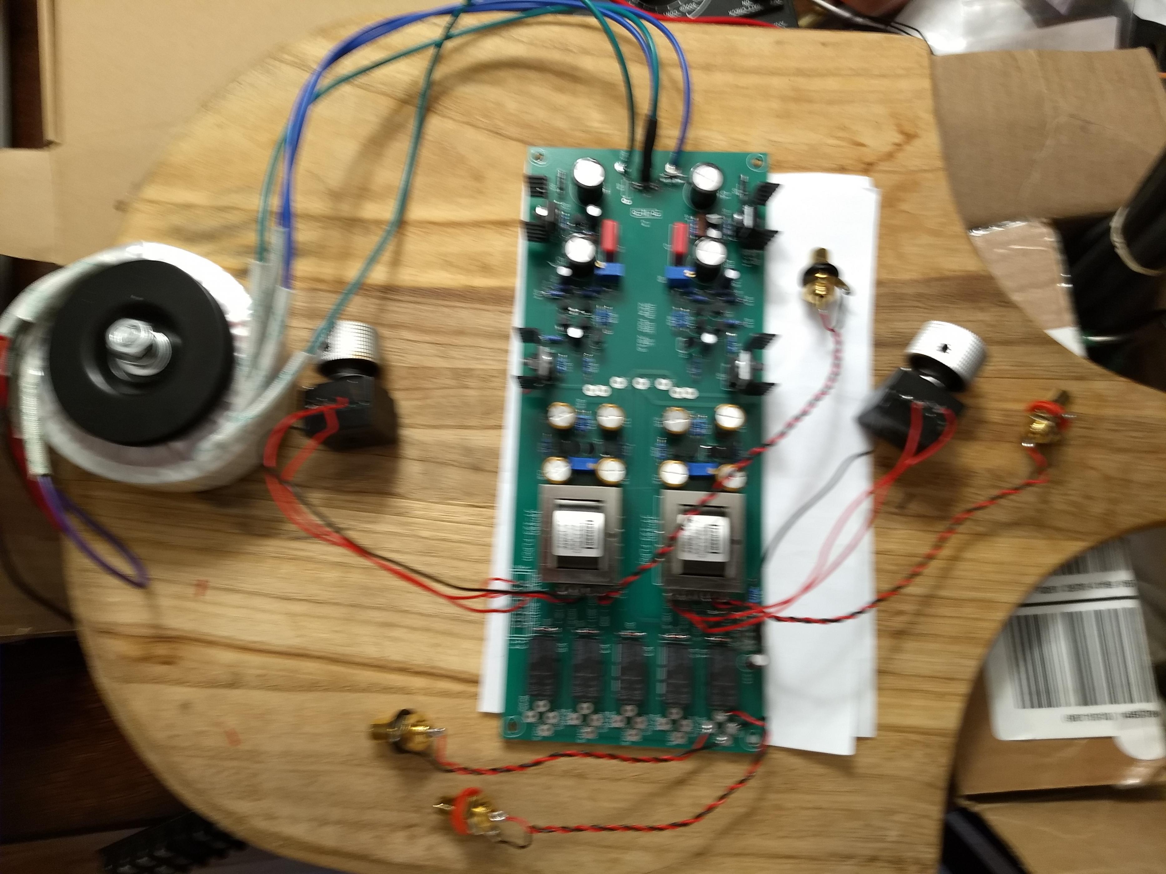

Seemed to work fine with JBL6230 "mule amp" but when hooked up to M2 as soon as M2 came up, hums like crazy. It is just layed out on a board...must need chassis ground, but ItsAllinmyhead's worked like this. Looking it over. Put Wayne's 2018 BA line stage back and it plays fine.

gimme pic exactly in humming arrangement
few please

edit: without waiting for pics - it must be issue with arrangement of Safety Gnd and Audio GND
either connect them or disconnect them (contrary to present situation) and it 'll stop humming
of course that I prefer all Audio GNDs connected to Safety GND , either through 15R NTC or last fashion - bridge+cap+NTC

Since I upgraded my computer to windows 10, I cant upload pics. They load in the box, hit upload and it goes away but does not attach. I will have to sort that out. Going to try putting sim card from camera in reader and see if that works.
If you check #569, mine is laid out just like this for checking it out before boxed up. So basically nothing is grounded...odd thing with JBL 6230 mule amp, nary a hum. Put M2 in chain and big 60hz hum. It is laid out just like his is in post #569
I may have to wait for chassis before I can go further so to have proper ground. I have no idea how Itsallinmyhead pulled it off.

either you have signal xformers in close proximity with some Big Donut, or your setup is lacking in grounding
first you can test with some moving, second with simple croc shortie put between chassis pad and mid pin on IEC
hoping that two other IEC pins are heatshrinked 🙂
Going to try to do it with phone....wiring is electrical nightmare. Transformer AC inputs are bolted to large barrier strip. Power cord to that, then to variac.
I probably need a chassis. In #569, I see a wire coming off his input plug IEC part. Maybe this is a ground wire?
This was just temp setup to hear it.
