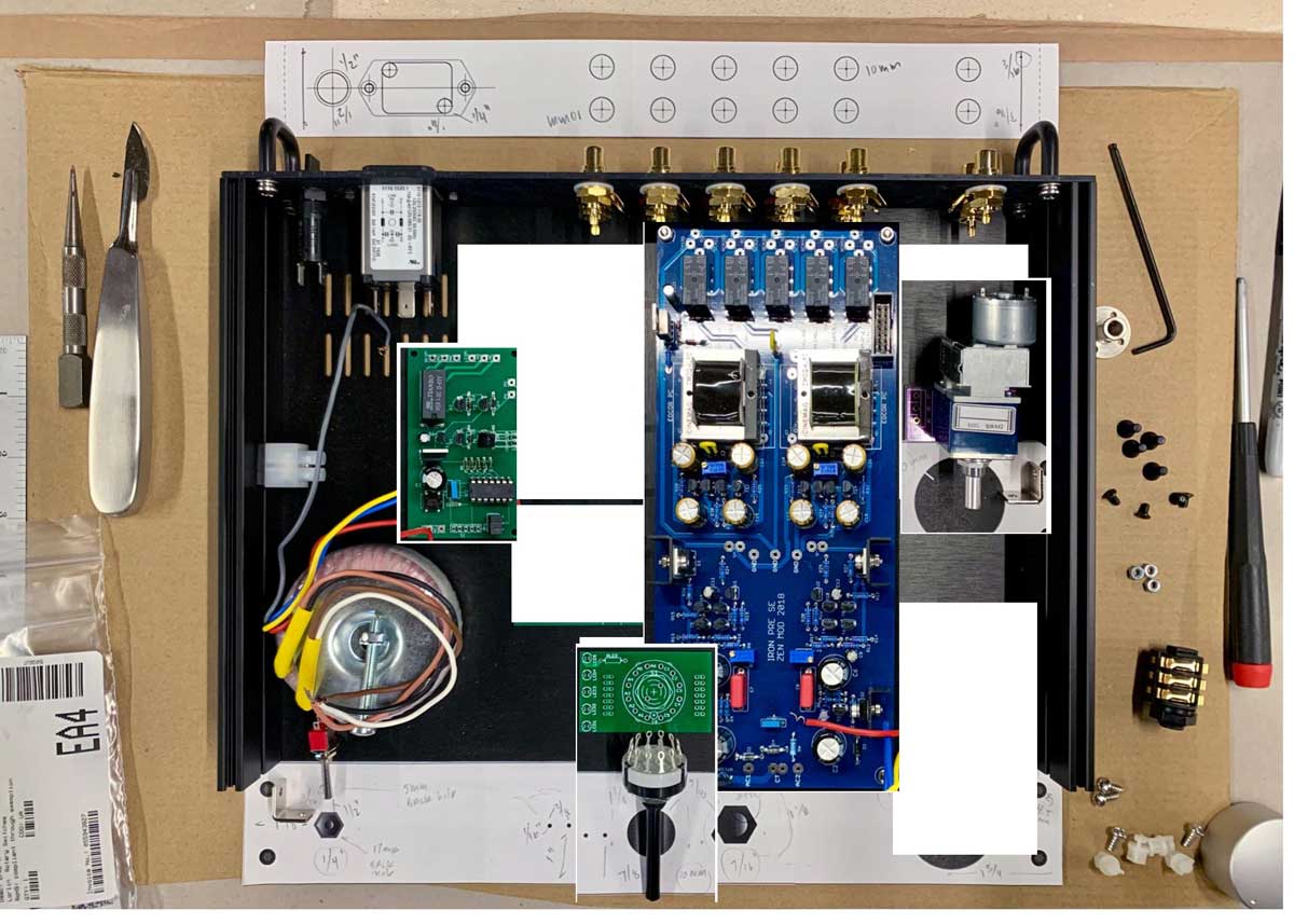

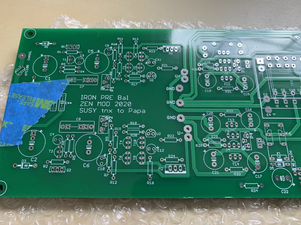

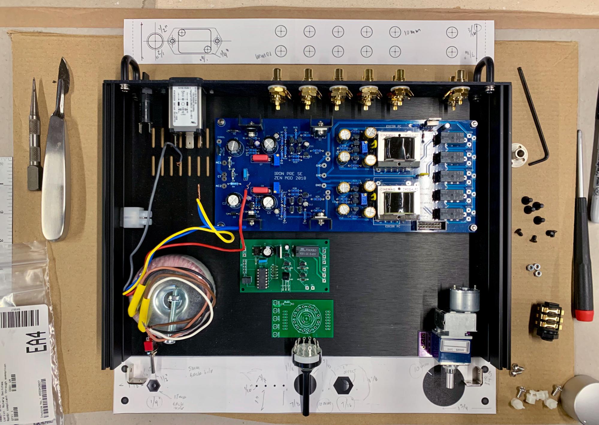

Process pics of ZM Iron Pre SE super compact....Matching chassis size for a stack-up with my version of Wayne's BA18 pre...

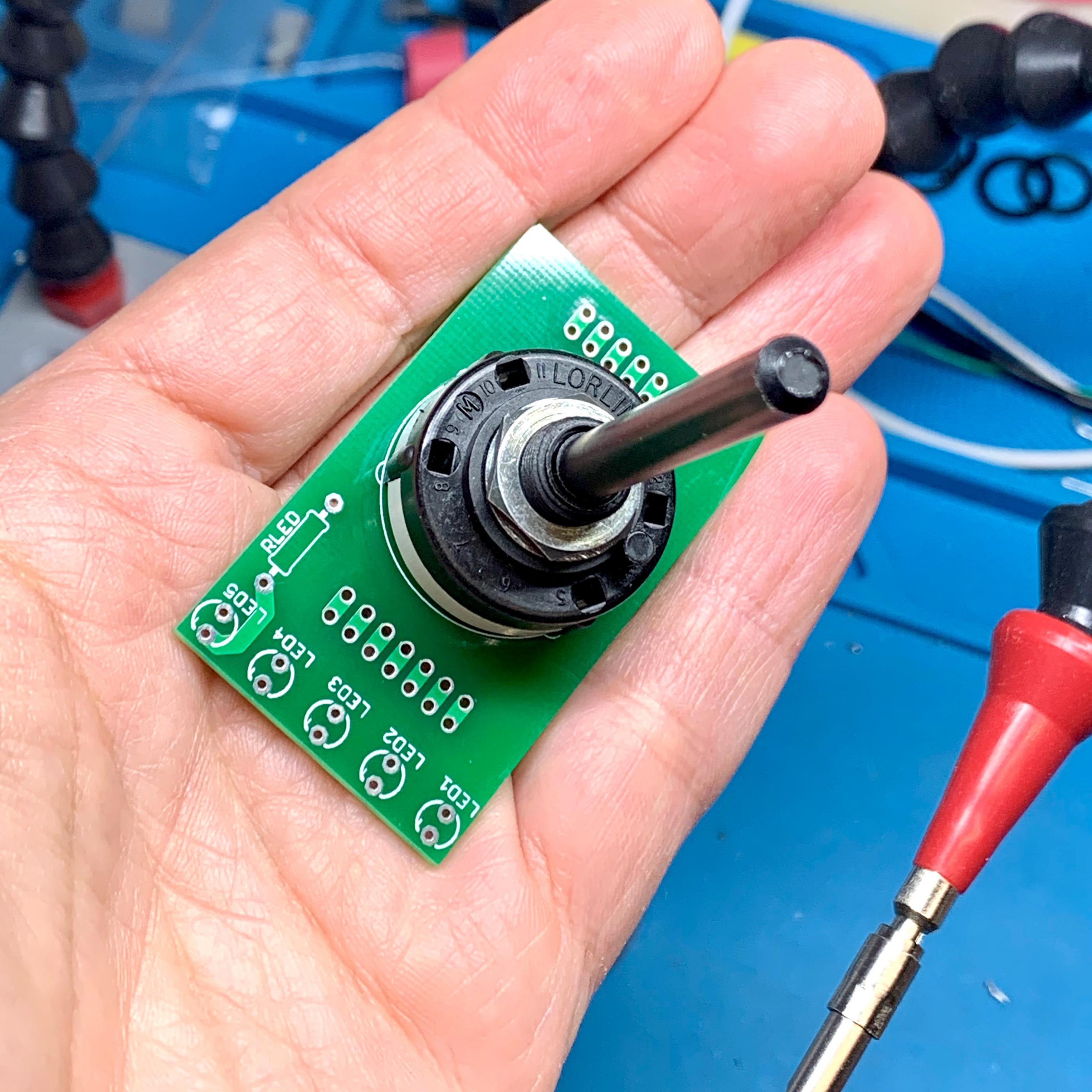

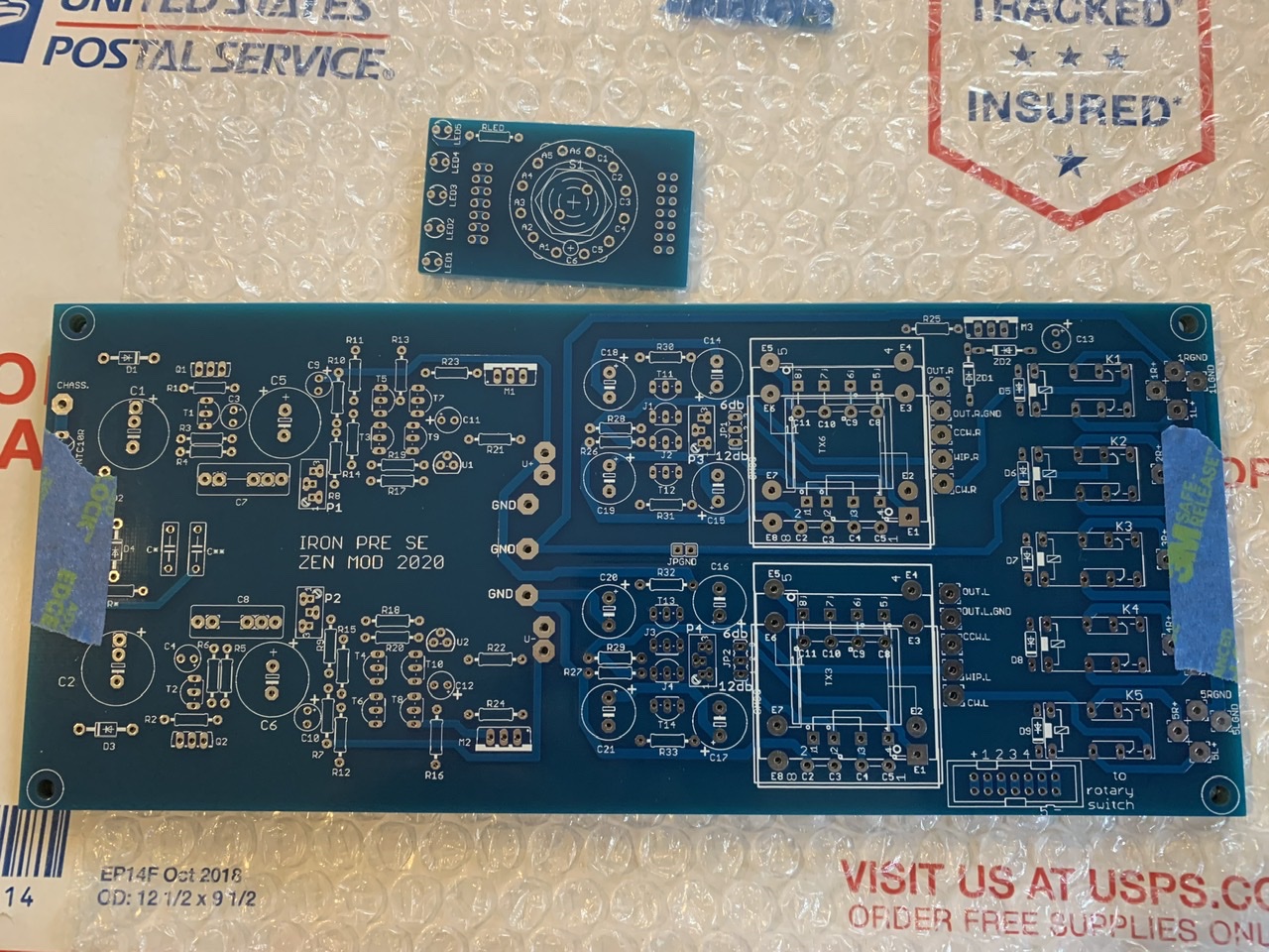

ZM—is the idea with the switcher to cut the loops on the Lorlin and stuff the board? Assuming yes. Haven't tested the hole sizes yet, they measure perfect though...

you got wrong Lorlin - that one is having solder eyelets , while you need one with through-hole pins for that pcb
try cutting solder lugs/eyelets and see can you squeeze leftovers in holes on pcb ; if needed , be brave with clippers , make them narower
edit: here's crude sketch/edit of your pic
I hope you can manage something like that

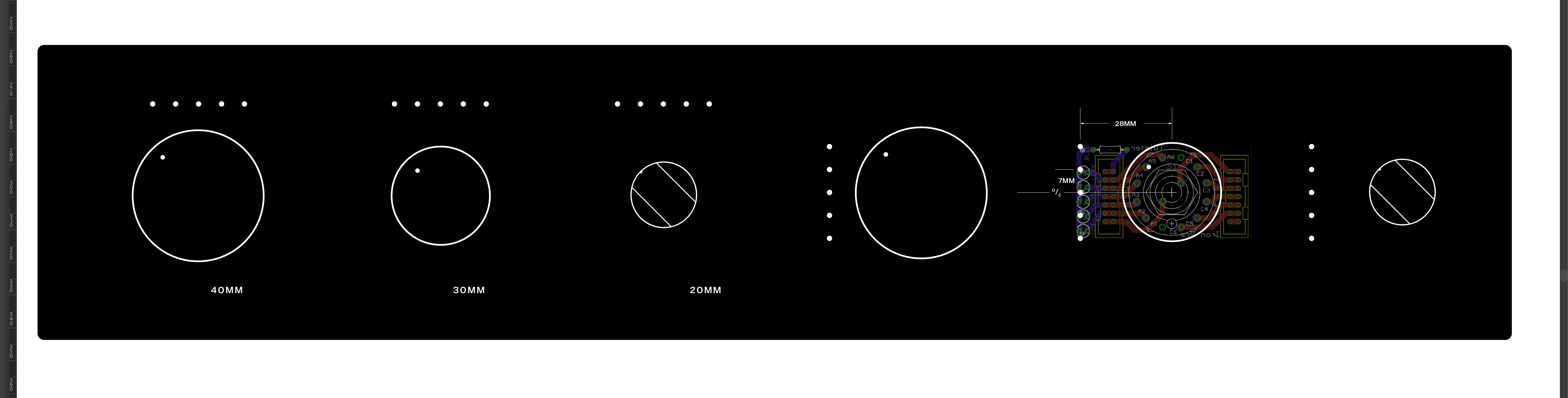

I would go with different orientation of pcb , it seems depth of case is good enough for rotating pcb for 90deg , so inputs are close to RCAs back and , if you already didn't messed with front plate , you can put pot left of pcb , with extending shaft - all the way back
only that way all internal wiring is kept shortest as possible
I hate to see ultramumbojumbo constructions of Yore ( most of them being Elector or Elector inspired( having all ziggles and zaggles digital ( few timers and input relays ) , more complicated that sound side of shebang ...... while having arm fat bundle of coaxes , routed from back to front and back again
see PL arsenal for examples of professionally claimed and accomplished lazy way - everything is short and logic ...... not just being better but also being less complicated and time consuming for assembly**
idea with the switcher - Guyz demanded light show in front , and that was pretty much cleanest way of getting it
**we all know da sayin' - cut trice , measure once

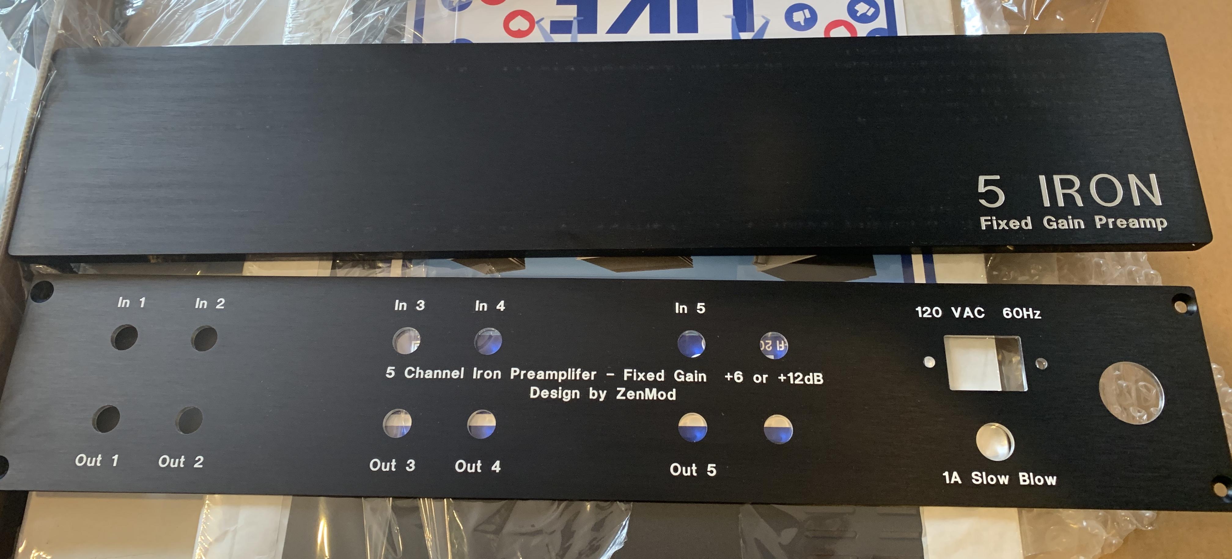

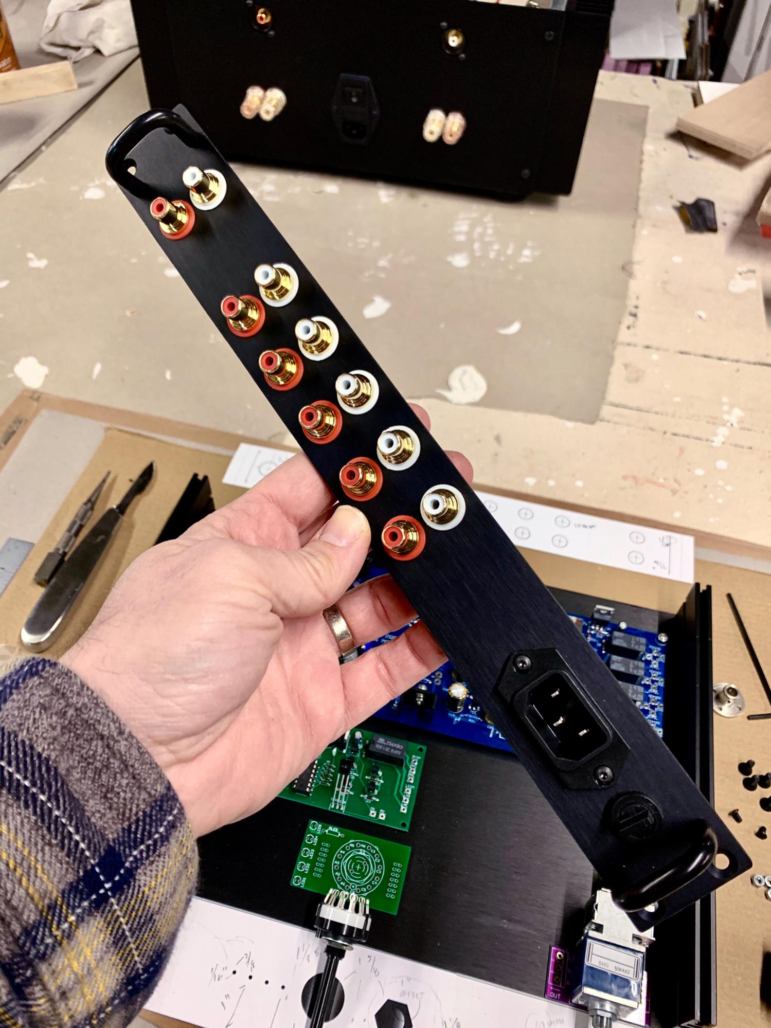

I will put this in a 280mm deep 1U (keep shorter chassis for something else). Keeps my design ethos for this build—and back plate still works... but I can lay it out as you suggest. Sweet! Love it! Haven't butchered front panel yet.....
Didn't know about the PCB version of the Lorlin (Missed that detail in your earlier post)—but see pics—perfect fit after snips. On a quick look at Mouser I couldn't locate this switch with PCB pins (in USA)...That said—I DID buy part CK1030—and lugs with loops is what they sent. CK1050 seems to the same switch with "pins"—nowhere to be found at Mouser or Digikey.

idea for these LEDs is - you can drill holes for them right in front of pcb and solder them when switch is in place , bolted
that way there is no need for additional wires for LEDs
of course , with taller front, LEDs can be above button , with 1U - either left or right of button
edit: that "something" visible on LED overlays is slightly hidden letter C for cathode ...... it could help with orientation ..... even if I always forget how C looks at actual LED (smaller inside or bigger inside) but DMM is there to remind me .....
